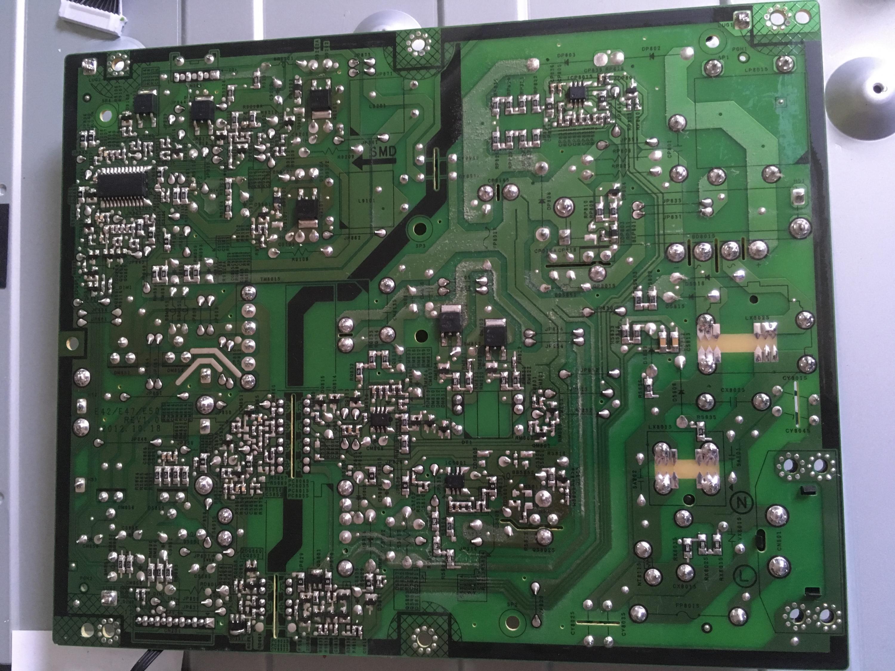

      #102
      Re: Vizio E470i no power
      ok i uploaded the pictures.
        #103
        https://www.badcaps.net/forum/attach...8&d=1518374864

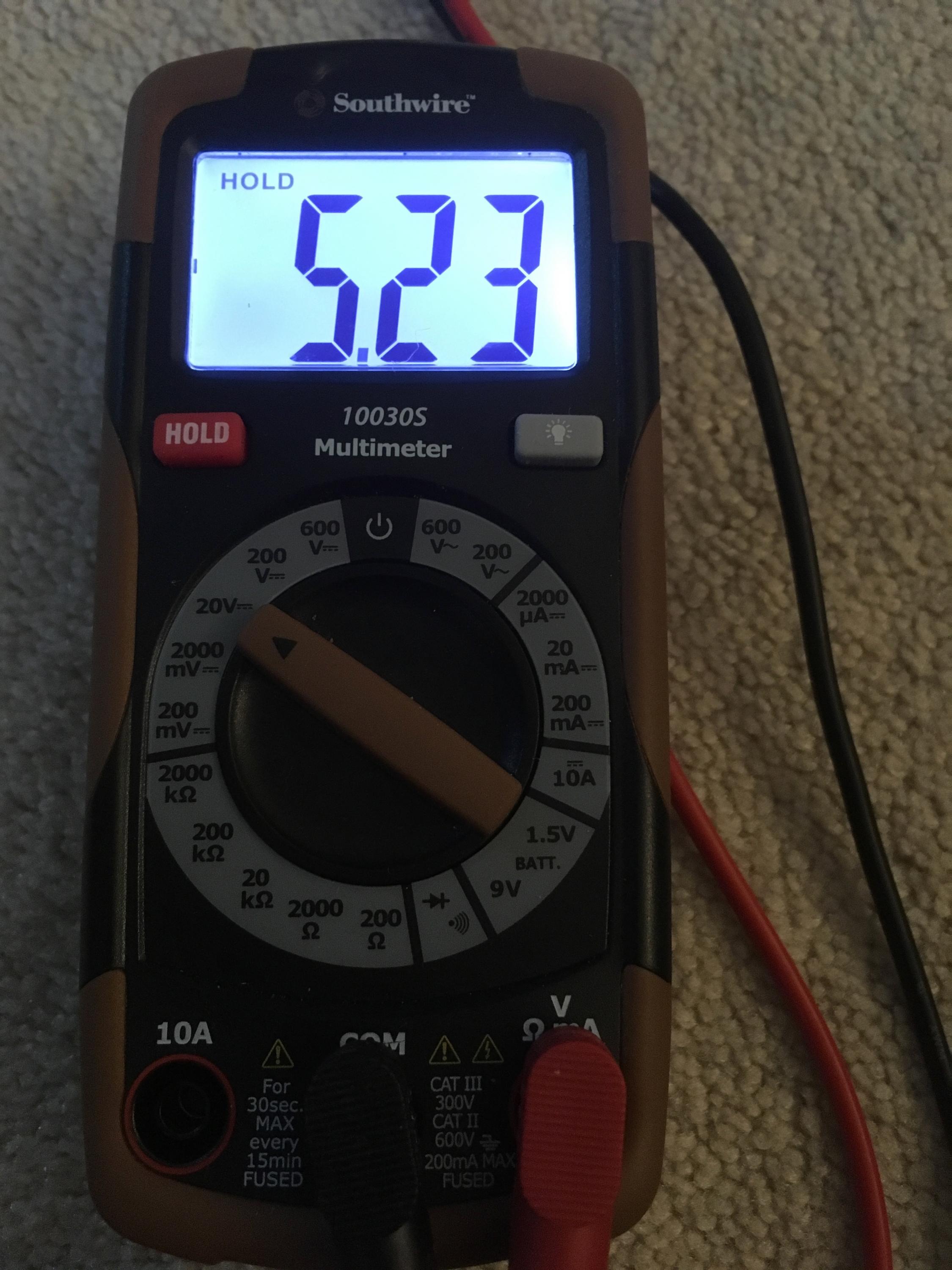

          #104
          ok. i think i did it, i also included a picture of my multimeter settings and amount.
          Got 5.23 v.
          , so i guess I got standby power.
            #105
            So with all the boards connected you do have 5VSTBY for the main board to run but you are not even getting any indicator lights to come on, so you need to troubleshoot the main board next. This is smart TV so try disconnecting WIFI card if it has one.

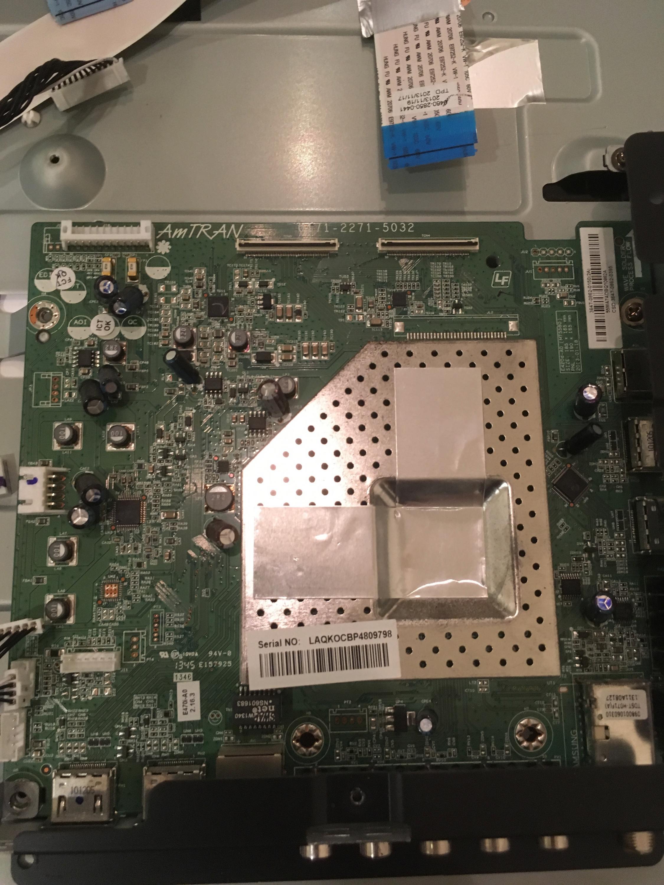

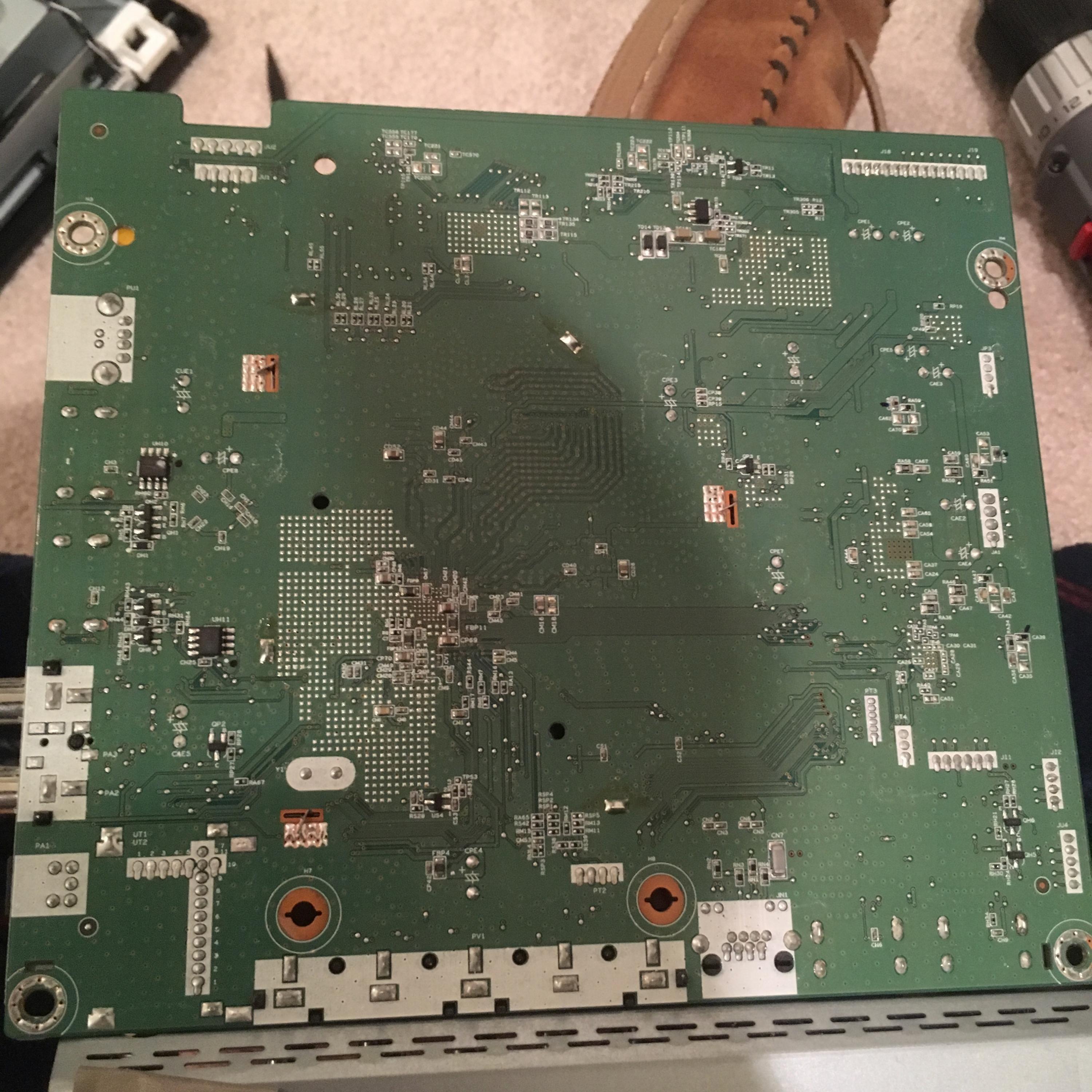

              #106
              ok. I did check to see if the power made it through the cable to the main board and it does. I think the wi-fi card must be the plug in the lower left hand corner, because the other black/white wires went to the power button on the side, and I'm guessing the remote sensor. The one midway up on the left went to the speakers.
              I unplugged the wi-fi and still no indicator light whatsoever. So i'm guess the Main board is bad? thinking it's one of the main CPU chips possibly that go bad.
              I've included pics of the main board.

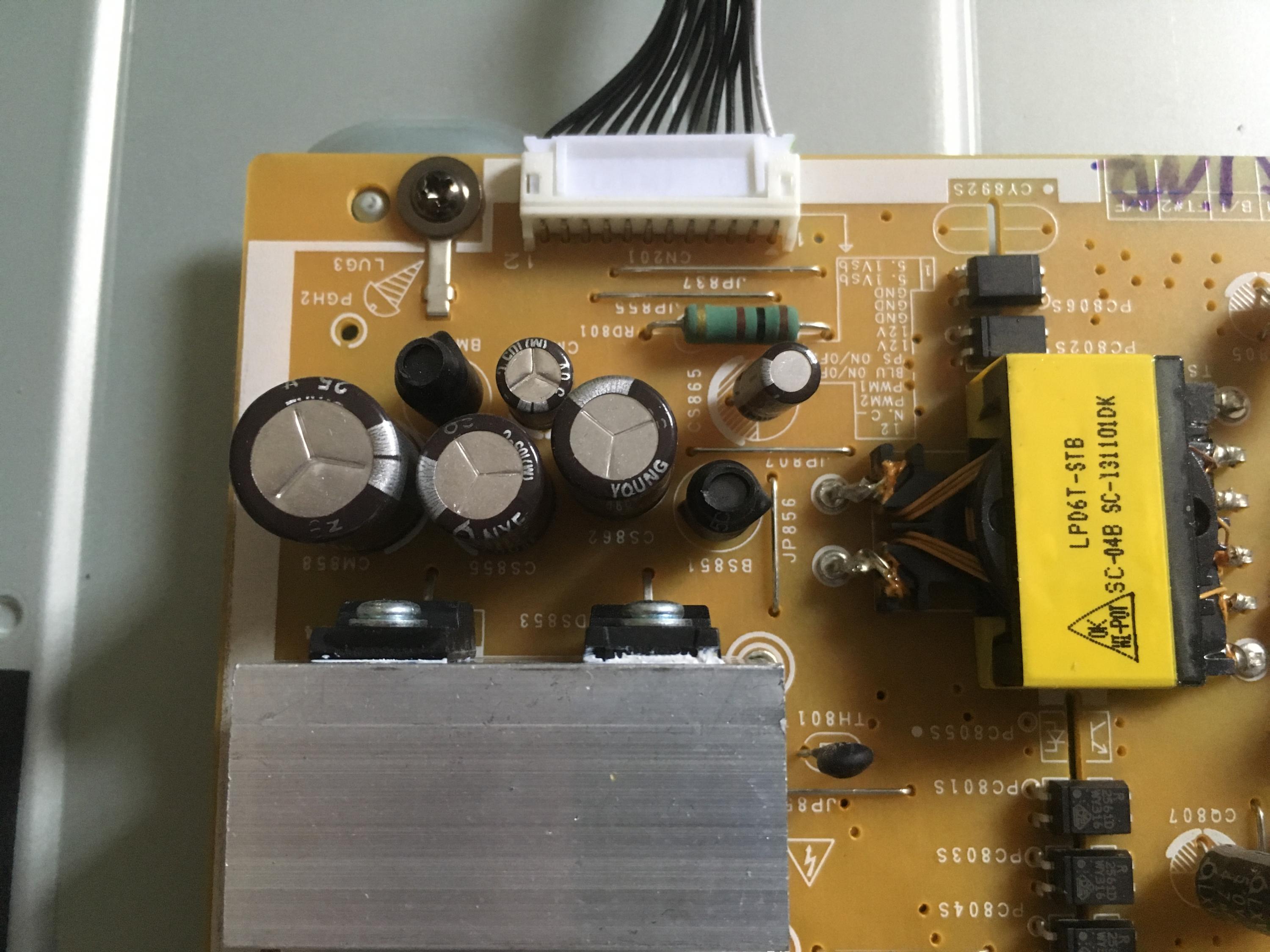

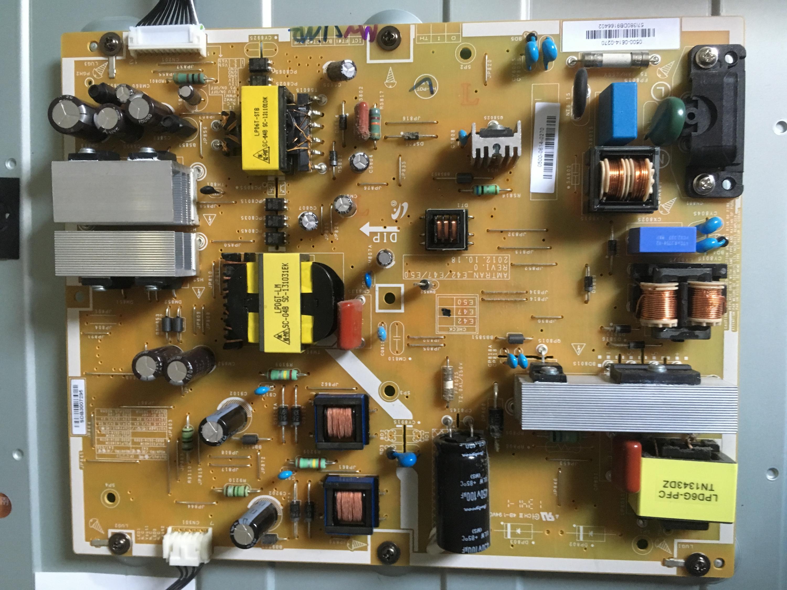

                  #108
                  https://www.badcaps.net/forum/attach...9&d=1518374864
                  You need to report the Voltage readings on the connector CN201 of the power supply board that goes to the main board next. As you can see, there are labels for each pin of that connector so you MUST put down the pin name and follow by the Voltage reading for each pin.
