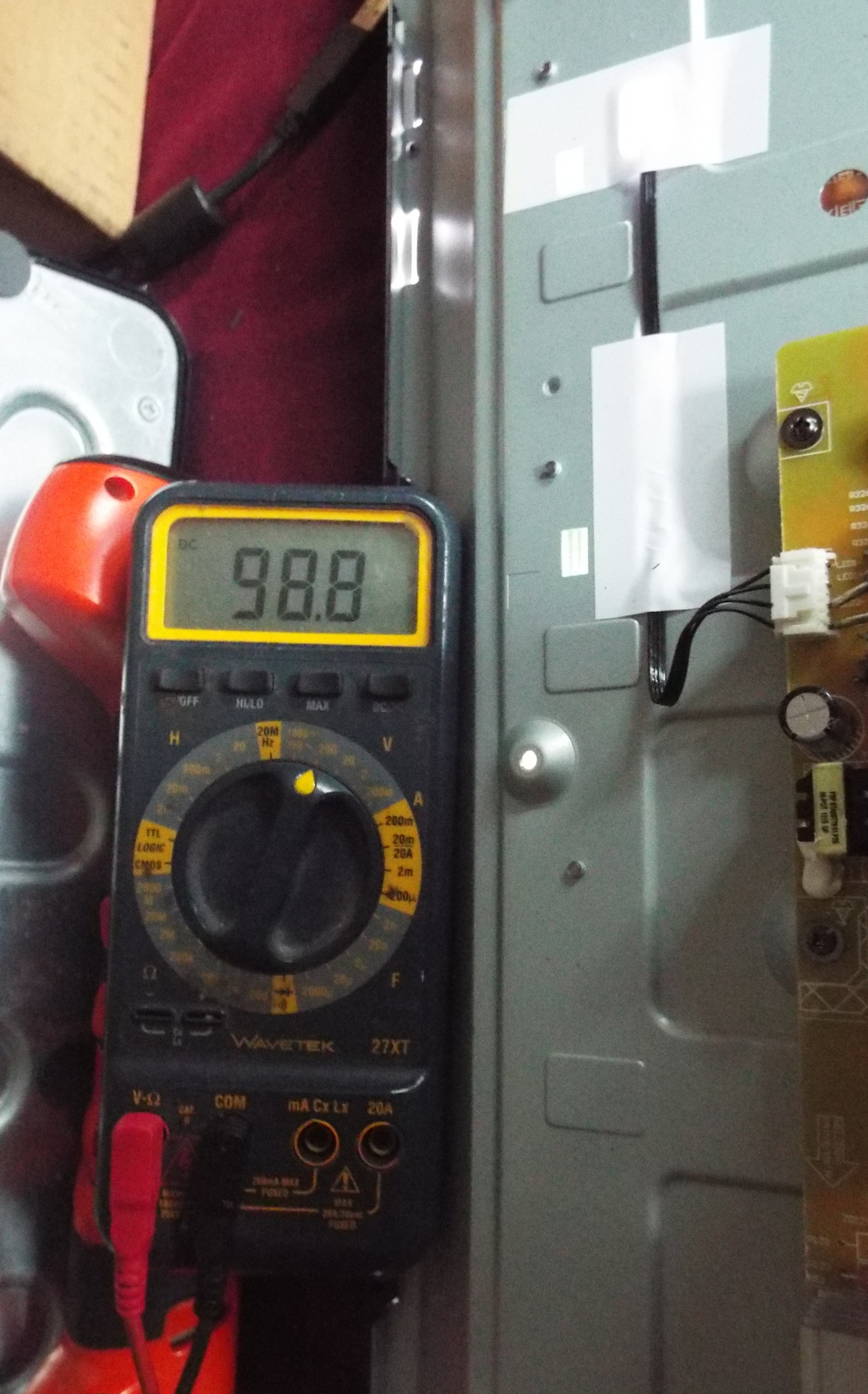

      I have a working Vizio E470i-A0 with a crack screen on my work bench, I'm about to dis-assemble this TV for parts,so if you need any voltage measurements I can confirm these reading.
      The LED connector should read around 99VDC
      if you need the LED strips please let me know.
              I get 126 average voltage on the LED pins, instead. I guess this may be ok, considering the % of accuracy into account. But if I'm getting this, why the heck won't the backlight come on? The blu-on is at 3.2, unless jumpered to the standby- and then it's 5.26. The guys on here helping me were deciding if it's a bad LED string, so I'll wait for what they think after reading my latest test results.
                #67
                Re: Vizio E470i no power
                If if the reading is 99V per ECKING, then you do have open circuit (no load) Voltage due to open LED connections/open LEDs.
                    When the LED driver output does not see the load, its Voltage will rise up to try to force current through the load due to the fact that it is constant current source, the current is held constant but the Voltage is varies to maintain constant current.
                    You can disconnect the LED connector and check the DCV at the pins of the connector that go to the Anode of the LED strings, you will probably see more than 100V also.
                          Thanks Budm,
                          I'm wondering if my DMM's reading of 120-131 is accurate enough to determine....could it be enough of a margin of error in it's reading that 99v is still correct..or is the difference too much? How is this fixed? Do I now need to find which LED's are faulty, or is it a matter of replacing the whole thing?

                              #74
                              I didn't see any issue with the main power connector voltage measurements.
                              I will focus on the LED strips inside the LCD screen itself.
                              Please confirm the voltages on the LED connector with the TV power on. You can make contact from the back side of the connector using your Multimeter.

                                  #76
                                  Originally posted by AcGeorgiegirl View Post
                                  Yes, that's actually the spot where I have been testing already. Same as before, I keep getting a range from 120 up to 131 or so, and my DMM cycles up and down this scale repeatedly.
                                  If 120vdc is being applied to the LED's strips and they don't light up, then one or more LEDs are open and no current is flowing. You will have to disassemble your LCD panel to inspect the panel LEDs.
