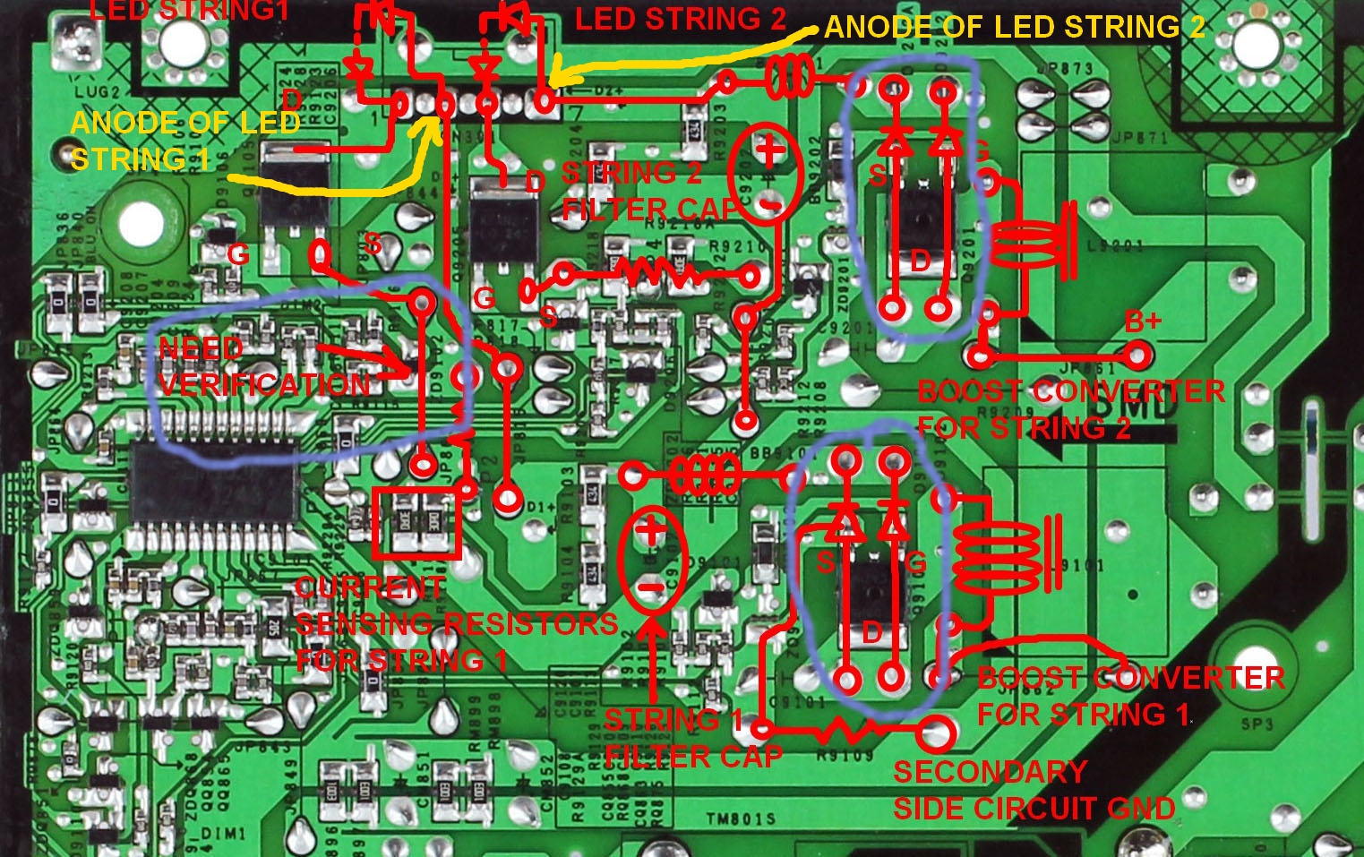

                      #50
                      Re: Vizio E470i no power

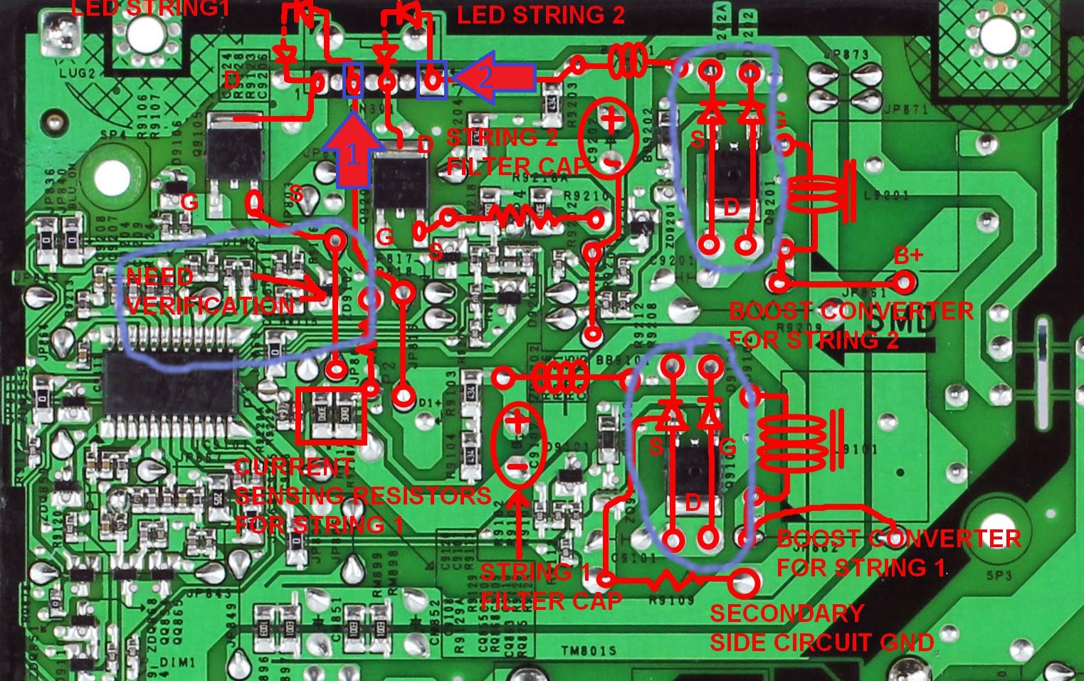

                      So it has two LED driver circuits for two sets of the string, more likely one string for left edge and one string for the right edge of the LCD panel.
                      You need to monitor the Anode of the LED string 1 and string 2 to see what DCV you get when you first turn on the TV, I am looking for the Voltage to jump up high and then settle down to the lower Voltage, I also need to know for sure if you do see the backlights flash on for second or not.
                      BTW, what is the DC Voltage rating of those two filter caps I marked?
                      Pictures provided by SHOPJIMMY.
                          Ok, I see where you marked for measuring a LED string, but I'm not sure there's supposed to be two of these...one for each string?
                          • AcGeorgiegirl
                            • Jun 2013
                            • 203
                            #53
                            I don't "get" strings, I think, is what's tripping me up. Are the 2 circles at the ends of the line you're pointing to the anodes for string 1 and 2?

                              #54
                              ...also, with testing the filter caps, I'm not certain my DMM will give nearly accurate reading unless I desolder/disconnect one lead. Is that true? Mine doesn't read capacitance or ESR...just ac/dc volts, diodes, amps, and ohms.

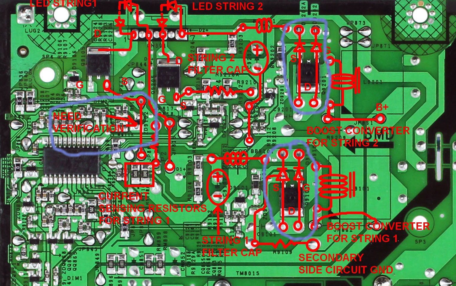

                                #55
                                I hope you know what the Diode symbol is to be able to tell what is Anode and what is Cathode, please look it up. You will put the meter in DCV, BLACK probe on the chassis, the RED probe on the Anode of the the LED string #1, turn on the TV and observe the readings, then turn off the TV, then do the same on the ANODE of the LED string #2. You see that I drew Diode symbol on the connector that goes to the LED strings of the panel.
                                • AcGeorgiegirl
                                  • Jun 2013
                                  • 203
                                  #56
                                  I attached a pic with marks I made to show you where I am looking. Yes, the anode side is the part that looks like an arrow. I just don't know where each string's anode is, on the board. I see where you drew the diode symbol for each string, and the only other symbols I see are the ones I circled in blue, which are two that look the same...do I touch the probe to the anodes of each of these? I also circled the area that originally I was focused on, the "Need Verification". I was thinking this was one of the string's area you wanted me to test, but didn't know how to locate the anode portion(!). I am looking for a soldered post that's an anode side of a "string", though not understanding, I think, what a string looks like. Maybe I'm thinking wrongly...that it is similar to a cap's connectors or a resistor's. Sorry I'm so confused!
                                    #57
                                    Please see the attached picture.
                                    BTW, you can take the measurement on the top side of the board right at the connector pins.

                                      #58
                                      ***EDIT***
                                      budm got there while my image was uploading

                                        #59
                                        Thanks, guys- You were telling me this, but I didn't get it! Quick question...should the psboard be connected to the other boards for this test, or just to the ac?
                                        • newtothis
                                          • Mar 2013
                                          • 1556
                                          • england
                                          #60
                                          Plug all boards in when doing the test
