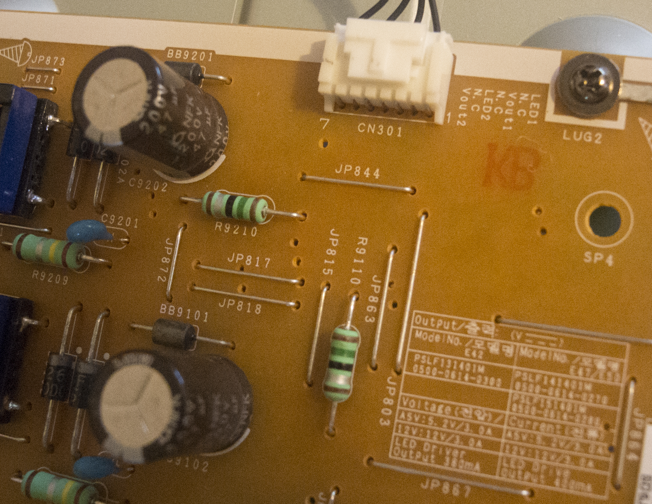

    On the Power Board jack P701 with the TV plugged in the AC measure Pins10-15 and 20-21 and see if you're getting 5Vdc.
    I am wondering if you actually have the schematics for my psb? I can't locate the P701 jack you are referring to, and would be great to have the schematics!!

          I think he meant P201:
          https://www.badcaps.net/forum/attach...3&d=1432326777

            On the pic you linked a closeup of the cn201, which is the jack we've been talking about thus far. Is that what you mean? There are only 12 pins. I can't see a P201 or P701...anything with that larger amount of pins.

              I am about to go try the same procedure (jumping using a 1k ohm resistor from 5v stndby to the ps-on and bl-on pins) on the original board. I damaged the replacement one, fyi.
              • AcGeorgiegirl
                • Jun 2013
                • 203
                Re: Vizio E470i no power
                I first tried it just using a wire(not resistor), and I did get a 5.2 v onto each of the pins(bl-on and ps-on). So what does that mean??? How can it actually switch on the backlight and the power, without being connected to the Main?(yes, I'm still stuck in not understanding this, I guess). How could I get the backlight and power on by jumpering, unless the main is connected?

                    I just tried it just using a wire(not resistor) and below are the pin readings. But...the backlight still doesn't come on. ( I realize that I just need to check v for the ps-on, but it can't do anything without the Main). I did leave the ps connected to what I am thinking must be the backlight or panel...the cn301. I'm going to take a pic for you guys and post it of this jack.
                    pin 1 stndby - 5.21v
                    pin 2 stndby - 5.21v
                    pin 3 Gnd
                    pin 4 Gnd
                    pin 5 Gnd
                    pin 6 12v - 11.89v
                    pin 7 12v - 11.89v
                    Pin 8 PS on/off - 5.21v
                    Pin 9 Blu on/off - 5.21v
                    Pin 10 PWM1 - 5.21v
                    Pin 11 PWM2 - 5.21v
                    Pin 12 NC

                      I also tested the CN302 jack pins while the 2 jumpers were still intact on the CN301, using a 200 on the v dial. Here's the results:
                      Pin 1 LED1 - 60 to 70v
                      Pin 2 N.C
                      Pin 3 VOUT1 - 121 to 130v
                      Pin 4 N.C
                      Pin 5 LED2 - 61 ti 72v
                      Pin 6 N.C
                      Pin 7 VOUT2 - 120 to 128v
                      • AcGeorgiegirl
                        • Jun 2013
                        • 203
                        #31
                        I also tested the CN302 with the 2 jumpers off. Got a depleting down to nothing reading on all pins that had any voltage before.

                          Main is irrelevant to this now.
                          You have the voltages all coming up yet still no backlight.
                          I am sure this is another case of bad LED strings.
                          Let others pipe in and lets see what they say
