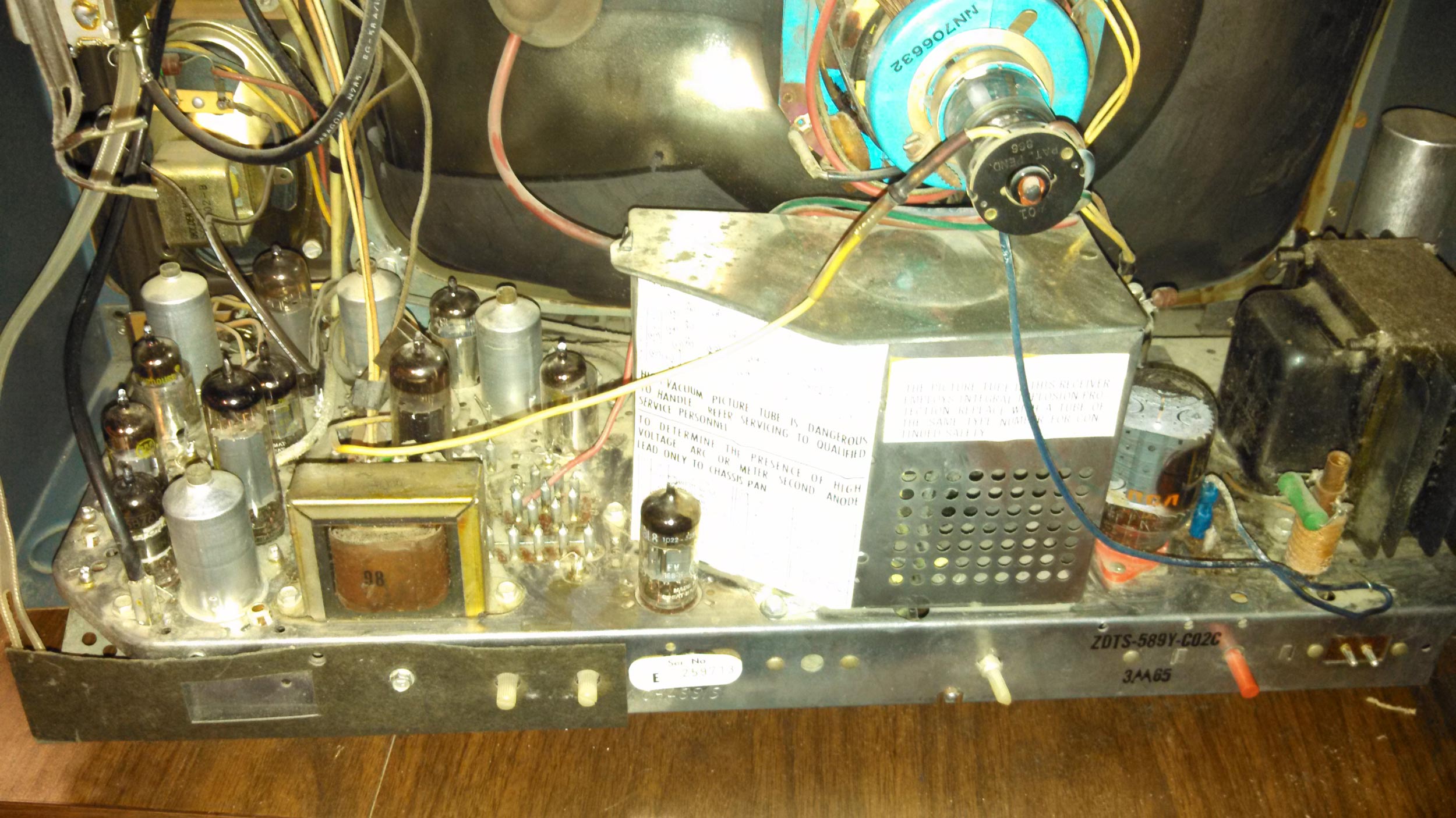

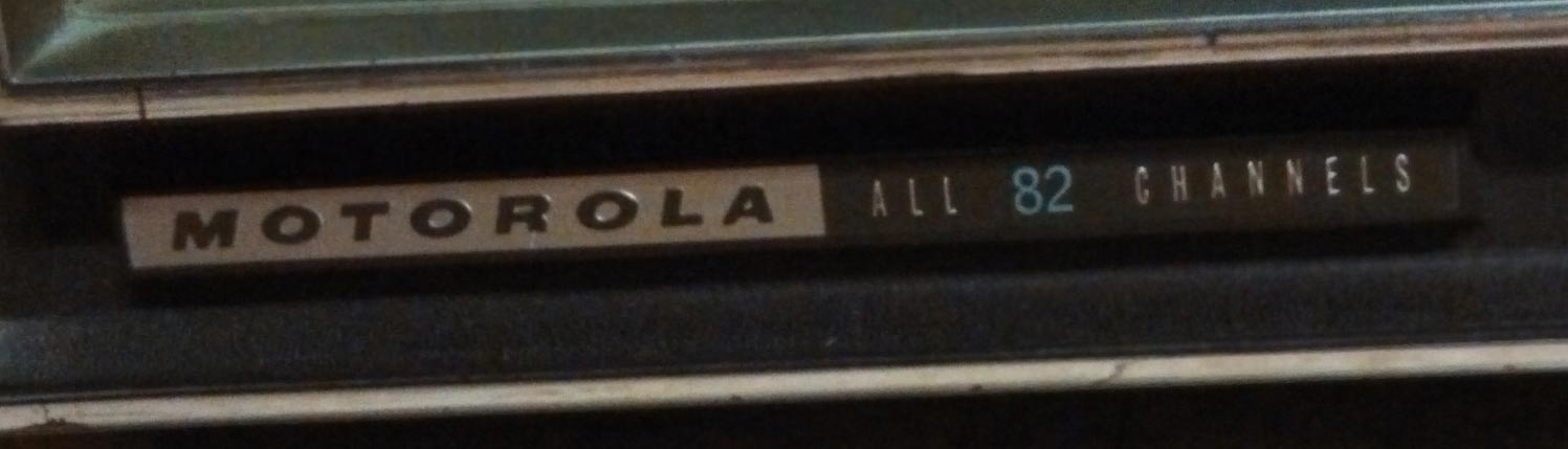

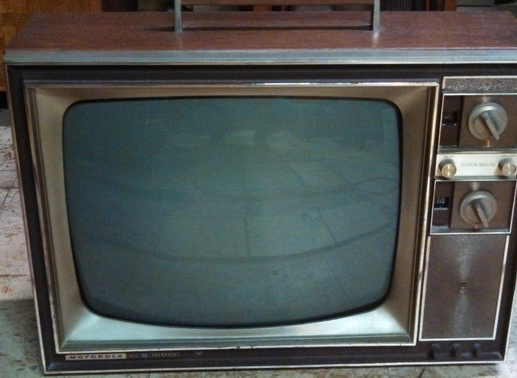

    Found an old tube TV. Want to find out more about it.
    Hey guys, it's been awhile. I was out and about when I saw an old tube TV sitting on the curb. When I say old tube TV, I don't mean some CRT set from the 80's or 90's. I'm talking about a TV with a metal casing and a chassis full of vacuum tubes.
    Pictures are attached. Based on what I know, I'd date the TV around the very early 60's. I say that because of the rectangular CRT and the fact that the CRT has integral explosion protection. However the chassis is hand wired, no printed circuit board so it's definitely not a later 60's set.
    I don't know if the TV works, since tube sets that have been sitting need to be brought up on a variac which I don't have, but cosmetically it's in great shape.
    Any information on this set would be great. I think the chassis number is ZDTS-589Y-C02C
    Edit: I realize it's a long shot, but figured I'd post and see if I get lucky.
    Oh and for a bit of irony, the pictures were taken on my Motorola phone.

    Re: Found an old tube TV. Want to find out more about it.
    bring it up on a variac and see what happens.biggest concerns are flyback and crt condition.
    if it plays then replace all the lytics and any wax paper or "black beauties"(black leakies) you see.

          • 31287
          Originally posted by Mrx3750
          Right now I just want to get an idea of when it was made
          maybe march 1965
          that's 50years old, so forget reostats/variacs and do a full recap before you put power into it.
            Yeah I was wondering if that 3AA65 was a date code.
            1965... isn't that a bit old for a non PCB chassis?
              • 31287
              non-pcb valve tv's started in germany in ww2 - for the public use i mean.
              pcb use started in the 70's when valves got replaced by transistors.
              btw, you can probably find date codes on the valves and other components.
              also there is probably some stickers on the crt.
                Yeah, it's March 1965. I found a date code on a 1964 set, and what i thought were two A's is Motorola's M logo. so yeah, it's 50 years old.
                I'm going to do some more research on the TV before I decide whether or not to restore it. I don't really have the equipment for testing tube electronics. I may end up giving it to somebody who collects tube TV's as a hobby. Anything to keep it from getting crushed in a garbage truck

                    and tv tubes are plentiful and cheap.many billions were made and many are still with us.i can go to any hamfest and come away with buckets and boxes full for little of nothing.and weed out the audiophool stuff for a nice profit.
                    btw the uhf tuner mandate hit in 1965.
                    that one spins it as a feature.ALL CHANNEL!
                    so the datecode is probably correct.
                                        Hey guess what?
                                        It's alive! (Sorry for the crap picture. The phone that I took the first pictures on... the one with the good camera... yeah it decided to die on me last night, so I had to rush out and buy a cheap phone to get by until I get some money.)
                                        In any case, sound and picture works, and the set seems to be new enough to have mylar caps instead of wax.
