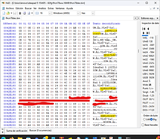

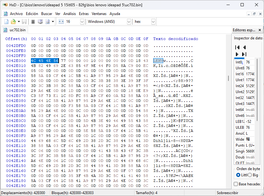

    Your laptop has its BIOS split into 2 chips, 8MB + 16MB, there's also a 8MB chip (maybe W25R64FV or similar), read this one too

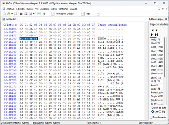

    DMi data is encrypted, find LENV with hex editor on 16MB chip, then copy both blocks
    It looks like this

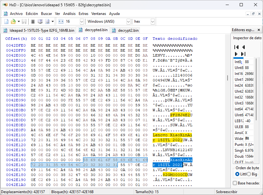

        Yes, it's supposed to look like that, that "0xBE" character which is repeated, it's the encryprion byte, it changes for every laptop even of the same model, what you call "scribbles"/"garabatos" copy all from 42E000 to 42FFFF including the "garabatos" and Paste write on the clean BIOS at the same offset (Pegar escribiendo, Ctrl-B), file size shouldn't change
        I decrypted your LENV blocks with the tool linked above, someone flashed a different BIOS, model "Lenovo XiaoXinAir 15ITL 2021", it's a China model, type 82GM, S/N doesn't match yours, your original data including Windows key is lost forever, sorry

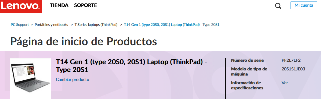

        Also the serial you posted PF2L7LF2 belongs to a Thinkpad T14 Gen 1, check again

        Should work, but will display INVALID serial number, model, and MTM, if you want you can copy the data from the 16MB BIOS on post 13, decrypt it, edit serial and MTM, encrypt again, flash it

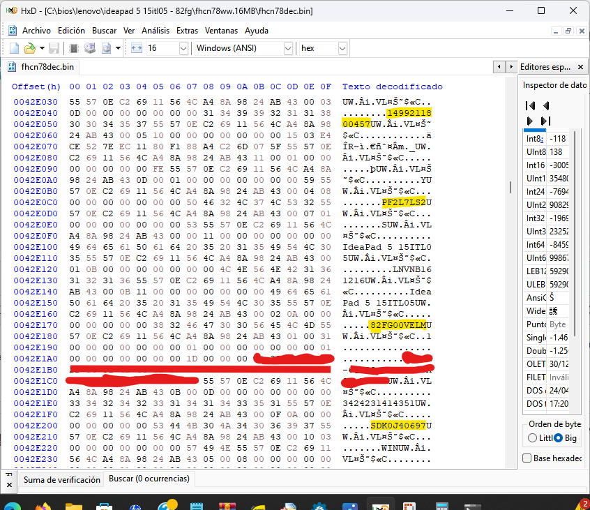

          Please review the structure and advise the correct sequence. I want to populate my BIOS with accurate data.
          Field Notes
          Manufacturer LENOVO
          Model Name IdeaPad 5 15ITL05
          Version SDK0J40697WIN
          Board Product NM-D211
          Alternate Board Product LNVNB161216
          Board Version Rev:1.0
          Board Serial 1499211800457.
          UUID XXXXXXXX-XXXX-XXXX-XXXX-XXXXXXXXXXXX
          MTM 82FG00VELM
          Family IdeaPad
          UUID obtained by scanning the motherboard barcode labeled as “UUID BARCODE.” All other fields sourced directly from the motherboard.
          BIOS was previously flashed incorrectly by technicians using the wrong model. Unsure about proper order: should Board Serial go before S/N or vice versa?
          If anyone has a correctly configured DMI, please share the exact structure or sequence. This will allow me to populate my BIOS accurately.

            Try, I edited your info here, used post 13 from here as a template https://www.badcaps.net/forum/troubl...50#post3659250
            UUID i don't know where it is, you can use Golden Key also to fill S/N, MTM, Model and generate a new UUID
            https://www.badcaps.net/forum/troubl...r-bootable-usb
            Highlighted changes in yellow, edited the 2 blocks
            Click image for larger version  Name:	dmi ideapad 5 15iil05.png Views:	0 Size:	143.4 KB ID:	3713983
