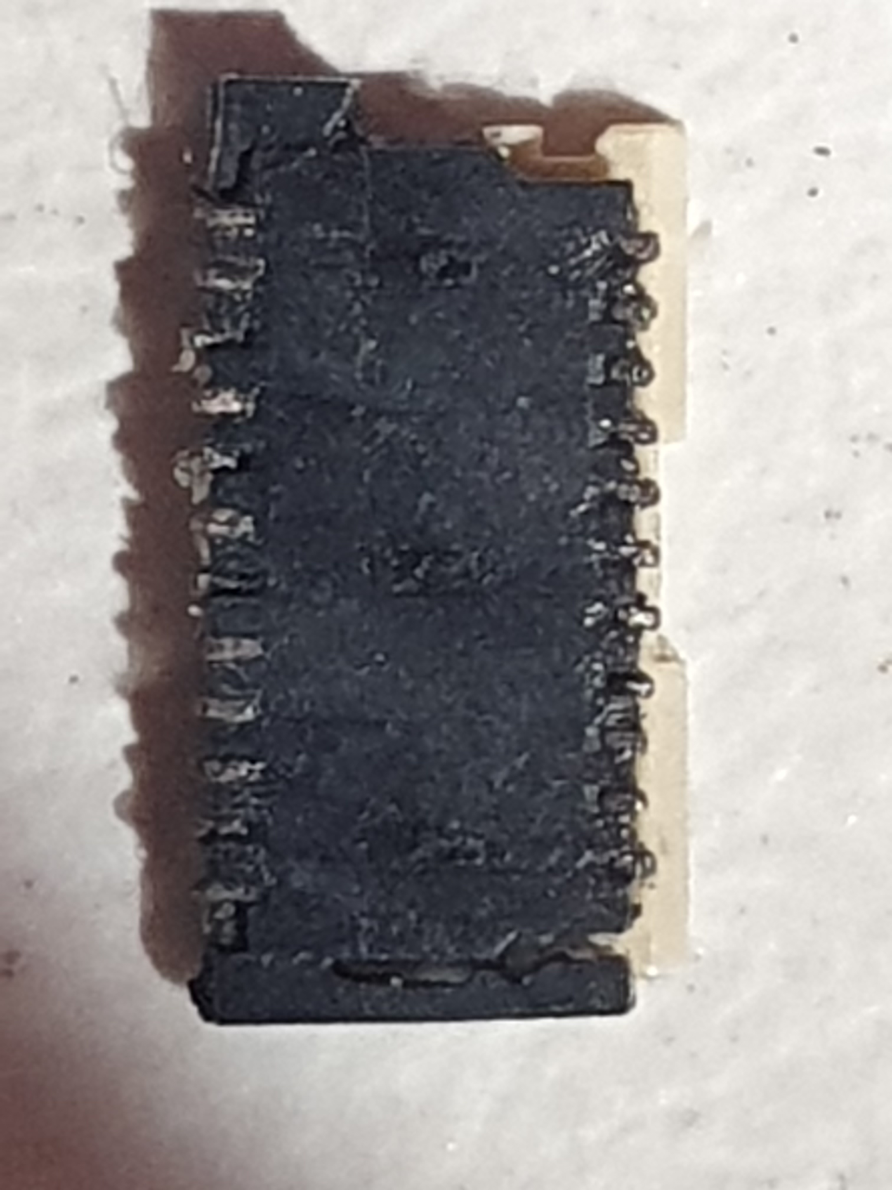

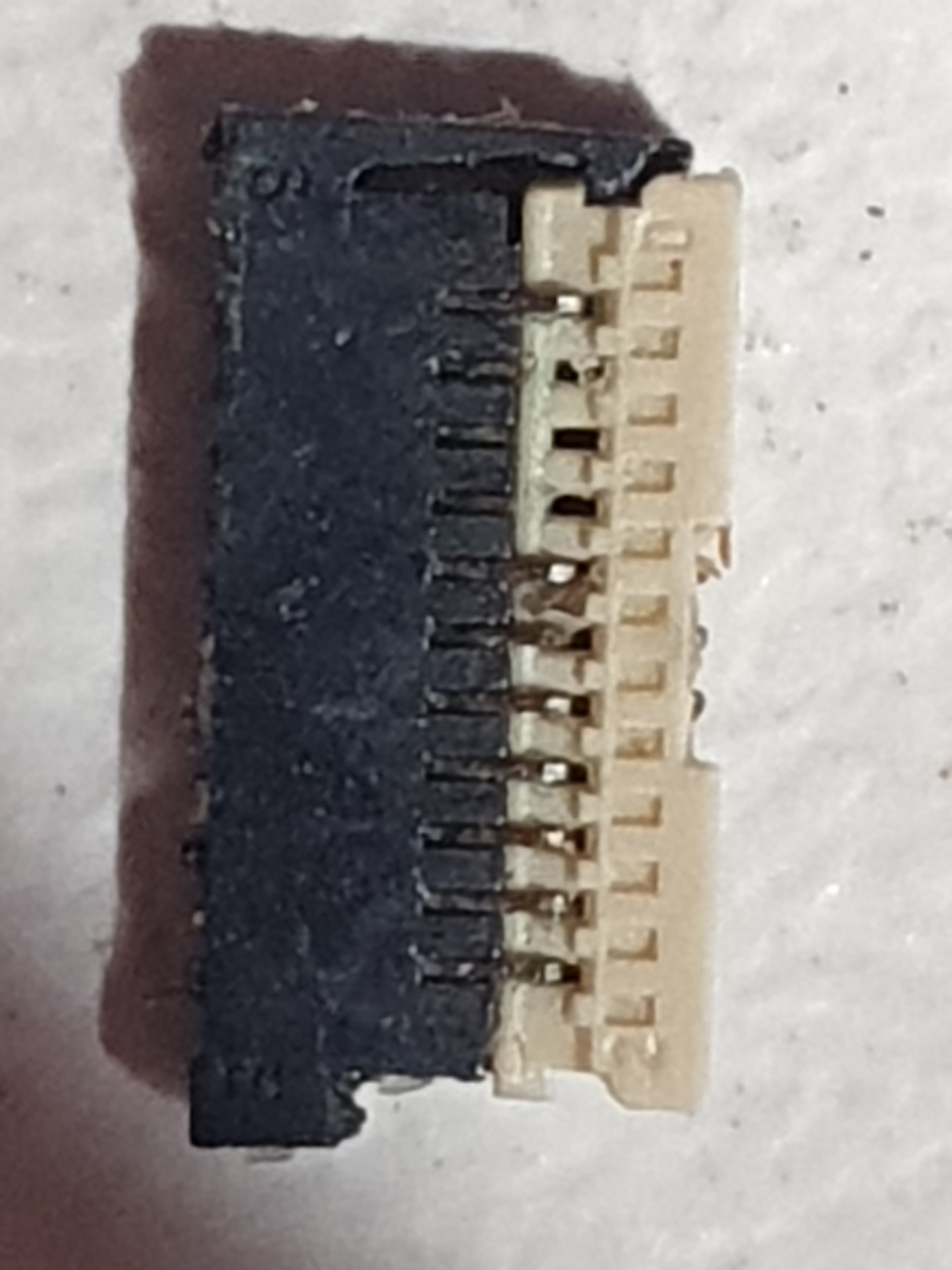

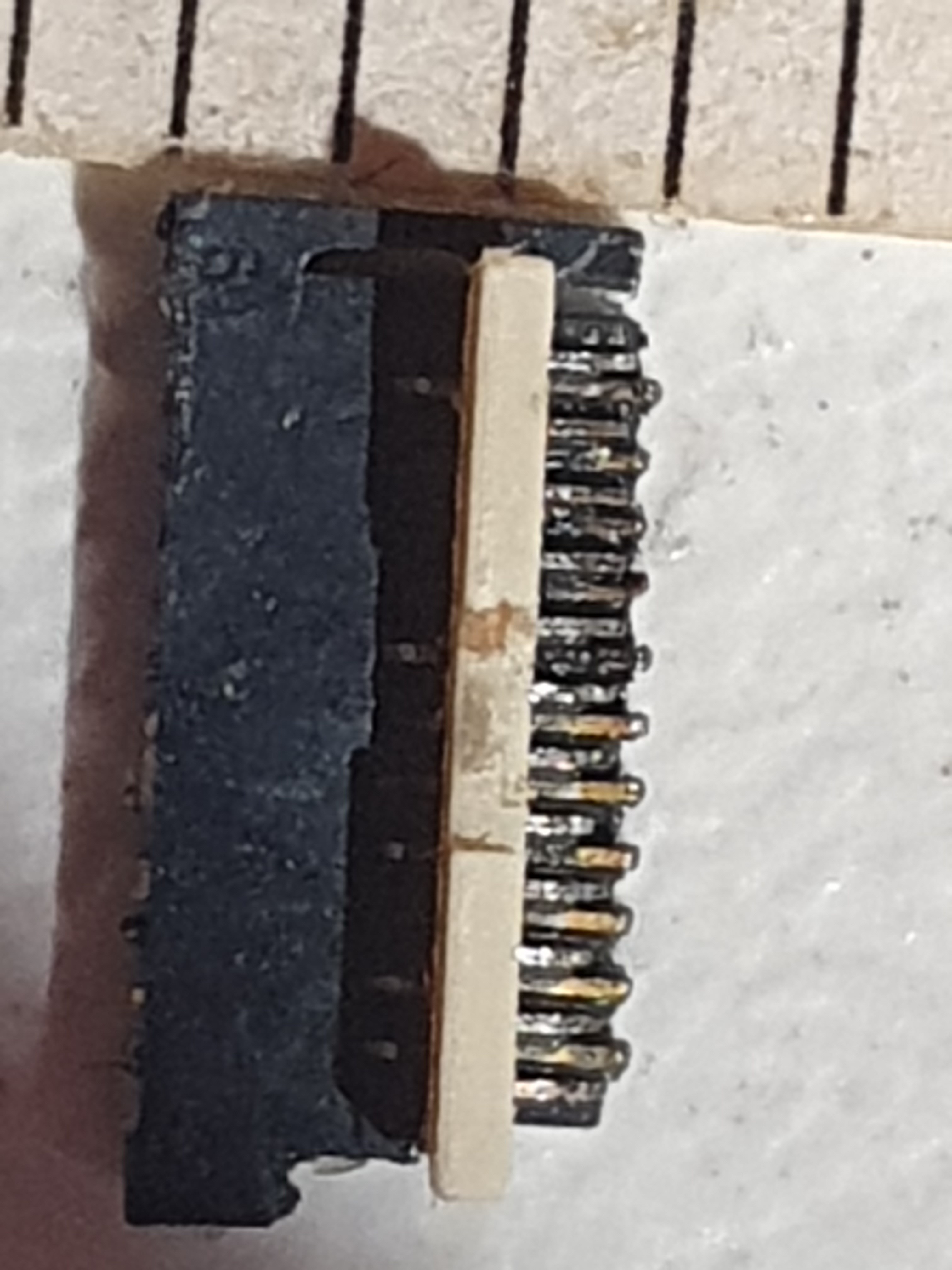

    Hello, I search this connector (oxydated).
    It's a fpc zif low profile connector. It come from camera sensor, it is very small : 0.3mm between 2 pins.
    I ordered 2 from Aliexpress called « 0.3mm pitch » but one was 0.5mm between 2 pins and the other 0.6mm. In fact « 0.3mm pitch » seams to be the pad width and not the distance between 2 pins.
    I can't find it. The other websites like mouser dont show the datasheet, and I can't check if it is 0.3mm between 2 pins ?
    Do you know how to find this connector please ? What is the exact name for find it ?

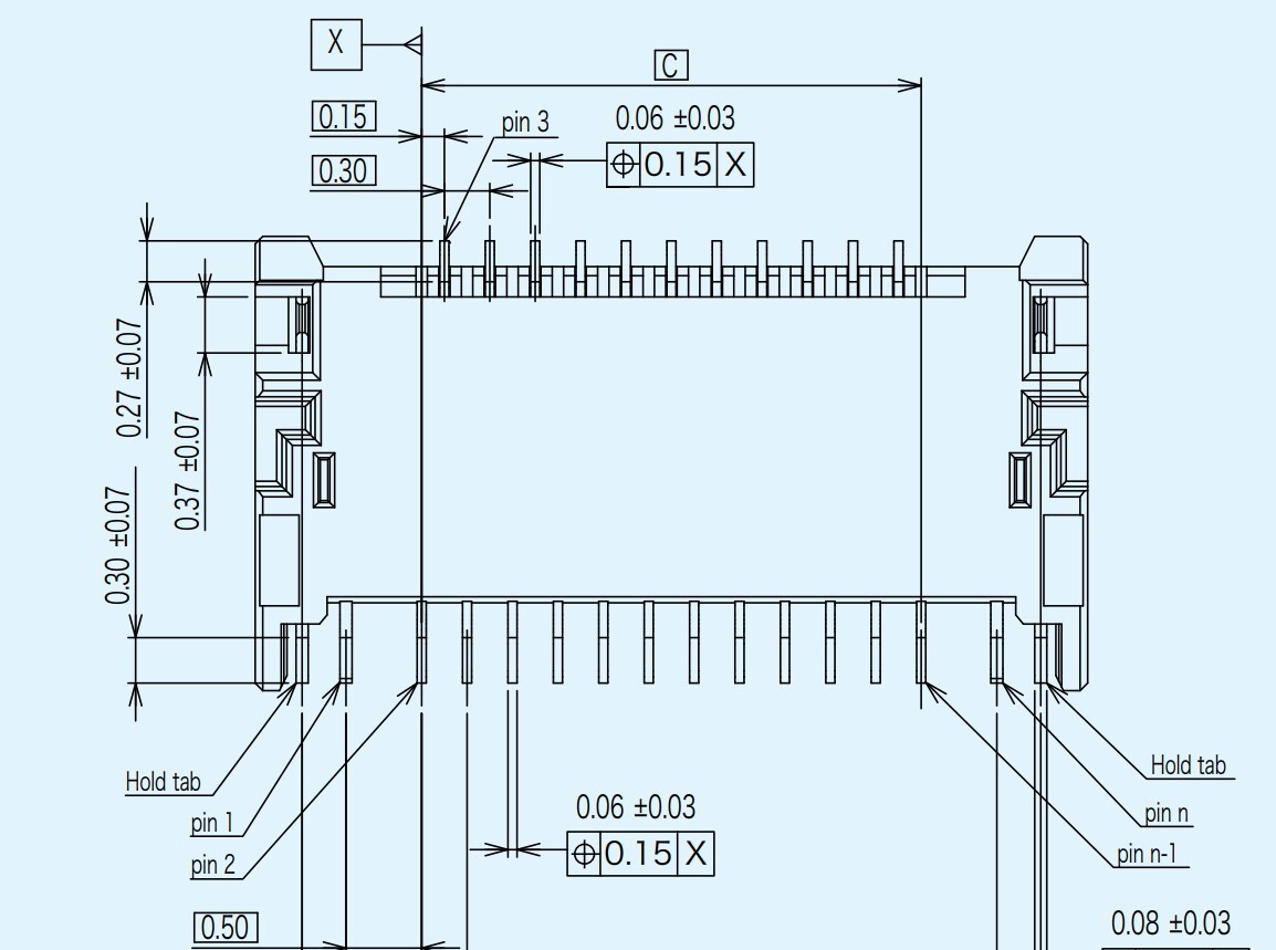

          In fact, for 0.3mm between 2 pins, the specs must be « 0.15mm pitch »
          If you read : « 0.3mm pitch », that means there is 0.6mm between 2 pins.
          I found only one connector with those specs (0.3mm between 2 pins) on the web, it call « FFA1W series » from Fujikura (see the picture in attachment)
          Datasheet :
          https://www.onlinecomponents.com/en/...ab3h-58089340/
          But it can't be found on the web. Maybe manufacturers has reached a small size limit for this model, and maybe the smartphone connectors model are strongers. That could explain why only one manufacturer made it ?

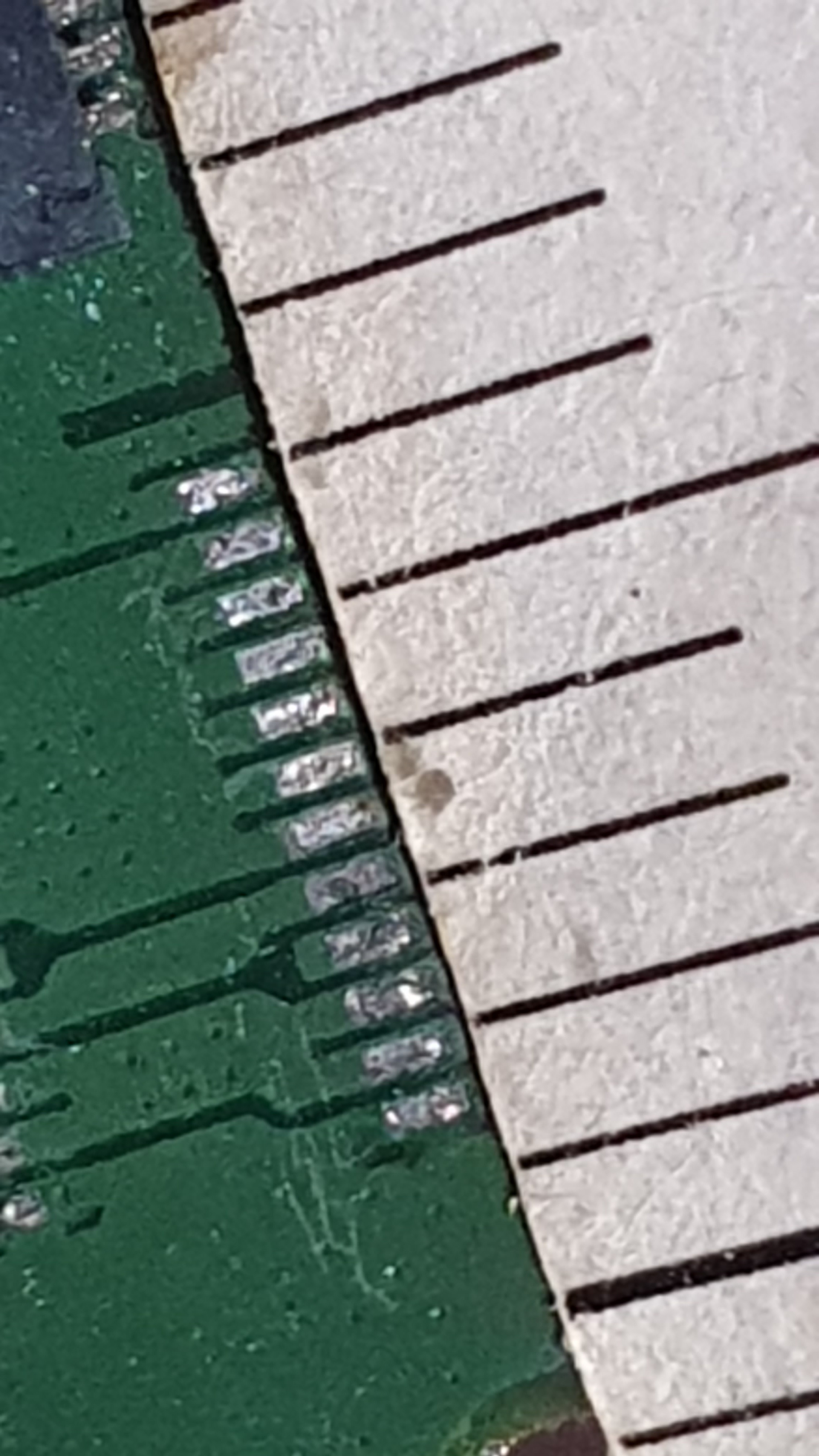

              Indeed if you mesure between 2 alternate pins on connector, you found : 0.15mm. And when you mesure between 2 tracks on the ribbon cable, it is the same : 0.15mm.
              The key is this number : 0.15mm. But it is very difficult to find. On Digikey or Mouser website, when you search fpc connectors, it show « 0.20mm pitch or under » but in the list nothing under 0.20.
