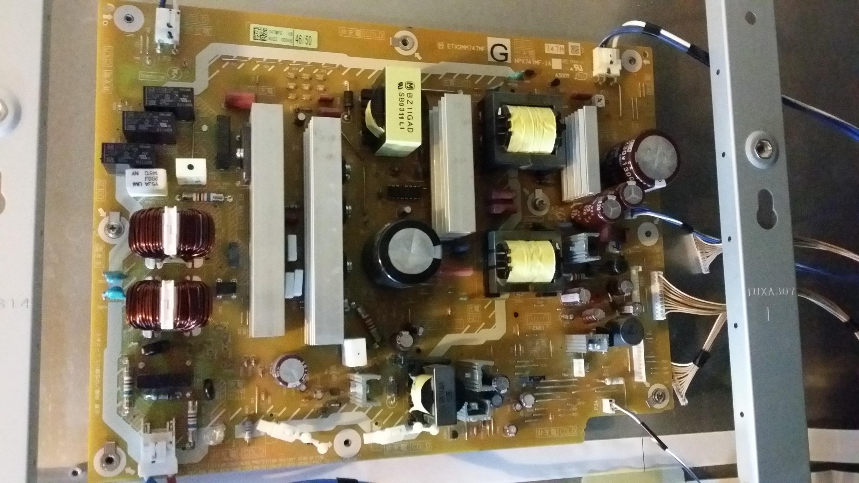

    Hi All
    After following instructions on flow chart Kindly supplied by TW2005 no relays clicking disconnected plugs as instructed and checked volts at pins on plugs p7 and a6 it advices to replace P board.
    What i was wandering was there any known faults on this board that may now have been discovered or do you have to replace these boards still ?

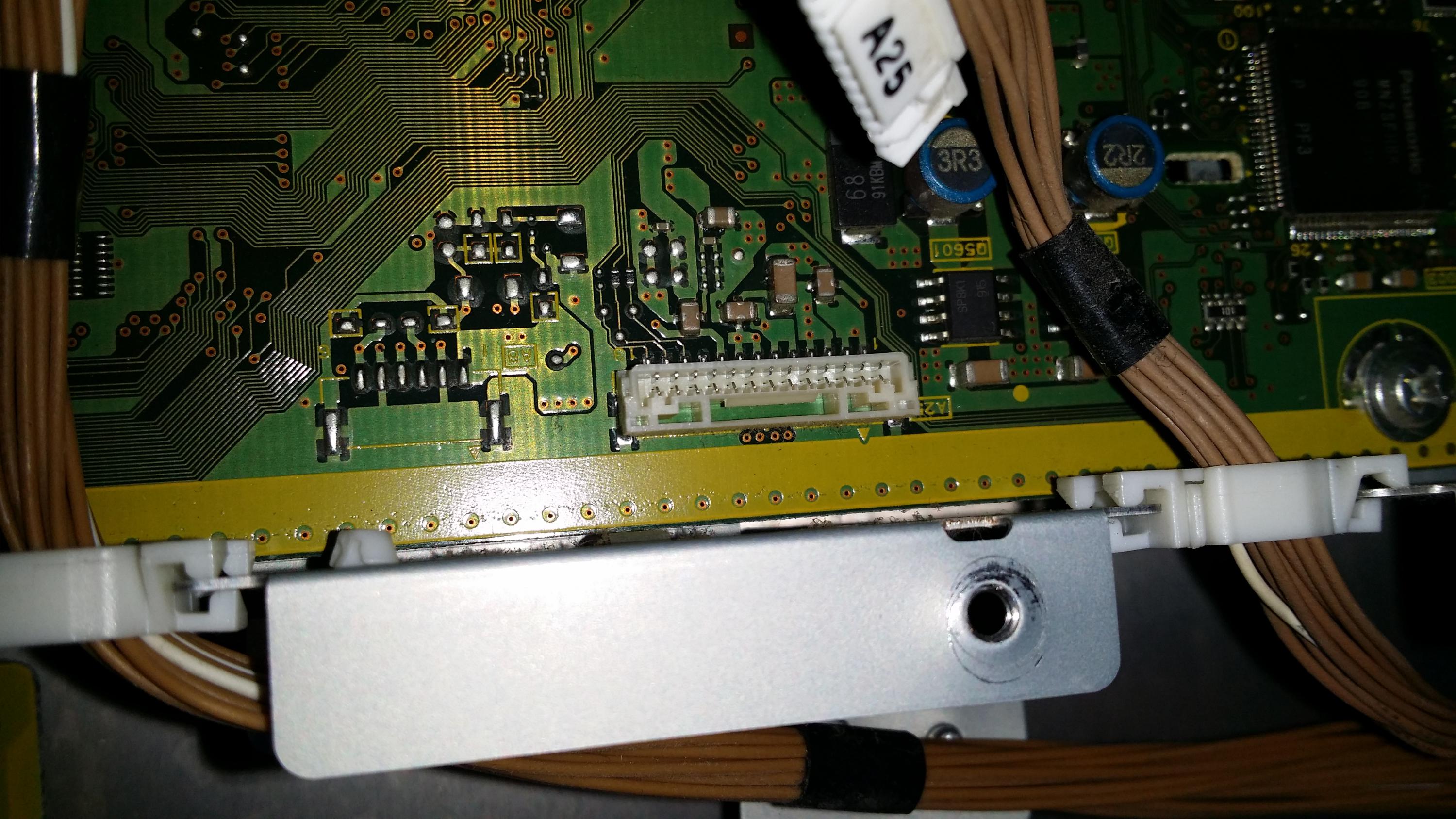

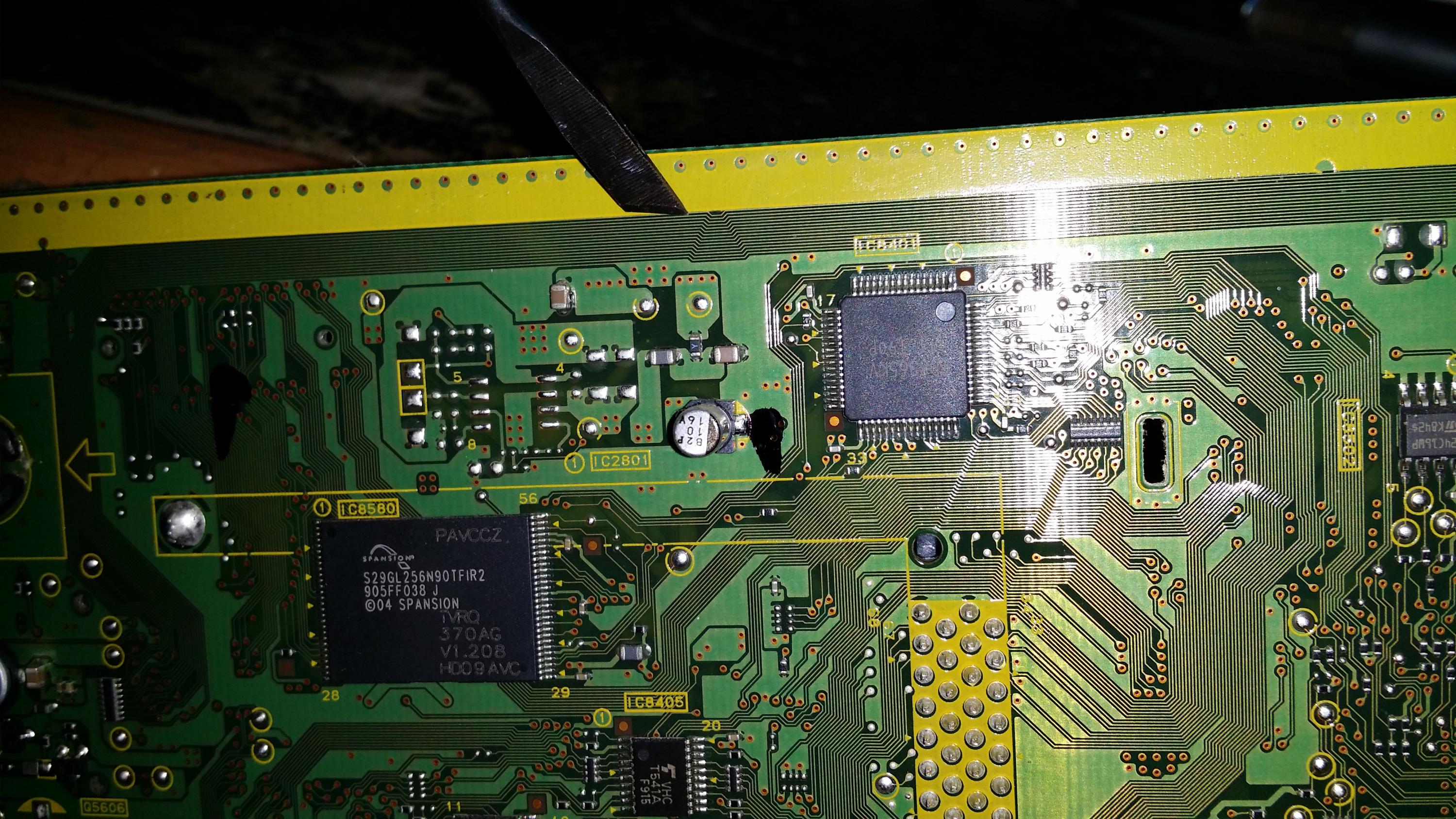

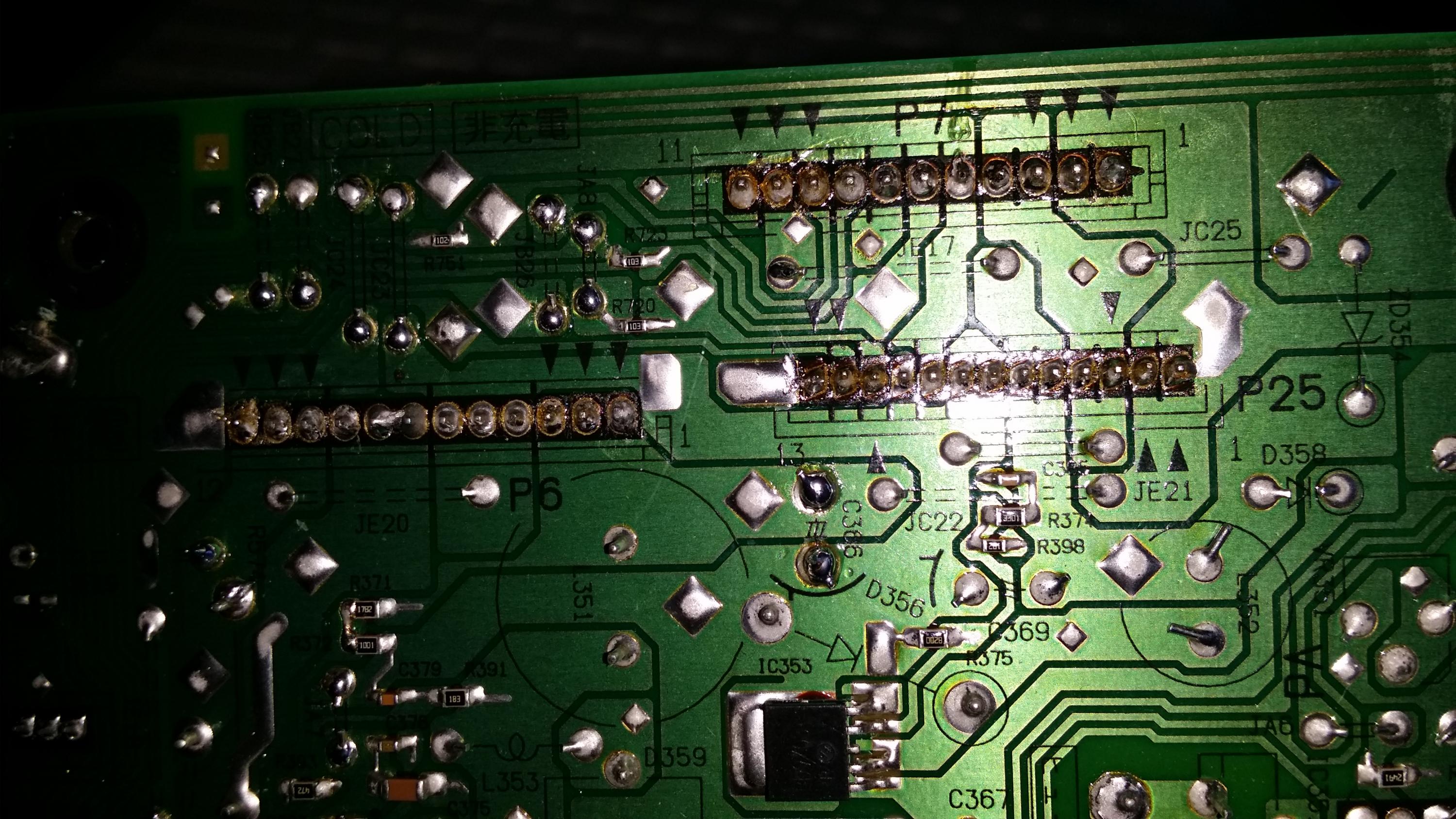

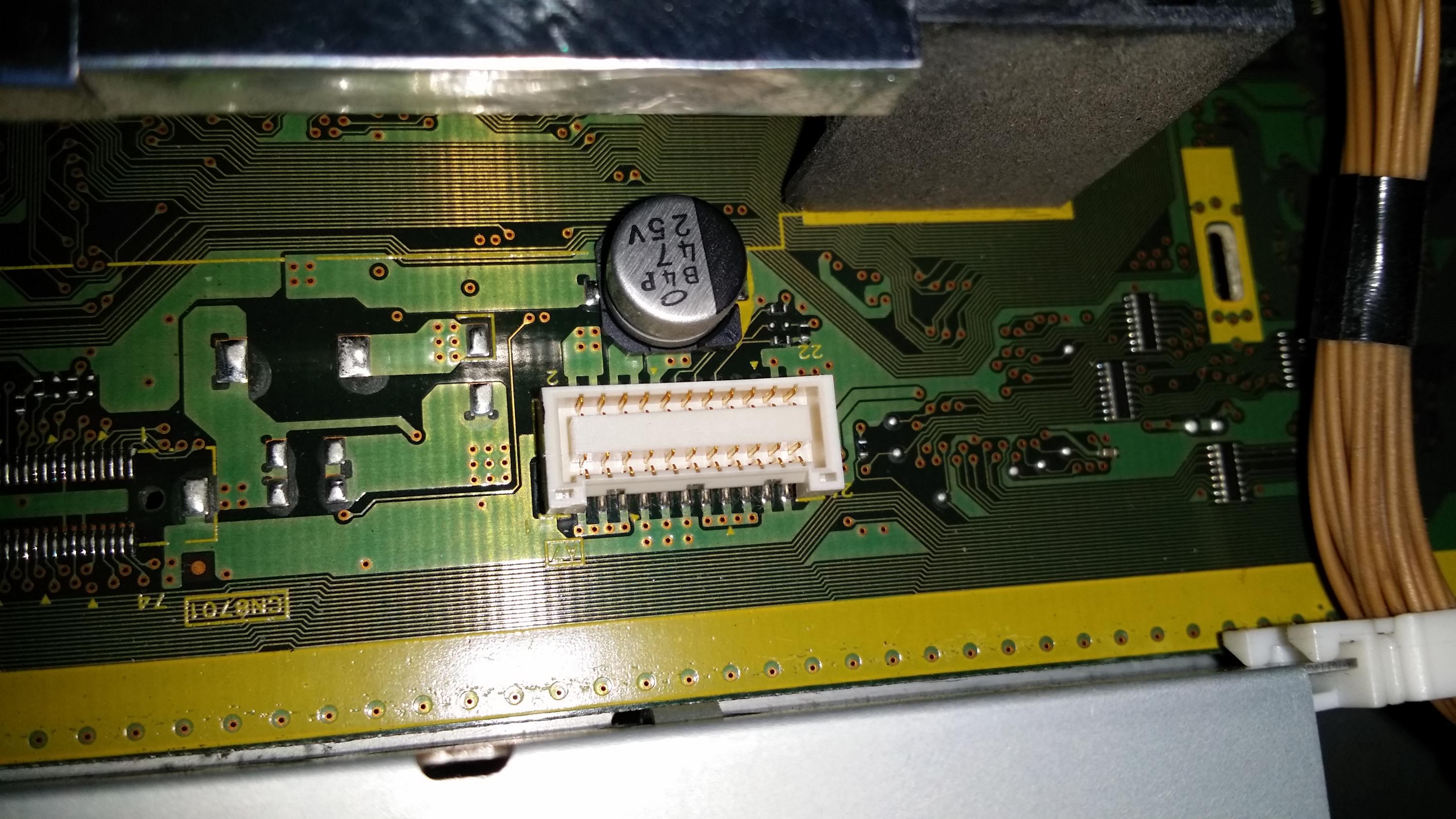

                      Please post a photograph of the the area with the two connectors to the right. There should be a description of each pin printed on top or bottom of the PCB.

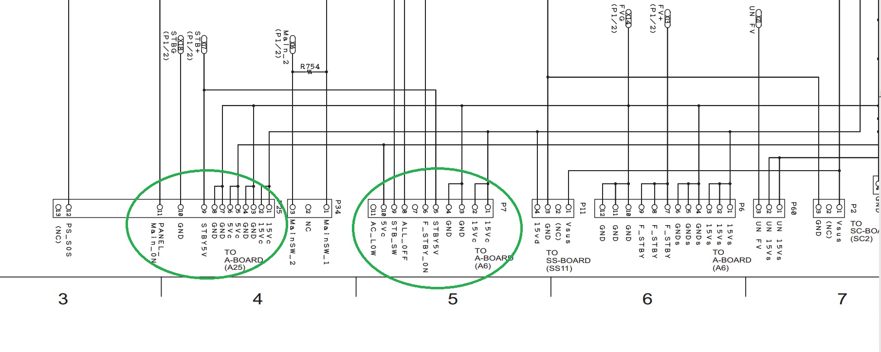

                      Is this your chassis? http://elektrotanya.com/panasonic_tc.../download.html

                        In my previous post there is a link to document containing the schematic of the PSU as well. You can't have it any better than that. It's supposed to be the ETX2MM747MFG.

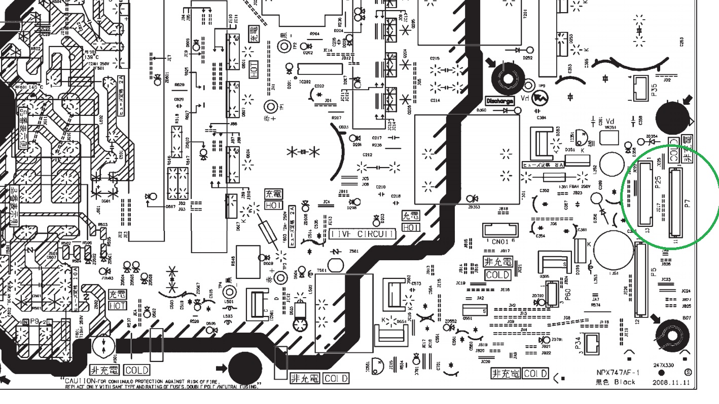

                        I attached two pictures of the connectors where you should measure the signals.
                        Measure all the signals on P7 and P25 while the set is in standby and while you try to turn it on. It's important to post any changes that the signals show, like first it's 0V, then after 2sec it's 5V etc.

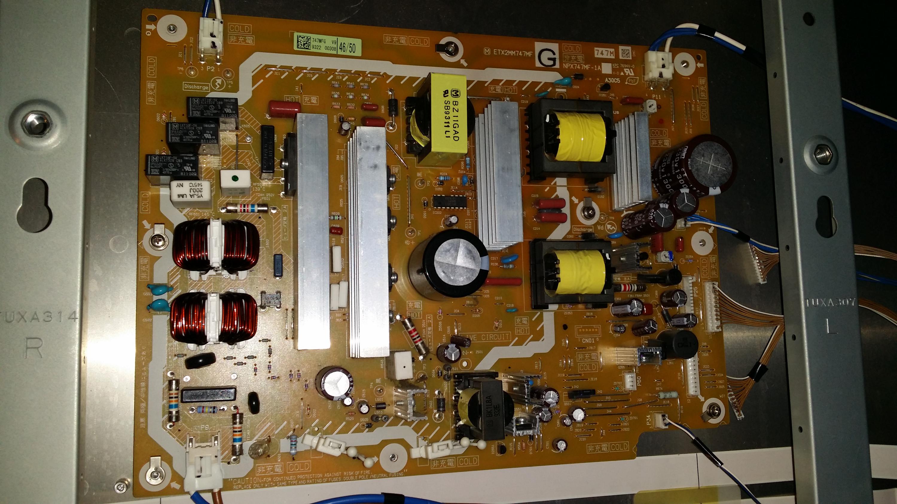

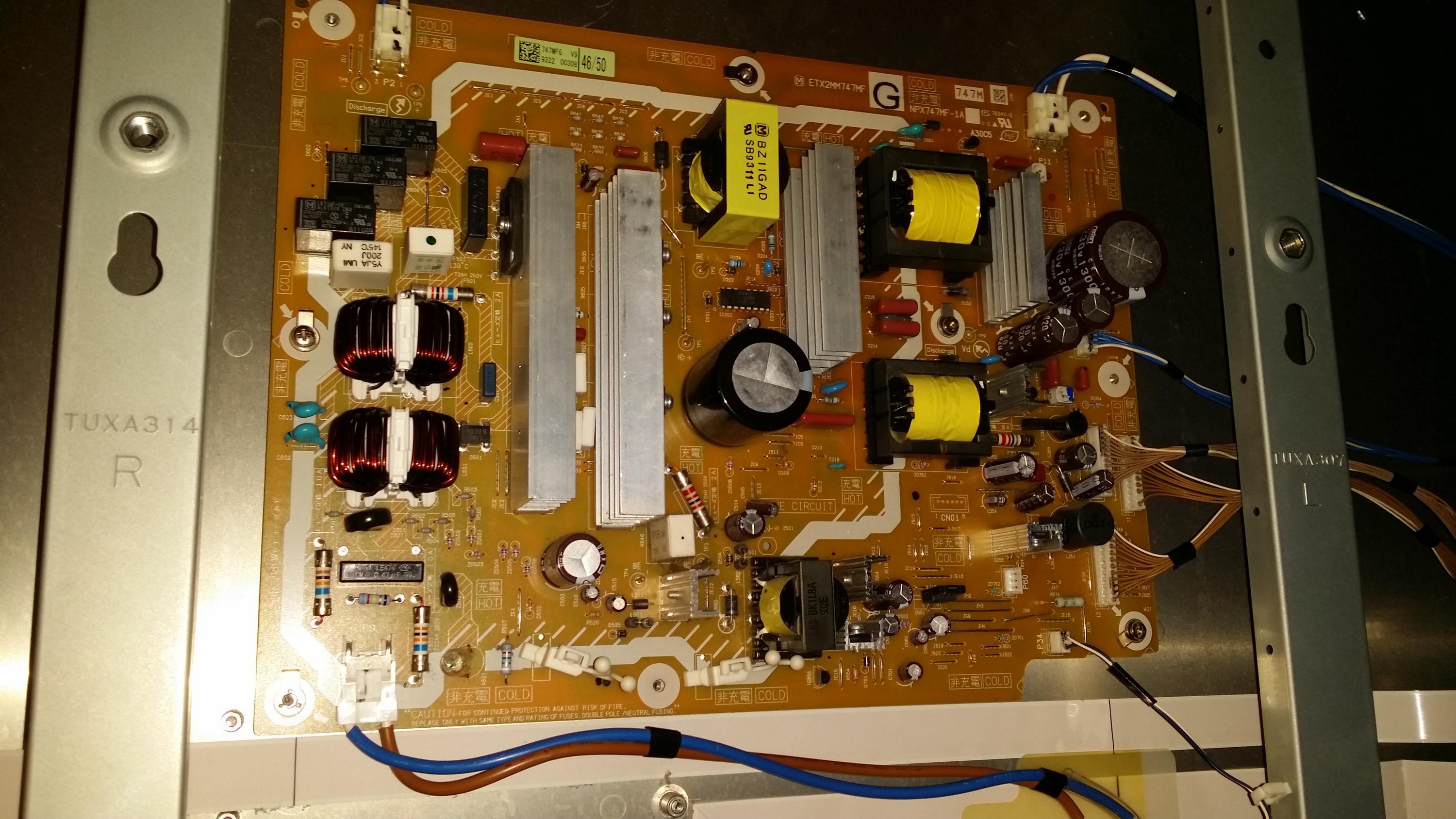

                          Hi Paul
                          Yes on the P board it is marked ETX2MM747MF and large letter G on white label just at the end of board number.

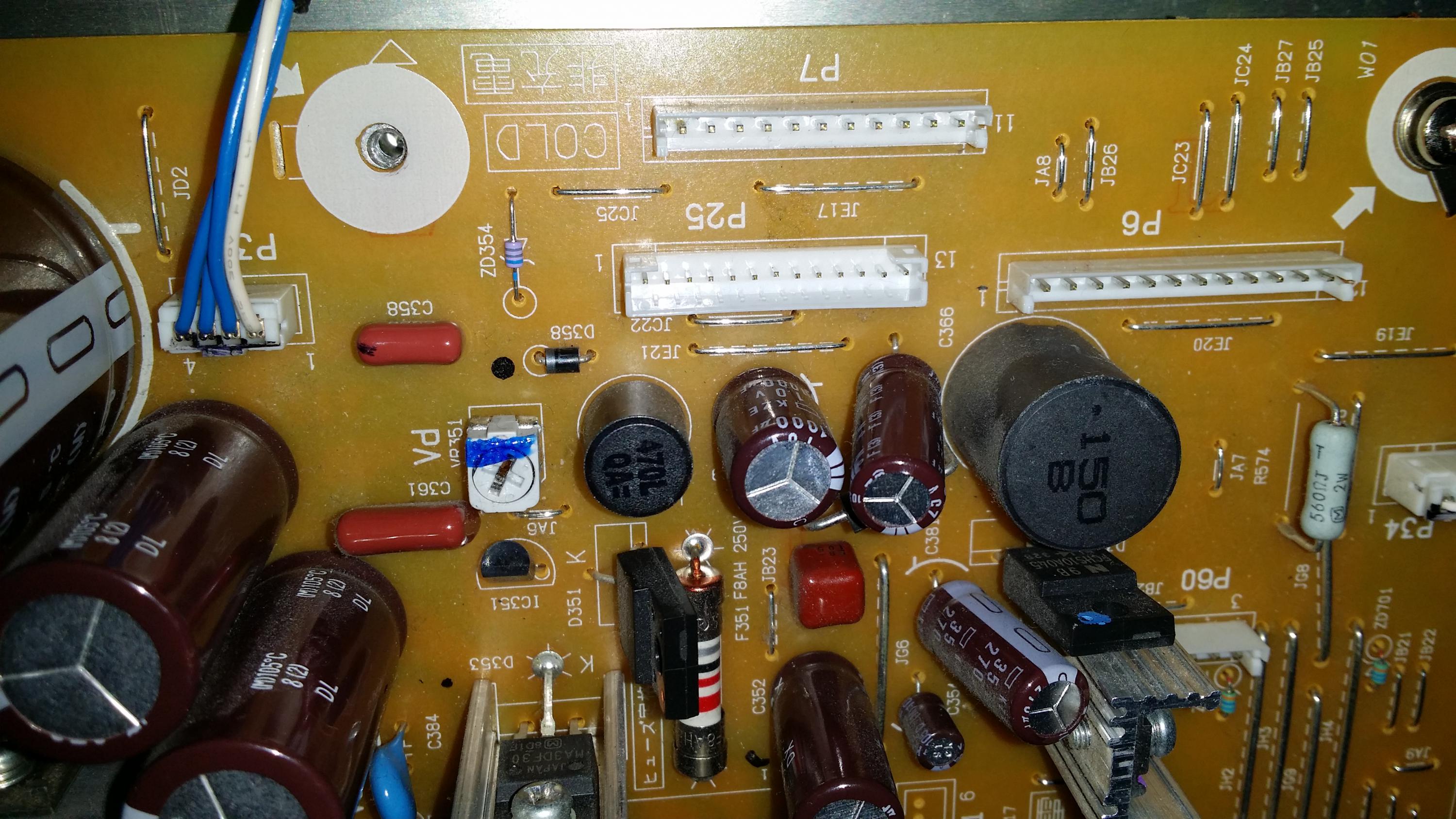

                          I have added pictures as you asked but no description on boards as you can see.

                            Hi Paulstef
                            I see what you are advising but when the P board is connected it is not possible to take measurements from these points as the solder point is under the board ( I would need to solder extension pins on so i could measure in situ) would that be the way you would go?
                            or take the measurements on the A board as it is possible on that board but would have to track each wire to each pin ?
                            Also in the schematics it quotes to A6 and A25 but on my A board the plugs are marked up A7 and A25 but i assume A7 is A6?
                              Re: panasonic tx-p50s10b
                              You should be able to measure directly on the connector from above, where the wire was crimped to the terminal.
                              If your probe doesn't enter use an alligator clip with a rigid wire attached to it.

                                I have measured volts on connectors P 7 and P 25 volts as follows:-
                                P 7 = PINS 1,2,3,4,6,7,10,11= 0V STBY press button wait 2 seconds or more still 0v pin 5 STBY 0v press button 4.73v pin 8 0v STBY press button 2.84v for one second then 0v pin 9 STBY 0v press button 4.70v.
                                P 25 = pins 1,2,3,4,5,6,7,8,10,11,12,13 =0V STBY press button wait 2 seconds still 0v pin 9 = 0v STBY press button 4.73v

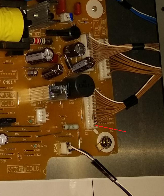

                                    The microcontroller obviously runs since the standby on button works, presumably connected to P34, right?
                                    It enables then STBY5V on P25/pin9 and P7/pin5. The mainboard is then supposed to send PANEL_Main_ON and F_STBY_ON, which it doesn't.

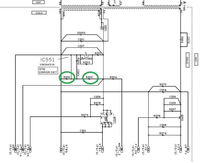

                                    It looks more like a A-board fault but I would still verify if the 5V standby voltage (or VDD at pin6 of IC701) is really supposed to be 4.73V.
                                    For this you need to tell us the values of R556 and R555 next to IC551. This determines the output voltage.
