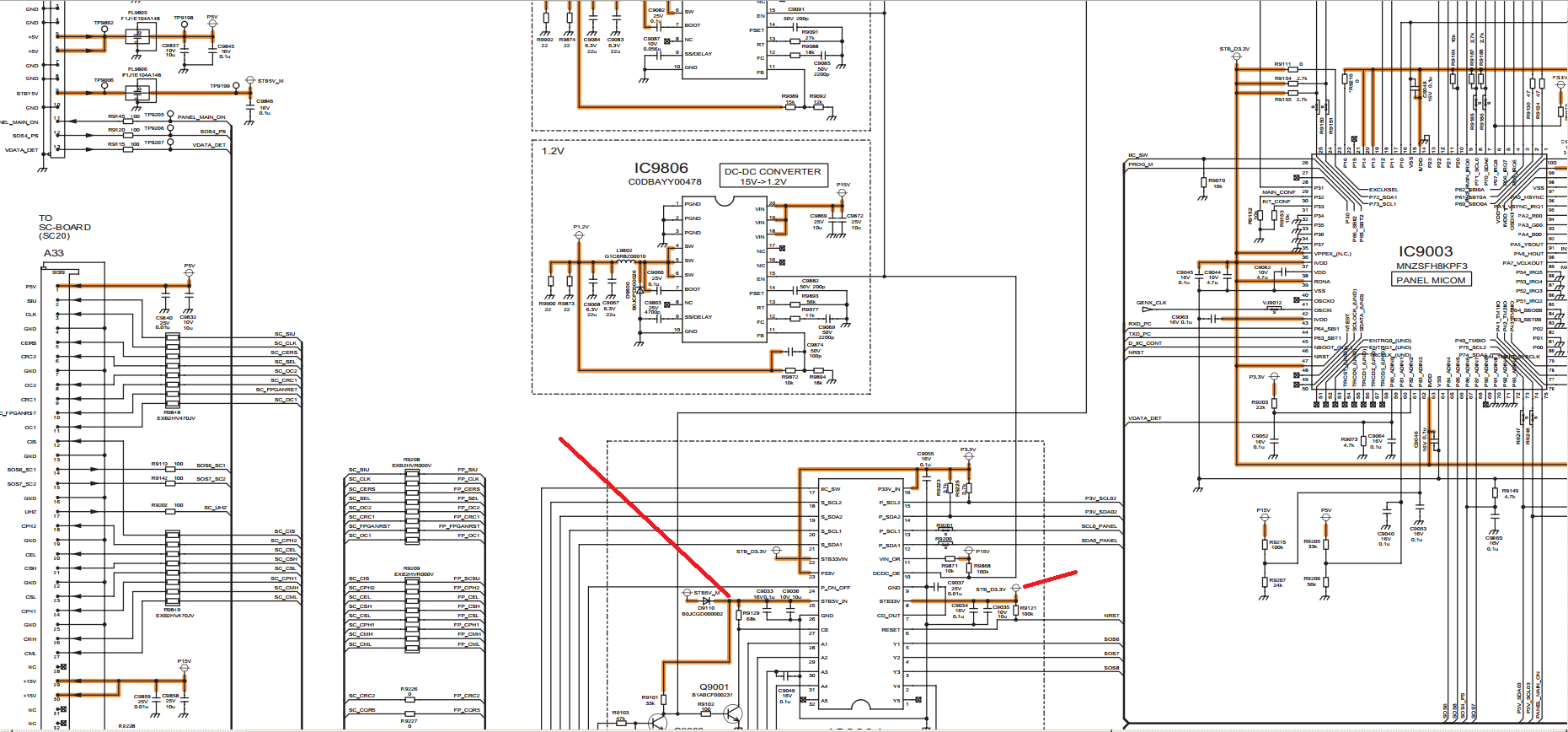

            #65
            Re: panasonic tx-p50s10b
            Well it looks like your PSU is working then...
            I'd continue on the A-board. The PANEL_MAIN_ON signal for example comes from IC9003. (the other signal going to P7 pin 6 comes from IC1100 on the A-board)
            Both these ICs need a 3.3V power supply.
            Can you measure the two points marked in the attached schematic?
            After the diode it should read around 4.6V and the other one 3.3V.

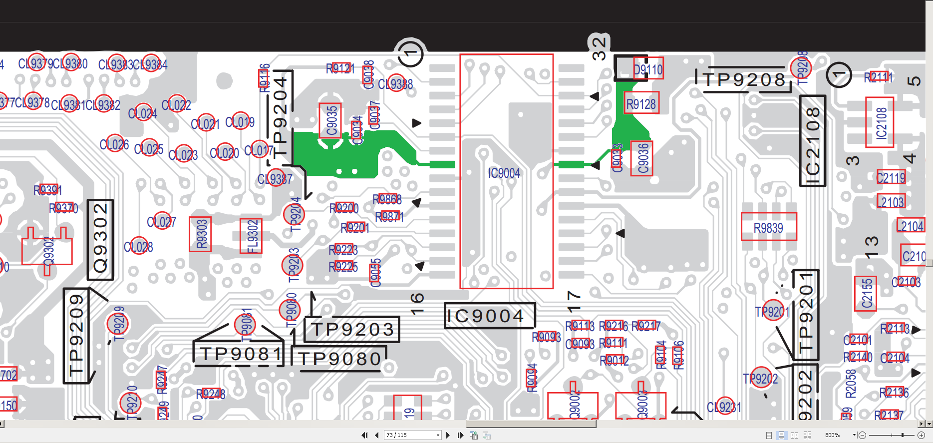

                                      • paulstef
                                        • Dec 2013
                                        • 724
                                        #79
                                        I marked them here, it's the two green traces. They are on the bottom side of this board.
                                        • ronhayes
                                          TV Engineer
                                          • Mar 2014
                                          • 458
                                          #80
                                          Paul
                                          I am getting 4.98v for the 4.6v but i am getting 0v for the 3.3v ?
