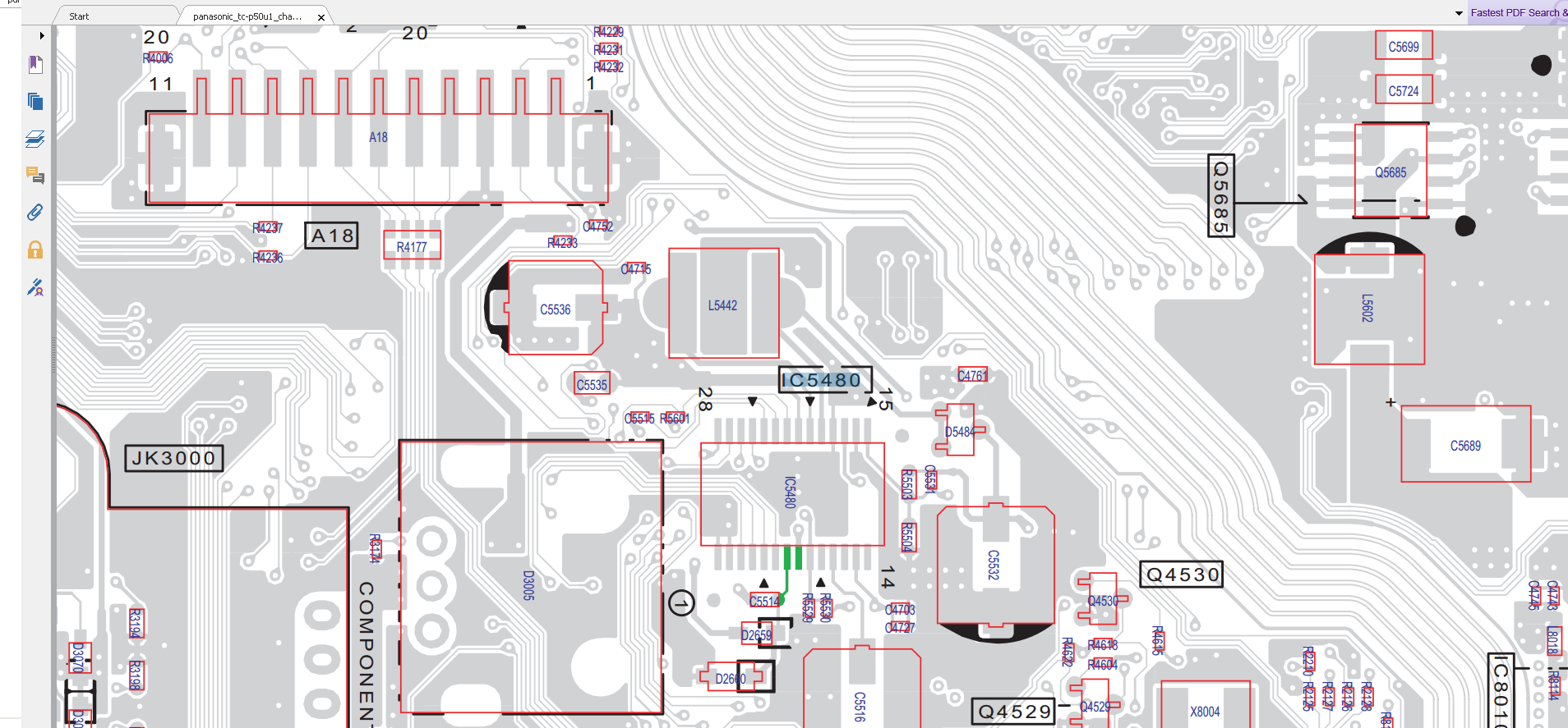

    The uCs need 3.3V. If they don't have it they won't do anything.
    Checking the schematic....
    In the meantime you could power off everything and see if you have a short from this 3.3V line to GND.

      Mmh, ok, THIS 3.3V is switched. The signal to turn it on comes from another uC.
      We need to check first IC5480 input and output voltage.

            Sorry Paul
            This IC was on the other side of the board.
            I am getting 4.25v on pin 7 and 0.24v on pin 8 of IC 5408.

              Measure resistance from pin 8 to gnd (turn off power before).
              This chip, according to the block diagram on page 30, should create 3.3V from the 5V standby voltage. It doesn't so it's possibly either defective or there is too much load on the 3.3V output.
              It also does some other stuff and I don't know if any wrong signal or shorts or anything on the other pins could affect the 3.3V regulator.

                It is 03.3 in the 200 range checked with two different meters both reading the same.

                  You mean 3.3Ohm on the 3.3V output pin 8 to ground? That's too low. Ideally we would now try to isolate the pin. :-D
                  You see that from pin 8 there is one trace going underneath the chip and goes then to a via to the other side of the board (unless it's a multilayer board, I don't hope so). Obviously you cannot cut a trace on this side. So you need to find the same via on the other side and then there is hopefully only one trace going from that via. That trace you would need to cut. Pin 8 is then isolated and you can you determine if the 3.3Ohm comes from the chip itself or from somewhere else.
                  Actually not difficult.

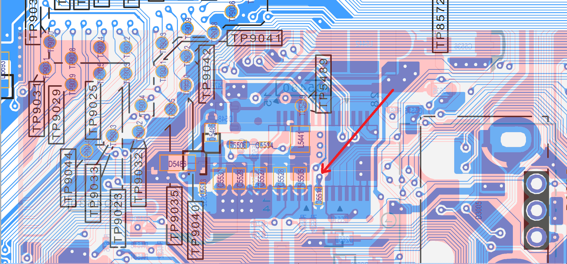

                            We could at least try to find out if it's this chip or not. Because if it's not than online troubleshooting will be become so difficult you are really better of buying a new board.
                            I've seen that IC for just a few dollars somewhere, have to find the link.
                            I'll try to find that trace on the other side for you...

                              Bad news. It's definitely a multi-layer board. The trace goes from pin 8 of IC5480 underneath the chip and to a via. The same via is connected to C5513 on the other side nowhere else. That means ST3.3V must be distributed on an inner layer.
                              Since you said your eyes aren't that good anymore I assume you don't want to try slightly lifting pin 8 from the board, right. :-)
                              There are some other things we could try but I think it's getting more complicated now.

                                Just out of curiosity i thought i would have a go at lifting that leg using a needle and fine tip soldering iron and i managed to lift it ?

                                  First I would remove the solder from that pin with solder wick. Then yes you could use a needle and slightly forcing it up while heating the pin/pad.
                                  Don't lift it up too much otherwise you may break the pin when pulling it down again.
                                  You should then be able to measure resistance again and determine where the 3.3Ohm come from.

                                    I have checked it and the it appears the 3,30 ohm is from the track and not the 8 leg but it is a slight difference now it is reading 3.10 ohm as apposed to 3.30 ohm.
