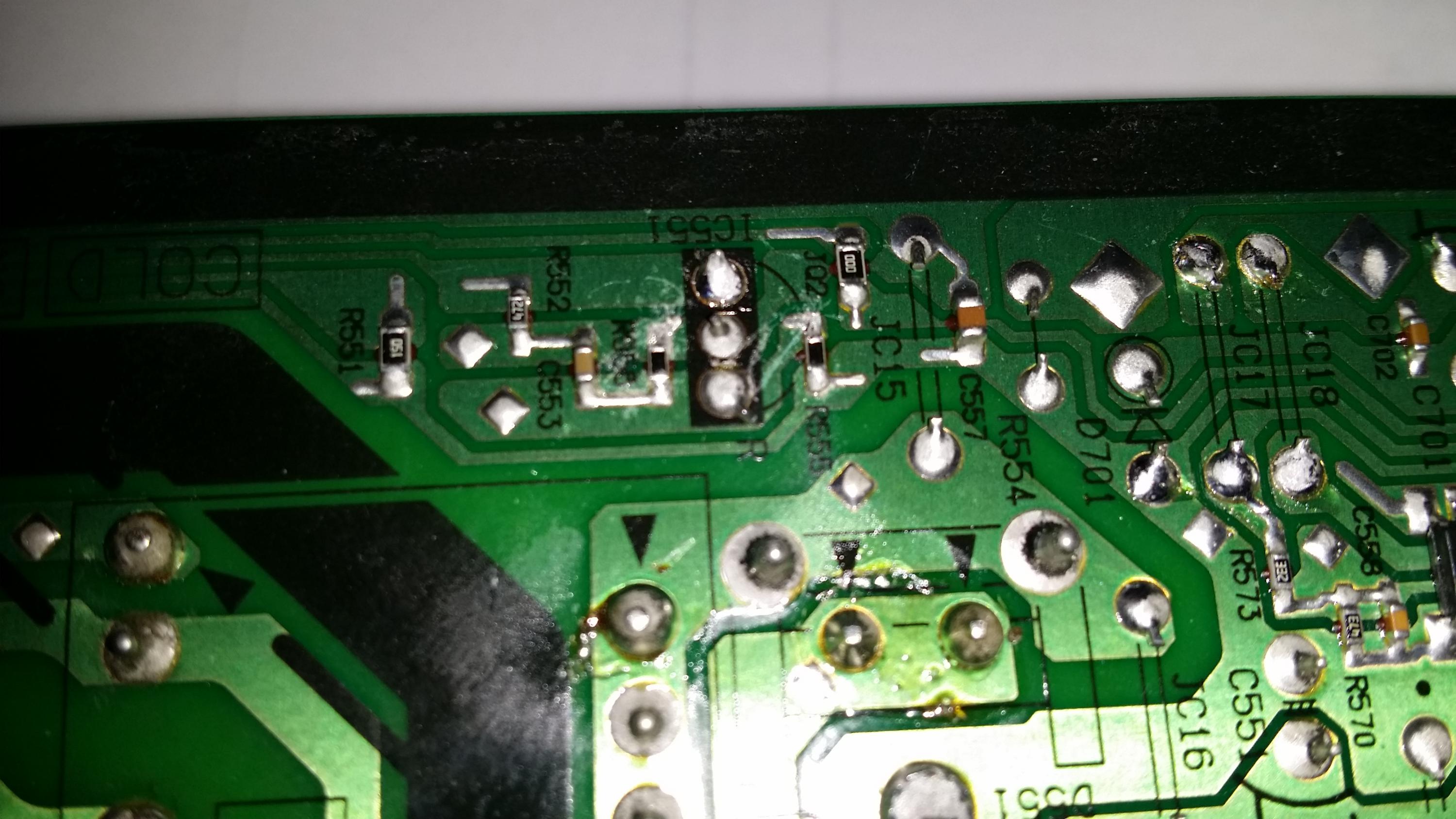

            Re: panasonic tx-p50s10b
            Hi Paul/Tom
            Thank you both for all your help with this set i feel i am getting close now to finding the fault.
            Just a couple of questions that i hope you can help me with ?
            Paul i am attaching a picture of ic551 on track side so you can see R555 and R556 and as you will see these are smaller than all the other smr resisters and you should be able to see from the picture there is no markings on them?
            Also Tom you say to measure the voltages at these resisters to see if their is a voltage of 2.945v this would be quite difficult while board is in situ unless i were to solder fly leads to them or take measurements from legs of ic551 on component side ?
            Also would taking measurements while set is powered up could this cause any damage elsewhere or would i have to connect set through an isolating transformer?
            And do i take measurements in stby and while pressing power button?
            Any more help would be much appreciated.
            • vinceroger69
              • Mar 2012
              • 6714
              • uk
              Maybe just the picture but jc15/ jc17 /jc18 solder joints looks iffy? maybe worth re soldering.

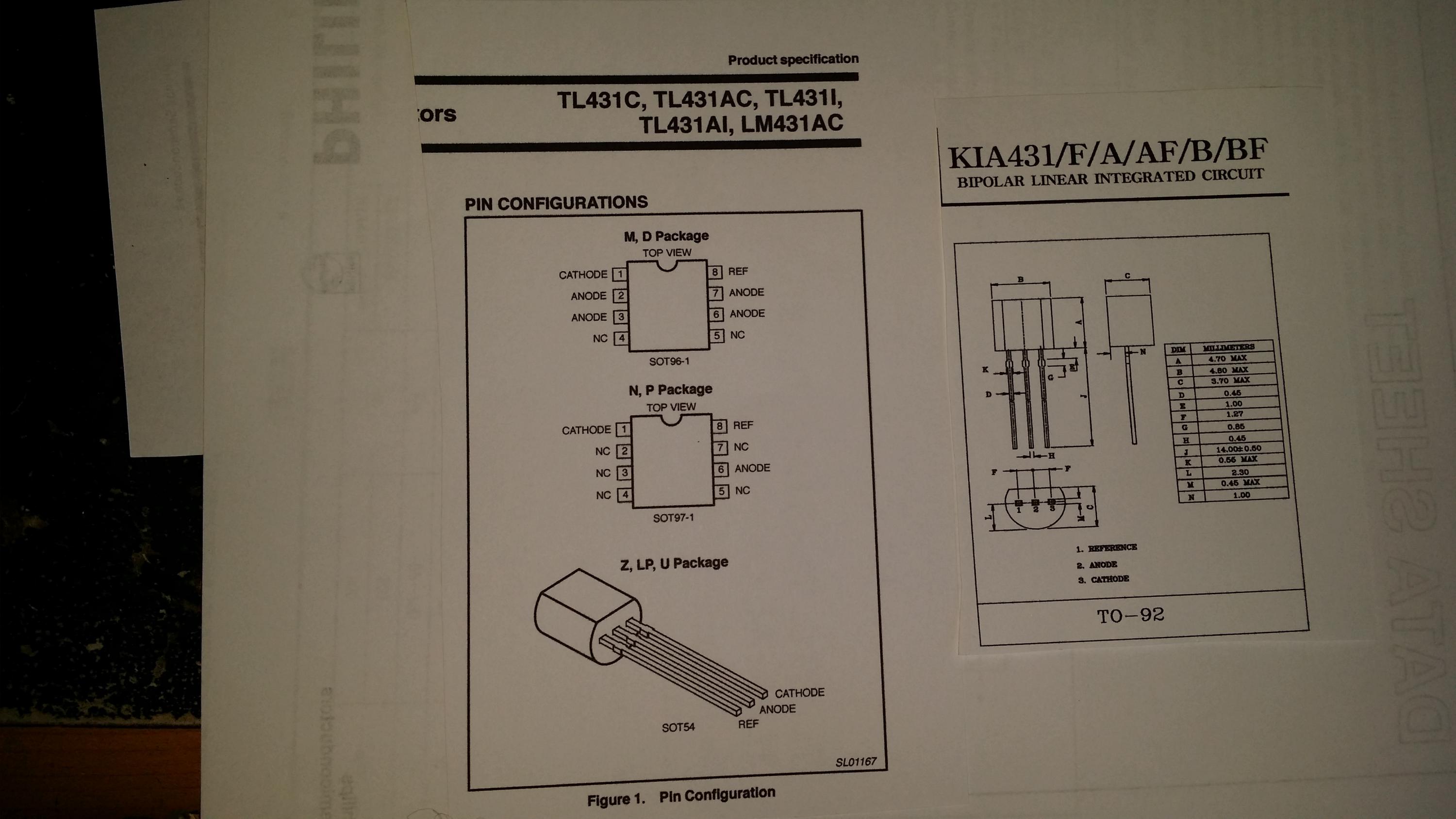

                          #32
                          Thank you tom
                          The IC551 has the markings KIA 431A 907 I have located a similar IC in another power board its marking are TL431C yo4o
                          Would this be compatible?
                            #33
                            Originally posted by paulstef
                            Yes, that's weird. If the reference pin is at 2.8V than the STB voltage should be way higher than 5V.
                            I have not yet seen it with TL431, but I have seen other devices with feedback pins that became leaky wrt to the supply as well as ground, i.e. current getting injected into the REF node, this could cause REF to rise, which would cause the power supply to reduce duty cycle too early. (Opto-coupler current would be injected into the REF node in this instance.)
                            • paulstef
                              • Dec 2013
                              • 724
                              #34
                              Originally posted by ronhayes
                              Thank you tom
                              Yes, take anything with a 431 on it (not 2431)
                              They are very common in feedback loops.
                                #35
                                Thank you tom
                                I think TL431C has a reversed pin out. (See datasheet) This will work but you will have to install it in reverse. In any instance, when testing it, disconnect all loads from the power supply, such as the main board. This will ensure in case the TL431 is installed backwards, higher output voltage cannot damage anything.
                                • paulstef
                                  • Dec 2013
                                  • 724
                                  #36
                                  Yes, needs verifying but seems to be the same pinout to me. TI shows top view, KEC bottom view... (I think)

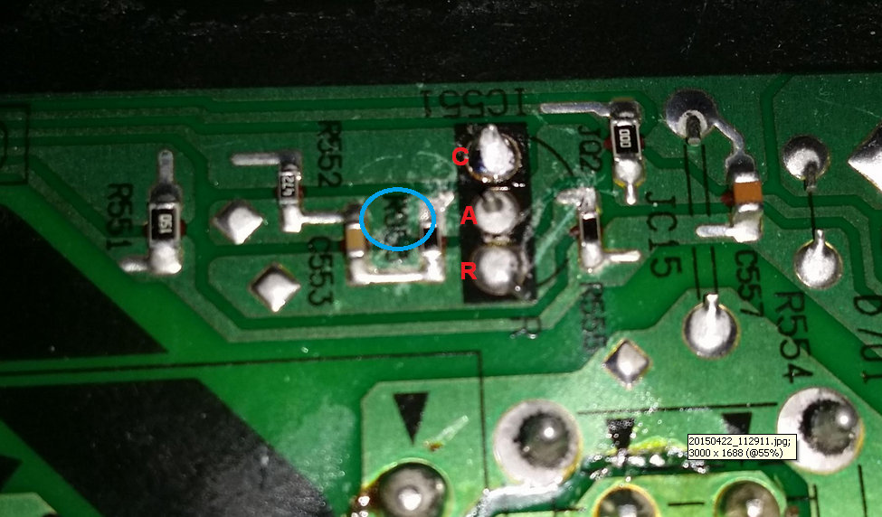

                                  • paulstef
                                    • Dec 2013
                                    • 724
                                    #37
                                    I marked the pinout on the PCB.
                                    Question: Somebody scratched around on this board. Where the blue circle is are these two traces connected?
                                    You may also measure if C553 is shorted. (I don't think so though)

                                      #38
                                      Hi Tom/Paul
                                      I have checked the data on both these shunt regulators and included a picture showing them side by side and from what i can see the pin orientation are the same ? would you mind looking to confirm this please.
                                      Also Paul i have checked the two traces not connected ! I also checked the schematics for c553 and it does not give value only slate plate capacitor ?
                                      Would hand held capacitor meter measure this and in what range ?
                                      • paulstef
                                        • Dec 2013
                                        • 724
                                        #39
                                        As for the pinout I included a pic in my previous post. Yes they look the same, only the KEC seems to show it from the bottom (thanks for not indicating it, KEC)
                                        The traces should not be connected, that's ok then.
                                        Only do a Ohmmeter test on the cap. I don't believe it's shorted but I would test it nevertheless.
