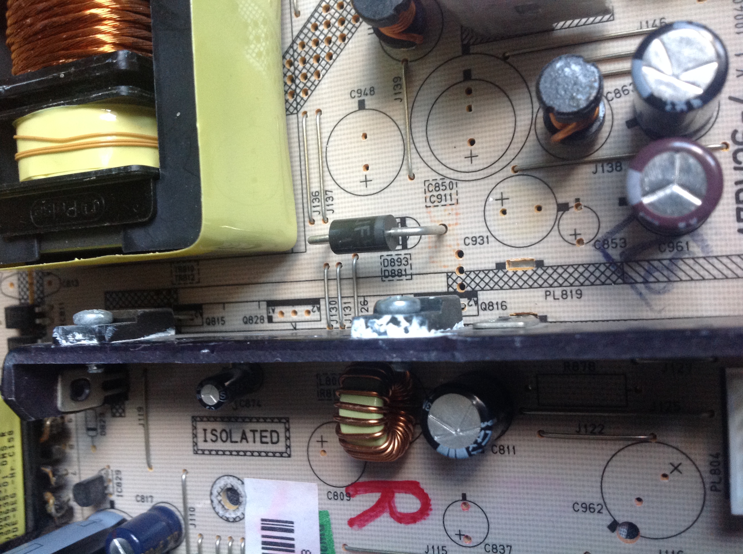

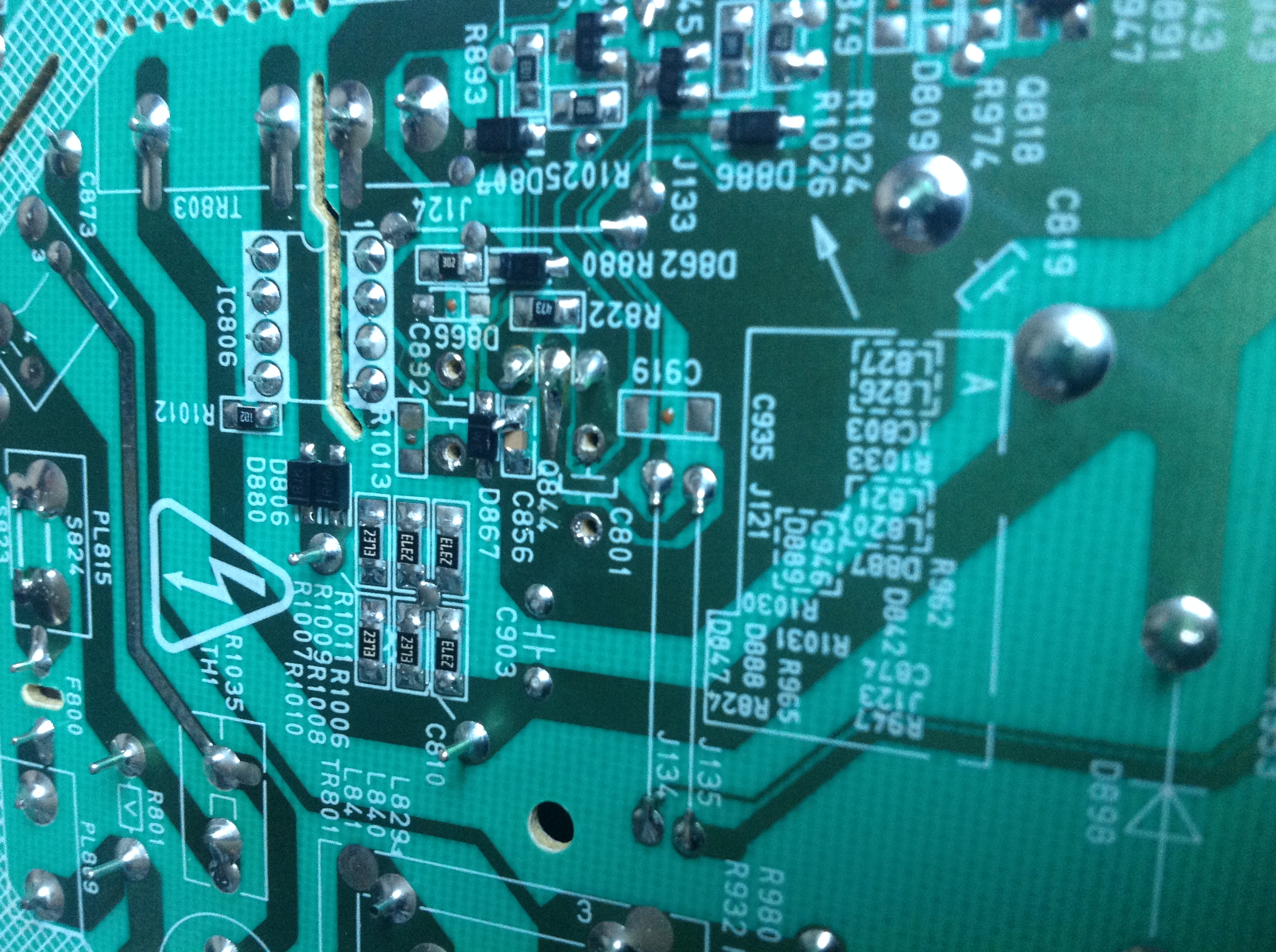

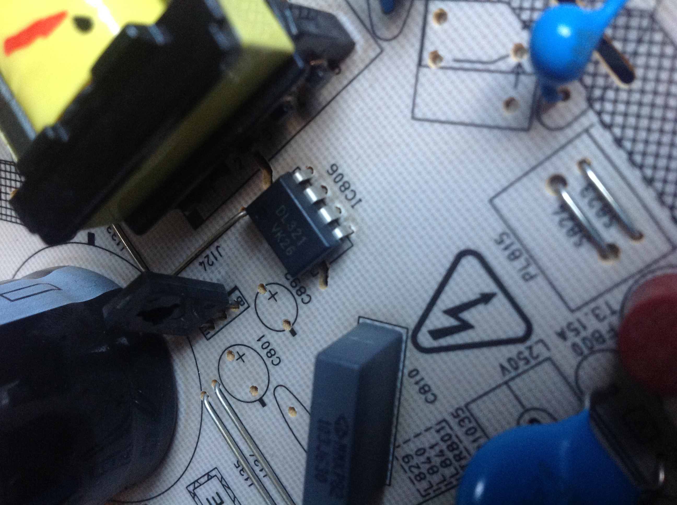

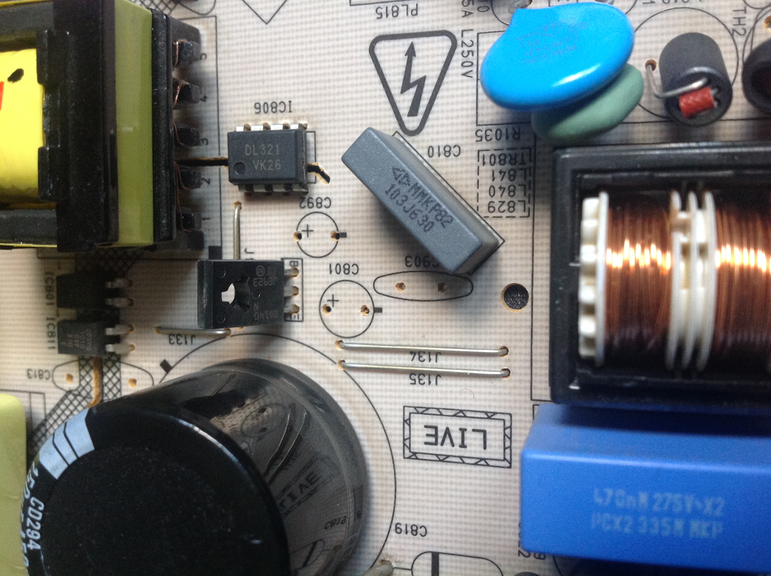

          Re: Acoustic Solutions TV - Stuck on Standby
          Ok here is one I repaired same issue as you significant voltage drop, the same Ic that you replaced was bad along with a small diode and resistor also the two capacitors 100uf 25v and 33uf 50v, and the little 8 pin controller was also bad and causing the same issue check all of them to rule them out.
          Photos showing the areas and parts I replaced, also check the diode right next to the heatsink as that can cause this issue as well, let us know if anything tests bad.
          Check:
          C856
          D867
          C801
          C892
          IC806

                    #29
                    C856
                    D867
                    C801
                    C892
                    All ok .
                    IC806 have no idea how to test it . will google it now for datasheet
