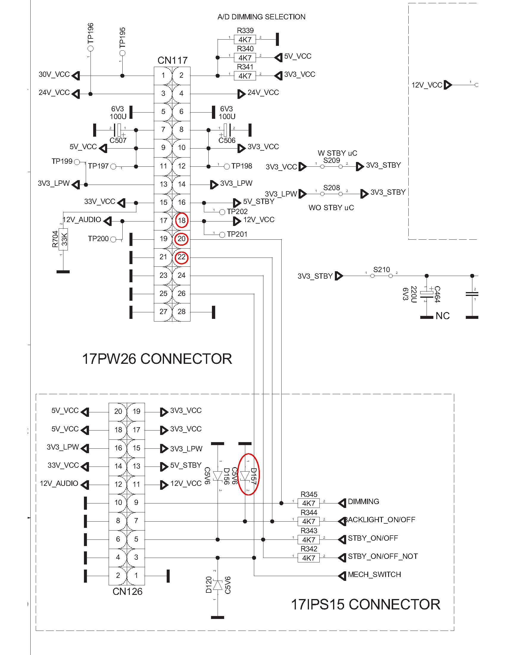

    OK, I look at the diagram, CN117:
    PIN18 12V_VCC
    PIN20: DIMMIN CONTROL
    PIN22: BL-ON
    So you are saying they show as shorted to ground with <1 Ohm reading?
    Are you sure you are not looking at the GND pins?
    Also as posted in post 1 the Voltages for the 24v, 12V, etc. are low.

      Re: Acoustic Solutions TV - Stuck on Standby
      oki..
      in 17bm35 schematic you have CN117 and CN126 it's a little bit different .. in PL816
      in pl816 ( 3.3v) is 18,20,22 .. in cn117 it's 8,10,12 .

          OK, I download the sch of the power supply. So pin 18, 20, 22 (VCC_3V3_ON) of the PL816 of the power supply board are showing as shorted to GND not the 18, 20, 22 of the CN117 of the main board as indicated in the other post, right?
          The PL816 pins to the CN117 are not pin to pin connections, for example: Pin 1, 2, 3, 7, 9 (GNDs) of PL816 are connected to pin 27 , 25, 23, 21, 19 of CN117.
          Basically Pin1 of PL816 is the same (CONNECTED TO) as Pin 27 of CN117.
          Pin 2 of PL816 is the same as Pin 28 of CN117.

              pin 18, 20, 22 (VCC_3V3_ON) of the PL816 of the power supply board are going into motherboard CN117 into pin 8, 10 , 12.
              I have disconnected the wires who makes the connection from power supply 18,20,22 to motherboard CN117 pins 8,10,12 and now board stops ticking every 1 second and SPDIF stops flashing.
              With the wires connected i get no Voltage but disconnected i get proper voltage on VCC_3V3_ON

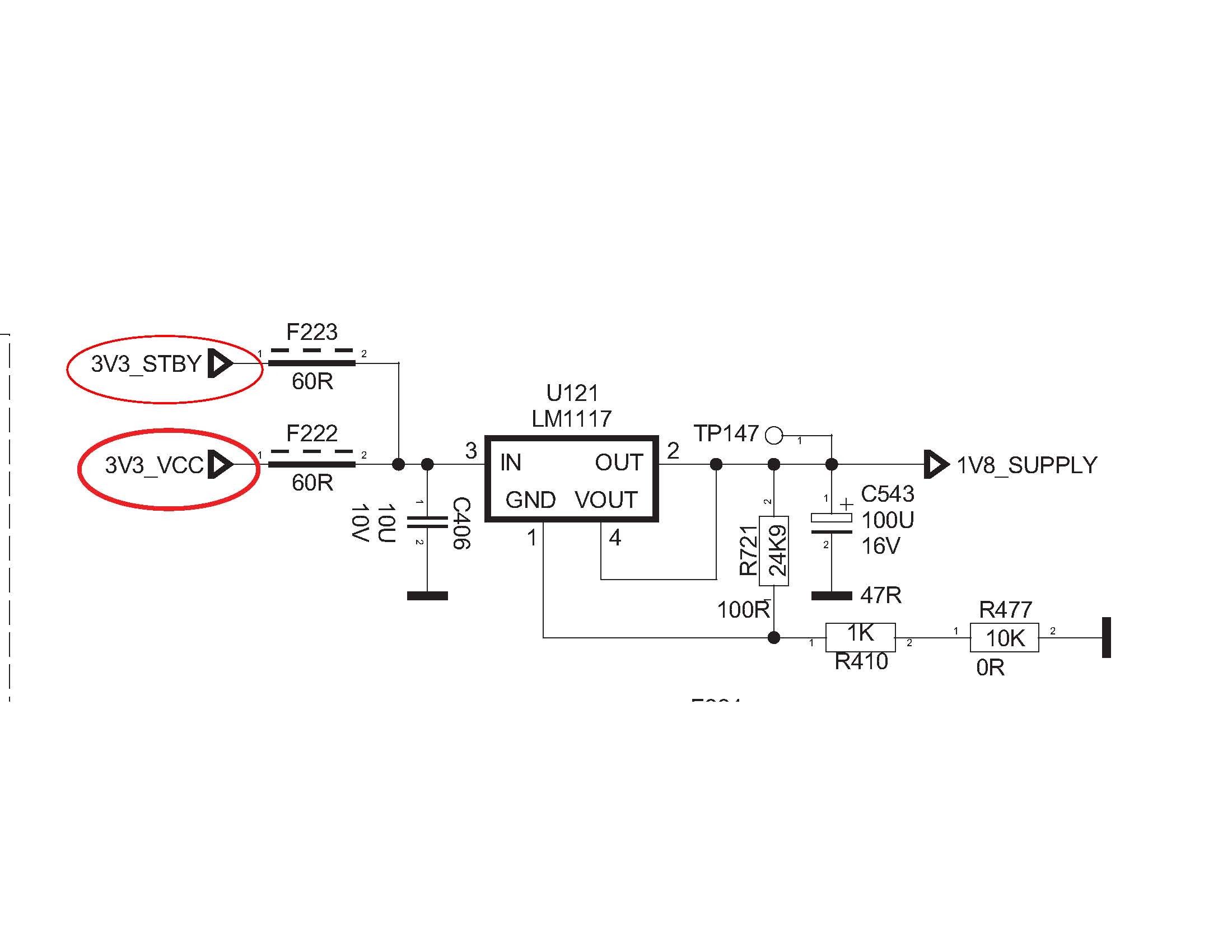

                      there's a regulator U121 shorted to GND .. i remove it and nothing happen still shorted .
                      also c506 shorted ... Ufff

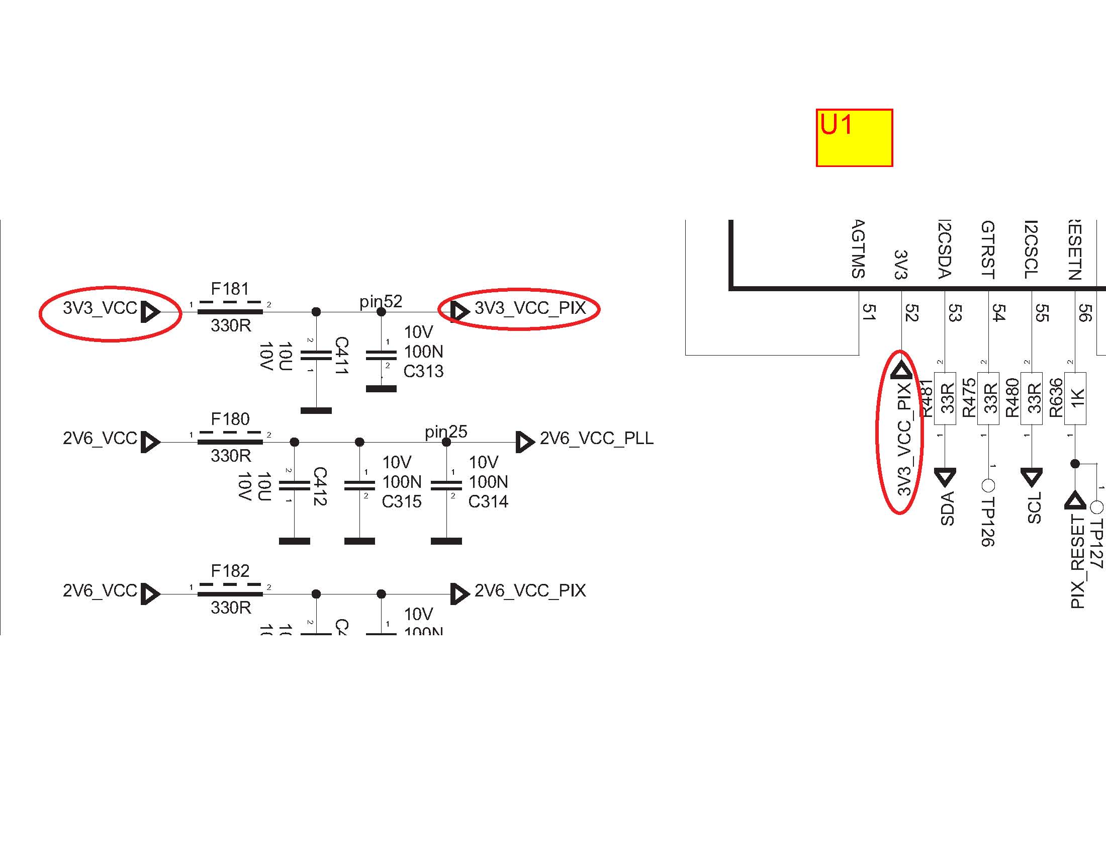

                          OK, I trace out what 3V3_VCC circuits, it is used for feeding pin 52 of U1 (PAGE 11 of the SCH). So it is either U1 is shorted out or the MLCC are shorted out.

                            What page is U121 is on the main board diagram?
                              #54
                              OK, I see u121 (x1117 adjustable output LDO regulator) on page 10, but as I indicated 3V3_VCC is also feed U1 PIN 52 also.
                              BTW, the SCH shows 3v3_STBY also feeds U121 which to me, that must be an error.
                              So what is the resistance reading against gnd?

                                    BTW, The Voltage source for the 3V3_VCC is from 3V3 STANDBY power supply through switched MOSFET (IC824 on the power supply board), so if it really dead shorted to GND the MOSFET will be damaged.
