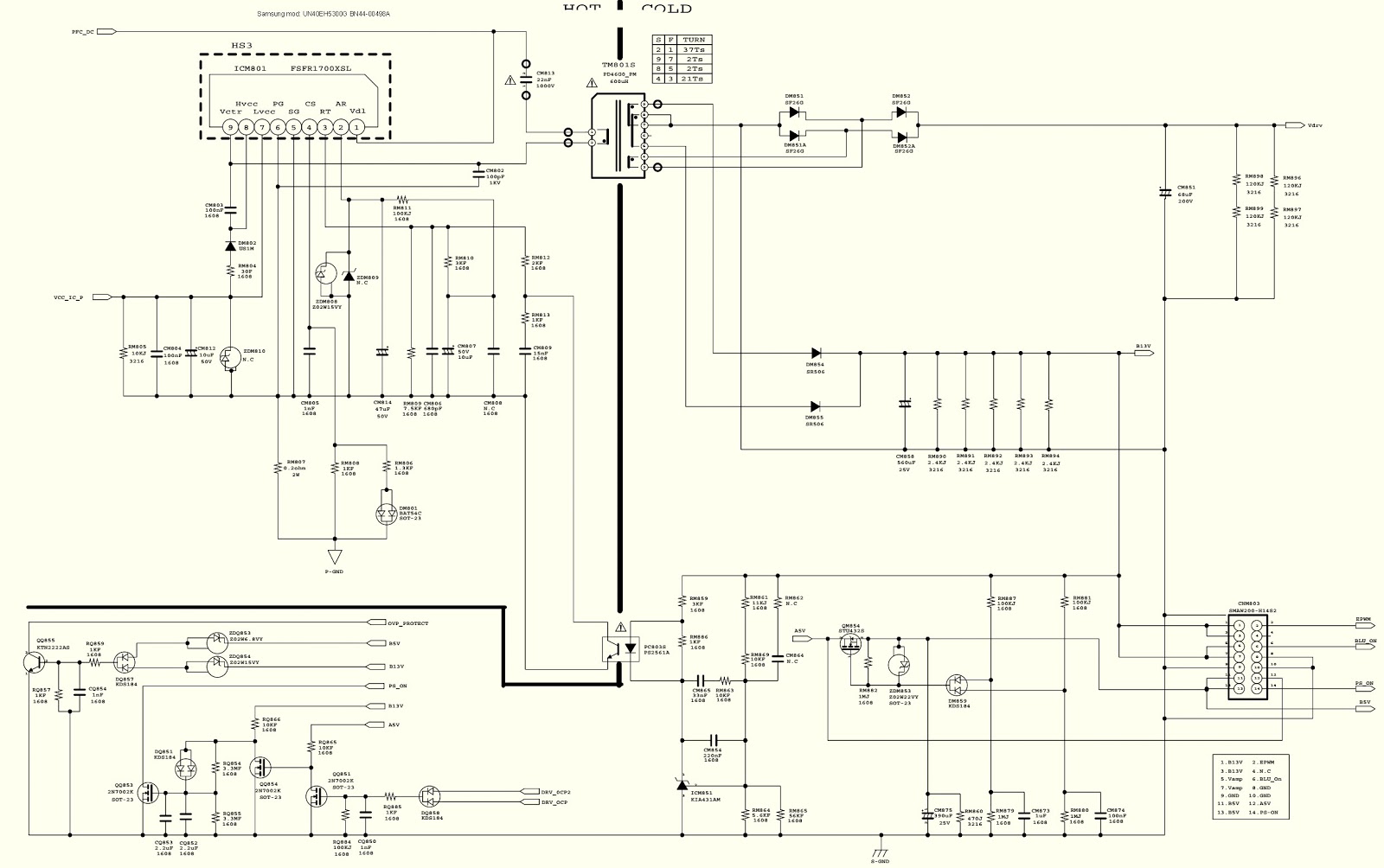

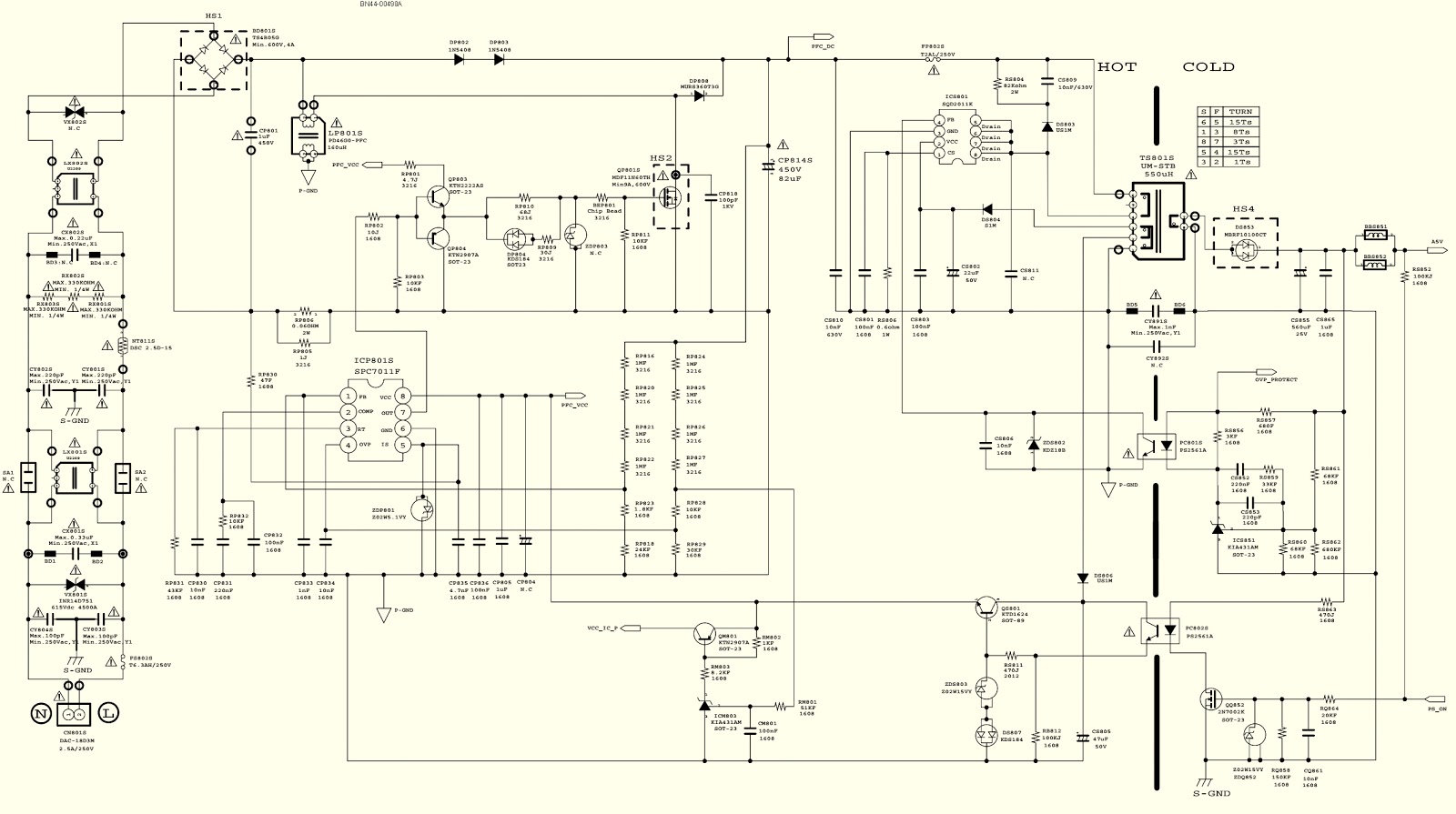

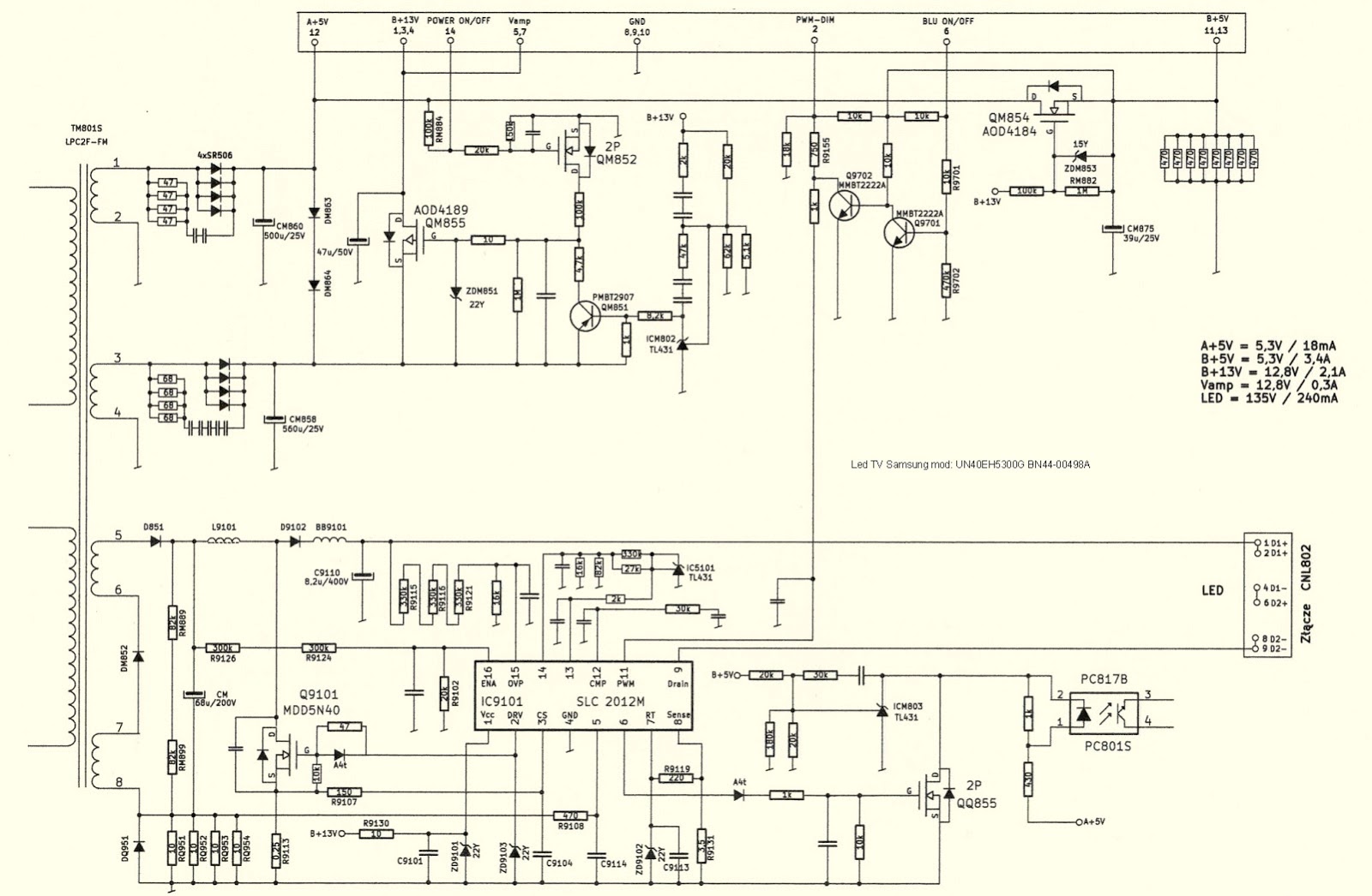

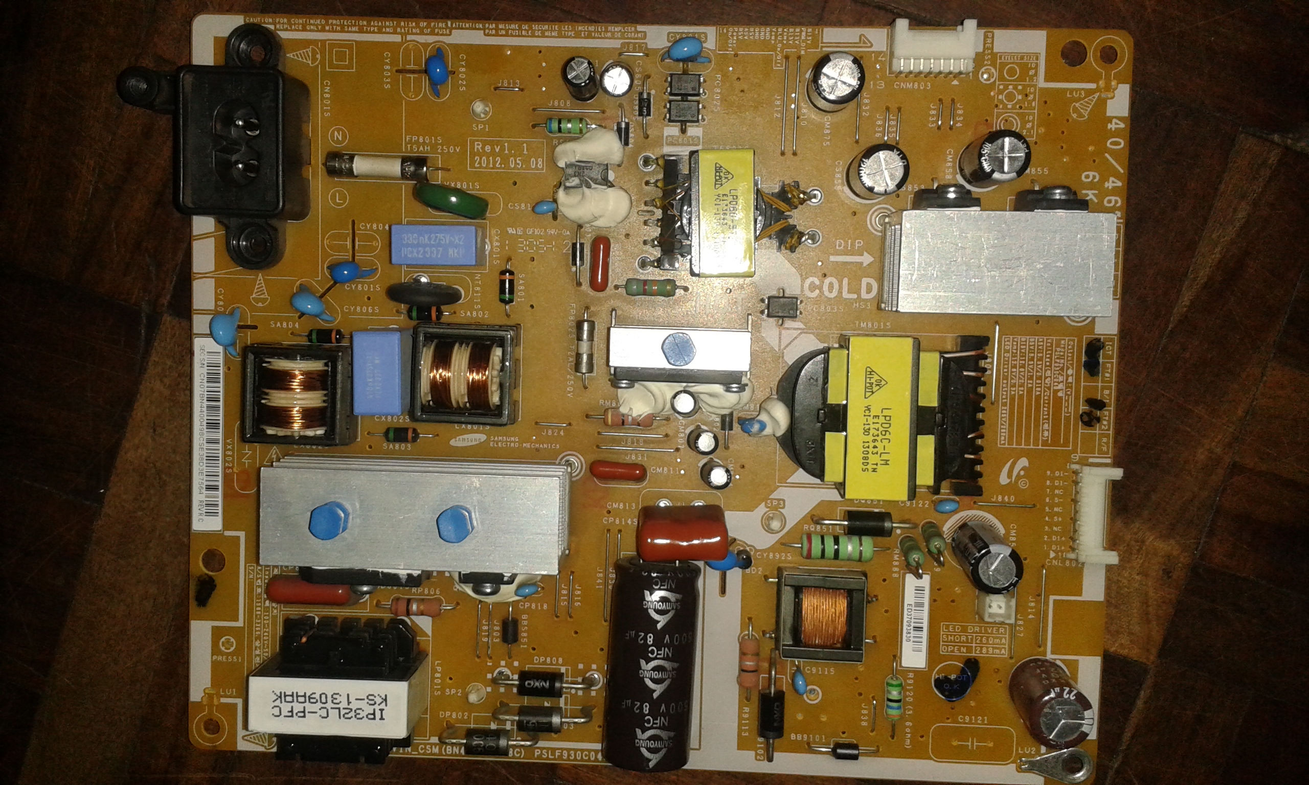

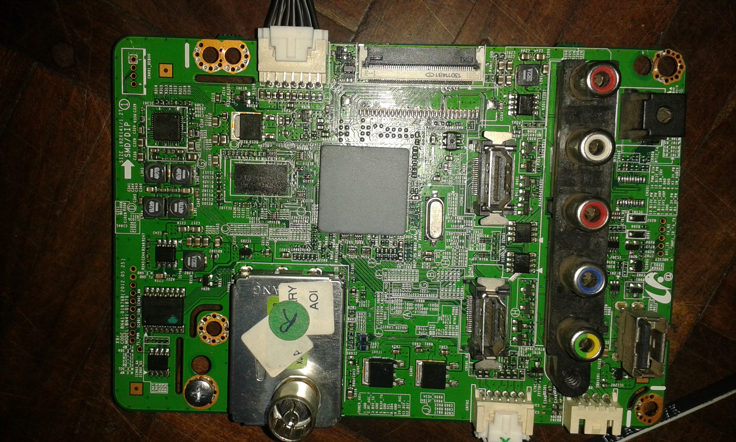

    Hi techs, I have a Samsung ua39eh5003r which switches on and then goes to standby. I have to wait for a day or two for the tv to switch on again, all the time it is stuck on standby. I have checked the voltages on the power supply board on both occasions when it is on and off and these are my findings:
    Connector CNM803:
    TV ON
    Pin1,3,4,5(Vamp),7(Vamp)- 12.6V; Pin2(PWM_DIM)- 0.96v; Pin6(BLU_ON/OFF)- 4.41v; Pin8,9,10- grnd; Pin11,12,13- 5.16v; Pin14(Power ON/OFF)- 3.3v
    TV OFF
    Pin1,3,4,5(Vamp),7(Vamp)- 12.6V; Pin2(PWM_DIM)- 0.06v; Pin6(BLU_ON/OFF)- 0.00v; Pin8,9,10- grnd; Pin11,12,13- 5.16v; Pin14(Power ON/OFF)- 3.3v
    When I disconnect the main board I get Pin2(PWM_DIM)- 4.45v and Pin6(BLU_ON/OFF)- 3.31v. These two voltages go to 0v when I reconnect the main board to the power supply board. Below are the images for both the power and main boards. I only managed to get the schematic for the power board unfortunately I cant get one for the main board. I desperately need help I am stuck. Thanks in advance.
