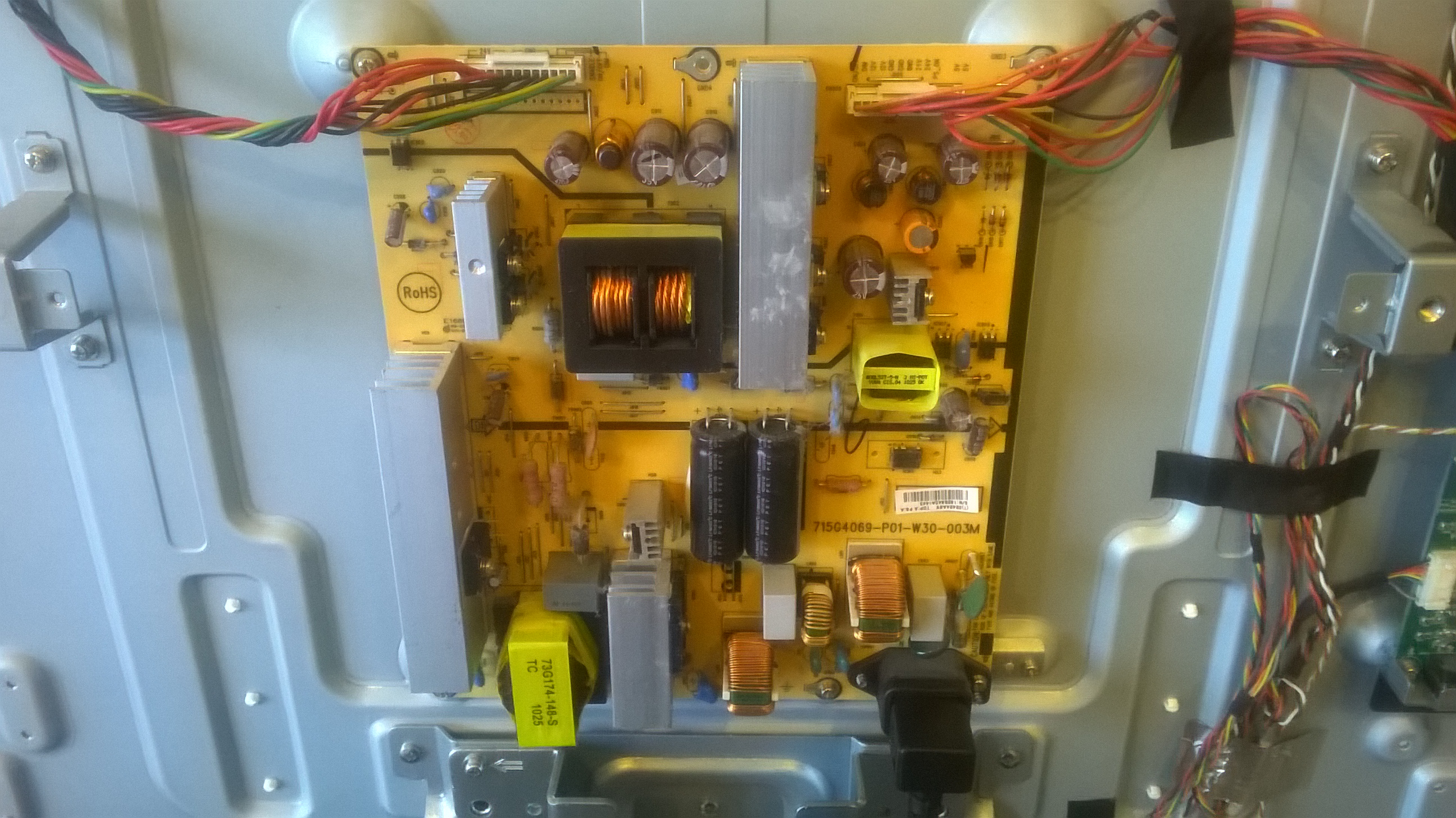

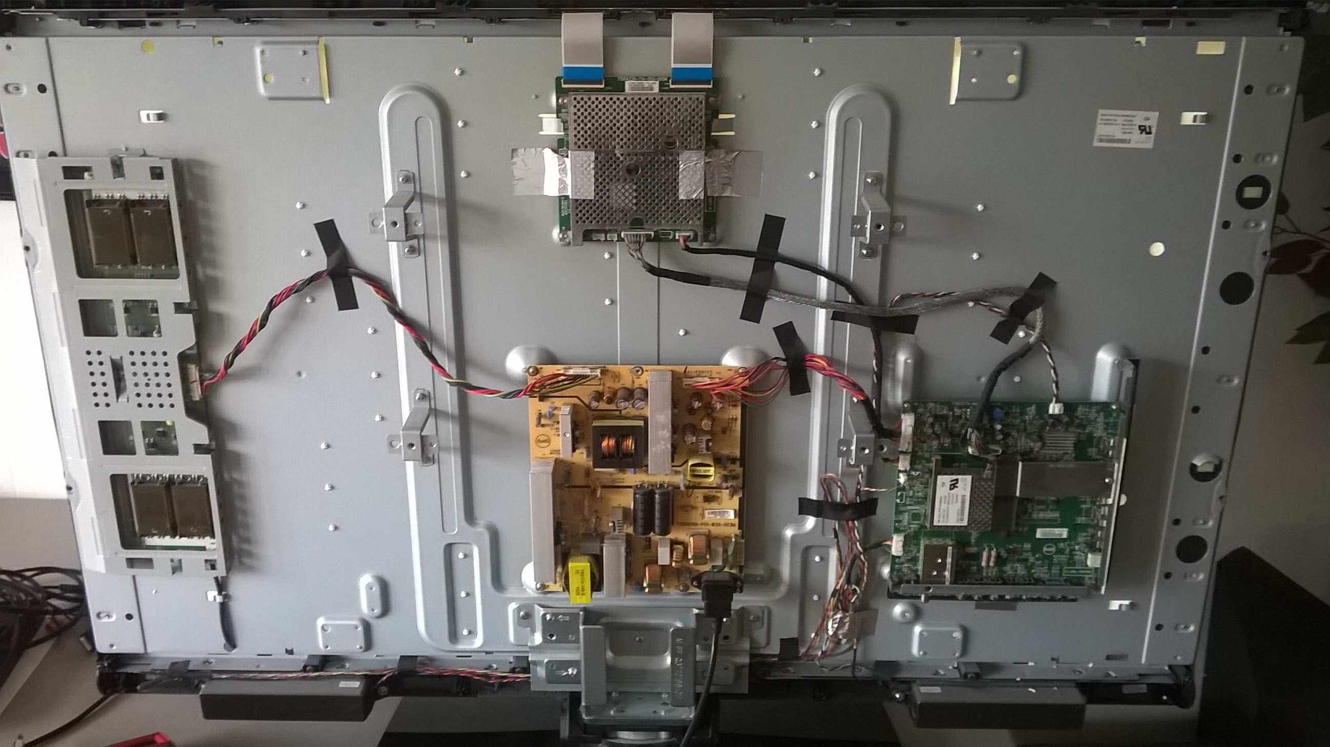

      Can we see a pic of the back side of the TV with all boards connected?

            can we see a pic of the back side of the tv with all boards connected?

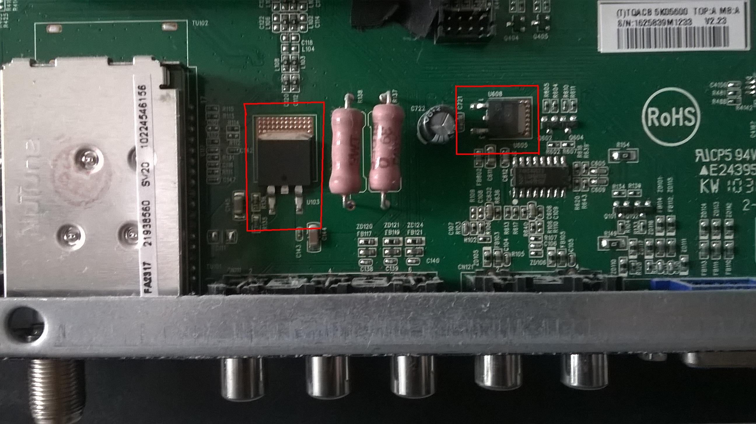

              Checked the voltages on the 2 volt regs on the main board. both were only outputting 0.39v?

                what are the voltages on all 3 pins of both regulators?

                  did you check the data sheet for those voltage regulators?, .39 seems off, maybe double check, make sure your reading them correctly.
                      According to the datasheet G9084 is adjustable with voltages of 1.5V,
                      1.8V, 2.5V, 3.3V and 5.0V.
                      This is what i'm getting...
                      Pin 1 is ADJ/GND 0.00
                      Pin 2 is V out = 0.00
                      Pin 3 is V In = 0.39 v

                            "According to the datasheet G9084......"
                            They are not adjustable, they are fixed output, the base part number will be followed by for I.E. 18 = 1.8V fixed output. The adjustable version will not have V rating after the base P/N.
                            You are not going to get any out put when the input is only 0.39V.
                            You need to find out if the main board is sending the PSON to turn on the rest of the power supply first, if the power supplies are not turn on, then that may be the reason you are not getting the input voltage to the regulators.
                            BTW, there are more than 2 regulator ICs that I can see from the SJ pictures.

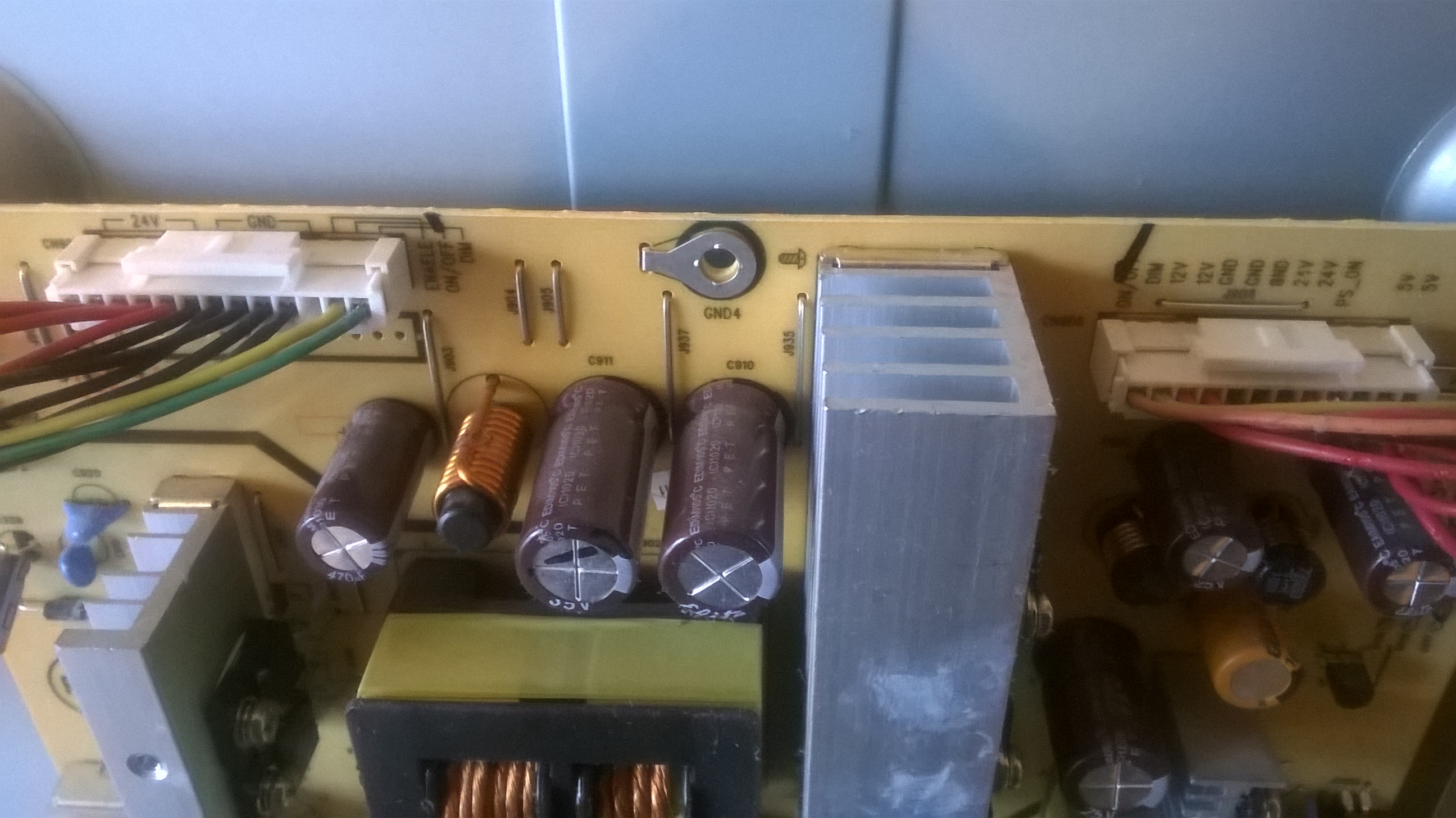

                                A better pic of PSU would help.
                                      Before powered on, the voltage is 0v at the ON/OFF pin going to the inverter board (with the blue LED). When I power it on the voltage jumps to 5.03 and remains there. There's also a PS/On pin on the other side of the power board going out to the main board. It shows a consistent 4.78v.
