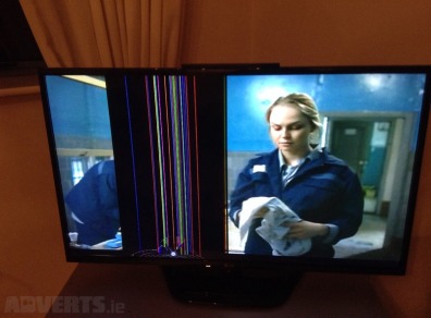

    H Guys,
    I have an lg tv with a black bar through the middle of the screen as per attached image.
    Is this the screen or tcon issue???
    Thanks a mill

    Re: Lg 42ln543v bar in screen
    could be, did you try reseating your tcon cable and ribbons? careful with the ribbons, use fingernail to pop up retainers, can check youtube tcon replace for a video, if you like.
      Have'nt tried much as of yet??
      Will need to take apart and see what the story is.
      Still have my hands full with the philips I have in the other thread!!!!!
        Look closely at the bottom of the black bar, it looks like an impact point.
            can't tell pic. is a little to small too see cleaerly.
              Definitely looks cracked to me... that can't be anything but impact damage. Unrepairable.
                Yes the screen is in bits alright.Will scrap it and remove working parts>
                Sorry for the bother guys..
