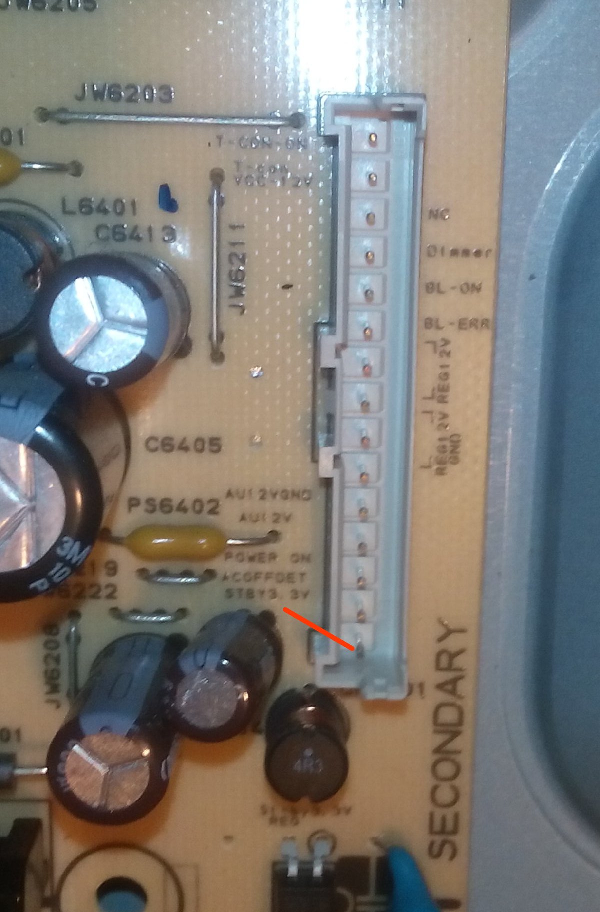

    Re: Dead As A Doornail. Sony KDL-40EX400
    Yea, should have clarified that..
    That's what I get when I plug the TV in.. Pushing the power button has no effect.. Still reads 166v
      I think when its working right its suppose to jump to 390 or so.
              maybe try unplug the connector from power supply that has stndby, and measure the stndby pin on power supply in dc mode.
              • Michale32086
                • Nov 2011
                • 1453
                The only standby I could find was 3.3v
                Checked the marked pin and it did give me 3.3v at plug in

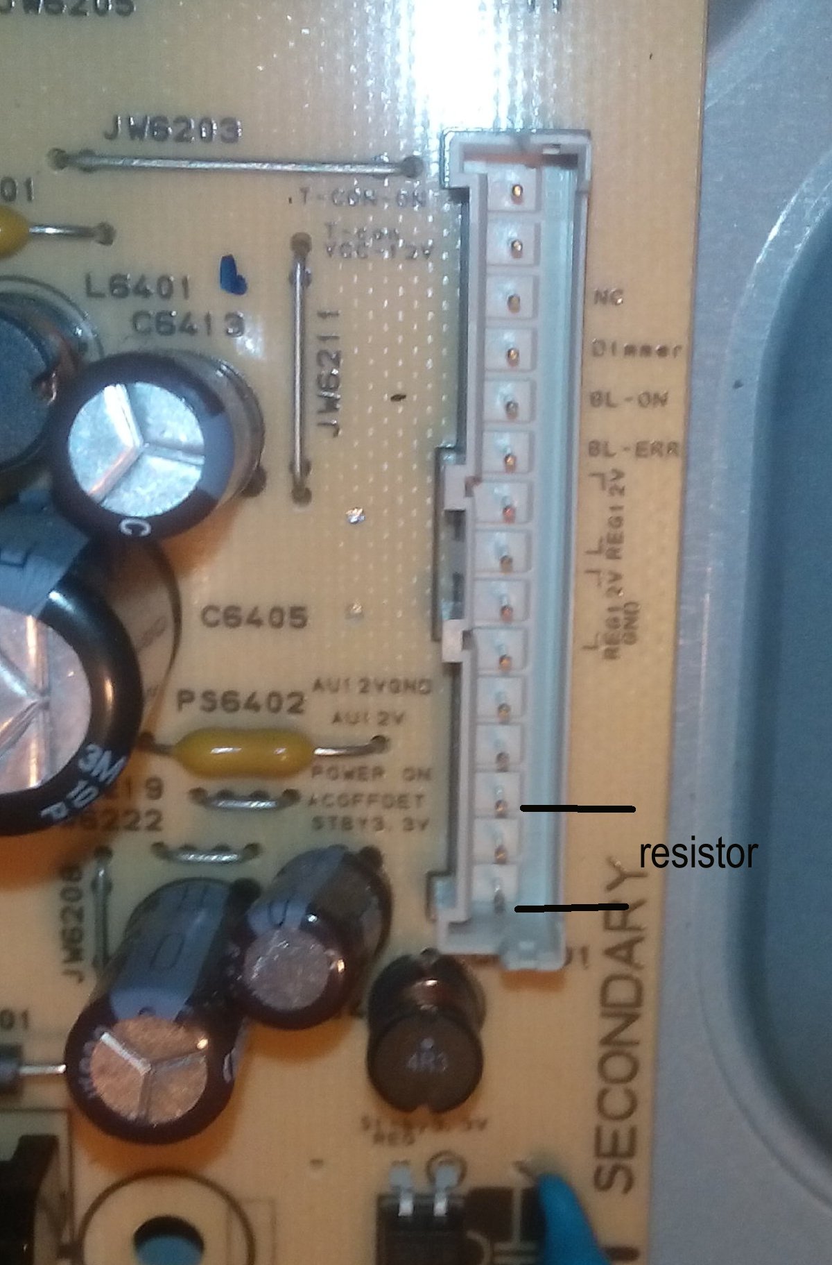

                    You can usually check power supply operation by connecting STBY and POWER ON with a small resistor (100 to 470 ohms, 1/4W through hole type)

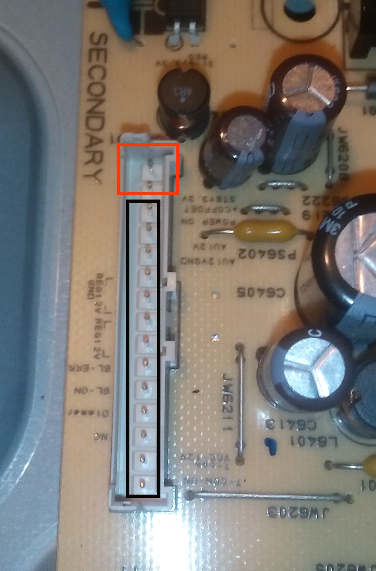

                    • Michale32086
                      • Nov 2011
                      • 1453
                      #30
                      The pins outlined in red have 3.3v
                      All the other pins (black) have 0v
                      • nomoresonys
                        • Jan 2013
                        • 12276
                        • U.S.
                        #31
                        ok, now is that with all the boards plugged in?

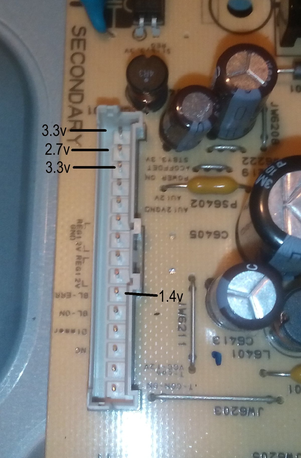

                        • Michale32086
                          • Nov 2011
                          • 1453
                          #32
                          It was out.. But here are the voltages with the connector plugged in..
                          All the unmarked pins are 0v
                            Lemme see if I can dig up a resistor..

                              #34
                              dunno, it seems like the mainboard isnt turning on the power supply.

                                Yea, Tom's idea might shed light on that. But it will have to wait til I get to the shop.. I have no resistors here at home..

                                        Yea, that's my thinking. I am going to run to the shop. I'll being home some resistors and test it with Tom's idea...

                                          OK, the closest resistor I have is a 500ohm... Too big??
                                          And I unplug the connector from the main board side and put the resistor on the connector at the marked pins...
                                          Good Ta Go??
