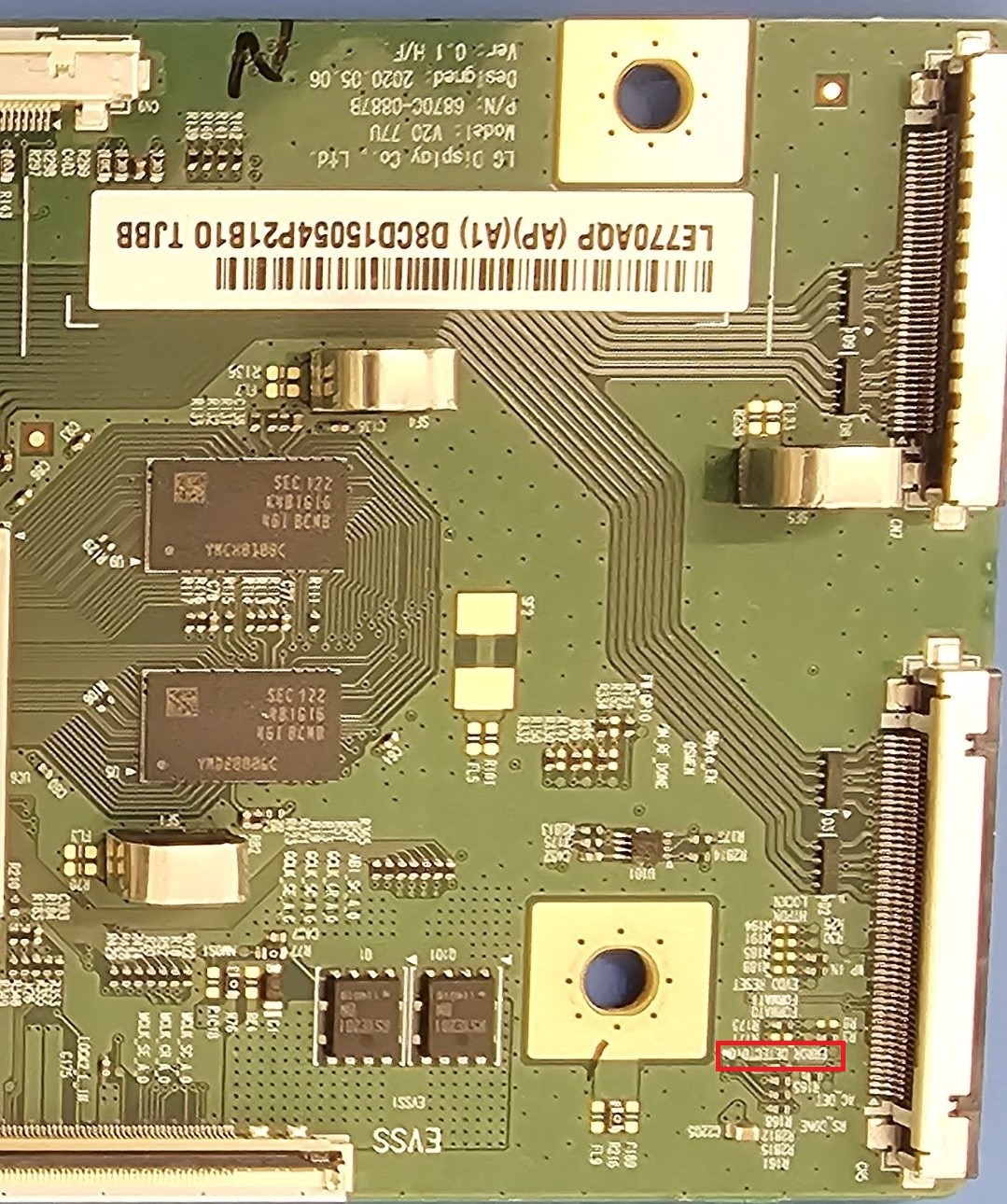

                      TCON Photos as requested...

                        which screen zise this OLED ???
                        follow the rail ERROR DETECTED ON sign at t-con

                            strange at OLED world 77 and just 2 ribbon to panel.. however the pin 40 you were talking on ... i think it response to R76 or R77 on t-con ... if it was 4 ribbon then i do know.

                                i don't know what pins you are referring too... is this 40?

                                  Yes, MB CN6800 Pin 40 = TCON CN5 Pin 12
                                  • thstuff
                                    • Jan 2015
                                    • 17
                                    TCON CN5 Pin 12 = ERROR_DETECTION

                                      i don't think yours pins calculating are correct , for me not PIN 12 maybe 7 or 8...
                                      heck the points with R i mentioned before then with ribbon socket which it go to panel
                                      c
