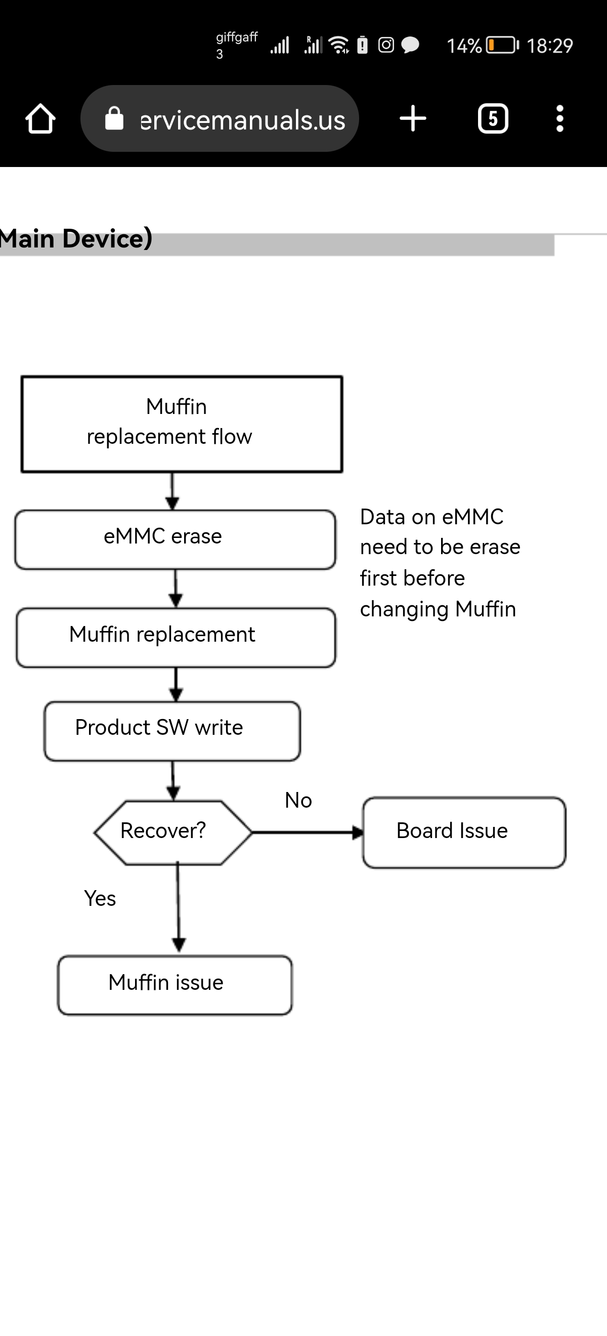

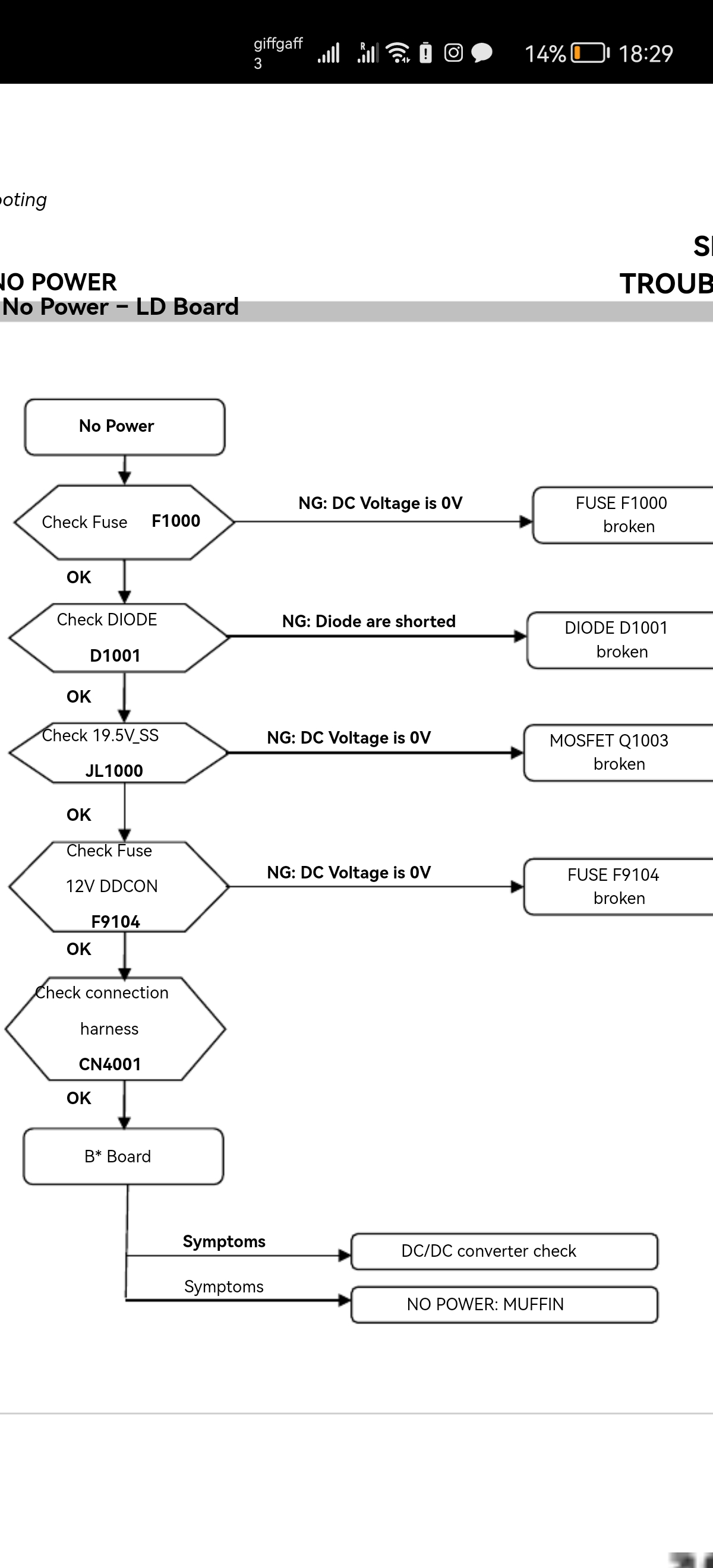

    I have a KDL-55W755c that came in dead - not even standby light going on. Tested the power supply - all correct. Tested the output pins on the Led driver board (in which the power cord plugs in) - all seemed fine.
    I got a service manual for this model and tested the DC/DC converter by checking voltages on selected components. Every voltage was present where it should be. Service manual says that in this case a "Muffin" replacement is needed. This is the moment where I got stuck as I wasn't able to Google my way through it - till this day I have absolutely no idea what the "Muffin" is.
    Decided to just swap the mainboard instead of trying to find out the meaning of "Muffin". Even had an actual muffin during lookout for the board. Found one from 50" 755c, exactly the same board numbers.
    After installing it I was greeted by flashing green/Amber lights. "Firmware please" it said. Downloaded it from Sony website and flashed it - could see the status light change to dimming white, which - according to various places in the Net - means it is reading the firmware and installing it. After some time the TV resets and... Continues to flash green/Amber, this time with Android setup sound playing in the background. I can hear it reacts to the remote as well.
    It is not a backlight issue as the backlight works fine when mainboard is disconnected from the PSU, and there is no picture visible when flashing with torch.
    Green/Amber flash means panel Id error, which I guess maybe could be solved by choosing the correct panel Id in service mode - the problem is I have no picture and can't really do it blind.
    I've seen various threads about a corrupted Android update that caused this sets to fail this way. At this pont I am suspecting that the board I received from eBay has the 'bricked' soft on it, that doesn't 'want' to be overwritten.
    My questions to you are as follows:

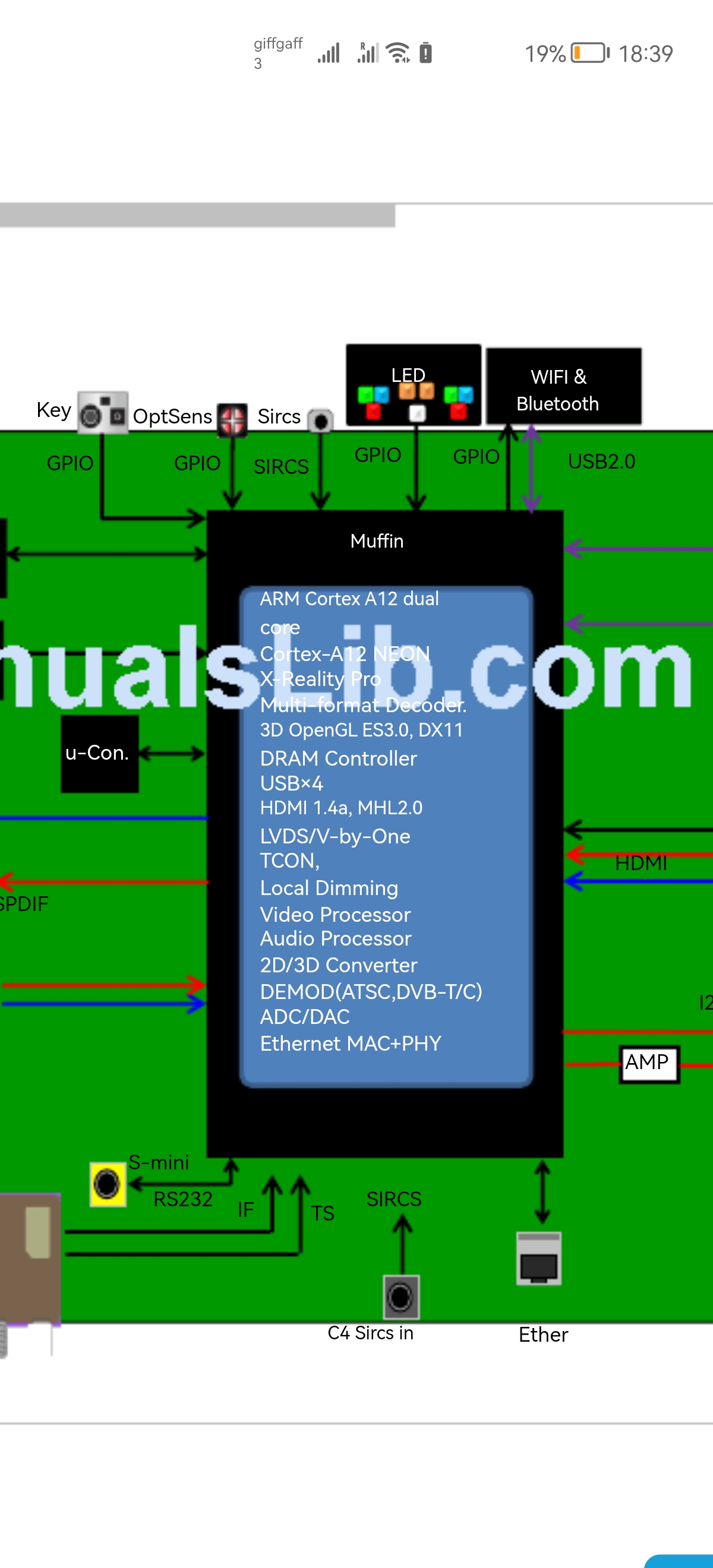

    1. Is anyone able to explain what a "Muffin" is? Eeprom?
    2. If the board I received has a corrupted firmware on it, would it update over with fresh update from Sony website?
    3. Is there any reasonable way to make 1 properly working board out of the 2 I have? I suspect swapping the firmware is 'a bit' more complicated than transferring an iC containing it?
    What's my best shot now? Any help would be highly appreciated.
    Thanks for stopping by.

    Probably the EEMC chip on mainboard is dead, they only last so long.

      Backup the contents of both EMMC’s from both boards, then flash the content from the original board to the new board with flying wires. No soldering needed.

        Android versions carrys the name of a typical sweet, evidently your tv has got muffin version. Since this is an always on tv, a not booting tv is often one with damaged android. I have followed a thread on an italian forum that was by headache, also there a not booting one followed by mb replacement and no video with audio, ended up in carrying the giant tv to Sony assistance, they told to the owner they worked only with closed tv and an usb memory with correct firmware, i guessed they have secret key combinations/menus that carrys to the correct updating process that recognize the actual panel and synchronizes with the new main board..
        Finally i suggest you to try insert the sowftware usb key in with tv in standby, then keep press on key on local keyboard for 4-5 secs and watch if update starts, if the process is not successful retry it but with at least 14-15secs..

          lol, if only someone could get that SECRET combination, but there is no such thing in the real world.

            There was no Android version called Muffin (there was Cupcake but that's an ancient 2009 1.5 version which was never present in this TVs) and the service manual says about REPLACING the Muffin, so doesn't sound like a soft reinstall.

                  they were toying with the idea of calling android 6 muffin, but it's no secret or special conspiracy that needs a magic combination, VERY AMUSING concept tho.

                    For anyone in the future who might be looking for this answer - Muffin doesn't mean Android. Sony calls that it's main SOC, trivialising it Muffin = CPU.
                    I did try the update hundreds of times with the same results. Ordered a programmer to dump and flash eMMC as suggested. It's about time lol.

                      You can't do Capleaker's suggestion because flow chart tells emmc erase and re install software, this doesn't mean copy a premade installation with a dump but a new installation maybe with a software installer by usb flash key, remember cpu has got in it some key codes.. them must be used for new installation.. this is what seems to me..
                      ps: is possible new software is copied at steps, like another tv i repaired, first bootloader copy by serial port, then usb installation..

                        Only the flow chart sez something, doesn’t mean automatically it has to be done that way. I’ve cut many flowcharts short and was surprised with the outcome that it actually did work copying the content from one board and load it to the identical other board. Even worked on an Android TV box. Given, it isn’t a guarantee to revive this like that, but worth a shot. Before I do the boot loader on a TTL and USB jazz, I prefer making a dump file and flashing that. However, you have to be very careful with that and know what you’re doing, because you can easily screw up a dump too, by not selecting proper chip parameters, etc.

                                That flow chart was about replacing the CPU - I think only then it is necessary to follow exactly these steps.
                                I did some BIOS programming before but don't have experience with eMMC. Did some digging and it seems -quite- straightforward, but is there anything specific I should know? Or maybe some step by step how-to guide?
                                Would soldering the original eMMC to the new board do the trick? Not a fan of bga-like ICs at but least I'd know what I'm doing lol.
