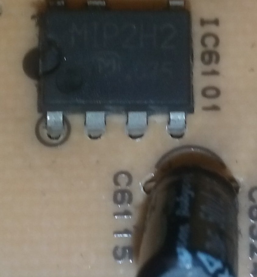

    Also, what's the p/n of that 7pin chip near C6115. I think it's ok as you've got stby but I just want to check 0V on that cap is normal (could be the burst/fault timer, if so its ok. Looks like the pfc/multi ic has the right supply so thinking that its probably bad.

        Re: Dead As A Doornail. Sony KDL-40EX400
        I was thinking just replacing C6115 as a matter of course..
        It's a 4.7uf 50v
        Any leeway for testing purposes??

          Found a 4.7uf 50v Capacitor.. Replaced it on the Sony..
          No Go.... Knew it couldn't be THAT simple...

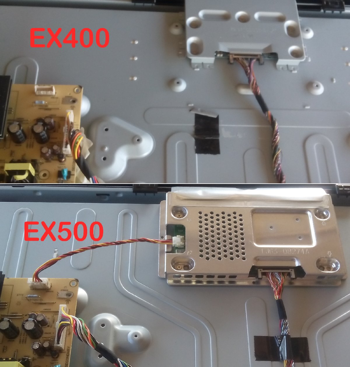

            OK, let's add a little fun twist to the saga...
            I just got in another Sony. KDL-40EX500
            The only different I can tell between the two is the extra connector going to the T-CON Board. (Pictured)
            Now, let me see if I can explain it...
            The NEW acquisition (EX500) when it's plugged in, the power LED blinks red 6 times.. When I power it up, the red LED goes out, the green LED comes on. I see the SONY emblem on the screen for a sec or two, here the SONY tone. That happens 3 times. Then the green LED goes out and the RED LED starts blinking 6 times again...
            Now, I figure I can kill two birds with one stone or, in this case, fix two TVs with the parts...
            Of course, it's nice in theory...
            When I put in the Power PCB from the EX400 into the EX500, I get nothing. No power lights no green lights no nothing...
            When I put in the Main Board PCB from the EX400 into the EX500, I ALSO get nothing. No power lights, no green lights no nothing...
            And the converse is also true.. When I put the Main Board PCB and the Power PCB into the EX400 from the EX500, I get nothing..
            I hope I explained that clearly because, in my mind, it's a MAJOR jumble, a total SNAFU...
            As Tom Cruise said in A FEW GOOD MEN...."I don't know what all that means, but it sounds pretty bad.."
                Can you try swapping power & main from EX500 into EX400? (It could be power surge that has damaged the boards.)
                Interesting you should mention this...
                First off, I did put the 500 boards in the 400.. Still dead..
                But the funny thing is, when I try a 400 board (either MAIN or POWER) in the 500, it's dead... But when I put the 500 boards back into the 500, it doesn't work right away.. I have to let it sit unplugged for a few mins and THEN the boards will work.. That is to say, it "works" as in giving me the 6 RED LED blinks, etc etc etc
                Almost as if something on the 400 boards is shorted and causing the 500 to have to "reset" it self.
                You can see why my mind is a bit frazzled...
                  Try unplugging the T-con board from the main board?
                  Really, really odd.
