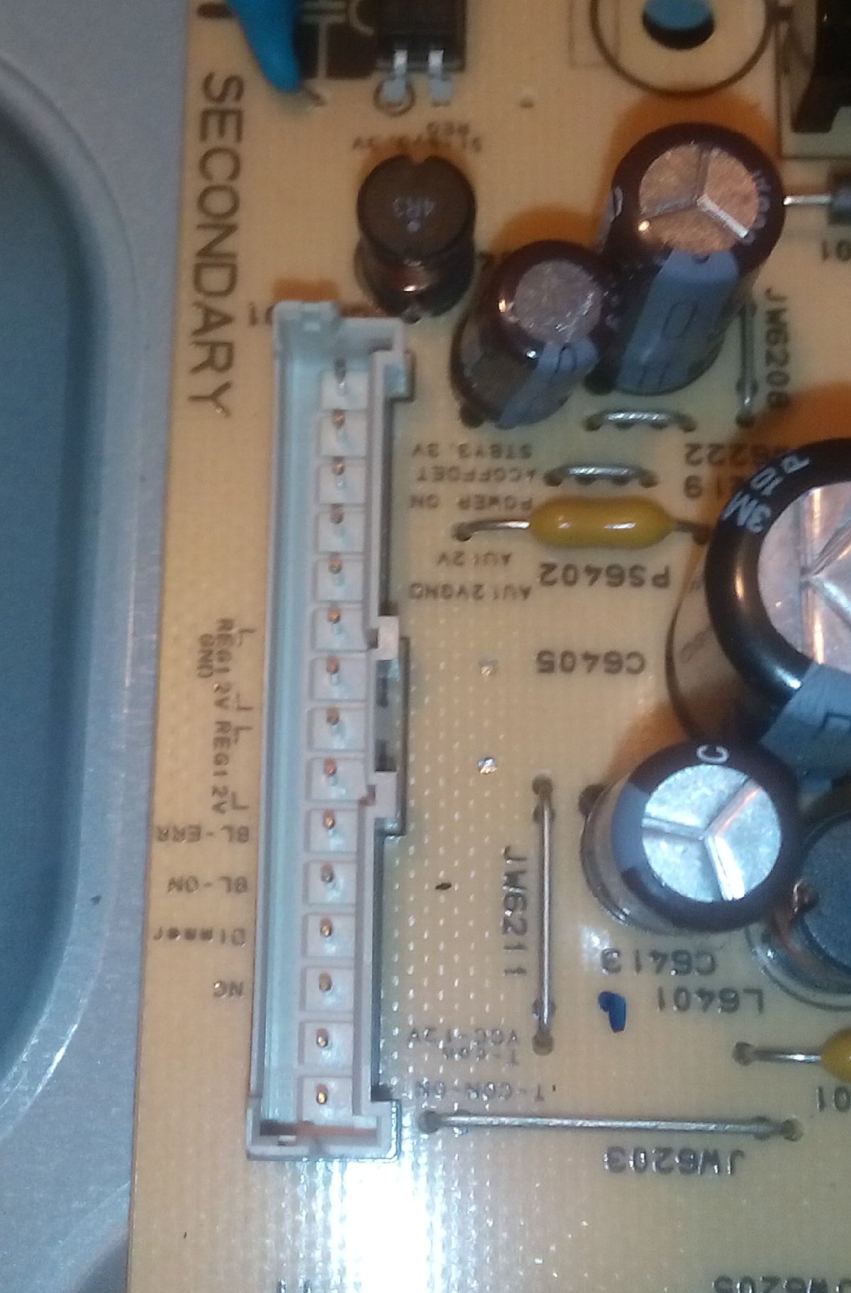

    did you check at the connectors?, you probably checked the fuse, if you have no stndby voltage, its a power supply issue.

      DOH!! Yea, the connectors.. I should have remembered that...
      Fuse is good..
      I'll check the connectors. Thanx

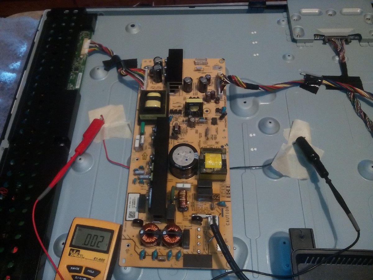

        Well, this is weird..
        I don't get any voltages from the connector..
        So I figured I would check the incoming voltage at the 2-pin power connector..
        http://sjfm.us/temp/SonyKDL1.3gp
        It's all over the place......
        AND upside down

              Is that the 120V AC input? Your meter was set to DC.
              DC starts at the bridge rectifier!

                oops, that would explain it.

                  rookie mistake...
                  Yea, 118v... So we're good..

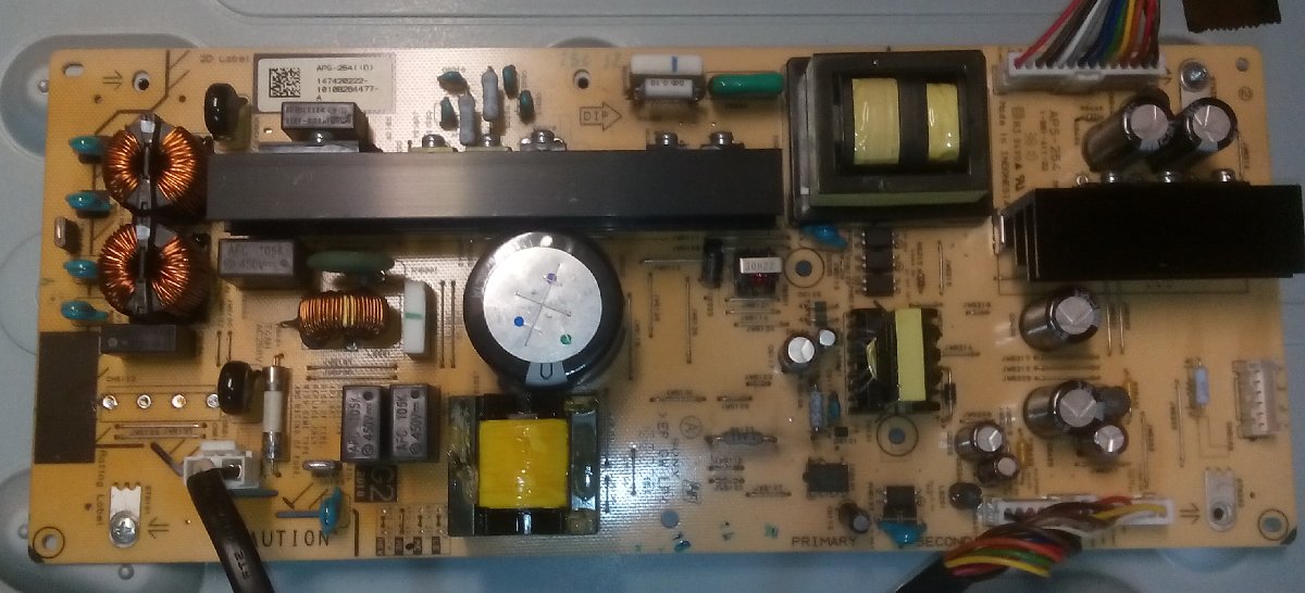

                    You have not much choice than to solder up some wires to the filter cap and measure it that way if you have to.

                      K, I'll give that a shot.. Thanx

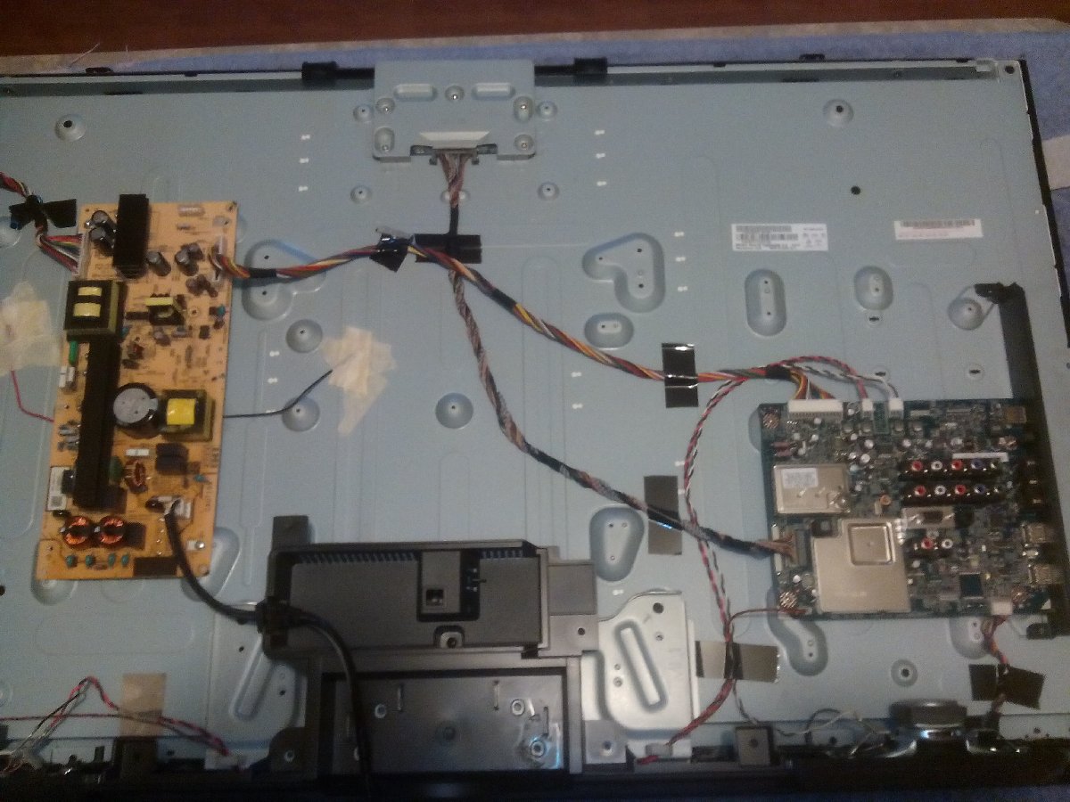

                                  Re: Dead As A Doornail. Sony KDL-40EX400
                                  So you get 0 Volt on all the pins of the the connector of the power supply that goes to to the main board?
                                  How about the pictures of the whole back side of the TV so we can see how all the boards are connected together?
                                    Nope, no power on either of the connectors...
                                    I also am ready to check the voltages on the large cap.. Just wanted to make sure the setup I have (pic) is good..
                                      OK, I get 166V on the large cap which is a 270uf 450V cap...
                                        I think that sounds about right, is that with tv off?, does it go up when you turn tv on?
