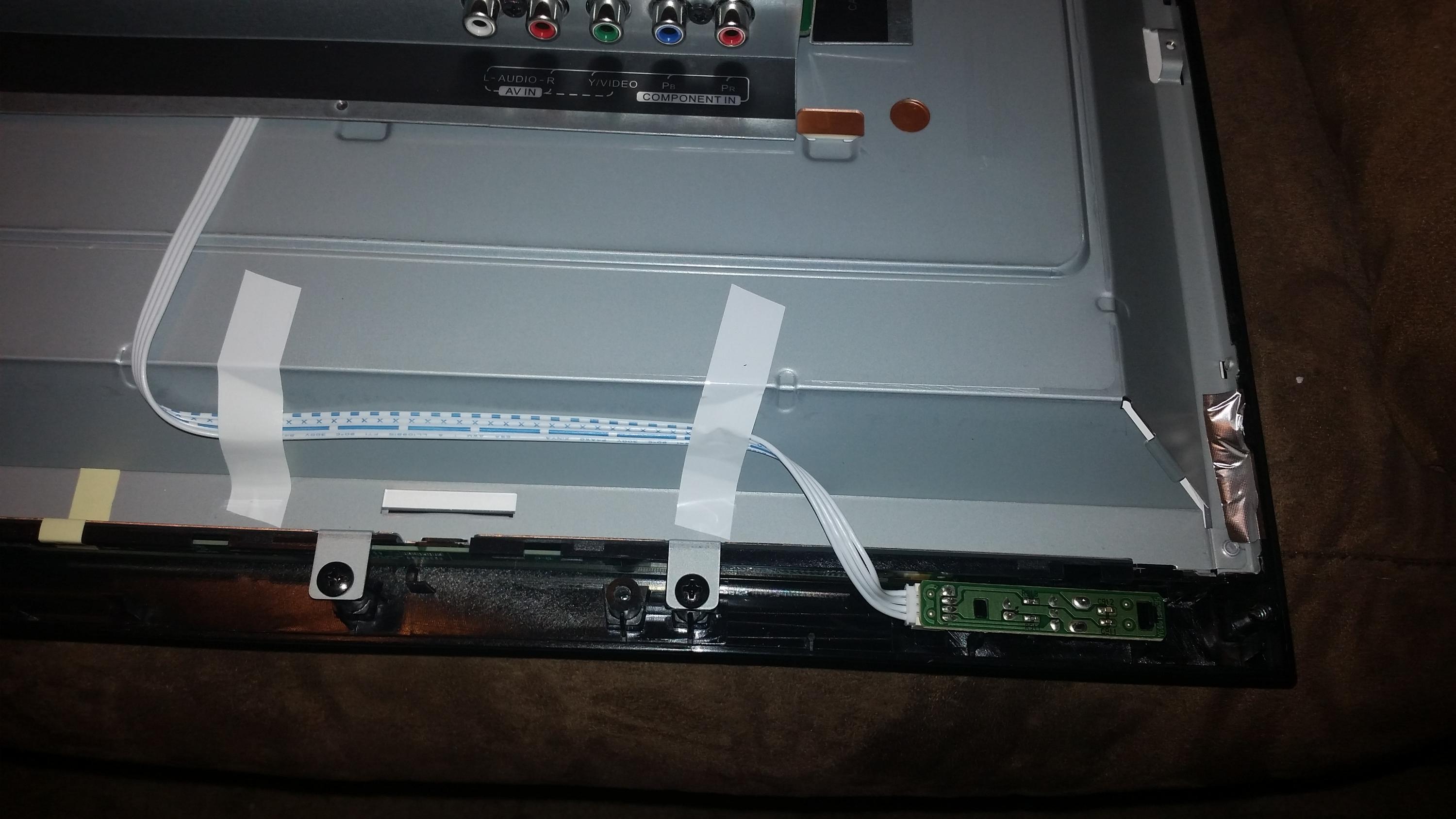

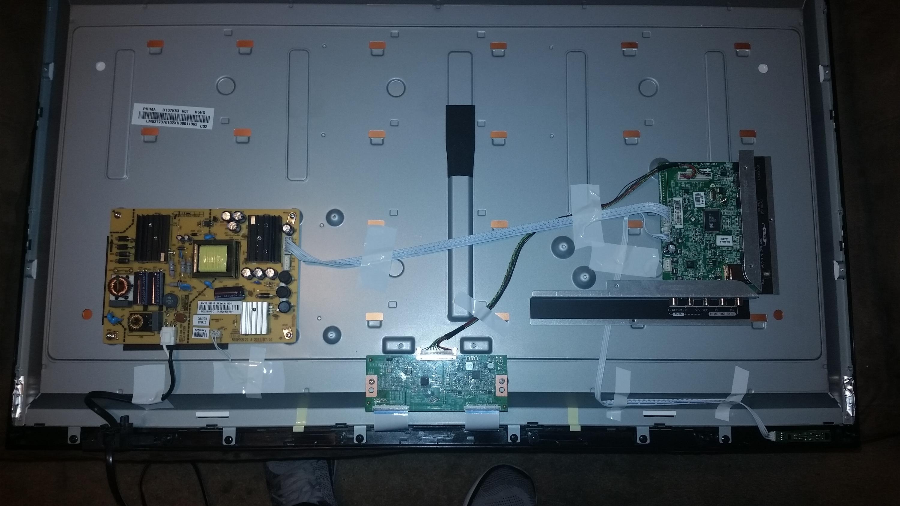

        Re: Insignia NS-37D20SNA14 Backlight going out. Flickering! Help!
        Here are a few pics of the internals. http://postimg.org/gallery/2wvigyv44/ Let me know what you think?

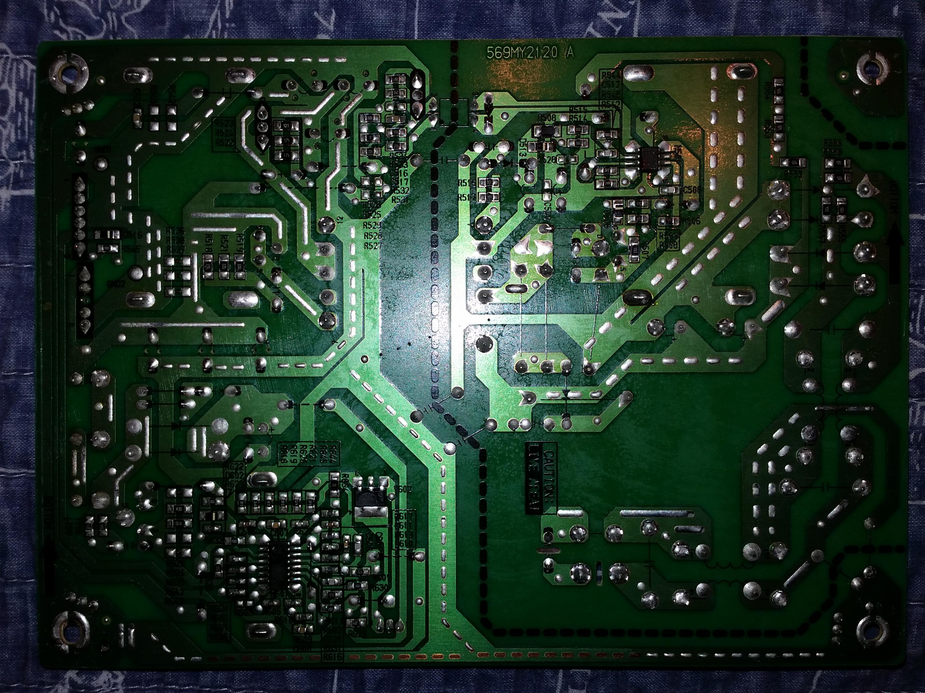

              Put simply you are not trying hard enough - Life is a lot simpler for us to just move on to another thread
              Try adding pics 2,3 &4 one at a time - we also need to see that back of the power supply and the back and front of the main board (no pic at all?)

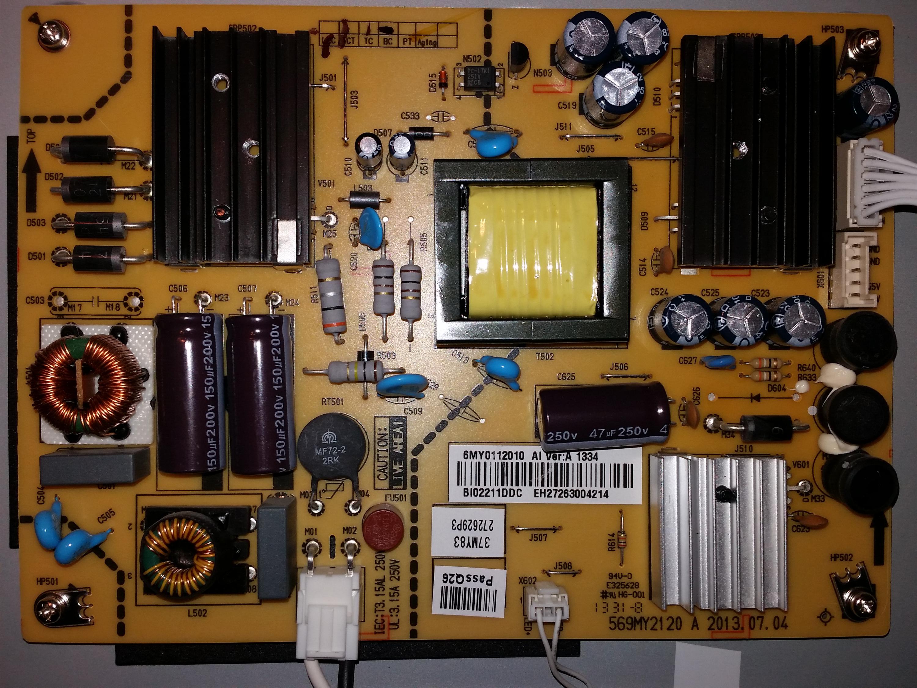

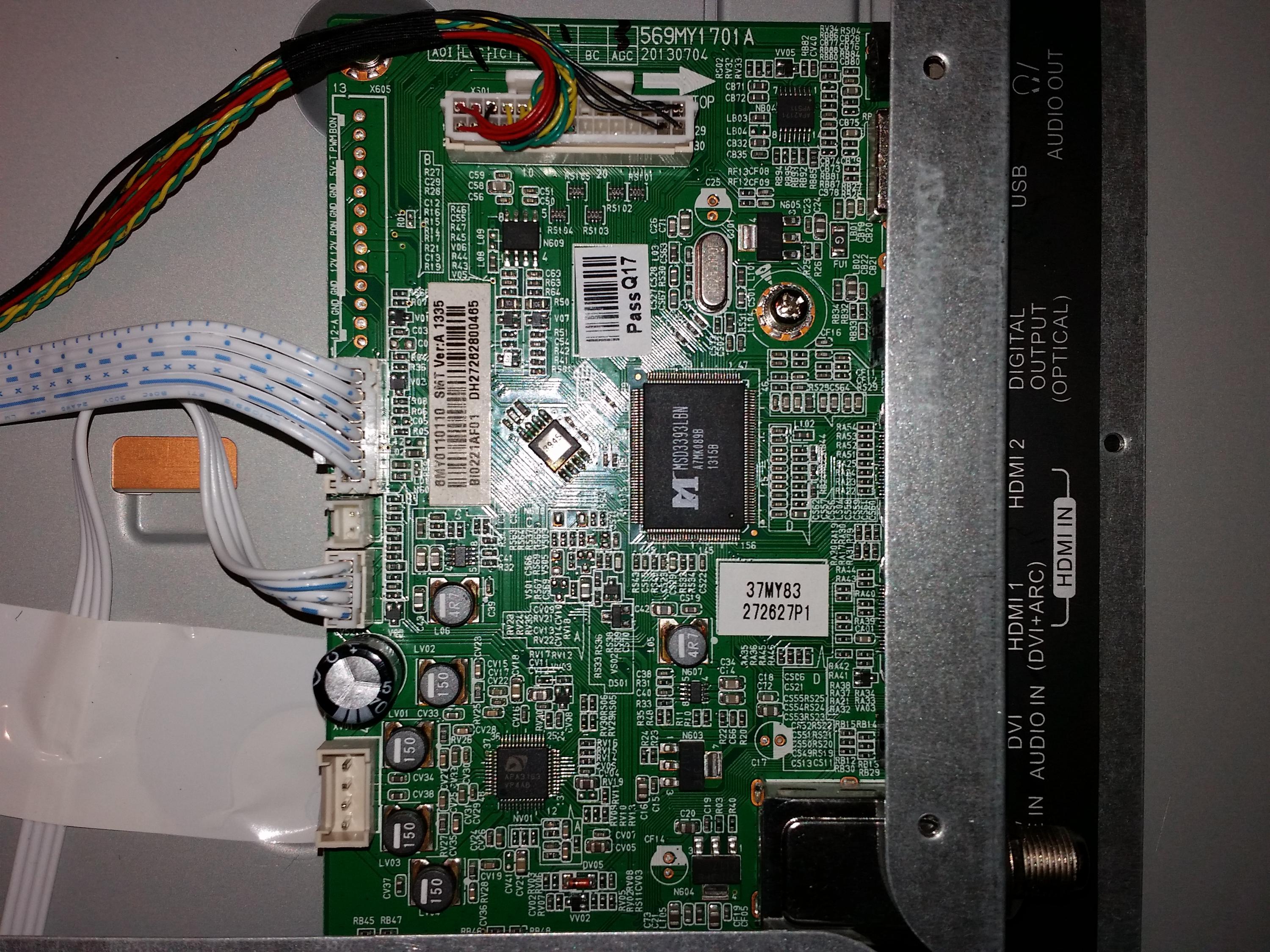

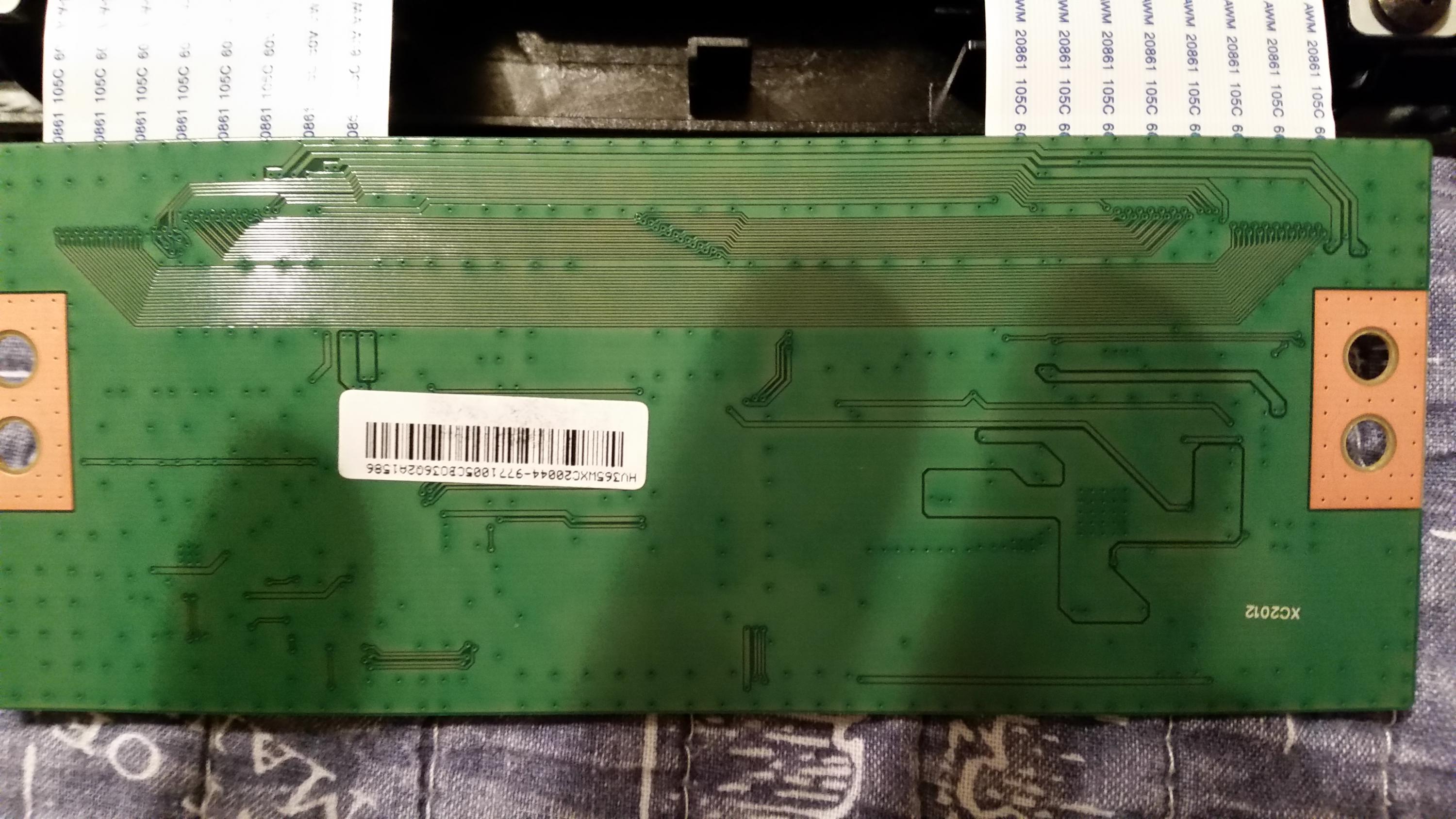

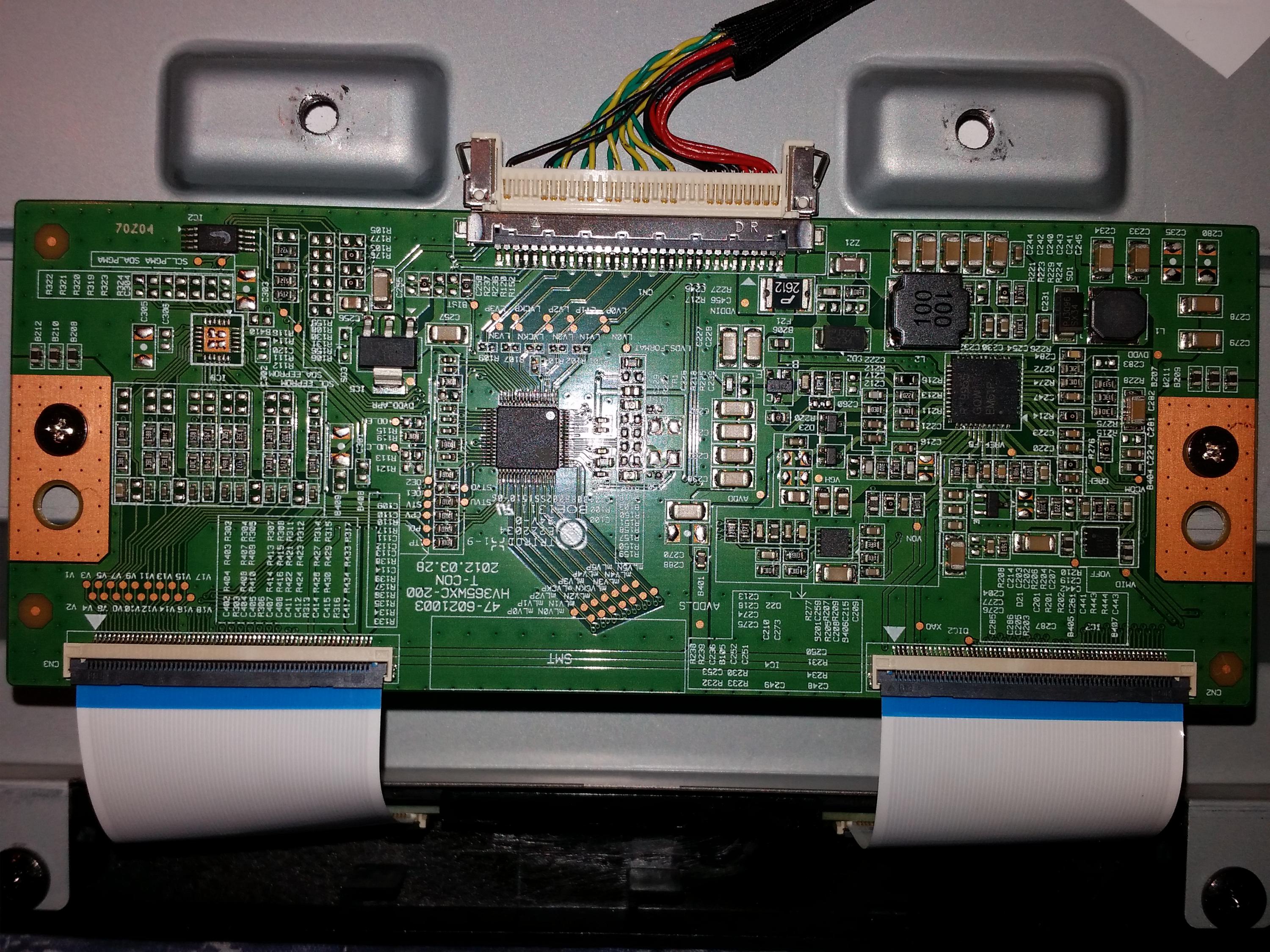

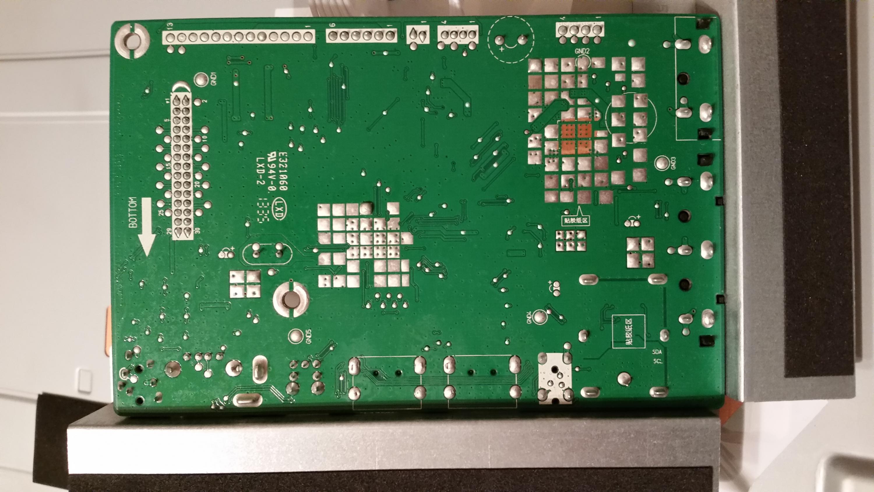

                  Here are the boards.
                  • youngkenzie
                    • Dec 2014
                    • 20
                    And here are some others.

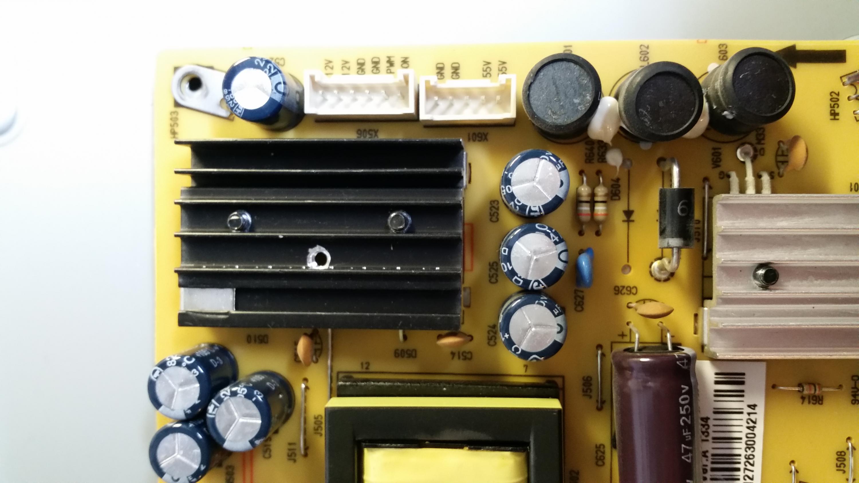

                      OK have just had a quick look but I cant work at it tonight
                      C525 looks a little bulged to me the way the light reflects - is it? have a look
                      flat across the end. What brand is it?
                      Also top left of the power supply there are 4 diodes looking at the back the
                      solder on the bottom one doesnt look great (maybe just the picture so check it out with a magnifying glass or just resolder them all.
                      Hopefully someone else on your side of the pond will join in and maybe spot a few other things and suggest a few tests.
                      I think this is an LED backlight - is it dim all over or are different sections dim?

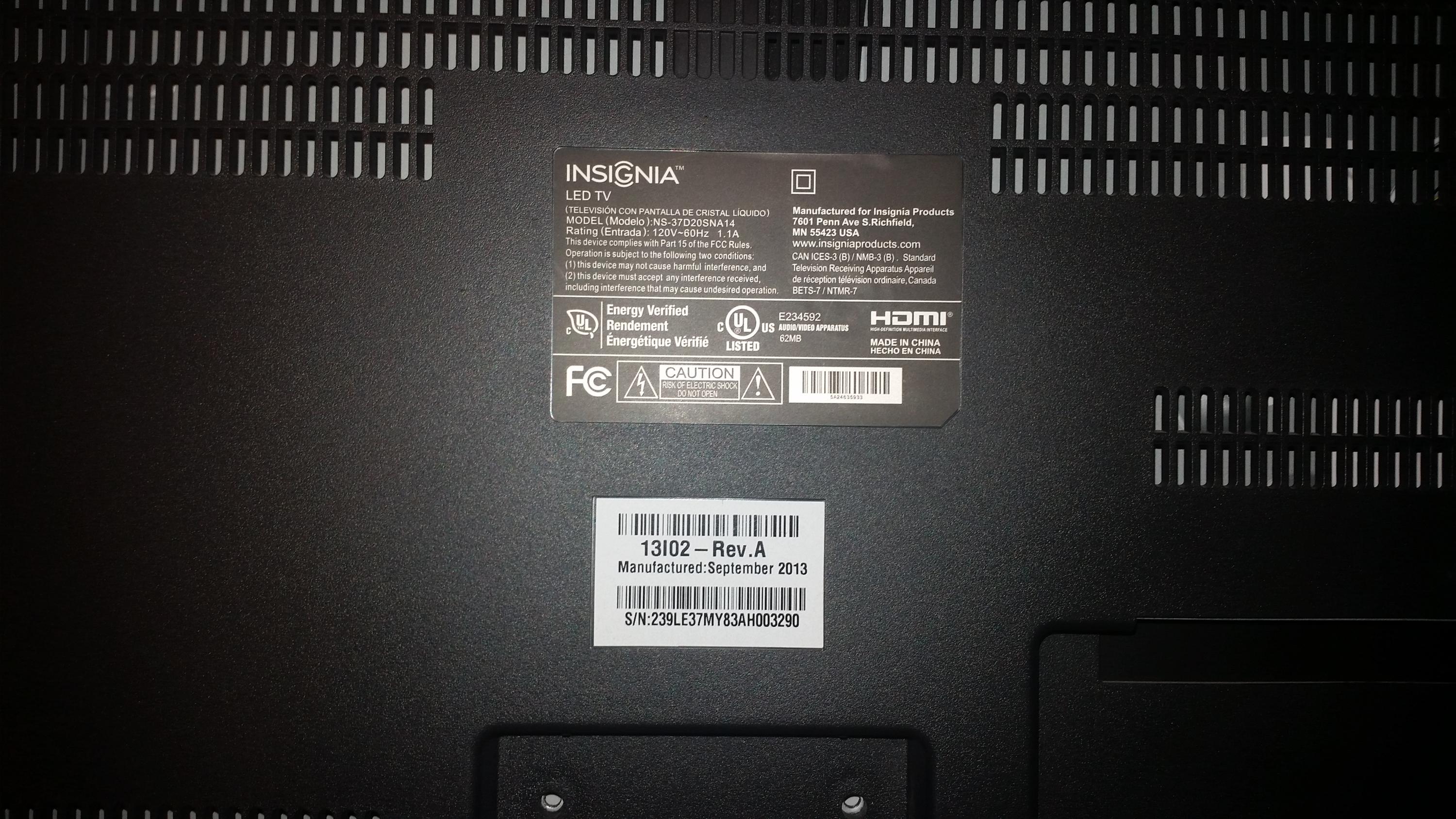

                        Thanks ill take a look when the kids go down. The whole tv is dim, like black... I can barley see any video input and I have to turn off the light in the room to even see it. Ill get back asap. Thanks again.
                        ps the brand of the tv is insignia. If your talking about the boards, im unsure.
                        • CapLeaker
                          Leaking Member
                          • Dec 2014
                          • 8351
                          That is a LED TV. The LED driver is combined with the power supply. Measure the voltage on X602 (LED output).
                          selldoor has a good eye. I looked at the same cap on two pictures and it sticks out a bit compared to the others. Maybe that is indeed a bad cap.
                          One more pic please of the top right of the power supply, without that cable plugged in, so we can see the pinouts too.
                                  Also c525 does look slightly bulged. Not trained in any of this but it does look swollen.
