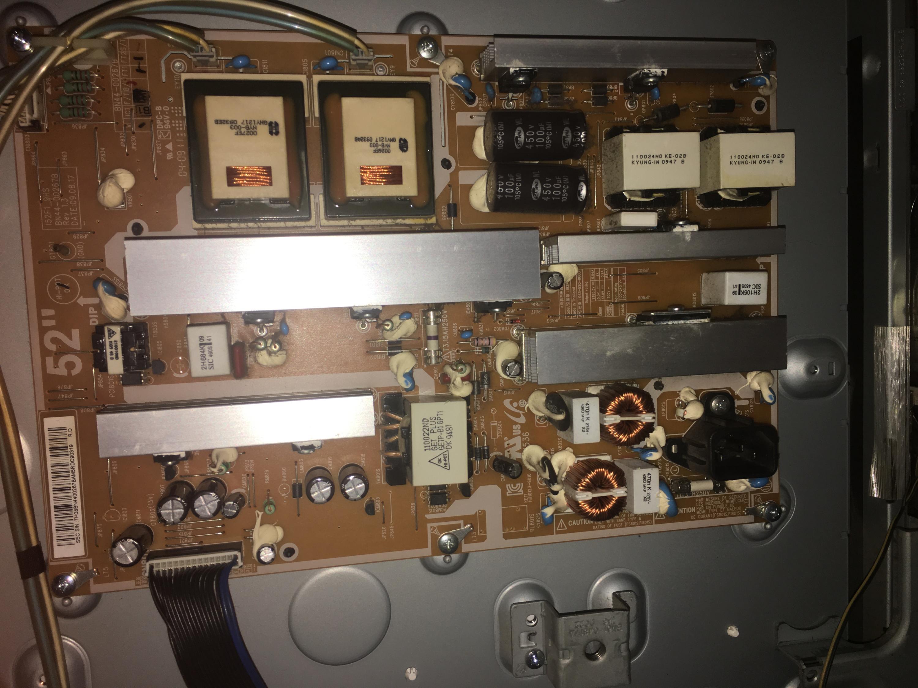

    Hello All,
    My Samsung LE52B620 started to have backlight flickering about a year ago, it would only last for about 10 mins and then the backlight would stay on.
    about a month ago the backlight flickering is constant and does not stop.
    I think it's a problem with the power supply board (BN44-00267b) or maybe the backlight is dying?
    I checked and all the caps look to be fine.
    I do not believe it is a problem with the mainboard, since I unplugged it from the power supply and the backlight came out but still flickers.
    I've attached a picture of the power supply board.
    Here is a video of the flickering occurring (uploaded to YouTube)
    Note: the longer the TV is on the brighter the screen will become, when I first it on, the backlight is quite low.
    Thanks again for the help guys!

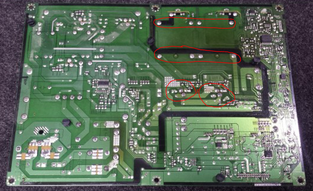

      Re: Samsung LE52B620 - Flickering backlight
      Originally posted by lotas
      There may be ring cracks here, try soldering
      Hello Lotas,
      Thanks for the suggestion.
      Ok I reflowed the solder in these areas.
      If I turn the TV with the mainboard unplugged, the blacklight turns on for about 5 seconds and then turns off.
      With the Mainboard plug, I get no backlight when turning out the TV. (I can see the menu's if I put a flashlight to the screen)
        Common problems through the models are when lamps are connected through connectors , the burnt or oxidized part, bad connection on inverter to balance board cables, bad caps are not possible since the inverter has an AC output.

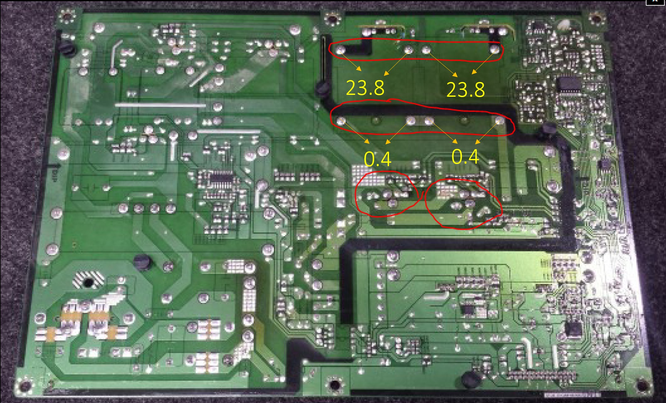

            Hello Lotas,
            I bought a cheap multimeter and checked the resistance of those spots and the readings were the same. (23.8 & 0.4, see attachment)
            What would be the next thing to check? also thanks for all the help so far!
              already said, unless you don't read me..

                  • cheeky2
                    • Dec 2012
                    • 337
                    • uk
                    Personally speaking if the power supply resolves your issue then I would swop over the two high voltage caps highlighted from your good one to your faulty one just to see if they are faulty and breaking down.

                      • sliceypete
                        • Jan 2013
                        • 8
                        The replacement board arrived last week and the TV worked after I did the swap.
                        I ordered some 22pF 6KV high voltage ceramic capacitor from ebay to replace the ones from my old board.
                        After replacing the two high voltage caps you pointed out, the old board it works without any flicker!! My TV is back up and running!
                        I think I will keep the replacement board just incase I run into anymore problems in the future. (if anyone on these forums needs a board, just PM me)
                        I really apprentice all the help I received!
