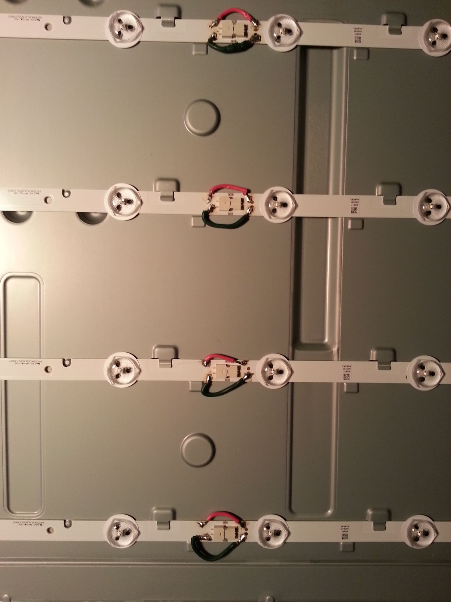

Insignia NS-37D20SNA14 Backlight going out. Flickering! Help!
  • instarep
    replied
    Re: Insignia NS-37D20SNA14 Backlight going out. Flickering! Help!
    Just checked, I have 2 like this on shelves in my garage. Just a few tap on the back et voilĂ . Thanks that wasn't an easy one... Happy that I will save them both!
    Leave a comment:
  • InsigniaTVBroke
    replied
    Re: Insignia NS-37D20SNA14 Backlight going out. Flickering! Help!
    Originally posted by cutlassbenbr
    Here is what I found with this TV. LED's have bad connections.
    THANK YOU. I REALLY didn't want to have to tear the screen out to inspect the LEDs and wiring until I saw your post. I had this problem too. I quickly found the point of discontinuity and bridged it. Double checked all of the LEDs according to this video and then bridged the remaining (working) connections for good measure. All fixed, and at no expense to me! Thanks!
    Leave a comment:
  • edgarlz123
    replied
    Re: Insignia NS-37D20SNA14 Backlight going out. Flickering! Help!
    Originally posted by cutlassbenbr
    Here is what I found with this TV. LED's have bad connections.
    Than you! I had exactly the same problem. Now working perfectly!
    Leave a comment:
  • rockjock83
    replied
    Re: Insignia NS-37D20SNA14 Backlight going out. Flickering! Help!
    Have same model on the bench and found 2 shorted LED's in the backlight LED strips. I believe the part # is: SVP370A33. I am starting to see this kind of problem more and more. Had a Sony and a Samsung with same issue. If anyone is familiar with a supplier for replacement LED's for these strips or for replacement LED strips, I would appreciate the info.
    Leave a comment:
  • OgreX
    replied
    Re: Insignia NS-37D20SNA14 Backlight going out. Flickering! Help!
    Originally posted by cutlassbenbr
    Here is what I found with this TV. LED's have bad connections.
    Awesome job dude!
    just wish I would have checked back sooner, oh well.
    (wasn't taking any chances with the solder job, lawl...)
    Leave a comment:
  • ajshoe
    replied
    Re: Insignia NS-37D20SNA14 Backlight going out. Flickering! Help!
    turned set on without screen. works now after replacing 3 bulging caps. see how long it lasts !
    Leave a comment:
  • ajshoe
    replied
    Re: Insignia NS-37D20SNA14 Backlight going out. Flickering! Help!
    have exact same tv - have apart like yours. can set be turned on without lcd screen attached ? so that the backlight leds come on by themselves ? Or are you applying 50 VDC to X602 to light LEDS ??? thanks
    Last edited by ajshoe; 01-27-2016, 04:40 PM.
    Leave a comment:
  • cutlassbenbr
    replied
    Re: Insignia NS-37D20SNA14 Backlight going out. Flickering! Help!
    Originally posted by OgreX
    Anyone have any clue to the actual issue that all these tv's seem to inevitably face?..(seems quite common sadly..) and "nomadder I'd have to wager against your fix lasting too terribly long sadly...(happy to be wrong though!)
    Pretty obvious they are designed to fail.... overheating seems a "large" concern.
    ..grandfather wanted me to order a new power board. not worth his money imo.
    Here is what I found with this TV. LED's have bad connections.
    Leave a comment:
  • CapLeaker
    replied
    Re: Insignia NS-37D20SNA14 Backlight going out. Flickering! Help!
    Maybe make your own tread, put in some hi res pictures of your boards, describe exactly what your TV is doing or not doing, provide measurements with pin out on the connector that goes from the PSU to the main board, service manual etc.
    That will wake more interest in things. Since your TV isn't working anymore, we have to start again at square one.
    Leave a comment:
  • OgreX
    replied
    Re: Insignia NS-37D20SNA14 Backlight going out. Flickering! Help!
    Capacitors are not equal... there are good ones and there are bad ones. We don't know what brand, what series and what temperature rating he put in. If he had replaced them with a generic capacitor that is only good for 85C, 3 weeks sounds about right!
    Kinda assuming that was aimed at me:
    "Nippon Chemi-Con Hi Temp 105°C
    47uF 100 volt 20% radial leaded electrolytic capacitors."
    Were those a terrible choice?
    Idk, there's not much info on this tv on the net.. only people replacing caps/whole power supply with the problem still persisting that I can find... thoughts?
    Leave a comment:
  • CapLeaker
    replied
    Re: Insignia NS-37D20SNA14 Backlight going out. Flickering! Help!
    Capacitors are not equal... there are good ones and there are bad ones. We don't know what brand, what series and what temperature rating he put in. If he had replaced them with a generic capacitor that is only good for 85C, 3 weeks sounds about right!
    Leave a comment:
  • OgreX
    replied
    Re: Insignia NS-37D20SNA14 Backlight going out. Flickering! Help!
    Anyone have any clue to the actual issue that all these tv's seem to inevitably face?..(seems quite common sadly..) and "nomadder I'd have to wager against your fix lasting too terribly long sadly...(happy to be wrong though!)
    Pretty obvious they are designed to fail.... overheating seems a "large" concern.
    ..grandfather wanted me to order a new power board. not worth his money imo.
    Last edited by OgreX; 09-10-2015, 01:14 AM.
    Leave a comment:
  • OgreX
    replied
    Re: Insignia NS-37D20SNA14 Backlight going out. Flickering! Help!
    I have the same model tv and had the same problem. I replaced all of the caps on the led driver side of the power board and the tv now works well.
    Thanks this thread helped me.
    Did you replace every single capacitor?
    I replaced only the 3 100v caps.(C524,C525,C523) in my grandfather's tv. It lasted 3 weeks before going right back to no leds, with sound playing.
    It lasted a week just taking the tv apart, unplugging the led cable and putting it back together the first time(evil tv.)
    Leave a comment:
  • nomadder
    replied
    Re: Insignia NS-37D20SNA14 Backlight going out. Flickering! Help!
    I have the same model tv and had the same problem. I replaced all of the caps on the led driver side of the power board and the tv now works well.
    Thanks this thread helped me.
    Leave a comment:
  • nomoresonys
    replied
    Re: Insignia NS-37D20SNA14 Backlight going out. Flickering! Help!
    maybe double check your solder joints on your new caps.
    Leave a comment:
  • rosettastoned
    replied
    Re: Insignia NS-37D20SNA14 Backlight going out. Flickering! Help!
    Wondering what you found to be the problem. I have the same model doing the same thing.
    Leave a comment:
  • youngkenzie
    replied
    Re: Insignia NS-37D20SNA14 Backlight going out. Flickering! Help!
    running test in the morning. Ill have answers around noon. Again thank you to everyone contributing the time to help.
    Leave a comment:
  • CapLeaker
    replied
    Re: Insignia NS-37D20SNA14 Backlight going out. Flickering! Help!
    What is the TV doing now? Does it turn on? Is there something on the LCD and sound, but no backlight? Is the backlight trying to come on, flickering or something? If you have a good board and you get something on the LCD itself and sound, then there is only 2 more things. Either a LED wiring harness problem or a LED has burnt out. But I asked you questions already on my last post, I didn't get any answer for.
    Last edited by CapLeaker; 01-23-2015, 05:32 PM.
    Leave a comment:
  • youngkenzie
    replied
    Re: Insignia NS-37D20SNA14 Backlight going out. Flickering! Help!
    ok.... bought new power supply/ led driver board, installed it, still nothing....anybody have a solution?
    Leave a comment:
  • CapLeaker
    replied
    Re: Insignia NS-37D20SNA14 Backlight going out. Flickering! Help!
    Back to the X602 connector. There should be something like 30V to 70V there. Try to measure that again with both meter leads on those 2 pins. Then try the same thing again with the connector unplugged. What does the back light do when you turn on the tv? Does it come on for a brief period and turn off, or is it off all the time? Another idea is that the backlight cable is shorted out to the chassis.
    btw... 36$ buys a new power supply / led driver board.
    Last edited by CapLeaker; 01-20-2015, 08:03 PM.
    Leave a comment:
  • k24a1
    TongFang GK5CN5Z (CyberPowerPC Tracer III Xtreme) LCD backlight flickering
    by k24a1
    Hello, I have a strange issue with a laptop that I'm working on fixing up for a friend of mine, and it appears as though the LCD backlight control is not reliable. The LCD backlight flickers sometimes with inconsistent brightness. The controls are no better.. when I go 1/3 of the way in the brightness controls it will get bright but flicker quite obviously, and when I go all the way to what SHOULD be full brightness, it becomes darker. The flickering is less severe at lower brightness, but more severe at higher. the backlight will literally flicker on and off when I set it to the lowest brightness...
    06-11-2024, 05:45 PM
  • sliceypete
    Samsung LE52B620 - Flickering backlight
    by sliceypete
    Hello All,
    My Samsung LE52B620 started to have backlight flickering about a year ago, it would only last for about 10 mins and then the backlight would stay on.
    about a month ago the backlight flickering is constant and does not stop.
    I think it's a problem with the power supply board (BN44-00267b) or maybe the backlight is dying?
    I checked and all the caps look to be fine.
    I do not believe it is a problem with the mainboard, since I unplugged it from the power supply and the backlight came out but still flickers.
    08-04-2021, 05:11 AM
  • triplefour
    by triplefour
    09-13-2023, 10:43 PM
  • EffiSon
    Lenovo Y50-70 - LA-B111P Rev:1A Flickering laptop screen after shorten the R205 resistor/ backlight restoration ?
    by EffiSon
    Hi. Could anyone on the forum help me find the cause of the problem?
    The board is LA-B111P Rev:1A comes from Lenovo Y50-70.
    I have a identified the damaged R205 resistor, and connect a jump wire over it So it restores the backlight but causing strange problems
    1. With Battery ONLY plugged in laptop works fine
    2 .With Charger ONLY plugged in laptop works fine as well
    3. Connecting both battery and charger at the same time shows a strange flickering screen. The flickering is not constant, it is completely random (and I think it depends on the load
    01-29-2024, 04:03 PM
  • HighwayStar89
    Lenovo B50-80 won't boot, backlight flickering
    by HighwayStar89
    Hi to all,
    I have this laptop that suddendly won't boot.
    When I plug the power adapter, the charging LED turns on.
    When I press the power button, I can hear the fan spinning, and the screen start flashings, with the frontal green LED flashing too.
    No other vital signs.
    I reseated the RAM, changed the RAM, changed CMOS battery, disassembled, cleaned, and reassembled all the boards, changed thermal paste and reflowed, tried the NOVO button (the tiny reset button on the right side) to enter BIOS, tried F2 or Fn + F2, changed power adapter, but with no luck.
    I think...
    11-08-2025, 08:04 AM
