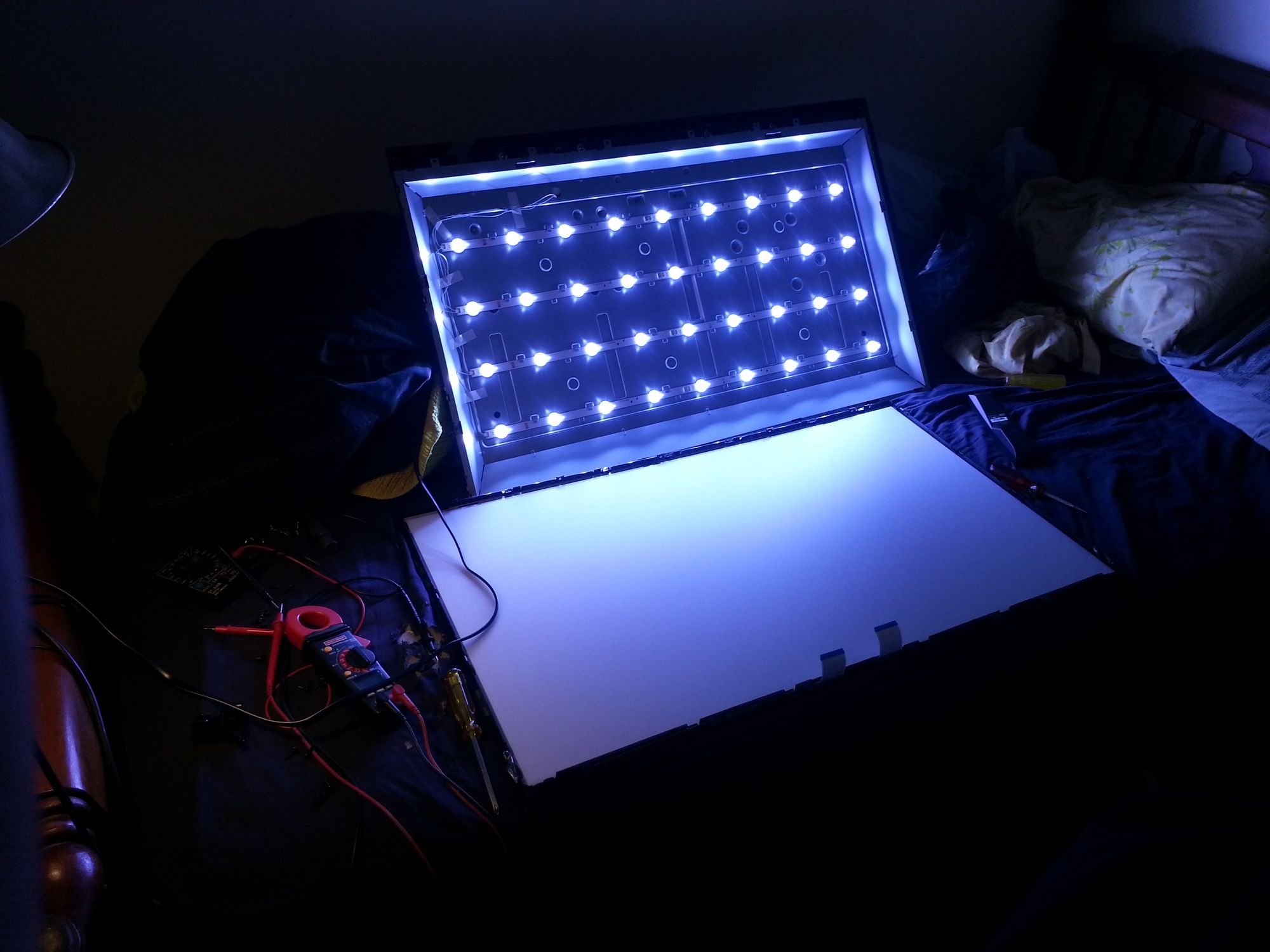

    turned set on without screen. works now after replacing 3 bulging caps. see how long it lasts !

      Originally posted by cutlassbenbr
      Here is what I found with this TV. LED's have bad connections.
      Awesome job dude!
      just wish I would have checked back sooner, oh well.
      (wasn't taking any chances with the solder job, lawl...)

        Have same model on the bench and found 2 shorted LED's in the backlight LED strips. I believe the part # is: SVP370A33. I am starting to see this kind of problem more and more. Had a Sony and a Samsung with same issue. If anyone is familiar with a supplier for replacement LED's for these strips or for replacement LED strips, I would appreciate the info.
          Than you! I had exactly the same problem. Now working perfectly!
            THANK YOU. I REALLY didn't want to have to tear the screen out to inspect the LEDs and wiring until I saw your post. I had this problem too. I quickly found the point of discontinuity and bridged it. Double checked all of the LEDs according to this video and then bridged the remaining (working) connections for good measure. All fixed, and at no expense to me! Thanks!
