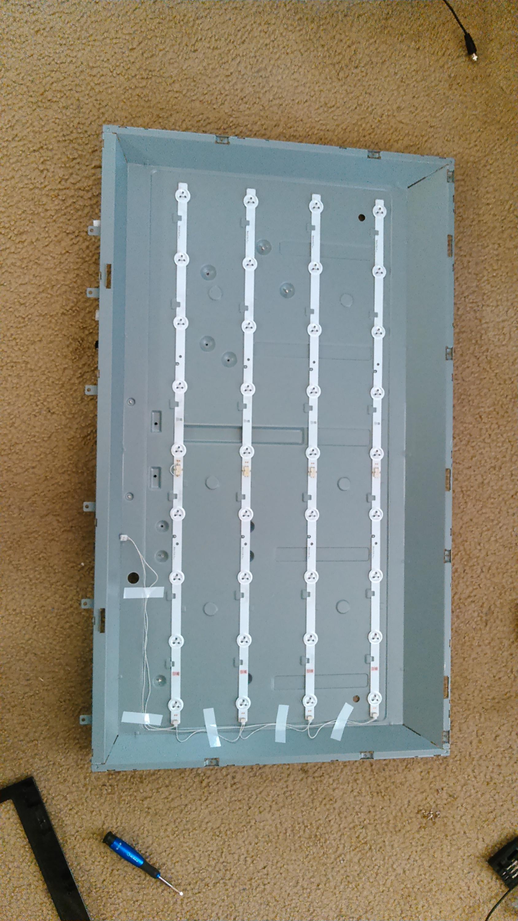

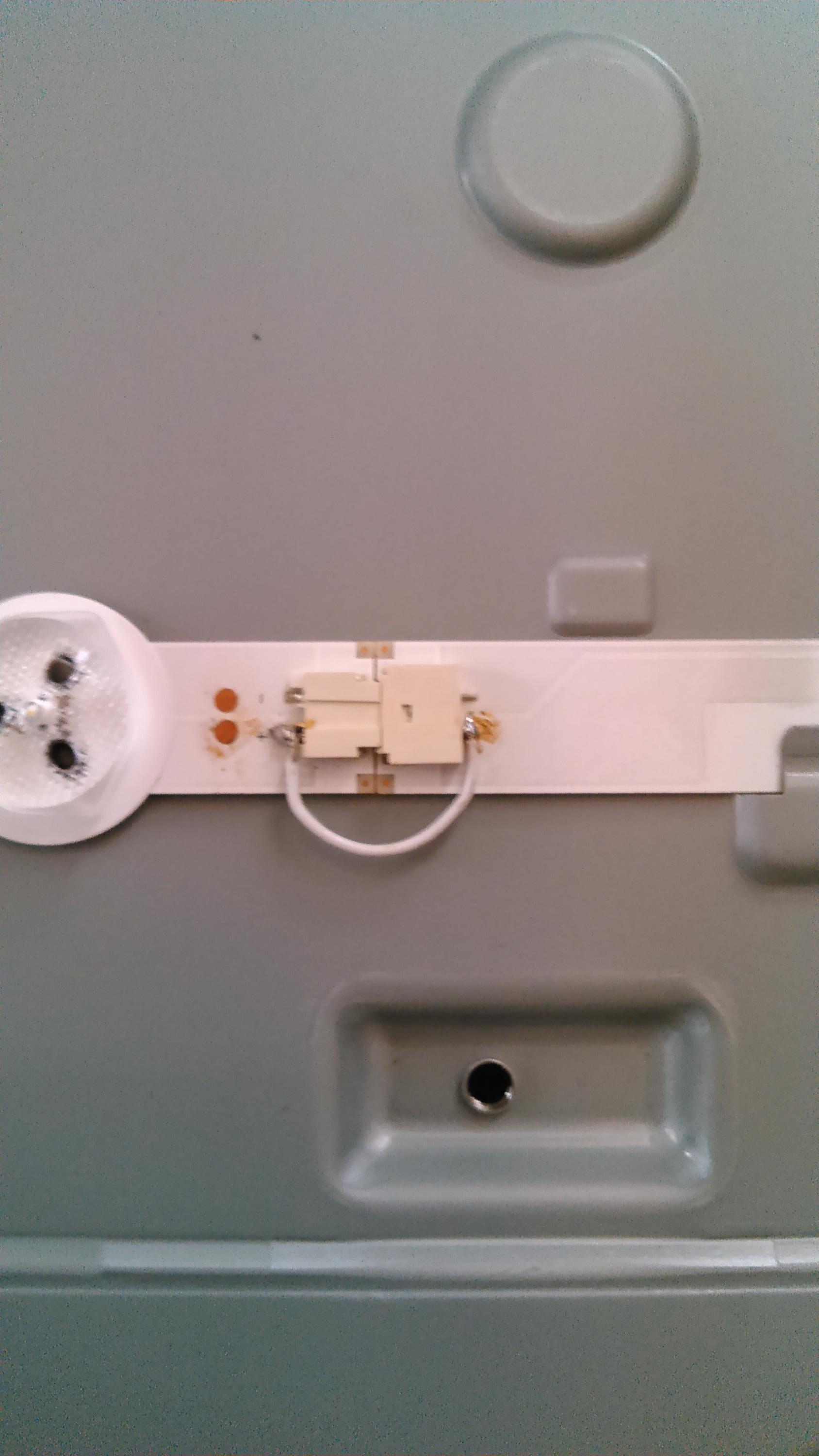

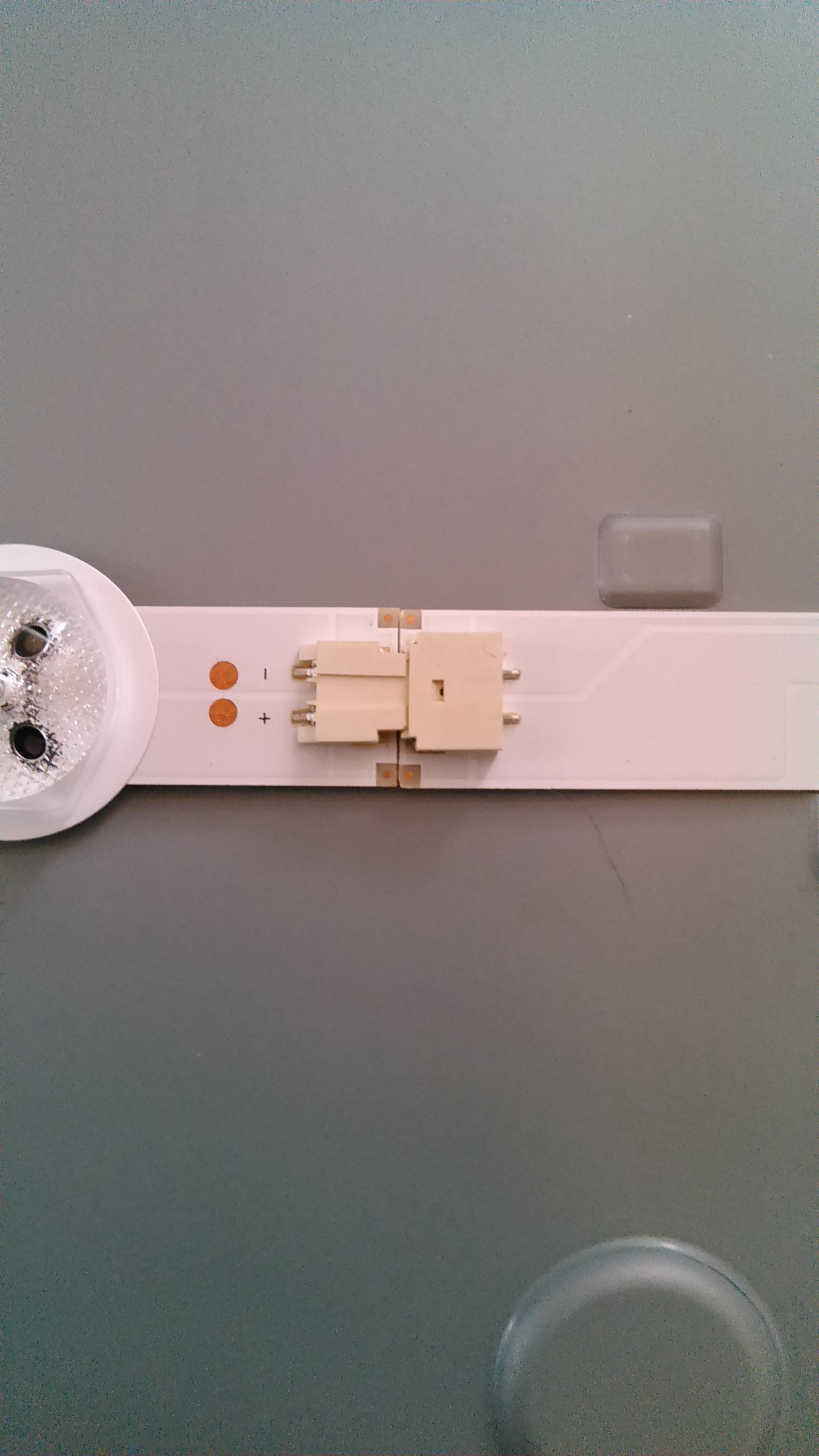

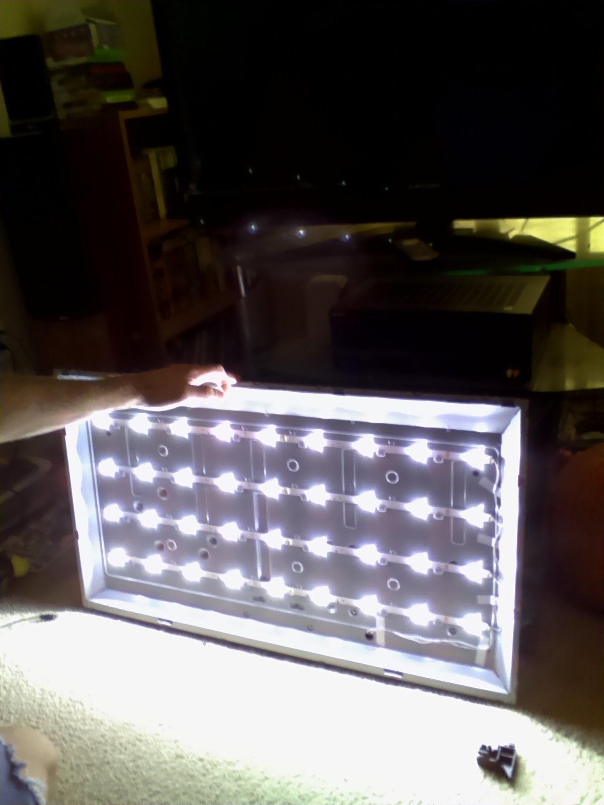

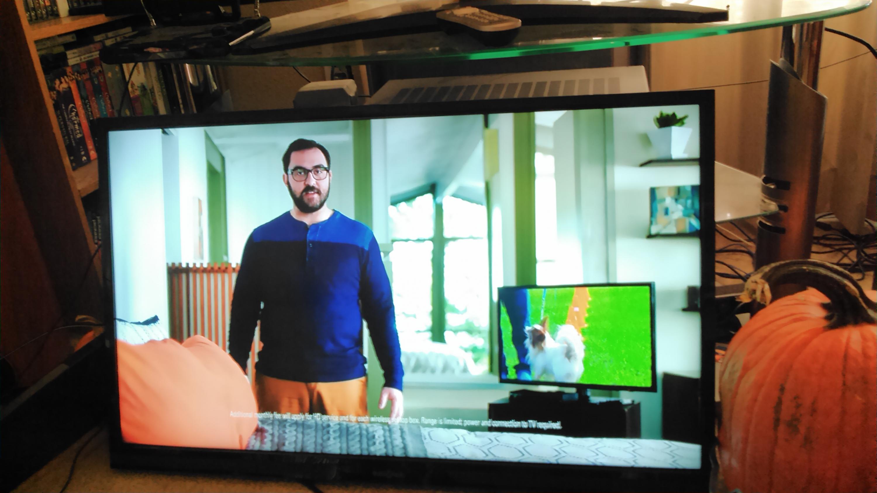

                                      • cutlassbenbr
                                        • Nov 2014
                                        • 3
                                        #39
                                        Re: Insignia NS-37D20SNA14 Backlight going out. Flickering! Help!
                                        Originally posted by OgreX
                                        Anyone have any clue to the actual issue that all these tv's seem to inevitably face?..(seems quite common sadly..) and "nomadder I'd have to wager against your fix lasting too terribly long sadly...(happy to be wrong though!)
                                        Pretty obvious they are designed to fail.... overheating seems a "large" concern.
                                        ..grandfather wanted me to order a new power board. not worth his money imo.
                                        Here is what I found with this TV. LED's have bad connections.
