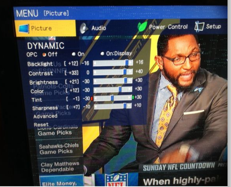

Trying to avoid what might be another Ebay disaster. Buyer is buying a mainboard (along with a tcon) to "fix" this problem. He says the lines are green in color, and other pictures he had show them being even darker. They look kind of random and all over the screen to me. Based on what I know, I thought this could maybe be a panel problem. As the main is kinda pricey, I don't want to send this to him, only to hear complaints or begging returns because a bad panel was the culprit. Thanks!

This does not look like a panel problem at all to me.A working TV? How boring!Originally posted by PeteS in CARemember that by the time consequences of a short-sighted decision are experienced, the idiot who made the bad decision may have already been promoted or moved on to a better job at another company.Comment

I have seen Double images due to bad tab bonding.

Something like this I would re-seat the cables, heating and cooling the board, flex the panel, etc.Never stop learning

Not a panel issue IMHO.Please do not PM me with questions! Questions via PM will not be answered. Post on the forums instead!

Thanks for the input. I normally keep a "hands off" approach to any of my miscellaneous ebay activity, and almost never post about it on a forum like this. Mainly , because I have enough problems I need help with myself
Like I said, I'm just hoping the mainboard and/or the mainboard/TCON combo will fix this particular buyer's set ... because of how it is on the bay nowadays. You sell a TV part on there, and all of a sudden you are responsible for the part AND fixing the buyers set ... all for absolutely zero money ... and if things don't go right often abuse/hassle/cost on top of it.Comment
