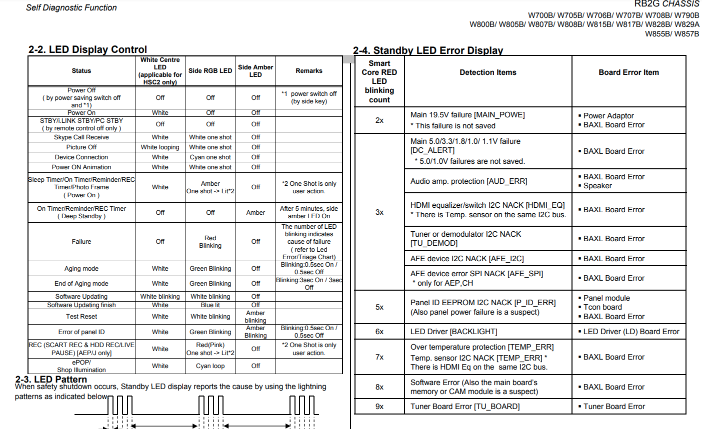

    Hi, this has panel problem for certain (AUO panel), in the troubleshooting process, after pressing ON button i am with set making a short lamp of backlight with status light shortly white then green/yellow repeated, in this situation main board remain powered and also tcon with all their correct output voltages. I cant find in the service manual description of this state, can you brief me ? thanks

    If it goes into blinking mode on alternately yellow - green, then it requires an update via USB.

        Yes i was just watching now YouTube videos saying this, the tv needs an update because i have changed tcon board that was broken also, my question is, after upgrading i will have latest software installed , some years ago i bought two pmic chips to repair original tcon, if i succesfully repair it then mainboard probably will not recognize it as an original component and needs a new update, but since no more new versions available i need to copy tcon eeproms or what? thanks
        ps: the panel is not already repaired, needs further efforts

                I have flight over the doubts and done the usb update, surprisingly immediately appeared a near perfect image, the first time i have seen one, there are some intermittent black lines , there was a tape masked pin made by me and there is a shorted burnt trace onto the last tab, therefore there is more work to do...

                      Bad news.. very bad news, after the replacement tcon brokes i have put back original tcon, the previous situation where it requests for an update returned, but now it refuses to load it!!! My premonition was right!!
                      I ask to experienced users: i have noticed that plugging the power in when keep pressing On button brings to a different state with blue led steady in standby position, leaving button and pressing it again if i remember brings to a pulsating white led but no update beginning, also in subsequent boots, what stands for this function?

                        1. Try to disconnect the LVDS cable from the T-CON and turn on the TV, as soon as the error lights up without turning off the TV abruptly and without distortions, insert (connect) the LVDS back to the T-CON.
                        2. If the update does not pick up, then rename your update file to "upgrade_loader.pkg" (without quotes).

                            Executed a forum search here, two things came out, no one knows about the blue led procedure, except the Sony aut. serv. centers obviously, the method of renaming the file did not worked so i think i will have to think a different method first..

                              LED Display Control

                                Maybe i am out of slime.. executed renaming ( same folder), put pendrive in tv, done the blue light procedure, waited pendrive led stop after few pulses, removed power, reinserted, white led does 3 - pause - 7 pulses, then turned on with key, tv turned on with backlight an maybe an image, tcon is broken, i see only vertical many colors lines. Thanks Lotas.. again..
