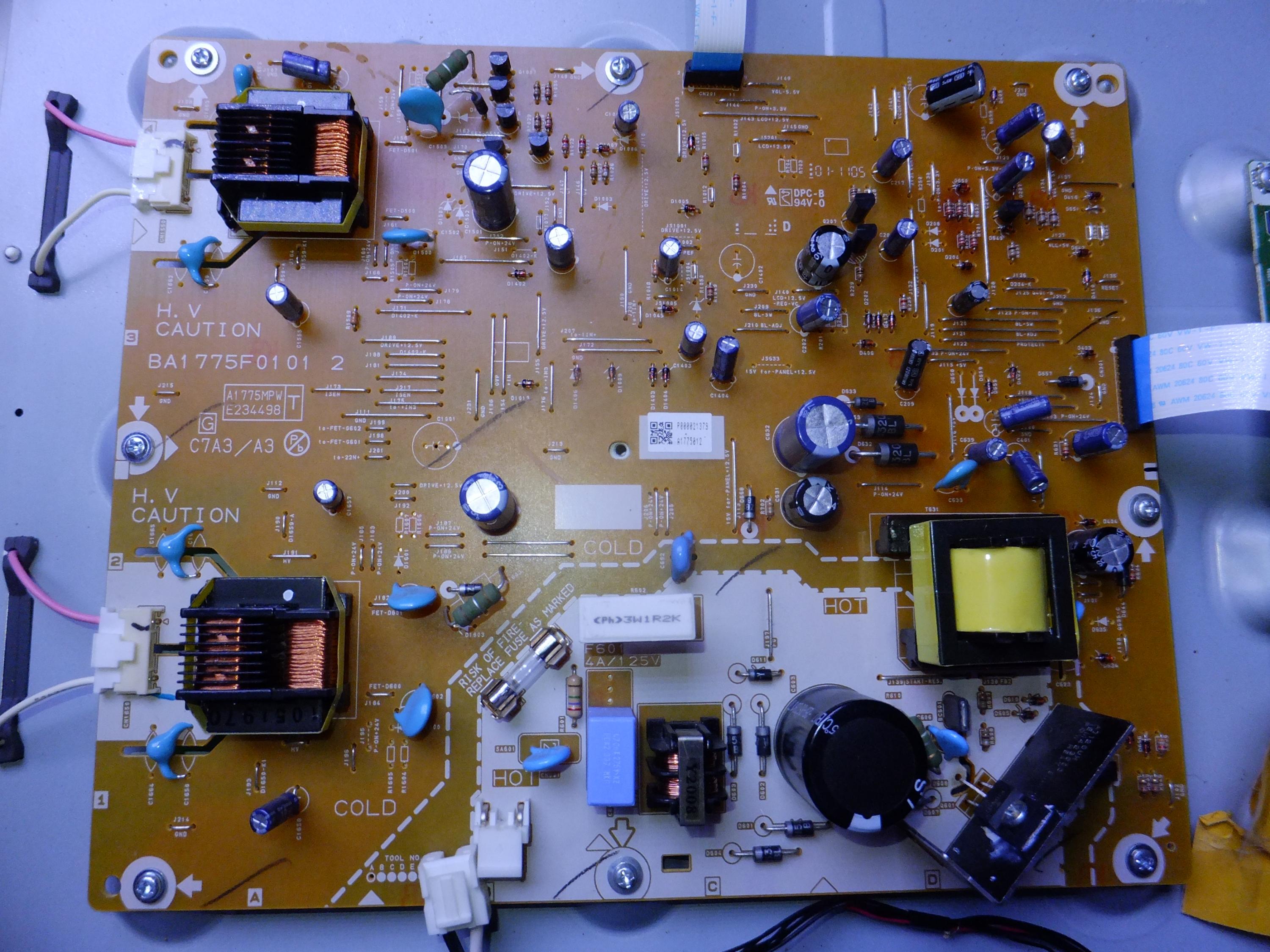

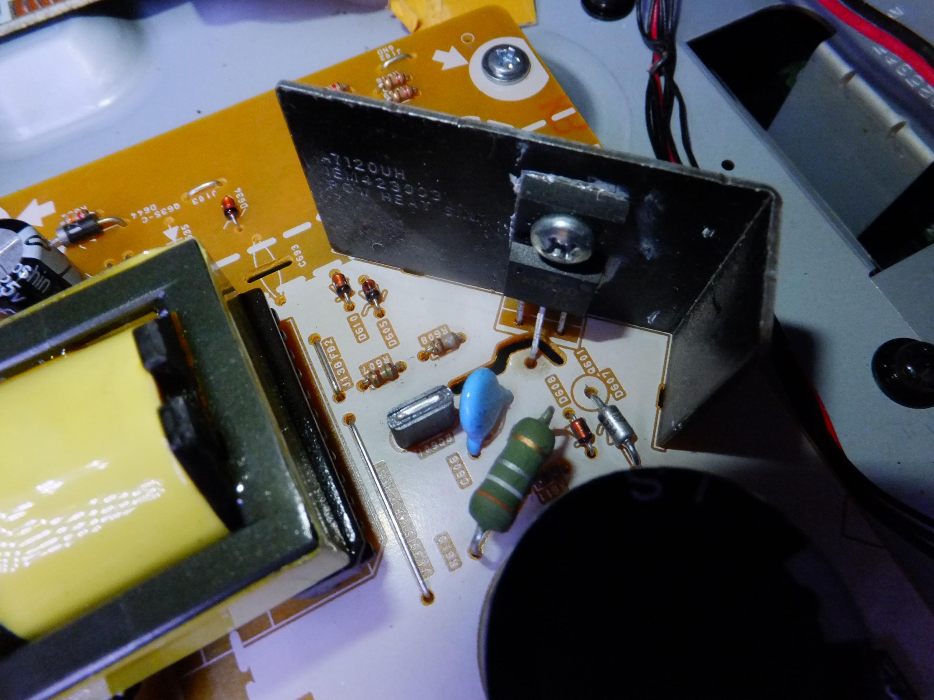

            I need help, I have this Emerson lc220em2. I opened it up and there was a blown fuse but the transistor at Q601 is missing. Does anyone know what the part number is for Q601? I tried putting a common one in but doesn't seem to be working.
            • dick_barton
              • Aug 2015
              • 6643
              • Wales
              Re: Emerson lc220em2 blows fuse
              Q601 given in the manual above in post #2 is a Mosfet 2SK3561

                • Shane711
                  • Dec 2014
                  • 493
                  That manual in post #2 does not have my board. It has boards for LC220EM1 and my TV is a LC220EM2.
                    Thanks budm, that is the Service manual I need. Busy looking it over now.
                      Make sure to check ALL the diodes on that board, the inverter MOSFETs, and the Transistors in the primary side.
                      Lots of parts in the primary side get wiped out when the secondary side has shorted circuit.
                          OK, so it looks like TK7A50D is the part number. That is not what I put in that spot. I will have to order some. Thanks a lot. I replaced some of the other parts already. but Q601 was missing entirely. I just checked over the board again and I think I got everything. Now I just have to wait for Q601 to be delivered.
