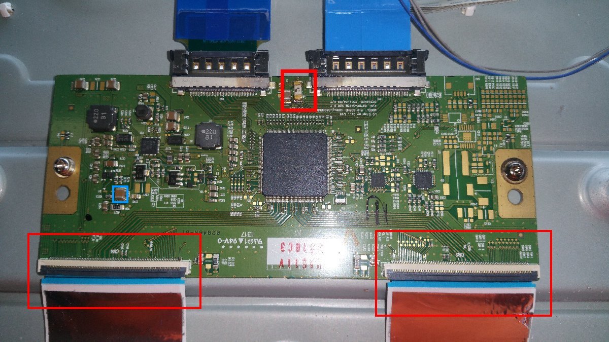

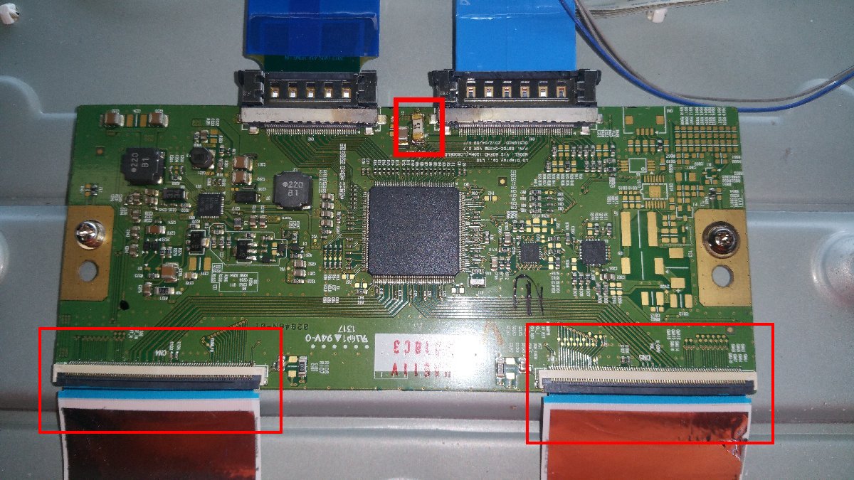

    I have a 60LN5400 that came in.. Backlights work fine.. No display..
    Traced the problem to the TCON board.. Blown fuse..
    Replaced the fuse.. Blows again.. Replaced the fuse again... This time it fries the marked part on the Main Video board...

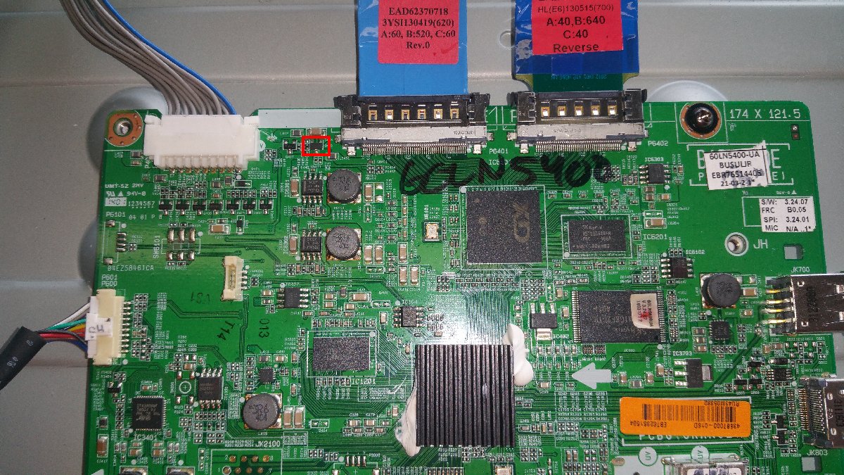

    Got a new Main Video Board.. Replaced the fuse on the TCON..
    The fuse is fine and the backlights come on fine if I don't have the cellophane connectors from the TCON to the Panel..
    So, I am figuring that ONE of the panel boards are bad.. Try it with the left panel board disconnected, right panel board connected... Blows fuse..
    Try it with the left panel board connected and the right panel board disconnected.. Blows fuse.
    So far, the component on the Main Video Board is OK. Thank the gods for small favors..
    So, I am now guessing that there is a short on BOTH panel boards..
    So, my question is, is there any meter diagnostics I can try to track it down and/or is there anything I can do about it even if I CAN track it down??
    It's a nice TV... Would hate to trash it because of this if it can be fixed somehow..
    Any assistance would be most appreciated...

        Check the small ceramic caps on tcon for shorts, can use diode mode probe on each end if it beeps probably a short somewhere, if any beep unhook tcon from panel like you did one side at a time then both if needed and see if they still read bad.

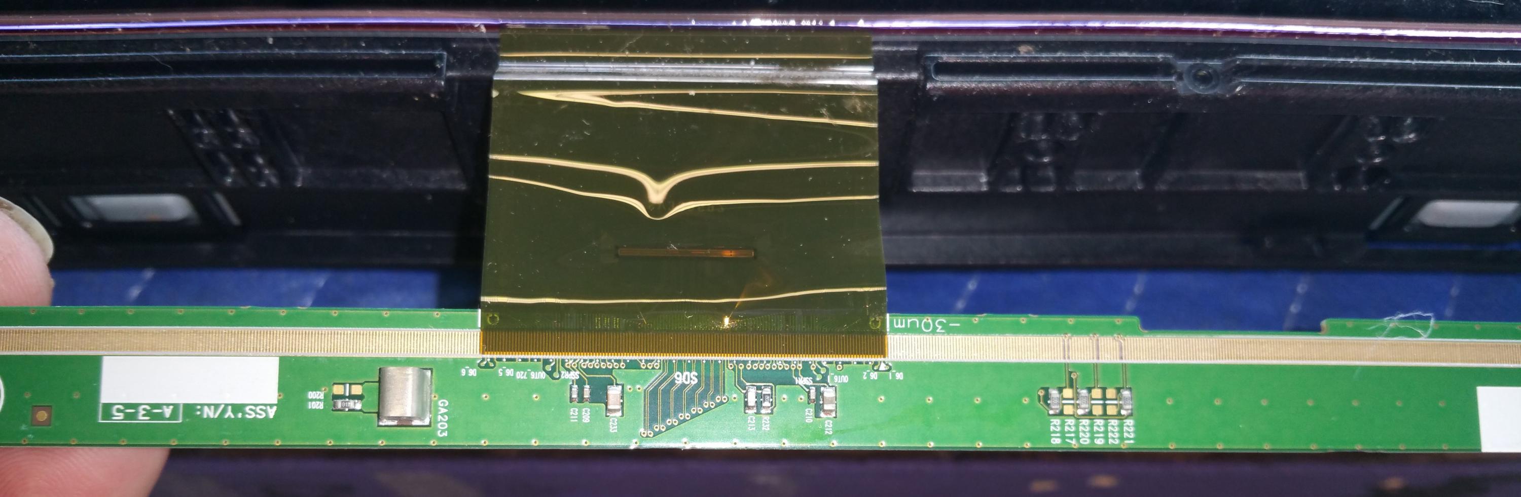

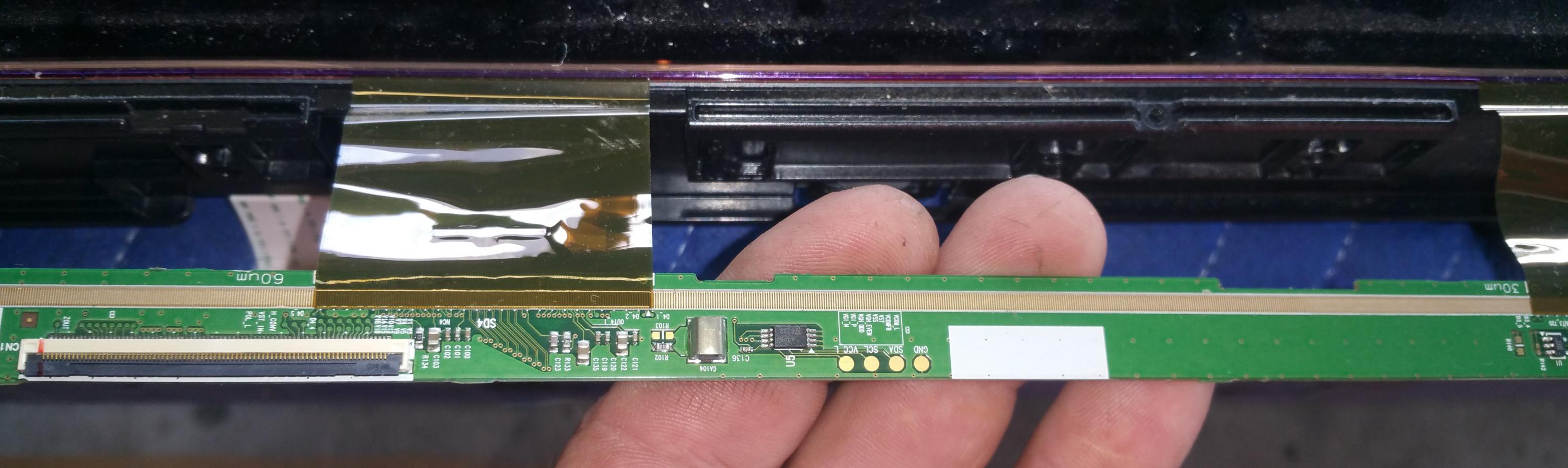

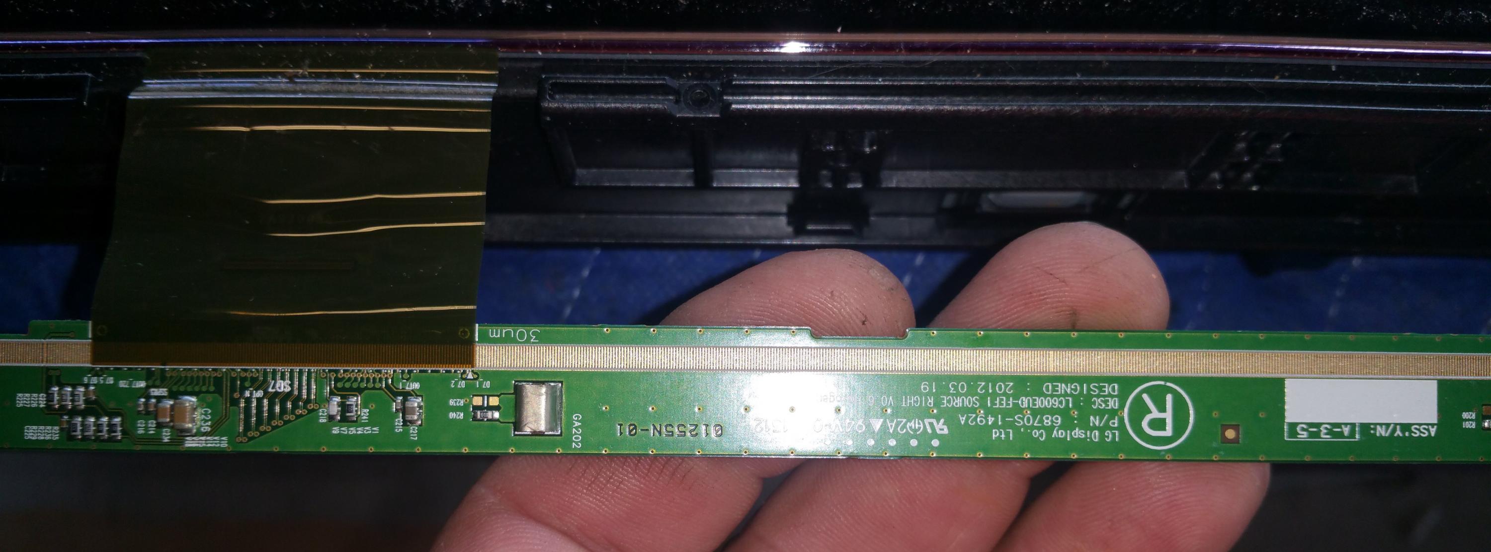

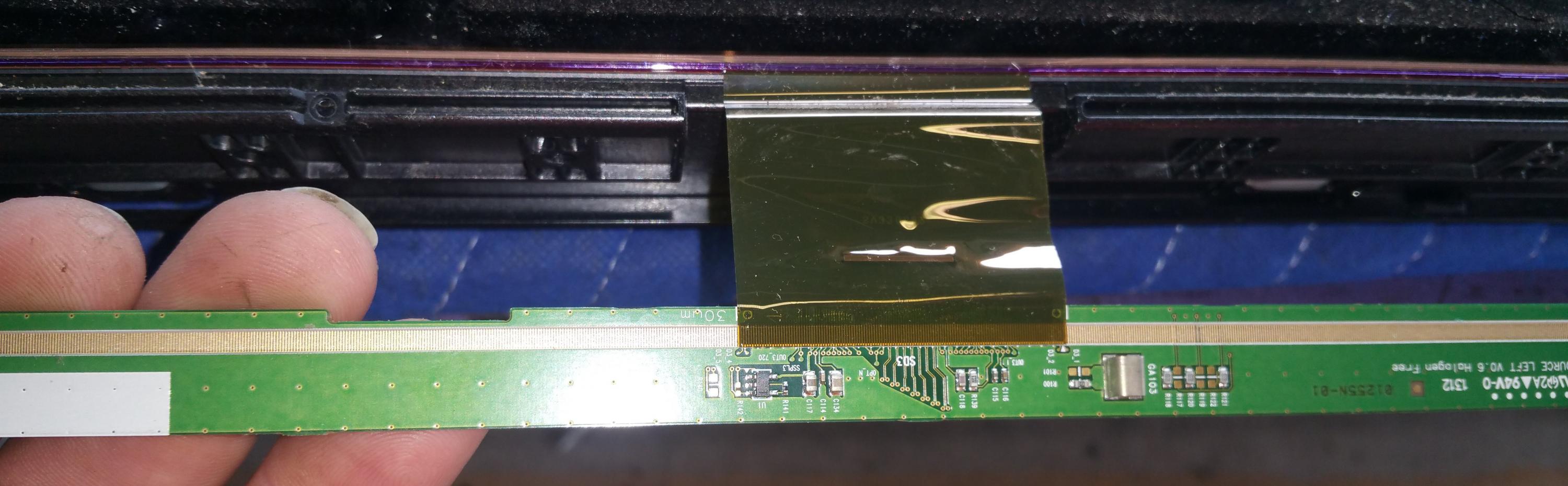

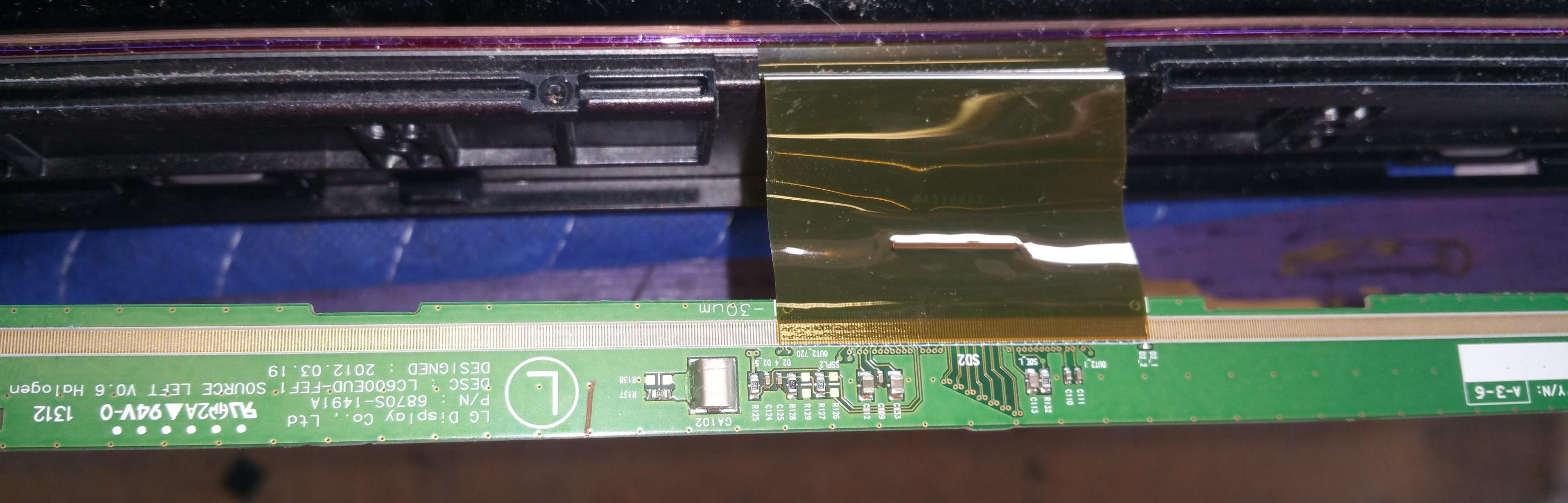

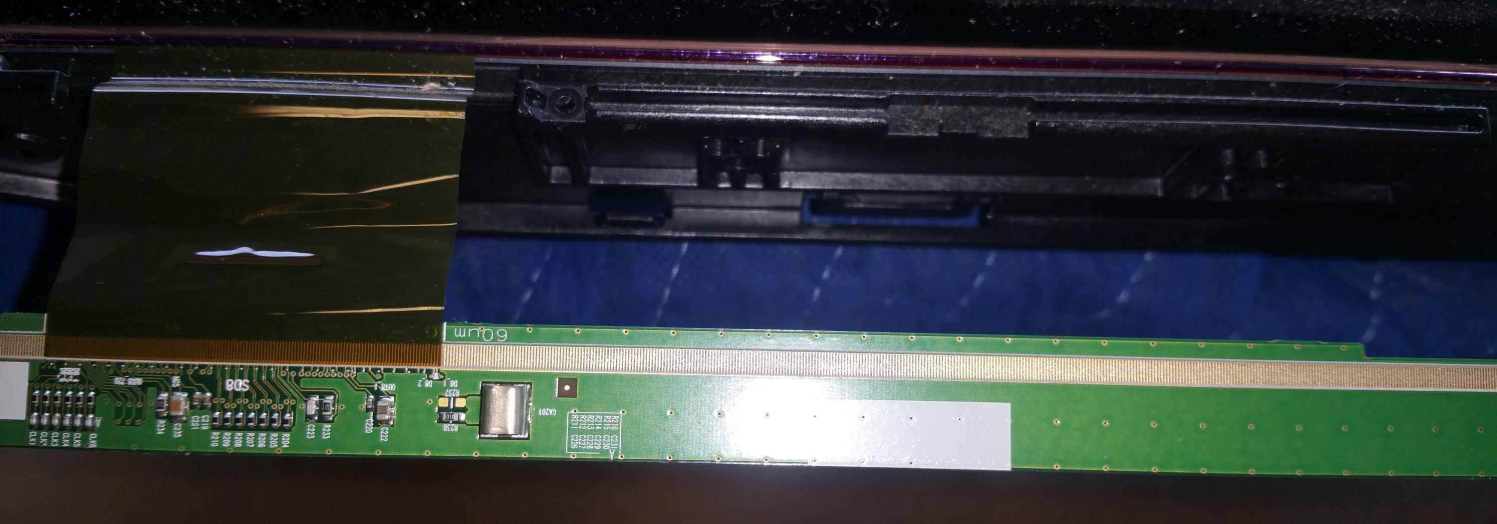

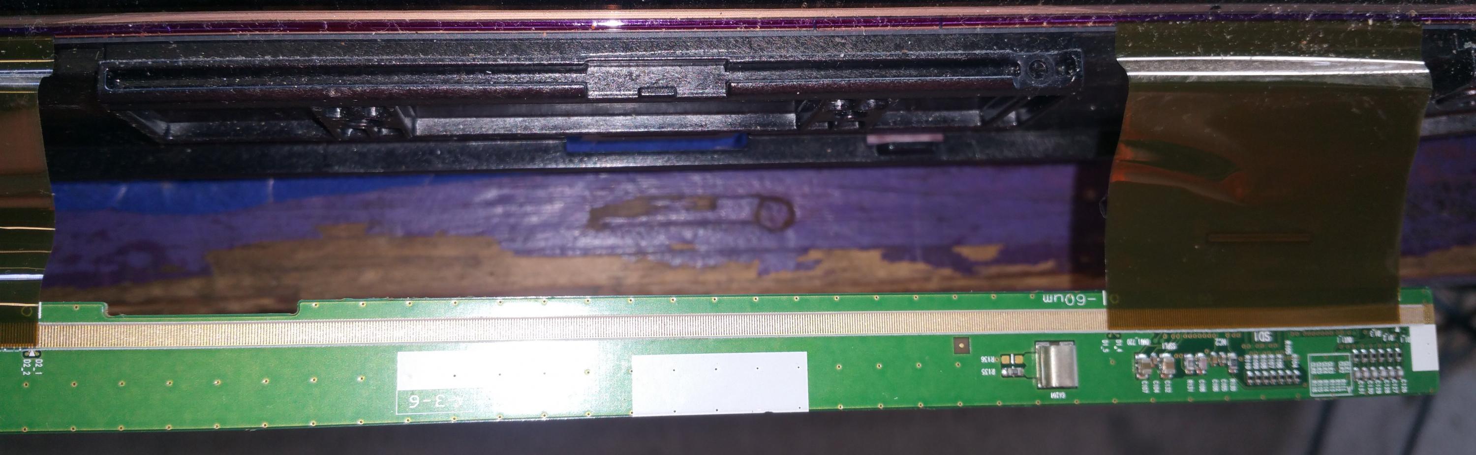

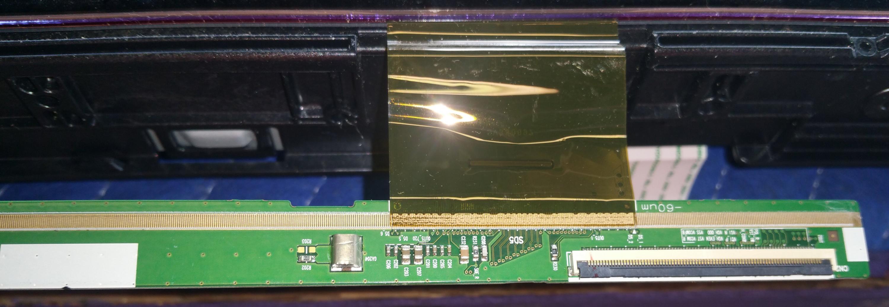

          Here are some pics of the LVDS Boards (???) attached to the panel..
          No obvious shorts or burns... I find it highly coincidental that BOTH boards will short the TCON fuse..
          Will check the small ceramic caps as suggested next..

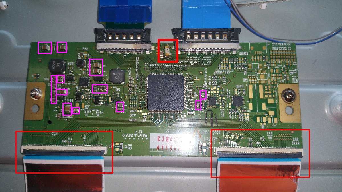

            It occurred to me that maybe the LVDS Boards off the panel were shorting against the metal panel cover that protects those panel boards..
            No such luck.. I tried it without that metal shield and the TCON fuse still blew..
            OK, now just to confirm..
            The components marked in purple. Those are ceramic caps and put my meter in DIODE mode and if I get a short on the ends, that's bad??

              Can you check that the fault is located on the Tcon board or not by disconnecting all the cables to the Tcon and from Tcon to panel and measure the resistance from the Tcon fuse to ground and then start reconnecting them one by one checking each time.
                Yes, just a probe on each end, they're marked starting with C, white one is fuse that will beep, if any others beep probably a short somewhere.

                    OK with the TCON isolated and with the TCON hooked to the panel by both connectors, I get 3.9 to 4.16 ohms on the top part of the fuse to GND...

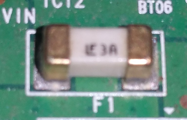

                      What is the supply voltage and fuse rating on the Tcon?
                      • Michale32086
                        • Nov 2011
                        • 1453
                        Re: LG 60LN5400 Blows TCON Fuse
                        Here,,,
                        • dick_barton
                          • Aug 2015
                          • 6643
                          • Wales
                          If it's a 12V supply and a 3 Amp fuse then 4 ohms will result in 3 amp current flow which it right at the fuse maximum rating. Anything less than 4 ohms will result in the fuse blowing.

                                  Have you checked the ceramic capacitor next to the fuse ?
                                    With my meter in DIODE MODE, most of them show .457 .037 etc etc..
                                    But the one marked in blue and a couple smaller ones around it show .0L
