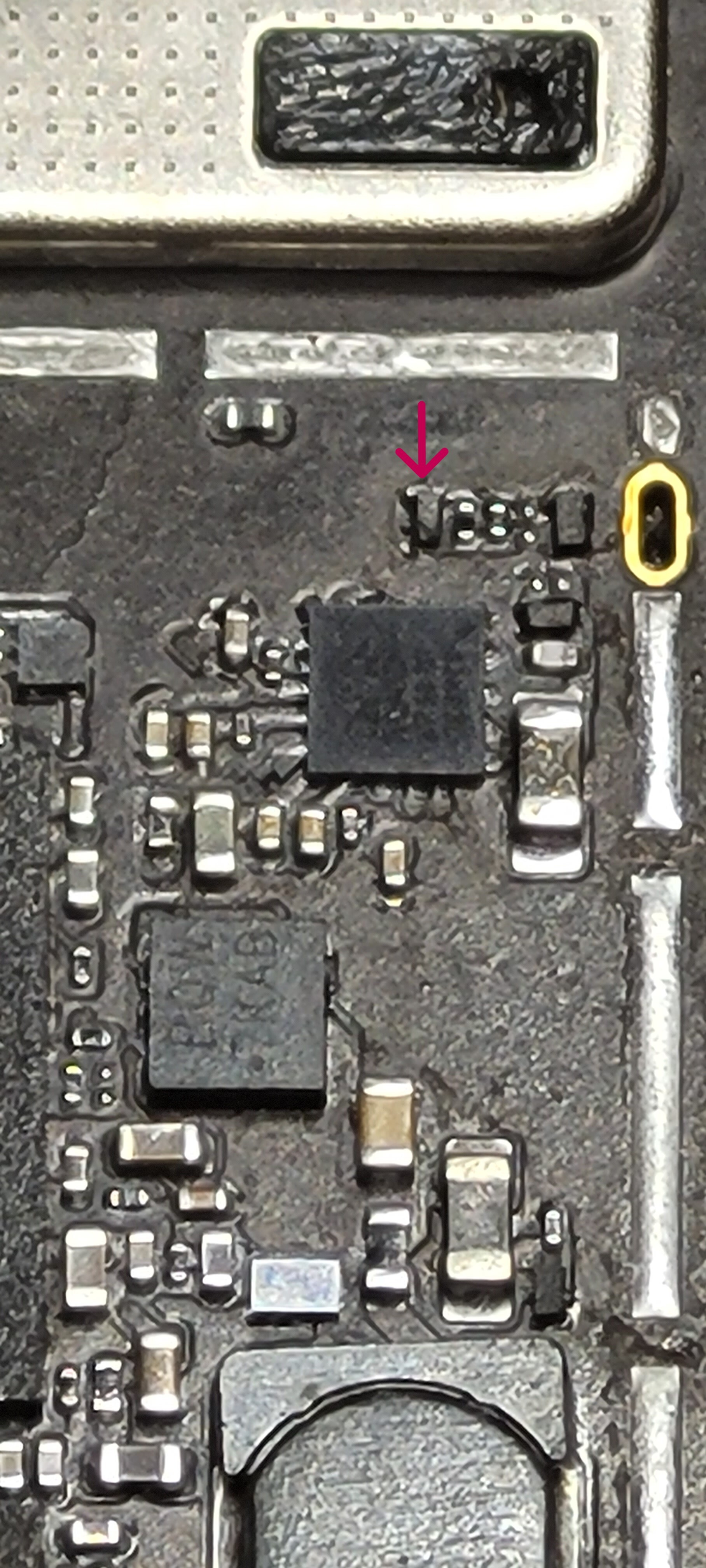

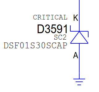

    Hello, I am looking for help to replace a damaged diode. The tristar was replaced and a diode was damaged in the process. I have a picture of the diode but dont have an exact donor. I mostly have macbooks for donors and only a few ipad and iphone boards. Diode part number: DSF01S30SCAP
    Im not sure where to find the ipad board number. Anybody have an idea where else this diode is used on other boards? Thanks.

    https://www.digikey.com/en/products/...SL-L3F/5409242
    Be sure to review the placement of this part. There is a polarity on the component.

      Thanks alot that worked.

        For future reference, this part was also located on a 2017 Macbook Pro. I was looking for the same part.
        • JGage
          • Sep 2024
          • 2
          Also, on the board it was used for the LCD panel.
