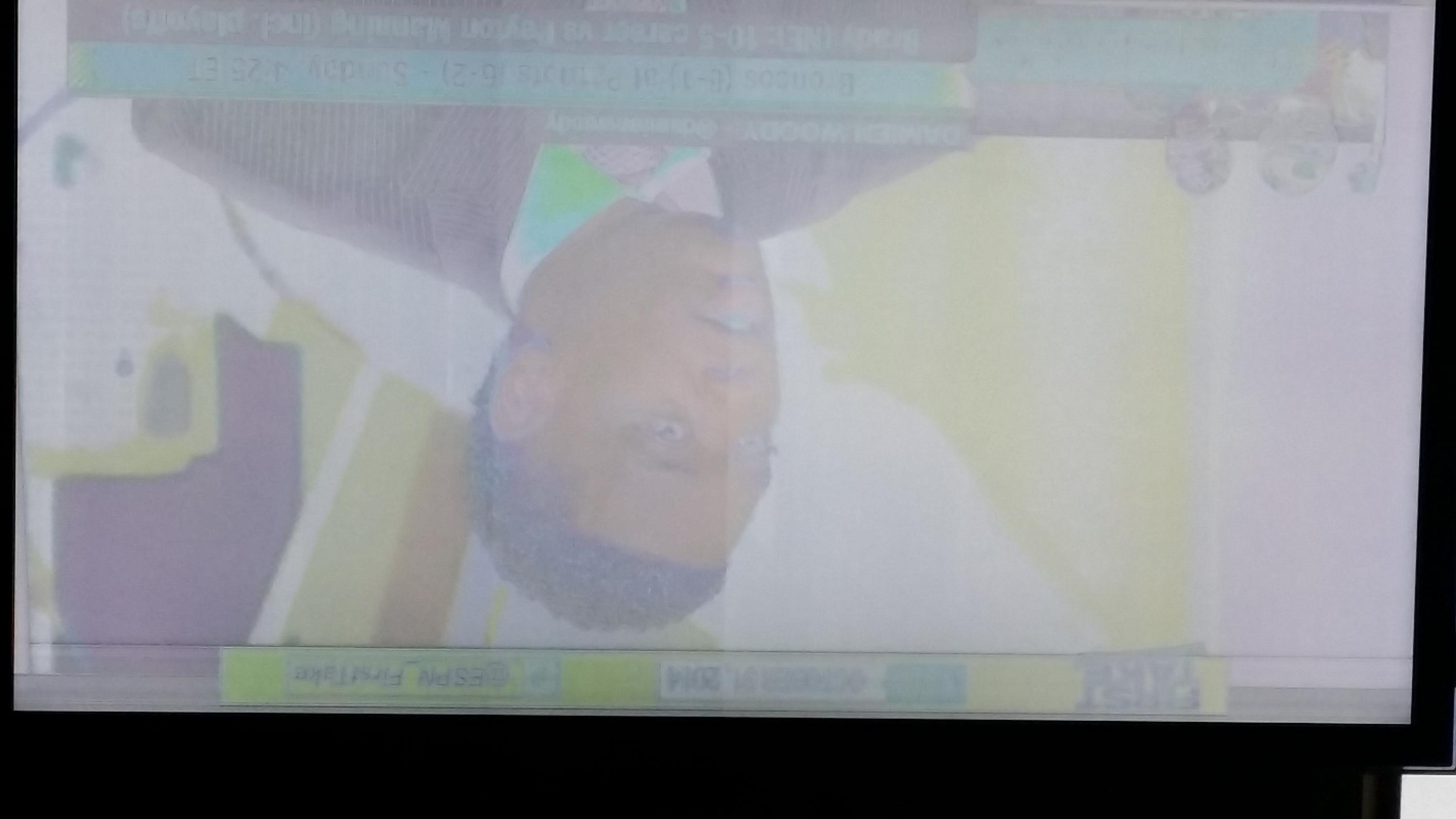

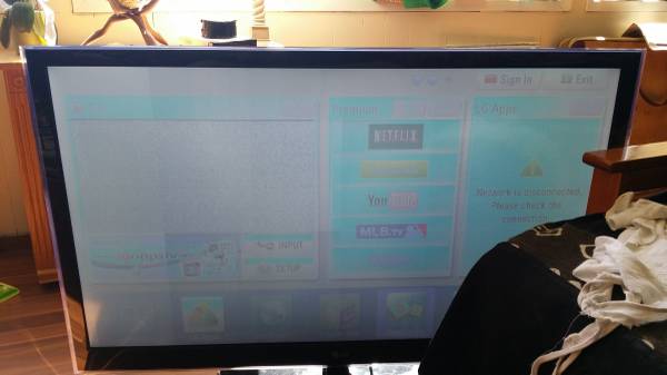

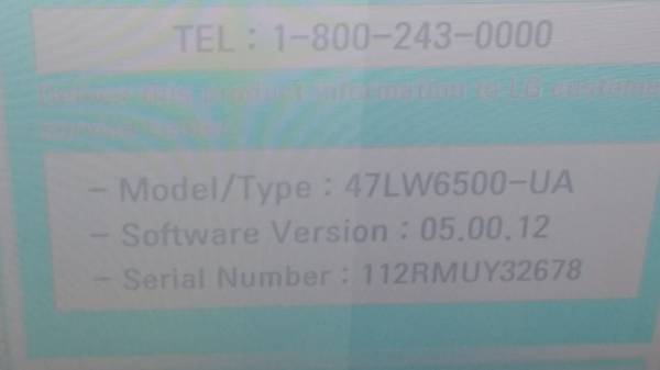

    Hi I have a 3d LG 47" LW 6500. The screen has washed out colors and the menu does as well. I tried replacing the tcon to no avail. Everything works fine and the firmware is up to date. Is it the panel? Any help would be appreciated.
    Re: photo negative LG 47" LW6500

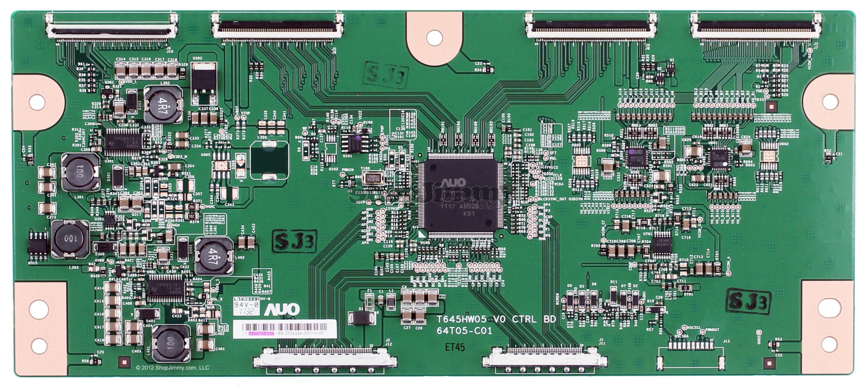

    Looks like bad GAMMA Voltage ref problem in the T-CON board.
    Pictures of the back side of the TV?

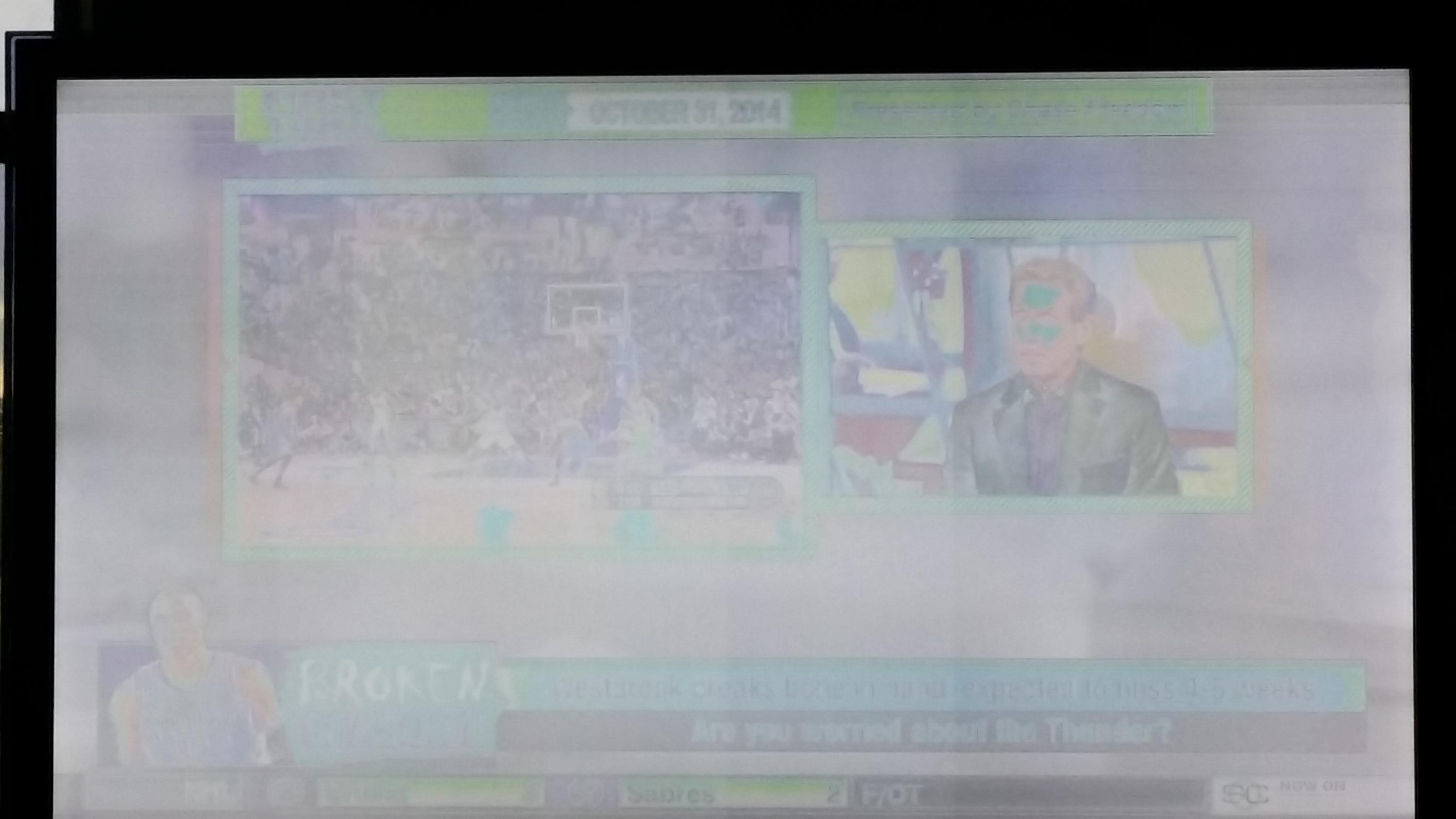

          Hi,I took off all of the boards but I didn't feel qualified to remove the metal shield that remained. It didn't come off easily and I got nervous forcing it.I took two more pics of the screen. Any advice on how to remove the shielding

                  Hi, I bit the bullet and took this to an electrician. They said that an I.c. was bad on the panel. Oh well. Thanks anyways
                  • tibimakai
                    • Jan 2012
                    • 3680
                    I would still try a T-con.
                    • quietwar
                      • Mar 2014
                      • 15
                      I tried that in my original post. Didn't work. Also, the shop tried it with a new one, same result.
                        I would say bad LCD panel then is the next most likeliest option.
