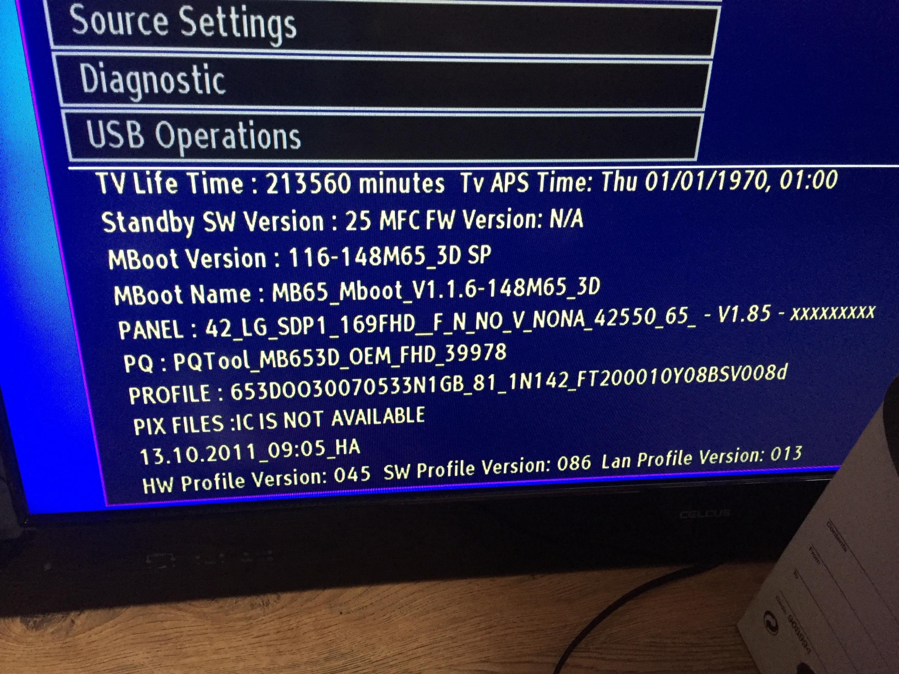

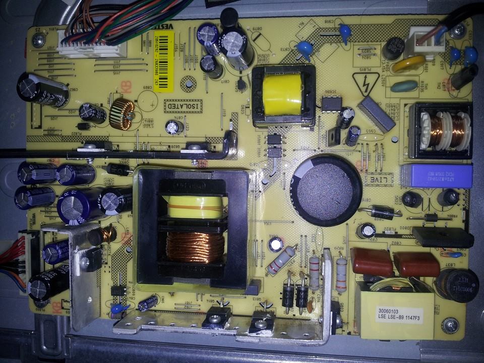

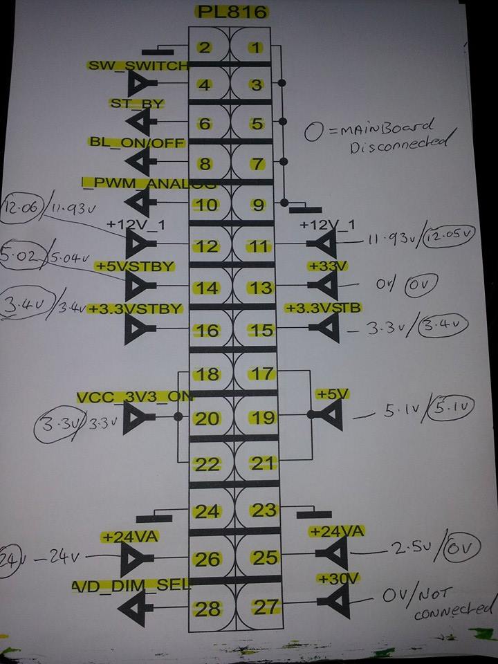

Hi there can someone help,im having look at this tv for a friend the problem is the red led on the front panel just flashes continuously,i have replaced the psu but the problem remains,there is 5v on the av board fuse and also there is 24v on the inverter fuse,could it possibly be the mainboard thats gone.
