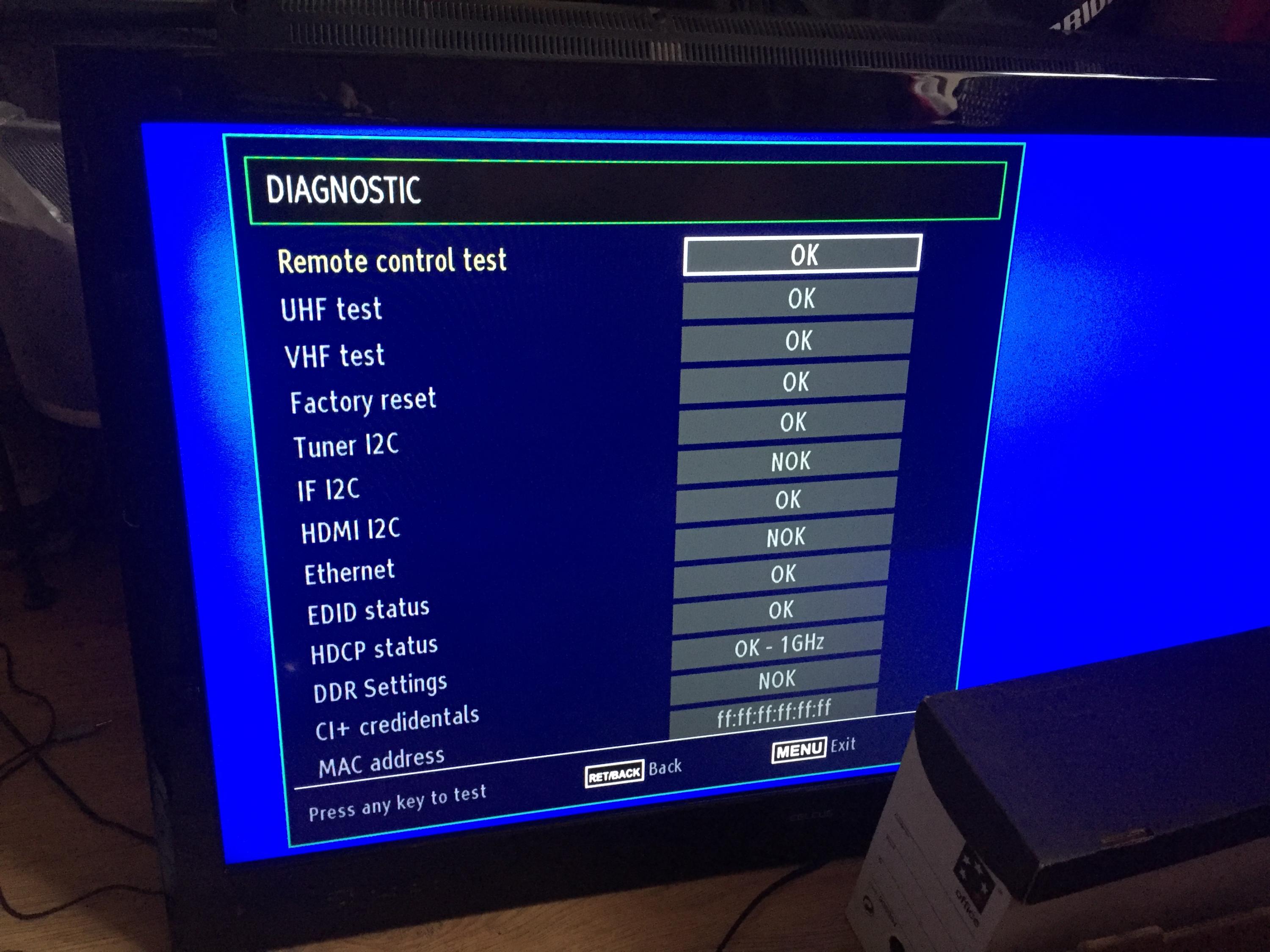

                                    Re: celcus lcd40s913fhd flashing red light
                                    Just wanted to say that the service manual posted above for the vestel board 17MB65-2 in a Celcus TV fixed a no audio from internal speakers, but sound from headphones issue.
                                    No audio fix instructions below.
                                    Turn TV on
                                    Press menu
                                    Type 4725
                                    Type 4725 again
                                    Service Menu appears
                                    Open Diagnostic
                                    Select factory reset
                                    Press OK
                                    Wait approximately 2mins
                                    Accept 'first run' options
                                    Tune any channels or switch to your desired source
                                    Test sound works
                                    I suspect this is only a temporary fix, there may be some hardware that is aging, but the fix can be applied as many times as it works
