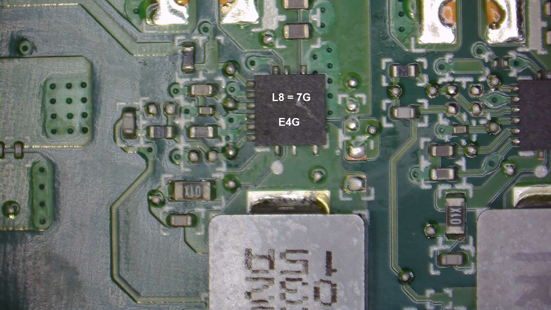

    Hp Spectra x360 Power light flashing, component id
    Working on a hp x360 15-eb1043dx that will not turn on and the power light just flashes. It pulls 700ma when flashing. Under the thermocam I found a component I am unable to id that light up. If someone can help would be appreciated. I put the number that are on it in better test.
  • mon2
    • Dec 2019
    • 14681
    Richtek RT6256BGQUF
    • CraigR
      • Dec 2013
      • 969
      Thank you mon2 Much appreciated!

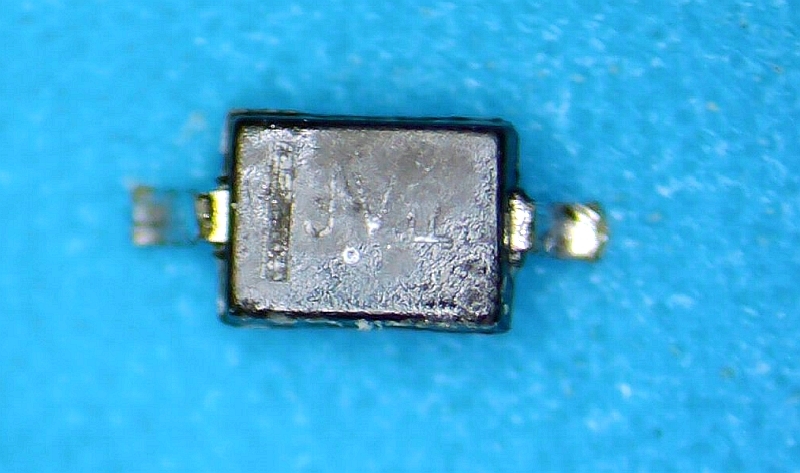

      • CraigR
        • Dec 2013
        • 969
        Originally posted by mon2
        Richtek RT6256BGQUF
        Have another part getting hot and it's a smc diode and the markings are JV then a sideways F. I can not find anything on this. Any ideas?
