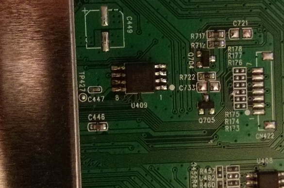

VIZIO E320-A1... Gets power but no picture
  • p2computing
    • Jul 2014
    • 49
    Re: VIZIO E320-A1... Gets power but no picture
    Order placed. Should know by the end of the weekend if this was the proper fix!
    • p2computing
      • Jul 2014
      • 49
      The EEPROM replacement was a success!
      • p2computing
        • Jul 2014
        • 49

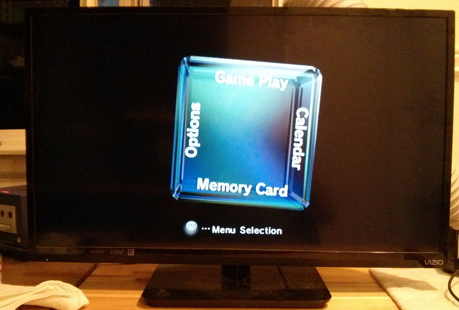

        The TV has been assembled and is working perfectly!
        Thank you, Budm! It was very awesome of you to lend your expertise to someone you don't even know.
        Thanks so much!
            Hi guys, I am new here, this is my first post. I have a Vizio E320-A1 with the same problem. The power light comes on when the TV is plugged in. I cannot turn it off with the remote or the button on the face of the unit. Black screen, no picture, no sound. I read this post and tested it with the same procedure. These are my results.
            Capacitor C9810 = 170vdc
            Connector CN9902 vdc
            ON OFF
            1- NC
            2- 5.19 5.18
            3- 5.19 5.18
            4- 5.16 0.09
            5- 11.80 12.06
            6- 11.80 12.06
            7- GND
            8- GND
            9- GND
            10- 11.80 12.06
            11- 11.80 12.06
            12- 0.09 0.03
            13- 0.05 0.03
            My Power Card is Part Number DL621XX04Q, my Main Board is TXDCB02K030002Q
            On the main Board I only see EPROM U402 and U408. Shopjimmy only lists EPROM U403 and U409.
            With my symptoms and test results, would it be safe to assume it is an EPROM problem? I would probably just order the main board from Shopjimmy, I do not feel comfortable enough to change the EPROM, too small for me to see well enough.
            Anything else I need to check?
            Thank you in advance,
            Ed
                      Hello. Very helpful forum and thread! I was also able to diagnose and fix the bad EEPROM problem with my Vizio E320-A1 TV following the thread info. In my case the problem was intermittent. The backlighting would not properly power-up maybe 50% of the time. Would unplug the TV for 20 sec, then wait another 20 sec after applying AC power before cycling the Power button. Eventually it would power-up OK. My TV is used with a cable converter box and the cable box must be disconnected or off for the power cycle trick to work. I suspect voltage is being back-fed thru the HDMI input into the TV causing the uP to stay "half-alive", something I've seen in other poorly designed uP controlled units with USB ports. Measuring pin voltages on the power supply board connector in both off & on states is a good test and confirmed the problem (pins 12&13). Ordered a replacement EEPROM from ShopJimmy and installed. Note that they sell several EEPROMs for the E320-A1 model so make sure you match your specific pc board part number. Also, the EEPROM is under the metal shield cover that also covers the uP. It must carefully be removed. It's not a hard swap if you follow good surface mount IC repair techniques. Thanks to BadCaps.net for the good advice.
                          Hi everyone, if anyone is still here. I have the same exact issue as p2computing, as I have a Vizio E320-A1 and the same symptoms. I have checked the pins as previously instructed and came up with the same voltages, and had 0 Volts on pins 12 and 13. So my question would be how do I know which EEPROM is the culprit? P2computing said his was fixed with the replacement of U409, but shphillips said that its under the metal shield. I am just confused as I havent removed the shield yet and I am looking for guidance.
                            #33
                            There are many versions of this model E320-A1.
                            See here to see which one you will need:
                            http://www.shopjimmy.com/catalogsear...=Vizio+E320-A1
                            • XwarlockX
                              • Jan 2016
                              • 2
                              #34
                              Thank you for the very quick response! I looked up the board from the numbers on mine and it appears that I will need the same U409. I have not soldered one of these before(but I know how to solder), is there any advice you can give me?
