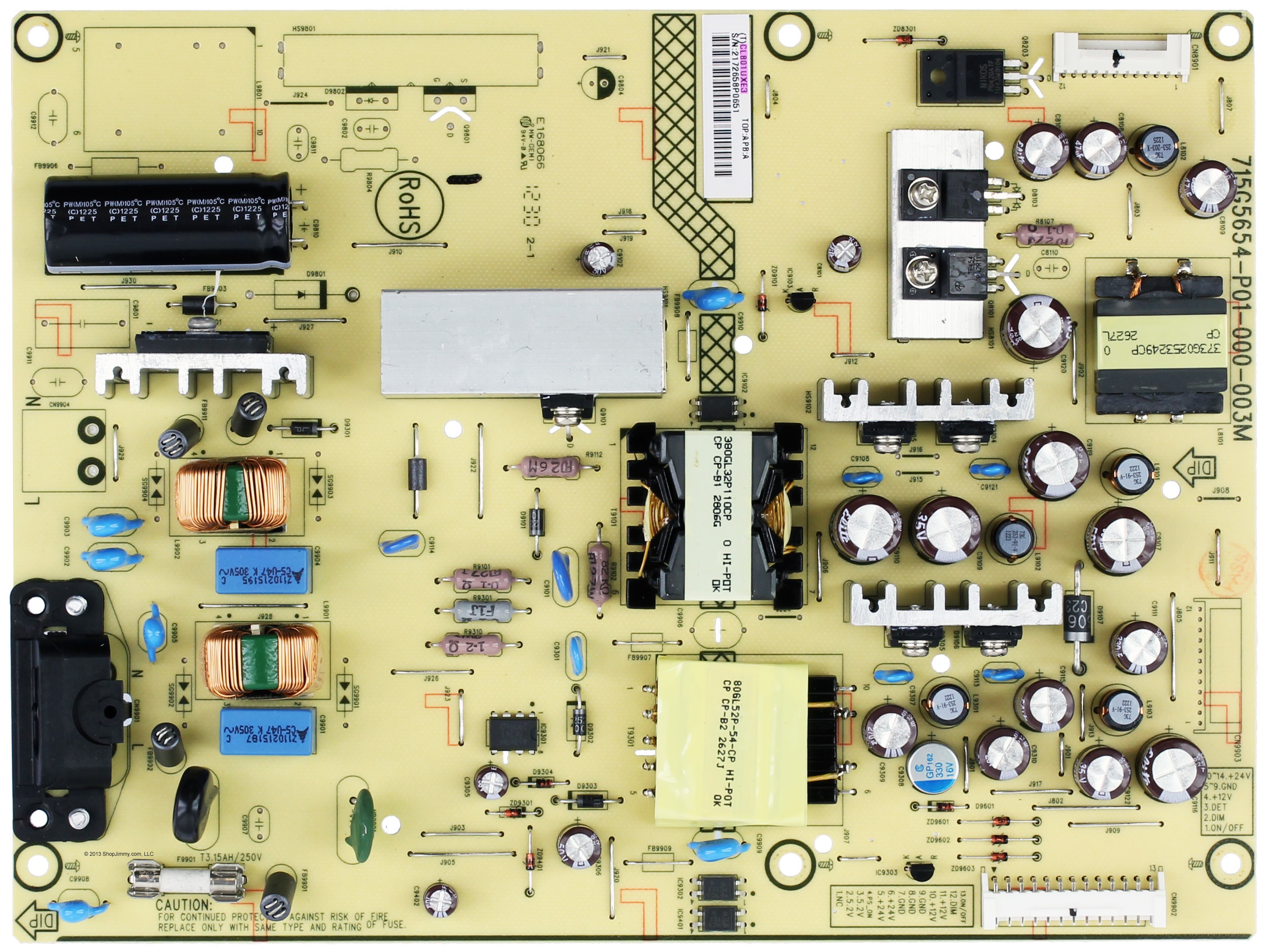

          Re: VIZIO E320-A1... Gets power but no picture
          I think this is your board:
          http://www.shopjimmy.com/vizio-adtvc...upply-unit.htm
          It also has the EEPRROM IC, so that can be one possible problem:
          http://www.shopjimmy.com/catalogsear...=VIZIO+E320-A1
              No problem, we are all here to learn, I just hope it is not EEPROM problem since it is hard to isolate software problem from hardware problem.
              Once we verify that is is the same board as shown at SJ then we can use those pictures SJ, I really have to give credit for putting ups lots of really good pictures.

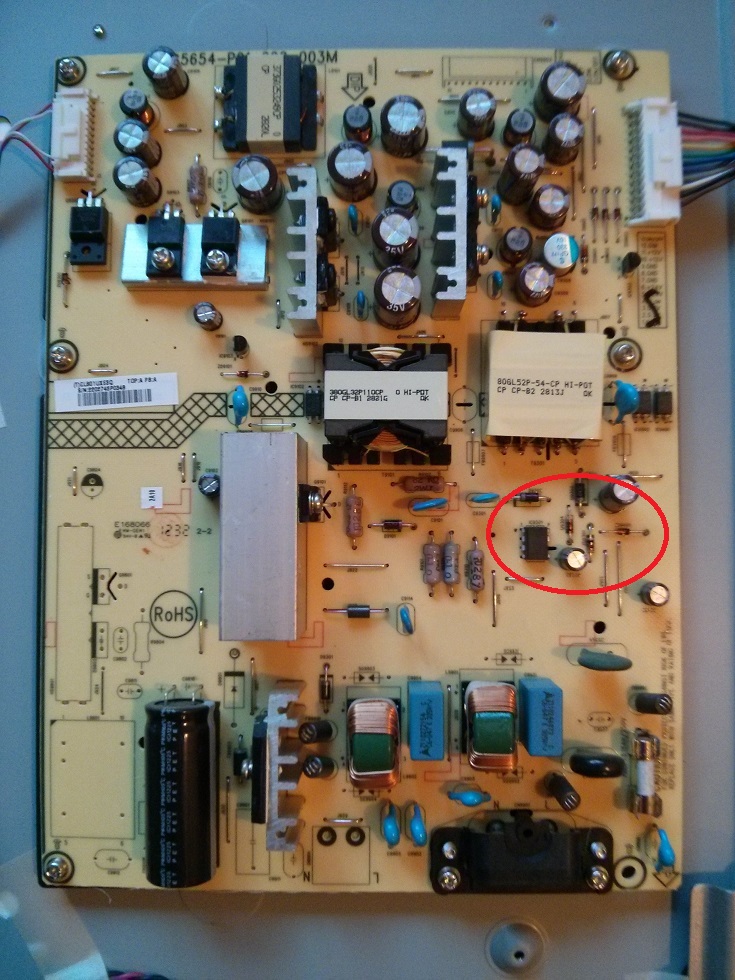

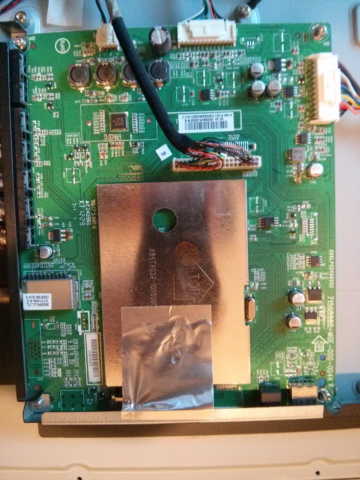

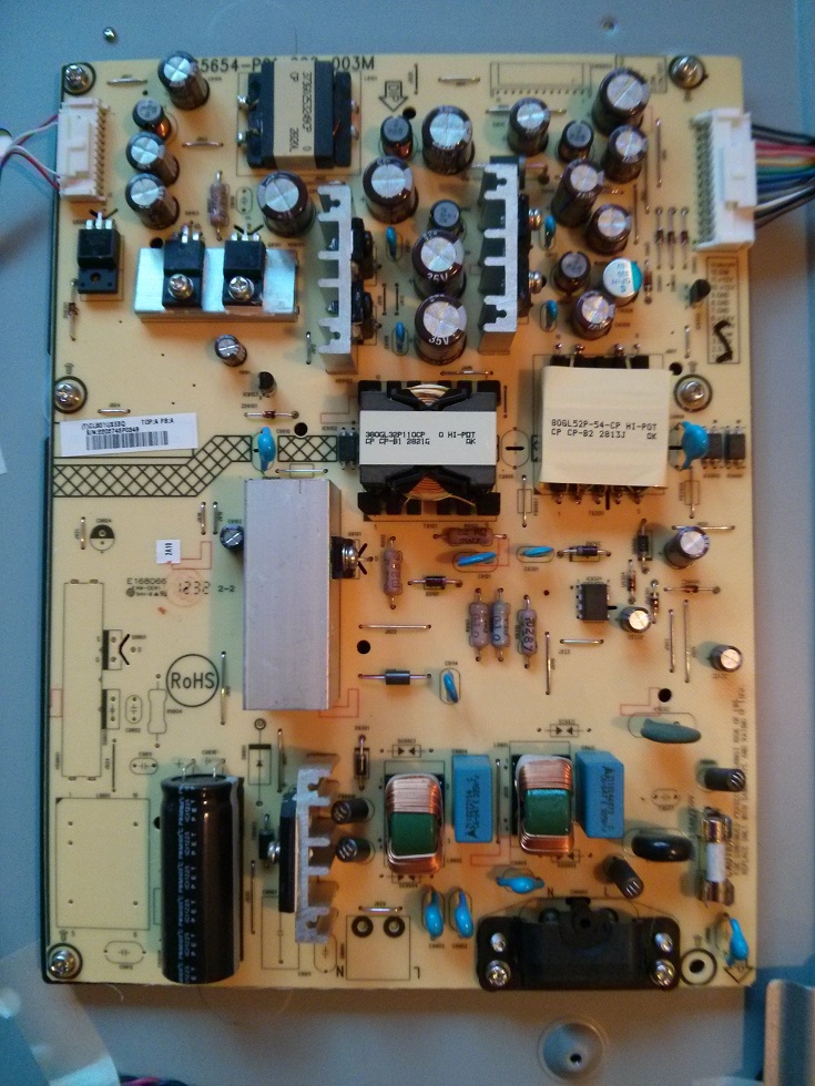

                Thanks for the start on this one fellas! (martino, i think that's the board i've got)
                Here are two images. White background is power, green is mainboard.
                Let me know what is needed next =)
                  OK, your board is really close to what SJ has on the web site.
                  Using the black probe on the chassis then take the DC Voltage readings on connector CN9902 (13 PINS) and report the reading on each pins as shown in the pictures when TV is OFF and when TV is ON:
                  For example
                  PIN1.NC = no need to test this one
                  PIN2. 5.2V = XXXV (OFF), XXXV (ON)
                  PIN3. 5.2V = XXXV (OFF), XXXV (ON)
                  PIN4. PS_ON = = XXXV (OFF), XXXV (ON)
