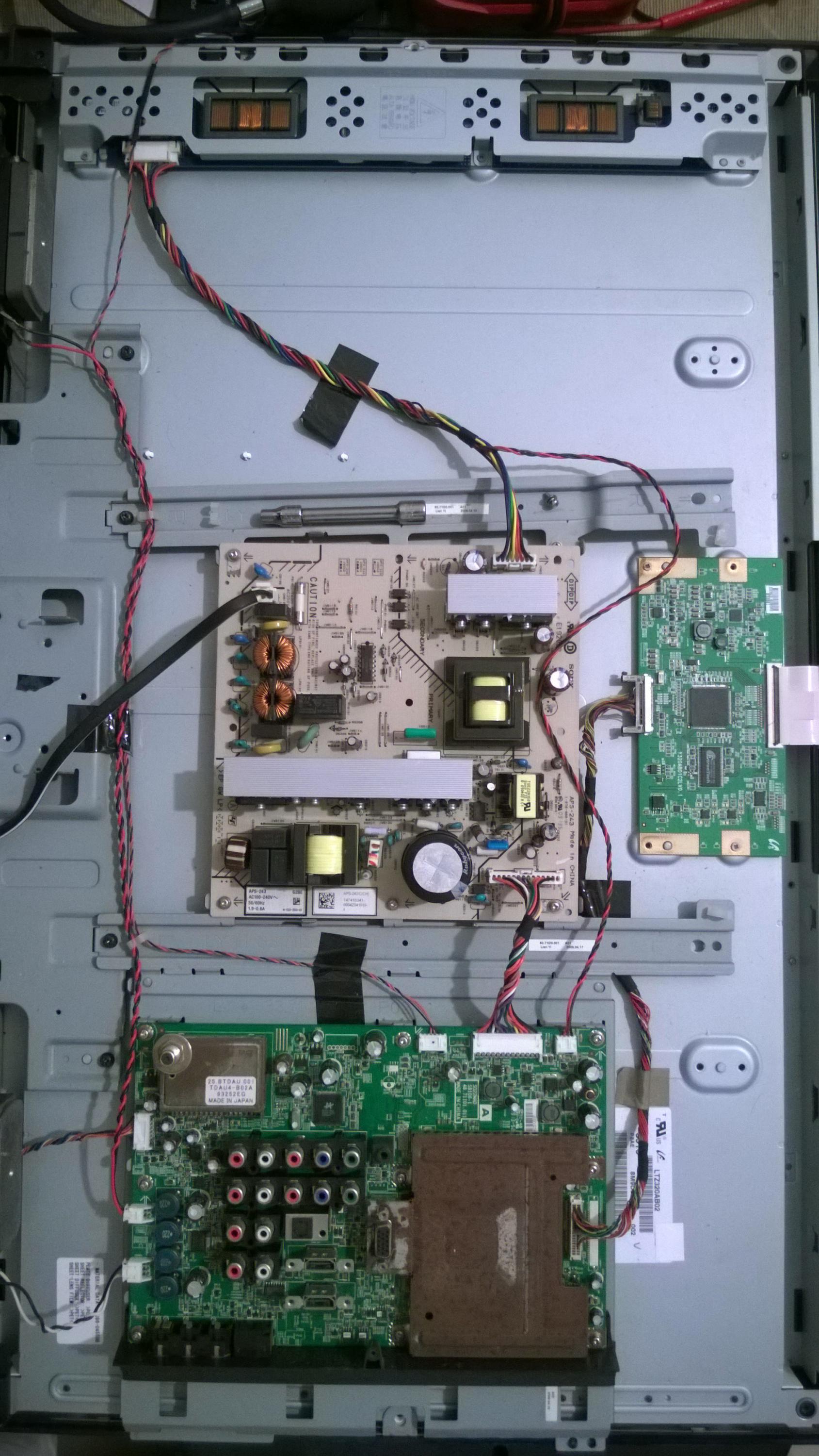

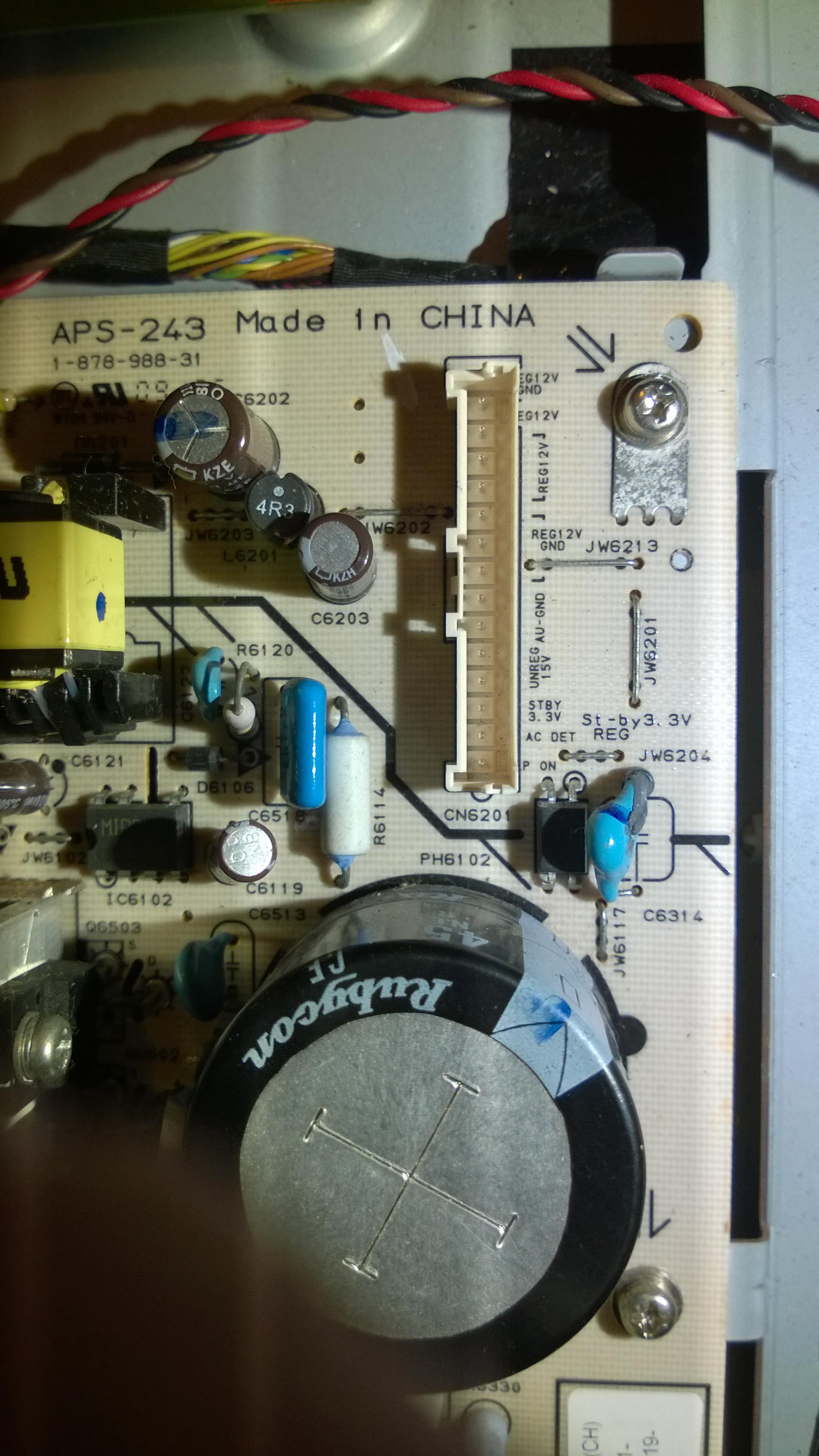

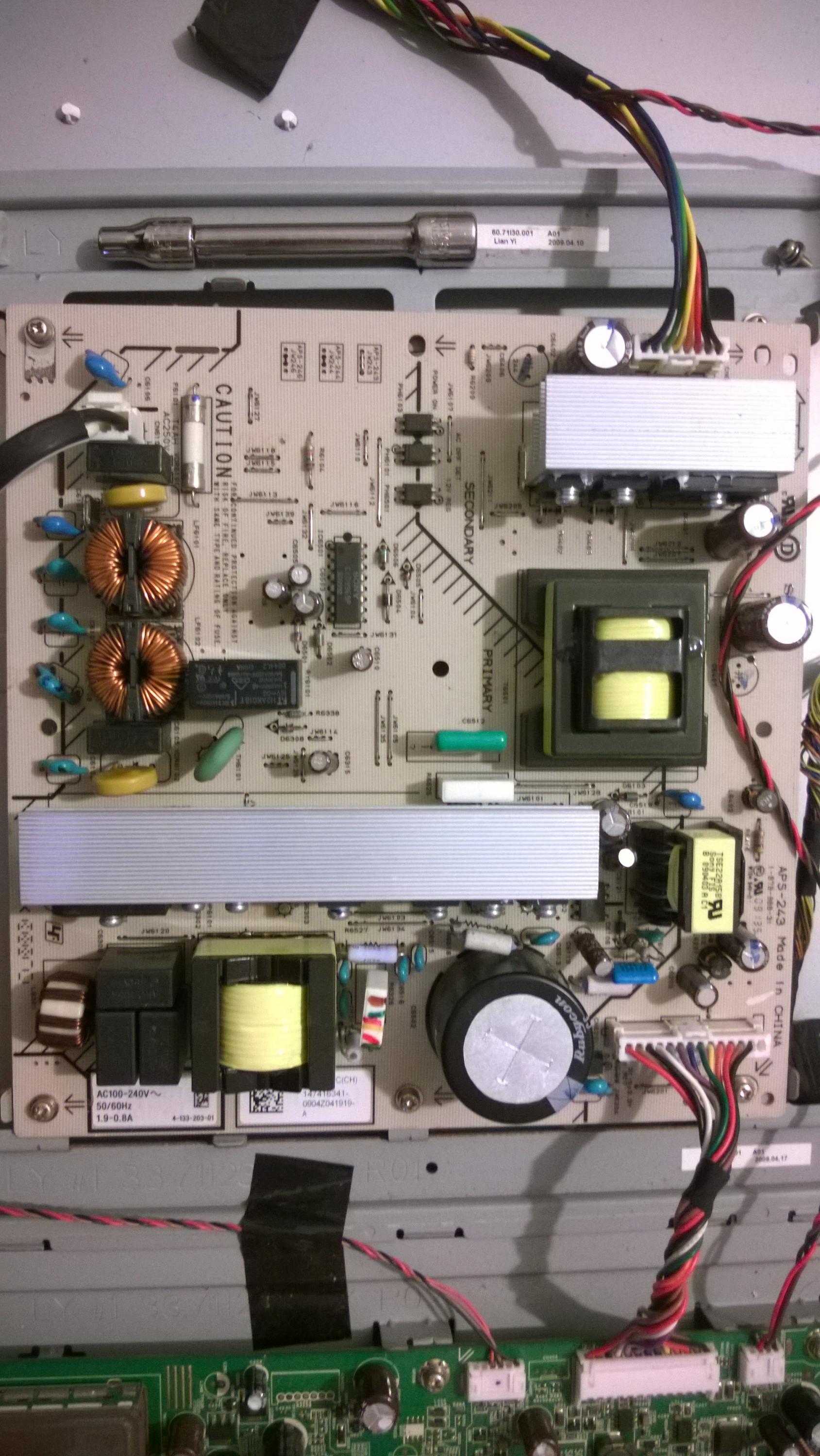

                Hello, stj, at least I got my hands on a PC I attached three pictures: The first one is a full view of the back of the TV without the back cover, the second is a closeup of the POWER board and the other is a closeup of the connector where I tested all those PINs (CN6201 ), I hope that helps you a bit, thanks for the patience.
                  • 31183
                  Re: Sony KDL32L5000 screen stays black but audio works fine
                  1st thing that comes to mind,
                  where the fuck did all that rust come from??????
                    Well I live in a tropical place, the weather changes unexpectedly every day and maybe that has some effect on that guard. Every price of electronics I've checked is the same after a couple of years of normal use. I have noticed some devices accumulate dust and that dust creates an area of oxidation on the metal plates covers in many of them, mostly video games consoles.
                    Does the rust matters? I've seen TVs that look worse than this which are completely functional, though.
