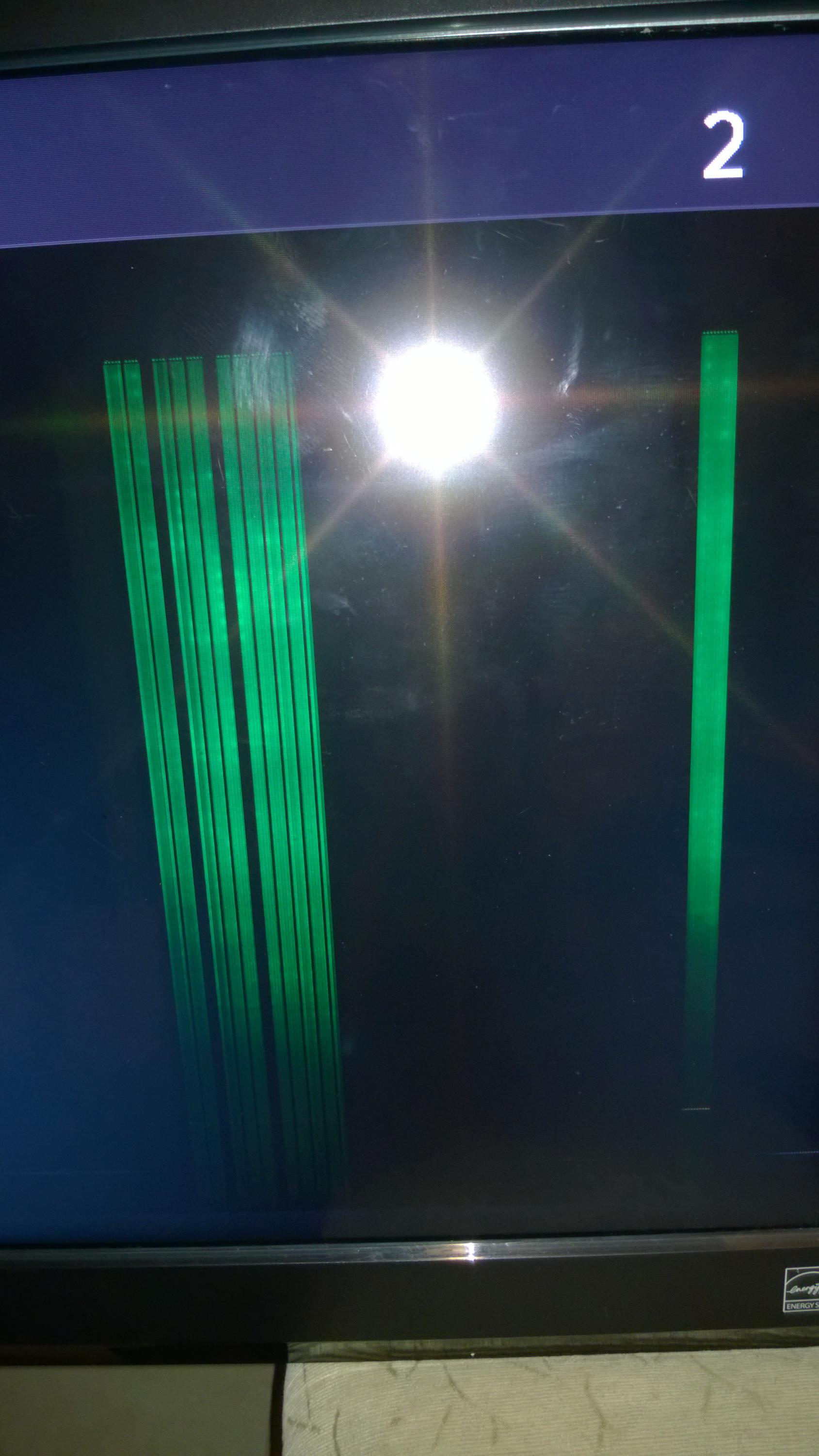

    The fuse may have blown due to this:
    "2- I connected the flex back,this time TV was still ON. The screen turned white entirely"
    good spot budm i missed that completly! i would try a new fuse and see how you get on.

      Ok, thanks, so the fuse might be another problem on top of what may have caused the lines... I'll get the fuse and report back ASAP.

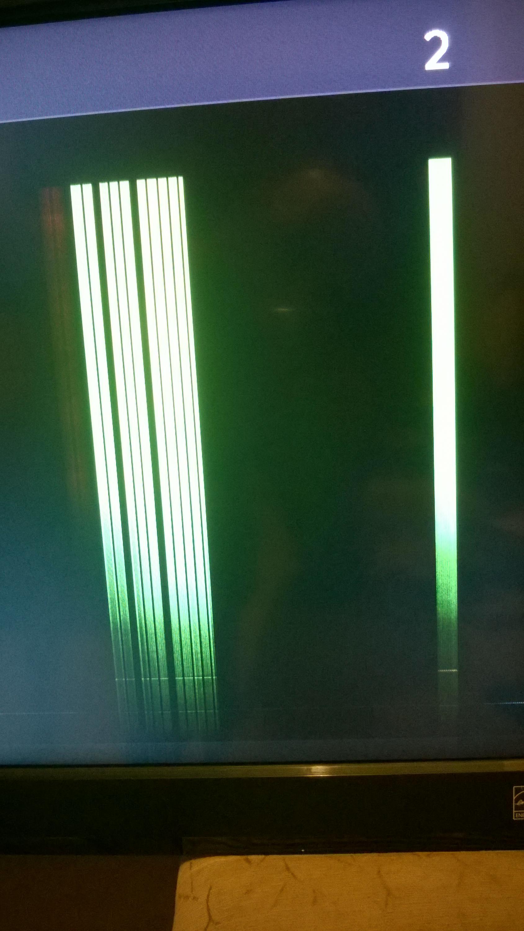

                            Hi every one, thanks for your patience, I've been having issues with the ISP and their service is crap as for the last month. Anyways, back to the TV, I soldered the fuse and the TV turned on, the horizontal,grey lines on top of screen are gone and seem to have been a poor connection of the flex cable, in the other hand, the vertical green lines persist. I can post a picture if you would like to take a look at it.What's the next step? Thanks again
                              #34
                              Re: Sony KDL32L5000 screen stays black but audio works fine
                              Here are the pictures, notice that the vertical green lines are visible after a few seconds of powering on, then they get brighter and even a Red or Orange line can be seen beside the first GREEN one after a few more seconds.
