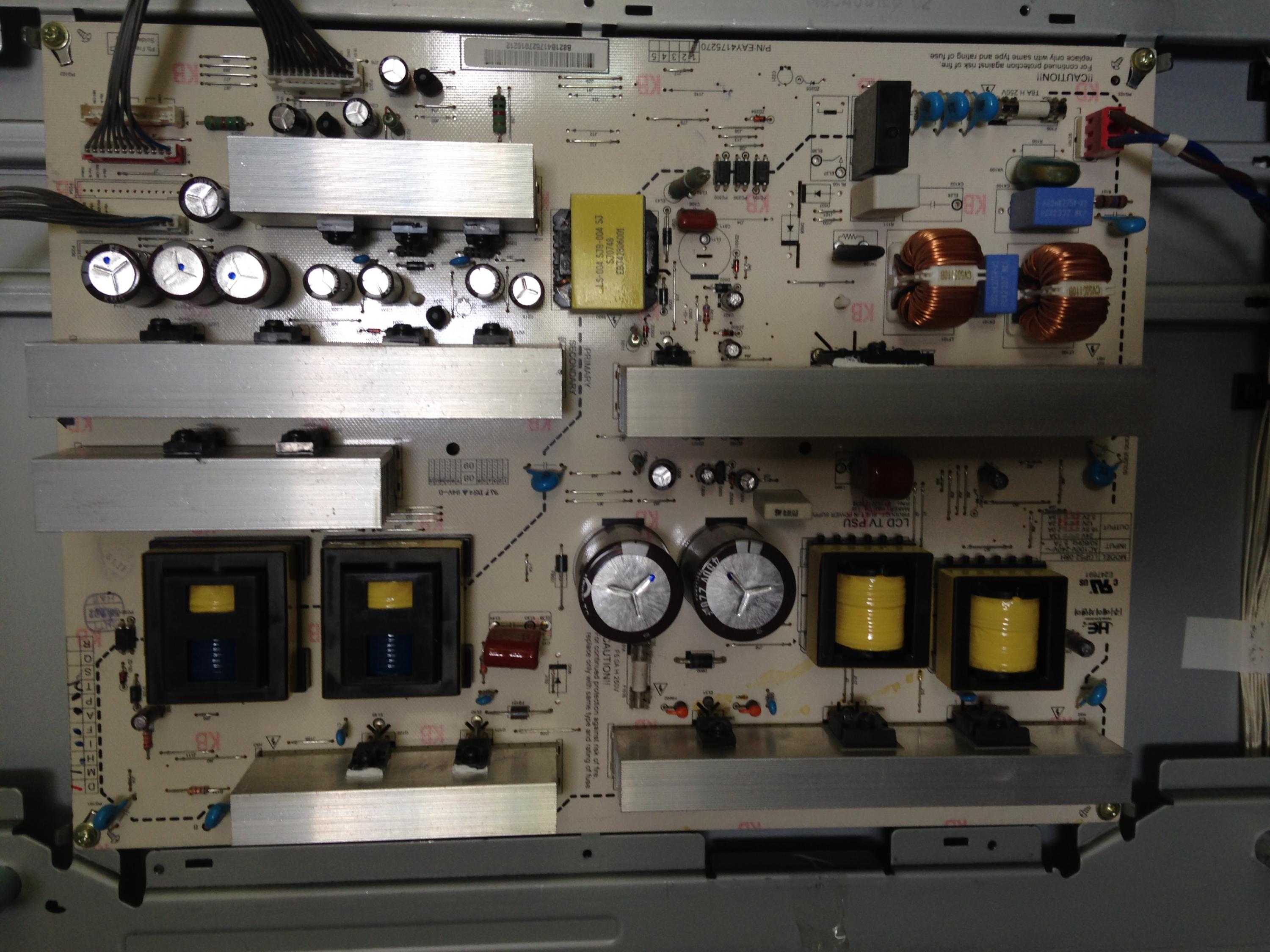

        Yes - or power supply board- post pictures front and back and please use manage attachments so pictures are kept available on this site for reference

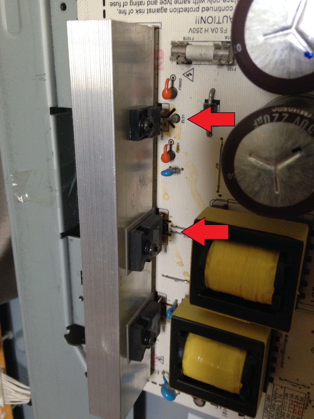

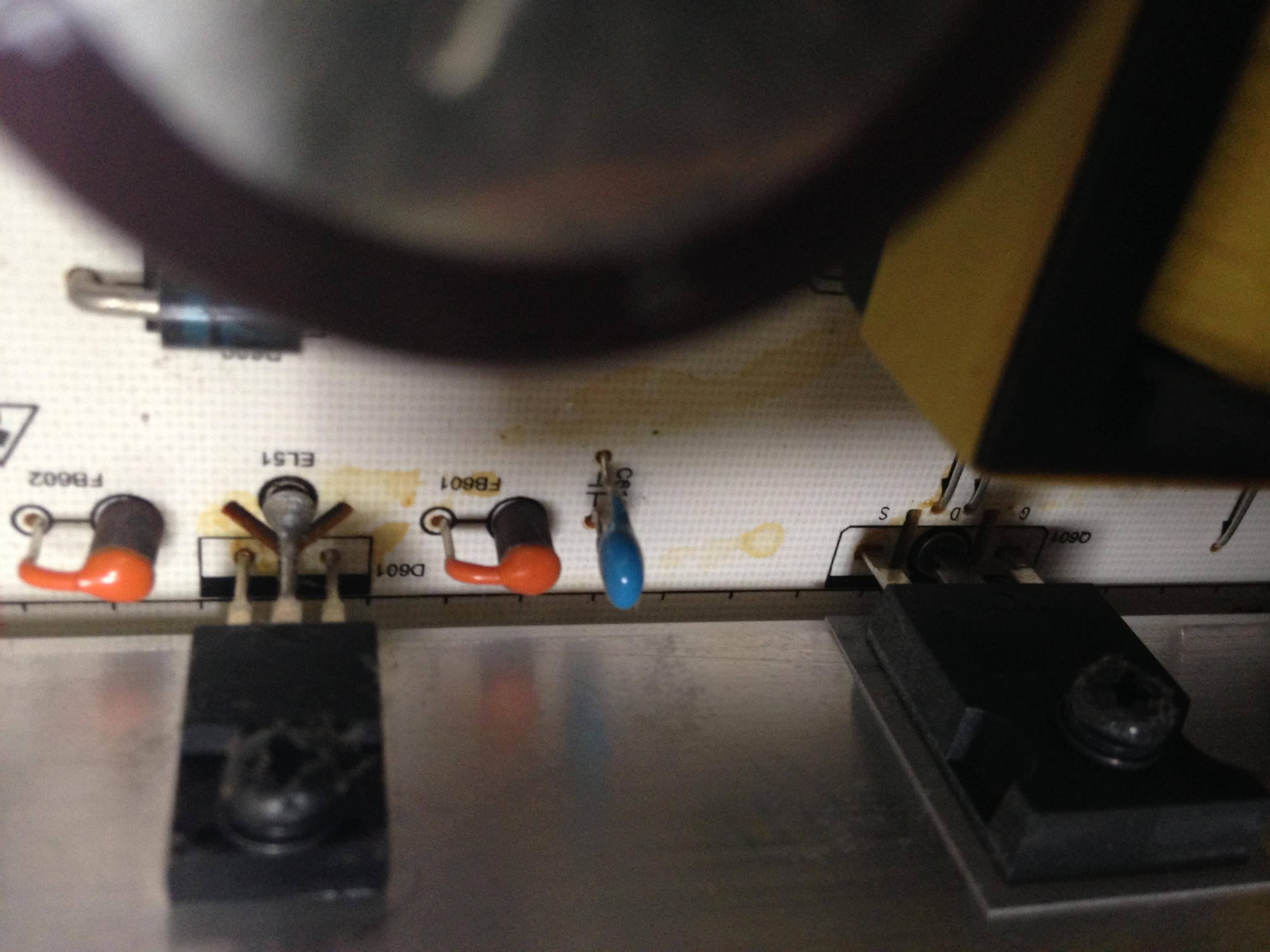

          I found this on the Power Supply board. After a little research these appear to be "MOSFETS" and as you can see there is some brown leaking coming from them. Is this OK?
          Pic attached.

            Power Supply Front & Back Full Pics

              Mosfets dont/cant leak the brown is probably just flux residue from manufacture
              - not a problem.
              Do any of the capacitors look swollen or the tops bulged/curved. What make are the BIG capacitors

                  The big brown capacitors in the photo are by SAMYOUNG.
                  Nothing looks swollen or bulging. I'm not seeing any residue either besides the small flux leakage mentioned before.

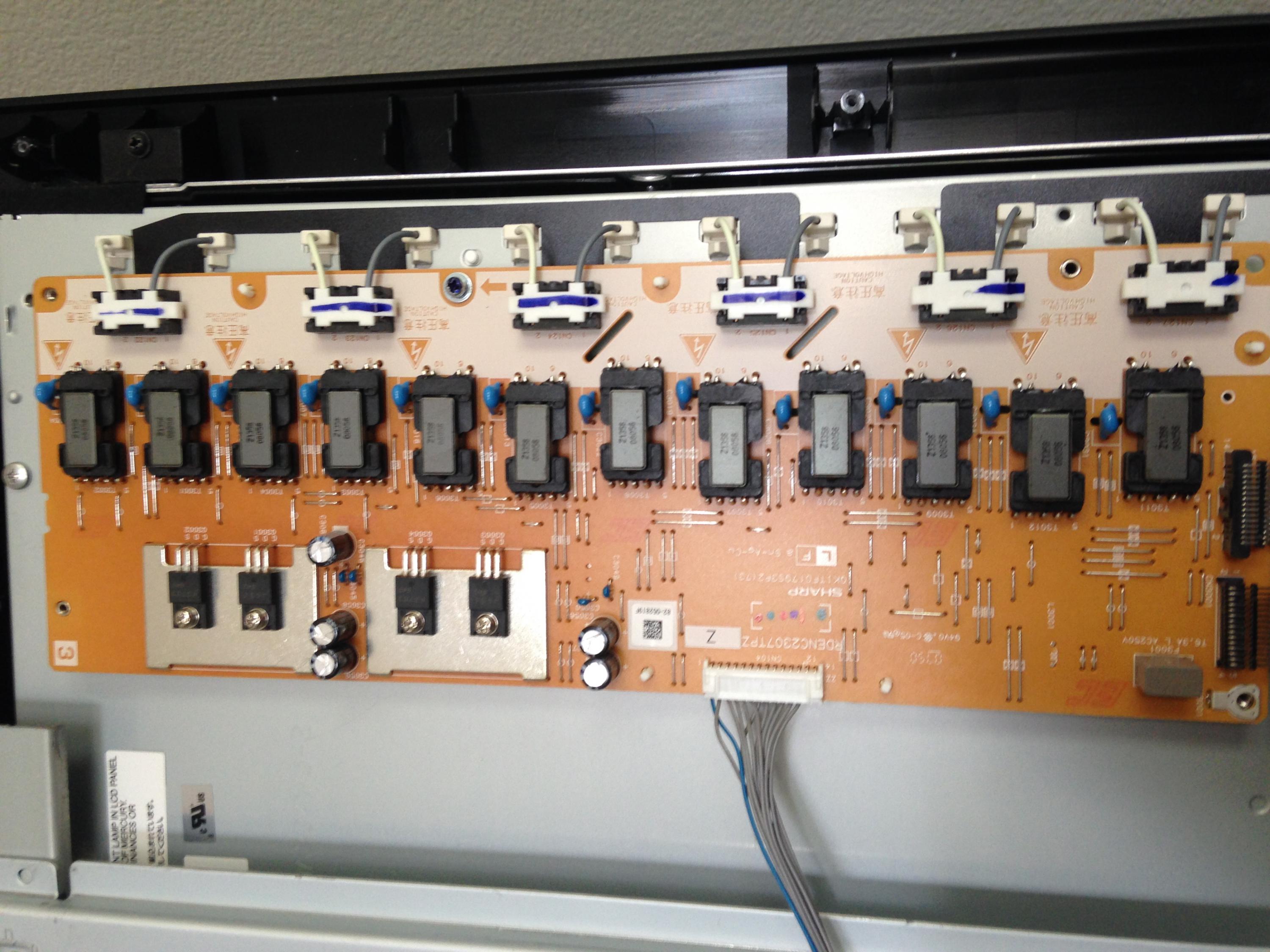

                        I googled this and believe this is my inverter board? http://www.tvpartsguy.com/media/0f/a...6238ec2a_l.JPG
                        ...I took the backs off of all my inverter boards and everything looks good. No bulging, no leaking. Is there something in particular I'm looking for? Could you show me some of the pics you're talking about regarding the "overheating" sections.
                        Is overheating a factor here? If the TV has been off for 24 hours and has trouble turning on. Once the TV makes it to on all issues are eliminated and the TV will act fine for as long as I need it. The initial turning on and turning it off are the only 2 areas where I have problems.

                            Have you checked those MOSFETs don't have cold solder joints? They look really heated, which could be a sign of a poor or intermittent connection.
                            It is more than possible you got two boards with the same fault... sellers rarely test their pulled boards despite their claims of doing so.

                                I am referring to this photo, the drain leg of the uppermost transistor looks cracked at the board point. Could just be the angle or lighting but might be a sign of a cold joint.
                                https://www.badcaps.net/forum/attach...0&d=1403290307

                                      The inverter boards appear fine. I think I have 4 of them? Below is a pic of 1 of the boards. No sign of burnage.
                                      Another pic of the Mosfet thing too.
