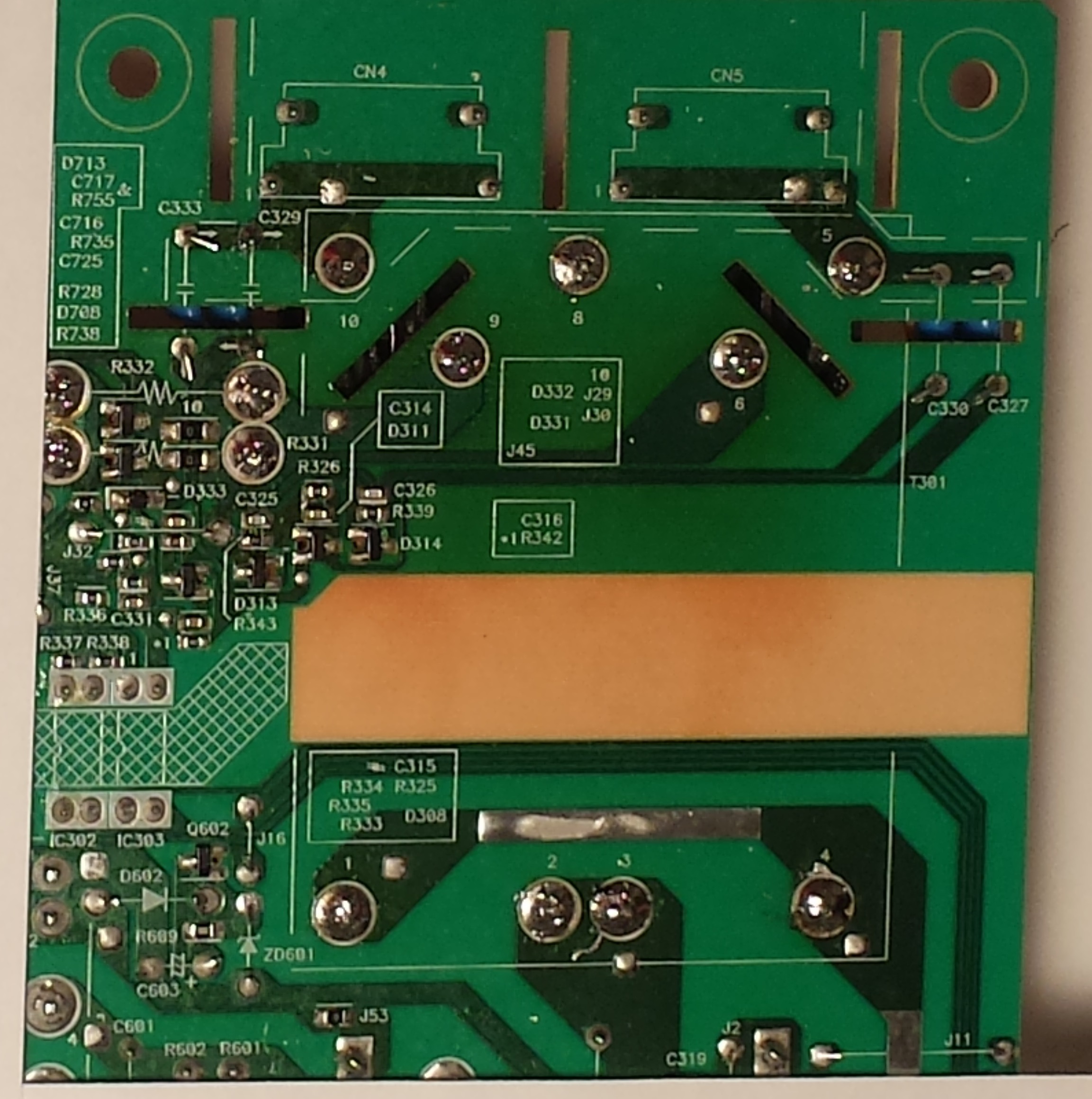

          Re: Transformer substitution - Sanyo DP42849-01
          Now, would I need to get the inductance from the secondary or primary? And powered on or off?

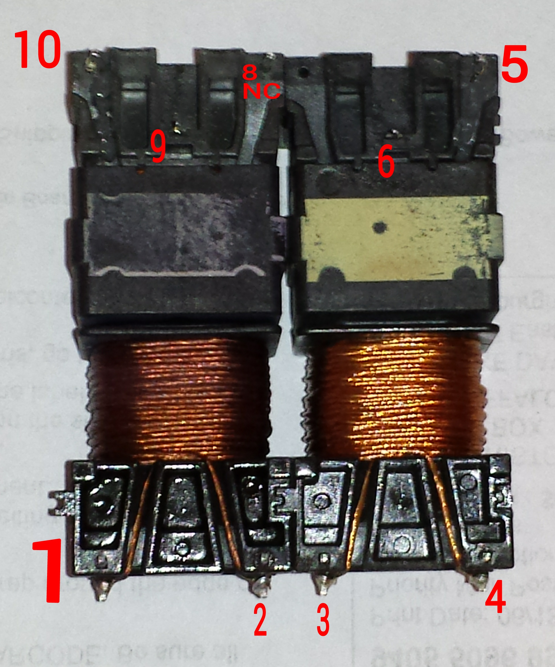

                  And I did it all twice so. Wanted to make sure I didn't miscount.
                  Here's the bottom view of one of the transformers. With pin out.
                  ------------signature starts here------------

                    • 1489
                    #29
                    Oh, if they're parallel then the numbers would be correct.

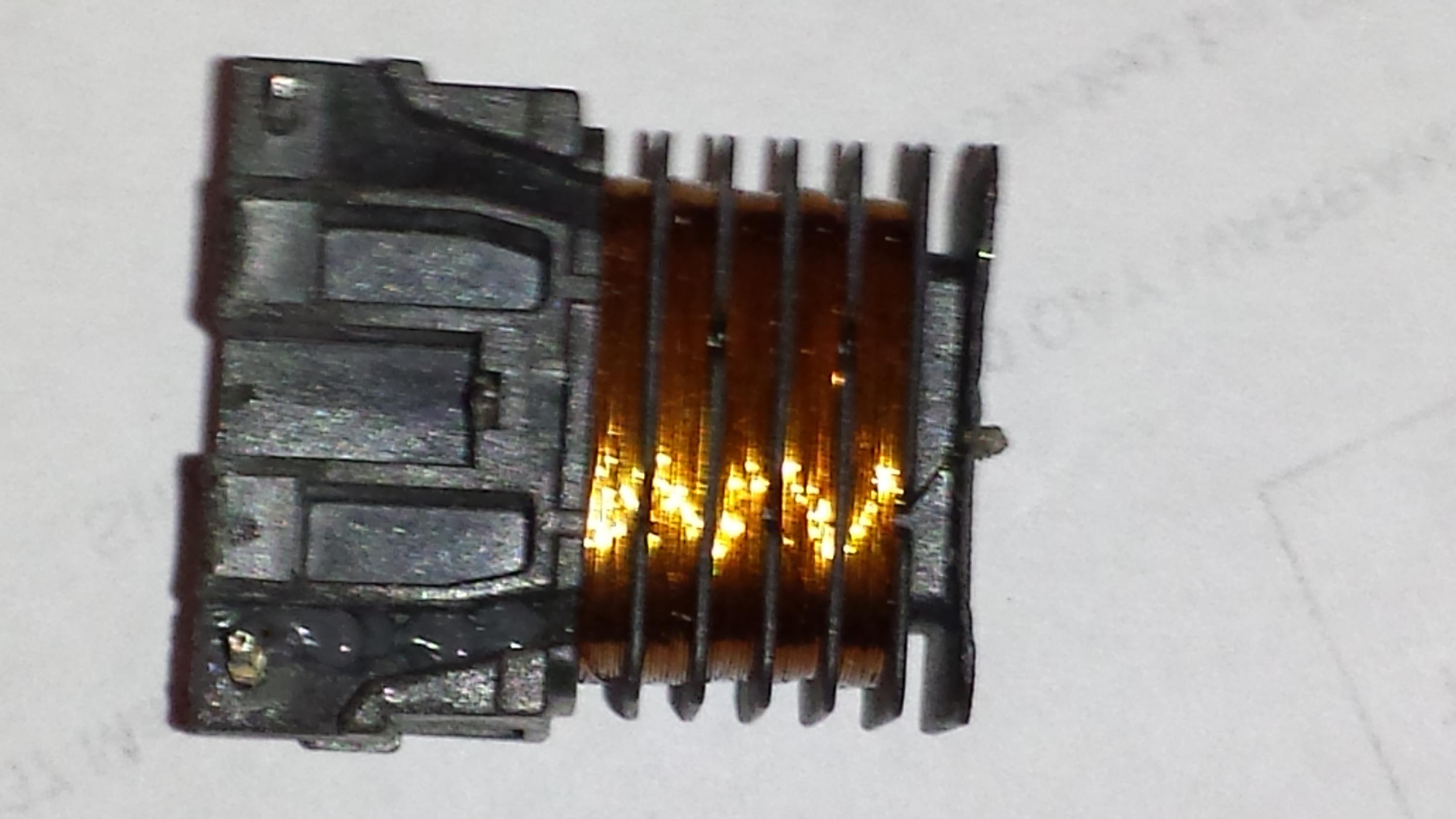

                            #33
                            Secondarys didn't take long. Here's a pic. Each section has 110 turns.

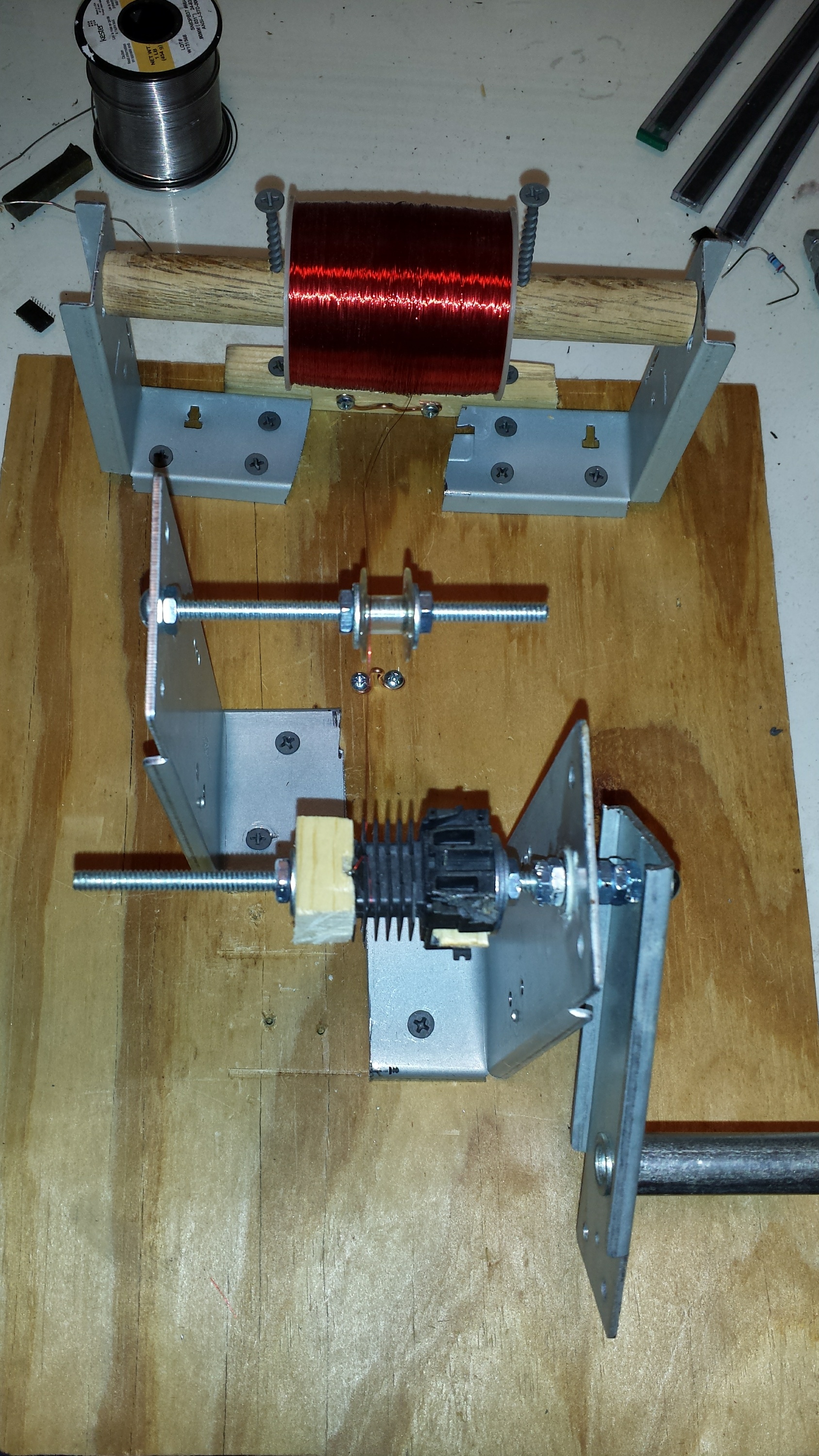

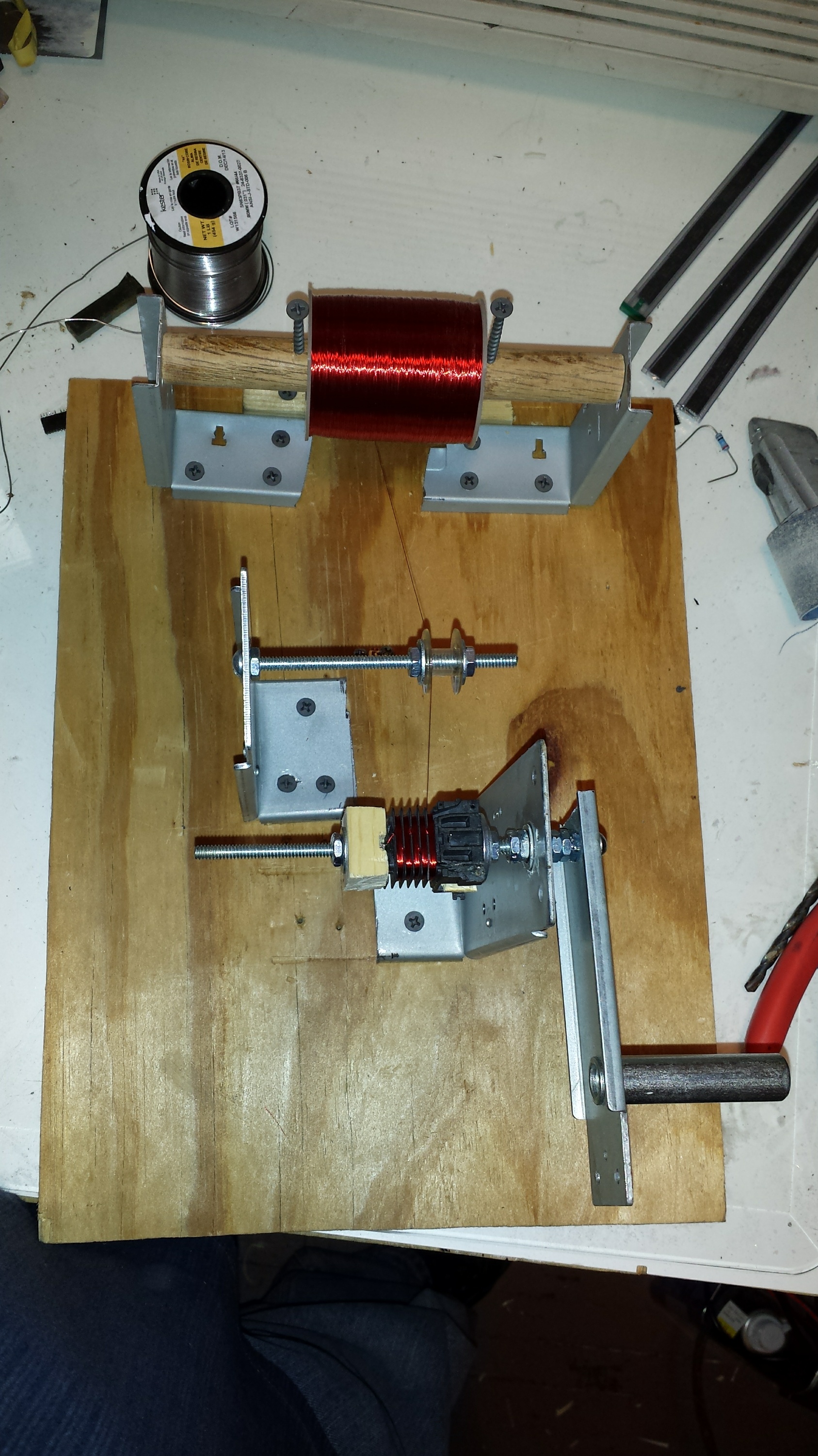

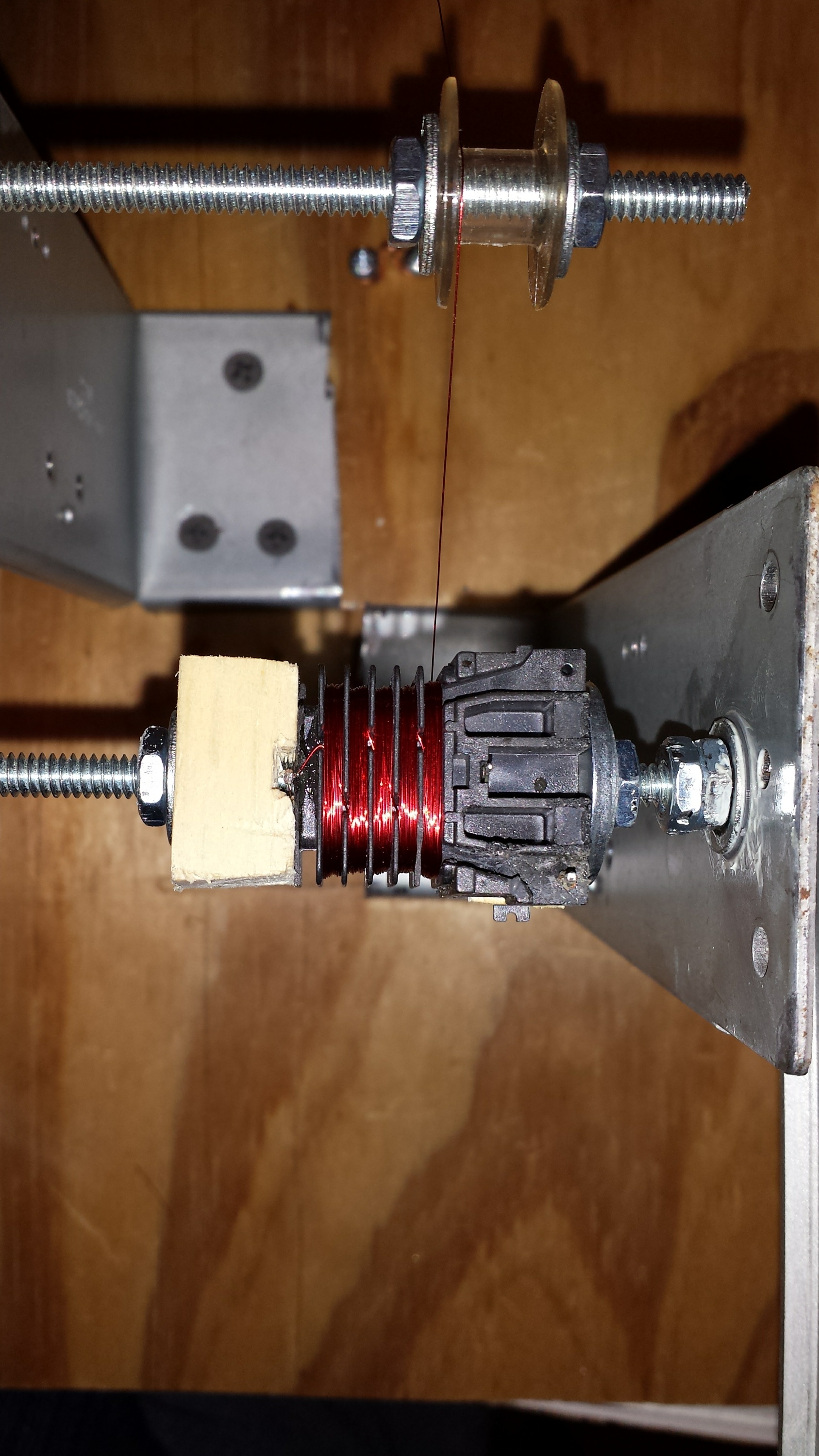

                                  #36
                                  Got the transformer wire today. Made this jig and am working on the first one. So far, so good. Resistance on the one bobbin I've completed is about 32 ohms. Working transformers I've tested were average 27 ohms. Is 5 ohms going to make a difference? Actually, I had a working transformer months ago which was 31.5 so this should be OK. Definitely could do better with a counter attached to this.

                                    #37
                                    It is the turn ratio that you need to maintain also, smaller gauge wire can have higher DCR compare to the the same turn using bigger gauge wire. You should also use LCR meter to test the inductance which is also important spec. The Phase of the winding should also keep that in mind.

                                      #38
                                      I used a caliper to gauge the wire (bare). I'm using 35 AWG triple poly nylon. They both read the same on the caliper. I'm going to get an electronic counter for my jig so I can better maintain the turn ratio. I did this slow so I wouldn't lose count though. I will test with the LCR too. I will have to pull a good transformer to get a comparison reading. I was careful to make sure I wrapped them in the right direction, which I guess would be the phase.
