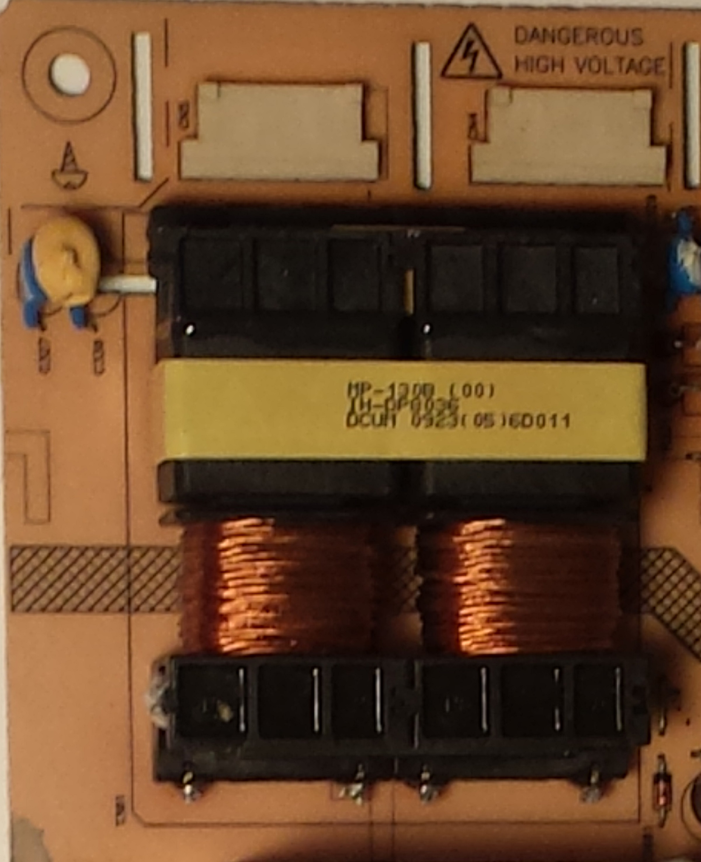

    Over the past couple of months I've encountered 5 of these inverter boards (P/Ns 1AV4U20C41500 and 1AV4U20C41501) which had failed. Of those 5, 2 were PWM failures and 3 were inverter transformer failures. I have failed 3 separate times at disassembling the transformers for rebuild. My most recent failure involved soaking the transformer in MEK overnight to dissolve the varnish which holds the ferrites in. The varnish dissolved (including on the primary windings which weren't bad) but the ferrites still cracked. Even when I have managed to get the ferrites out in one piece, the bobbin that the secondary is wound on usually breaks because it is fused to the primary bobbin.
    So, I've essentially abandoned the idea of rebuilding them. Now my idea is to locate a suitable SMD substitute and and make an adapter board. The adapter board would have the pin configuration of the original transformer and go in it's place. Then a SMD transformer would mount on that board and have tracings go to the correct pin locations. I at least think this could be done.
    My question though, is what I need to take into consideration when looking for a suitable transformer?

    Here's what I know about the transformer.
    Primary Winding 115 turns
    Secondary Winding 550 turns
    Primary Resistance 0.7-0.8 ohms
    Secondary Resistance 26-27 ohms
    How can I figure out the frequency?
    And the type?

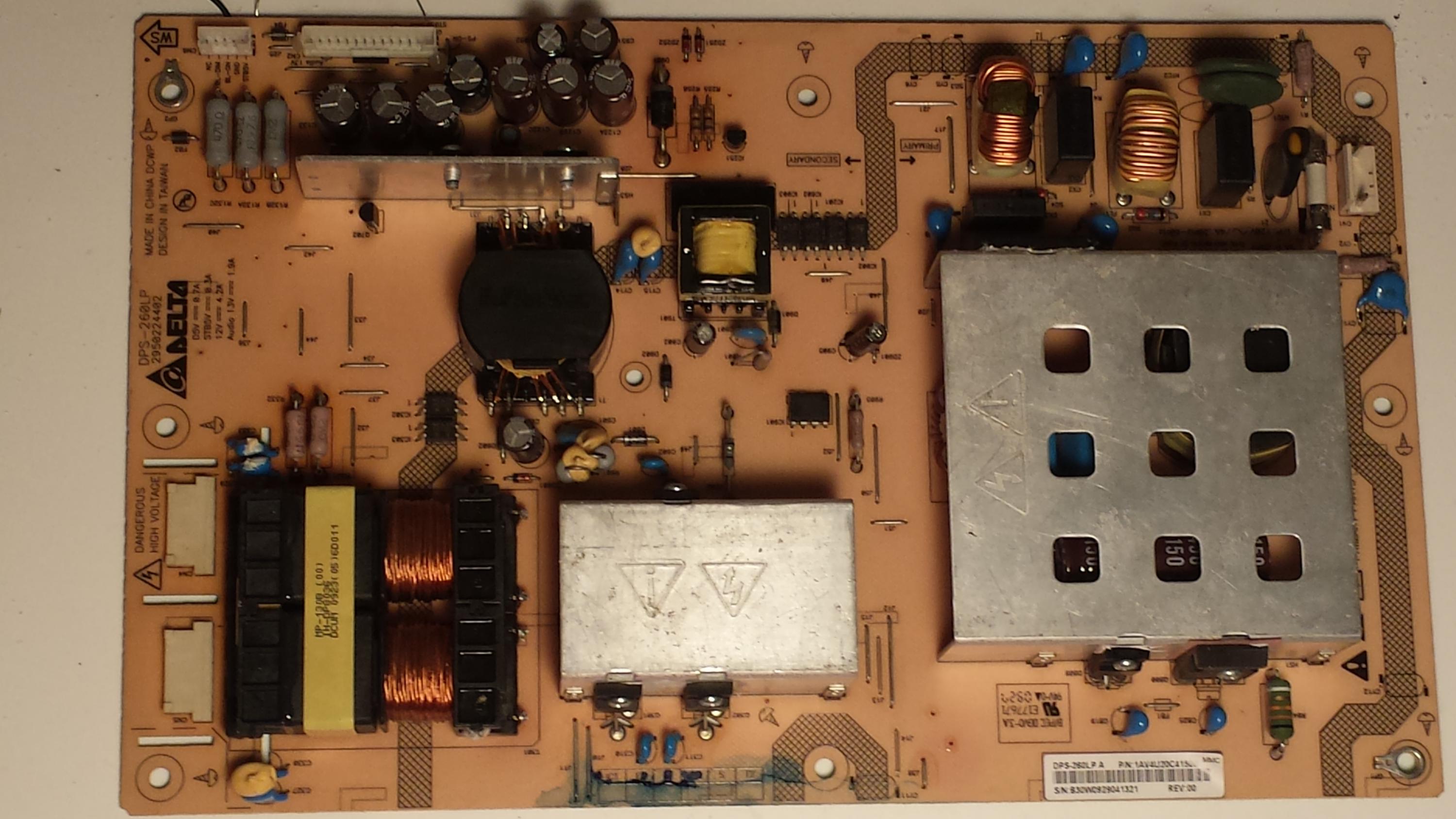

          Re: Transformer substitution - Sanyo DP42849-01
          are you sure that drives the lamps?
          that board looks like a combined psu and invertor.
          • lookimback
            • Aug 2013
            • 1489
            It is a combined PSU and inverter. I'll look at the data sheets from the other ICs and see if any might be the lamp driver.

                • 31250
                no, that's the pfc circuit.
                trace the transformers back to the fets that switch them.
                then trace the gate pin from those fets to find the drive chip.
                does it have parts on the other side of the board?
                  Here's a pic of the bottom and a link to one of my older threads which has some good closeups of the bottom.
                  https://www.badcaps.net/forum/showthread.php?t=33261
