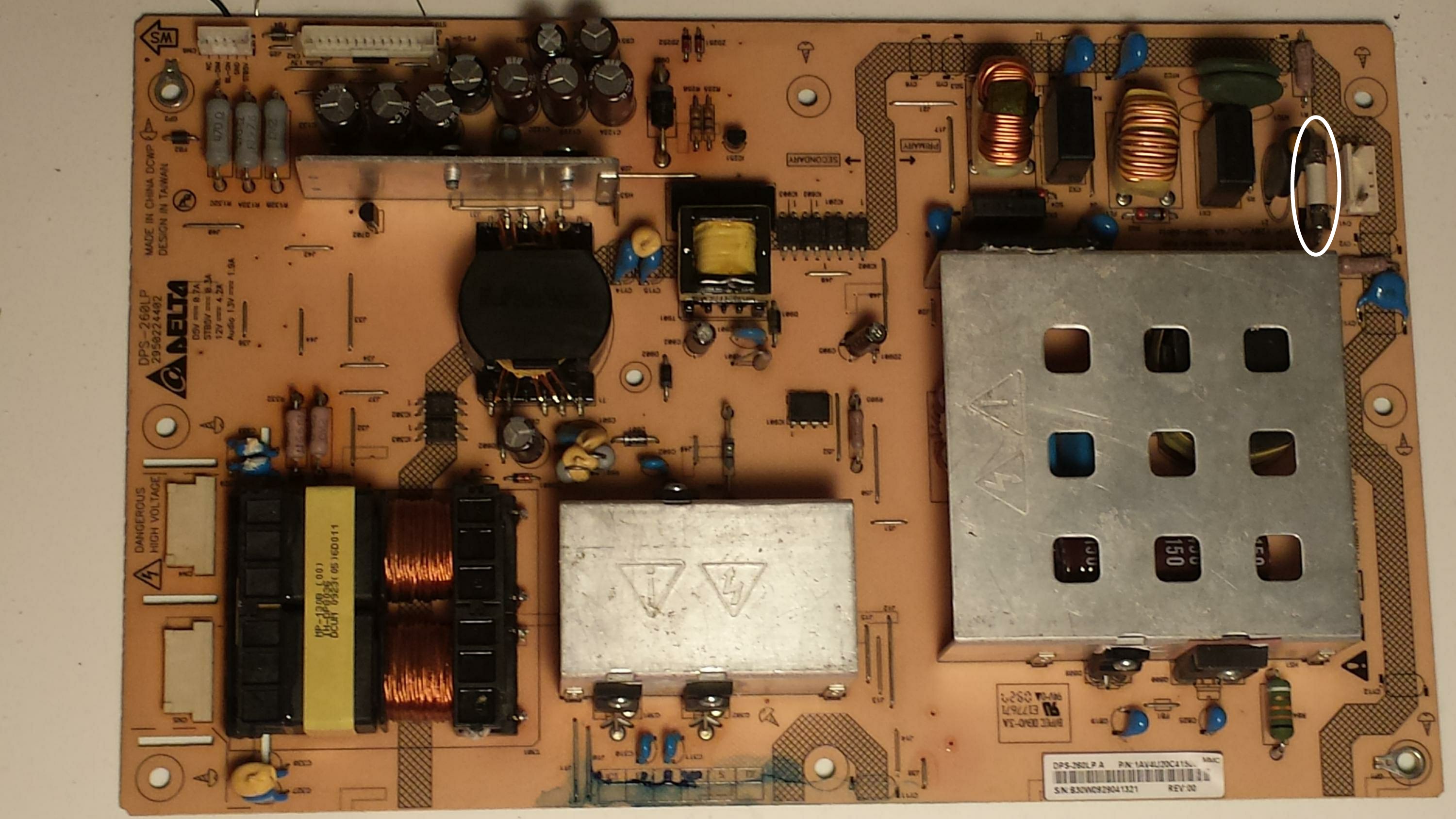

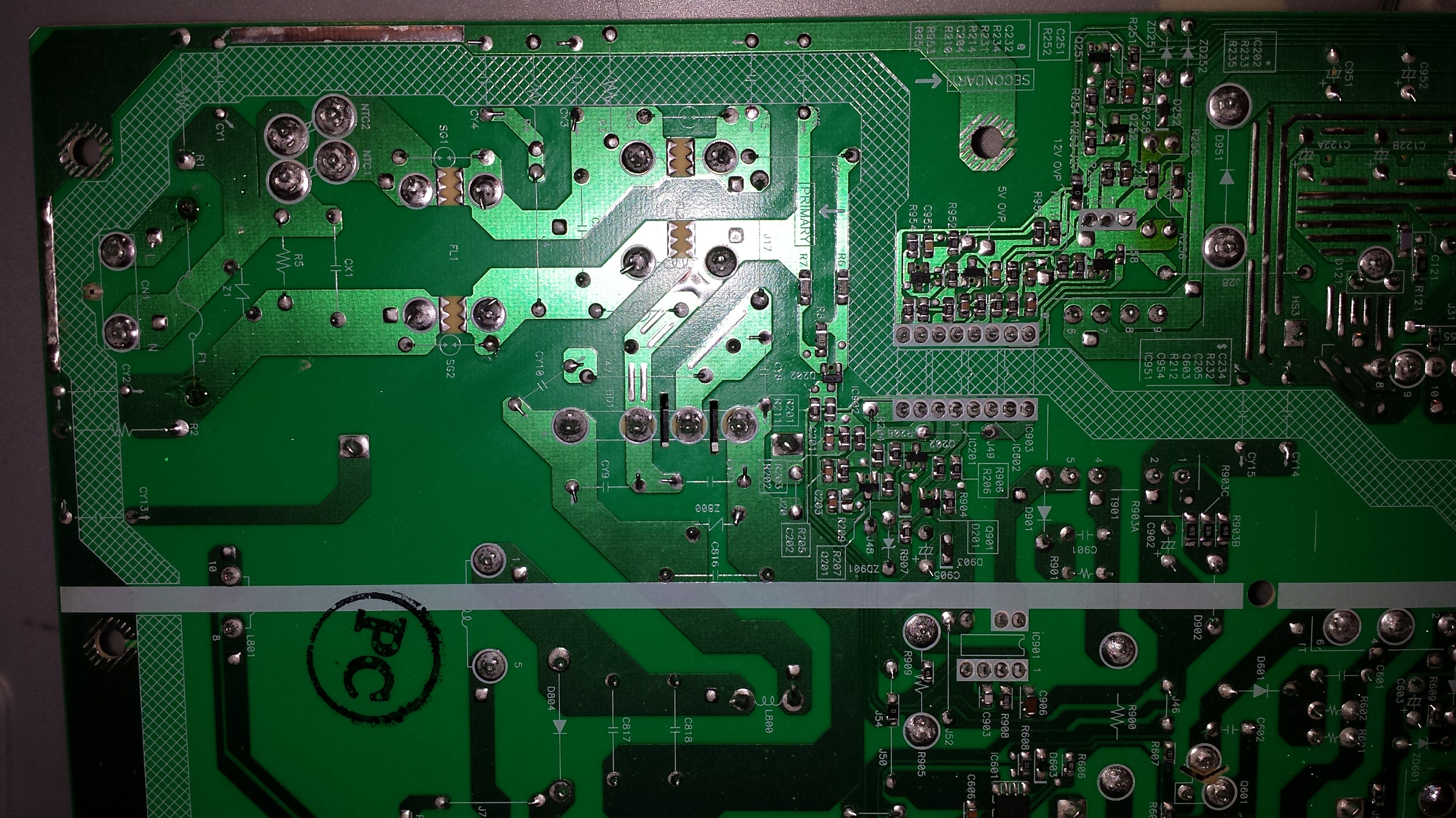

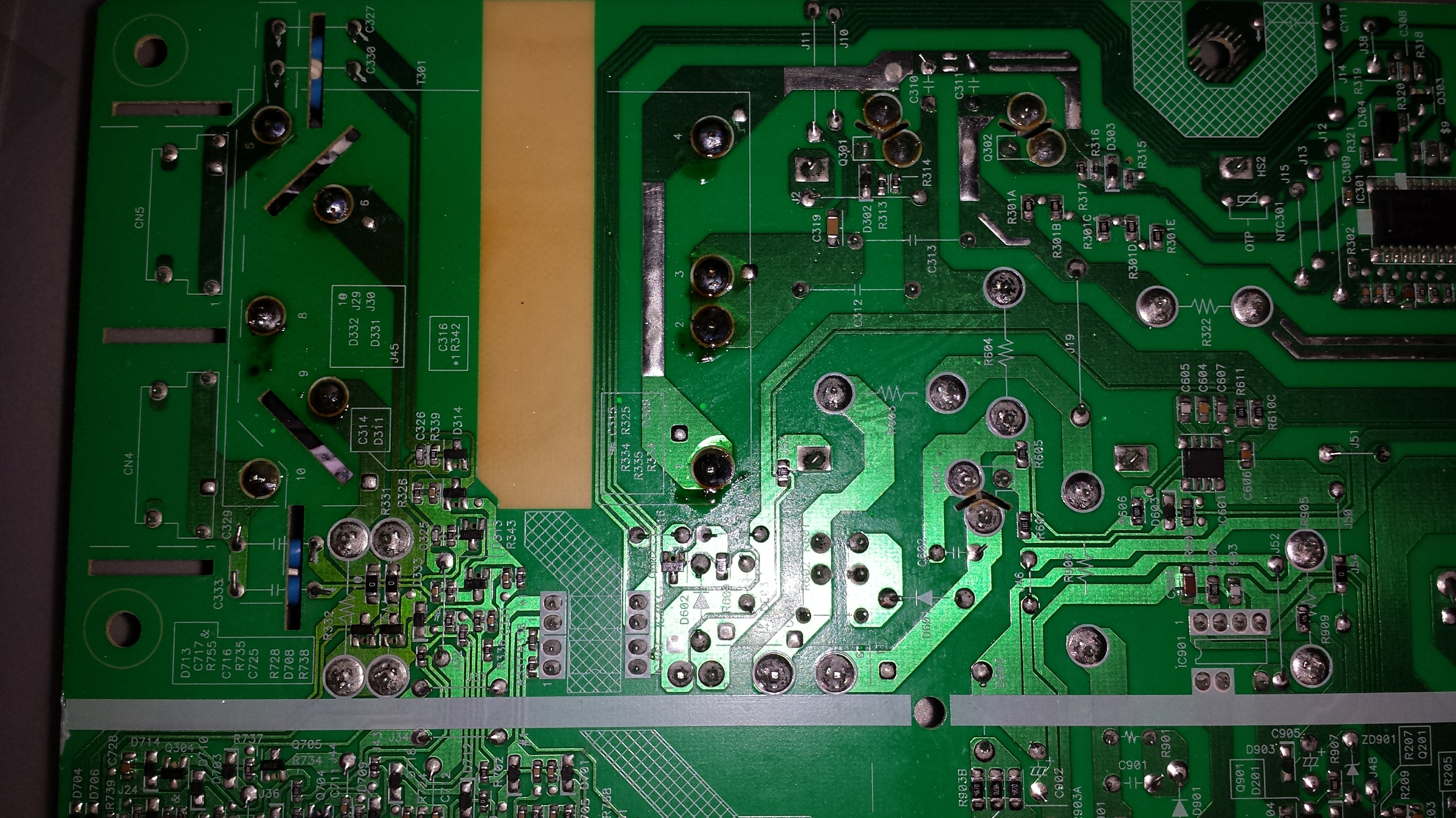

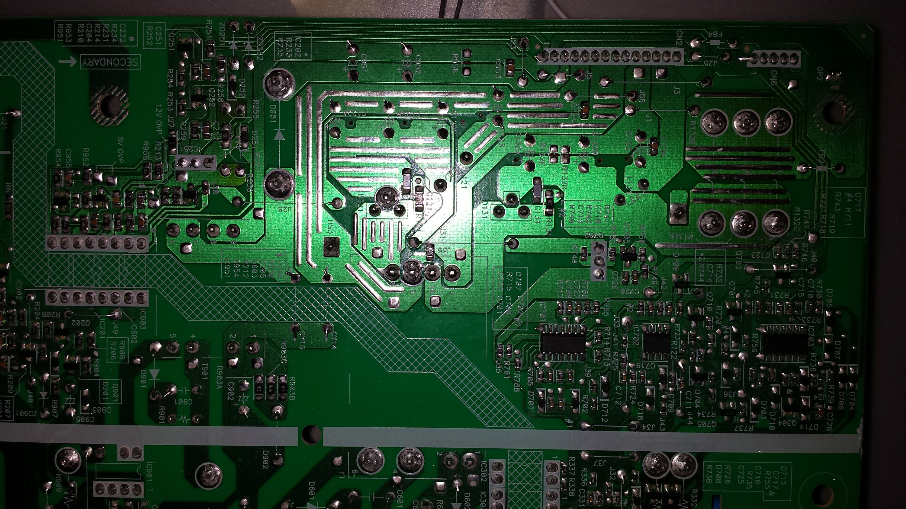

                        #51
                        Re: Transformer substitution - Sanyo DP42849-01
                        I get 1.68 amps. And as stated, I don't currently have a board with an original transformer. I have 2 more coming though so I might have a good one within a week. I'll cross my fingers and hope one is good. I've worked on at least 10 of these so far though and only 3 had good transformers, so the odds are not in my favor.
                        ------------signature starts here------------
                          #52
                          There may be a fusible resistor for feeding the Voltage to that inverter circuit where the power MOSFETs are mounted on that heat sink to the right of the inverter transformer. You can then check the voltage drops on that fusible resistor to calculate the current draw.
                          • lookimback
                            • Aug 2013
                            • 1489
                            #53
                            Can you tell from these pics which one it would be?
                              #54
                              It looks like you will be measuring the DC Voltage across fusible resistor R322 which is fed by the B+ from the positive pin of the main filter cap C821, this resistor will show the total current draw of the Inverter, standby power supply and the third supply I cannot clearly see from the picture, but this will give you some idea of the current draw, the inverter circuit will draw most of the current.

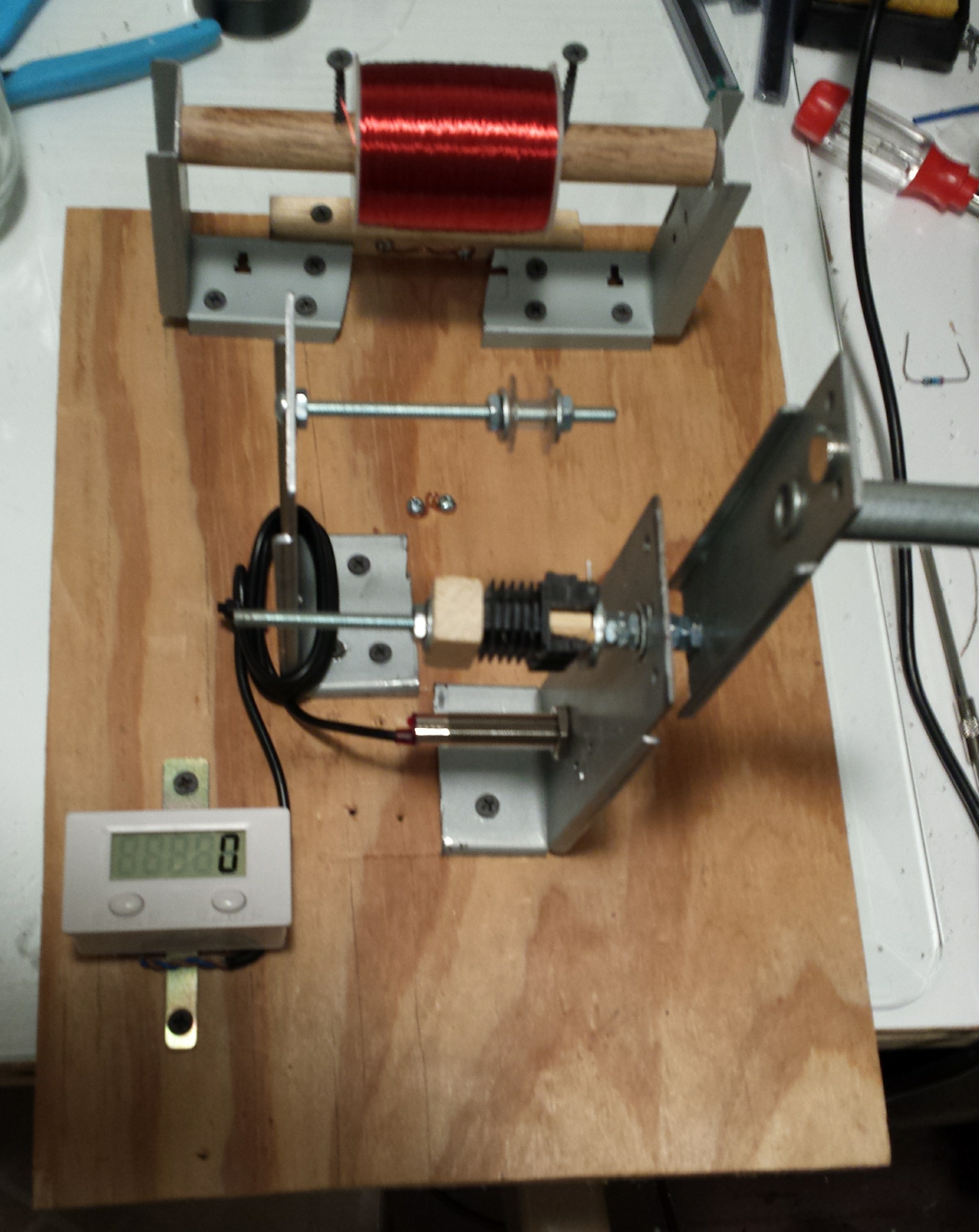

                                  #56
                                  I finally came up with another working board with a stock transformer. That board draws 1.45 amps and both with rebuilt transformers draw 1.68 amps. It's also the same if I put them on different boards, as I have a few spares without transformers. I ordered a laser temperature probe. When it arrives, I'll see what the actual temp differential is. I have a feeling I am going to have to up the gauge on the magnet wire. Also, I got the exact same voltage on both sides of resistor R322. Maybe I didn't do it right. I measured from the negative pin of the main filter cap C821.
                                  Got the digital proximity sensor counter installed and working in my winding jig too. Pic attached.
