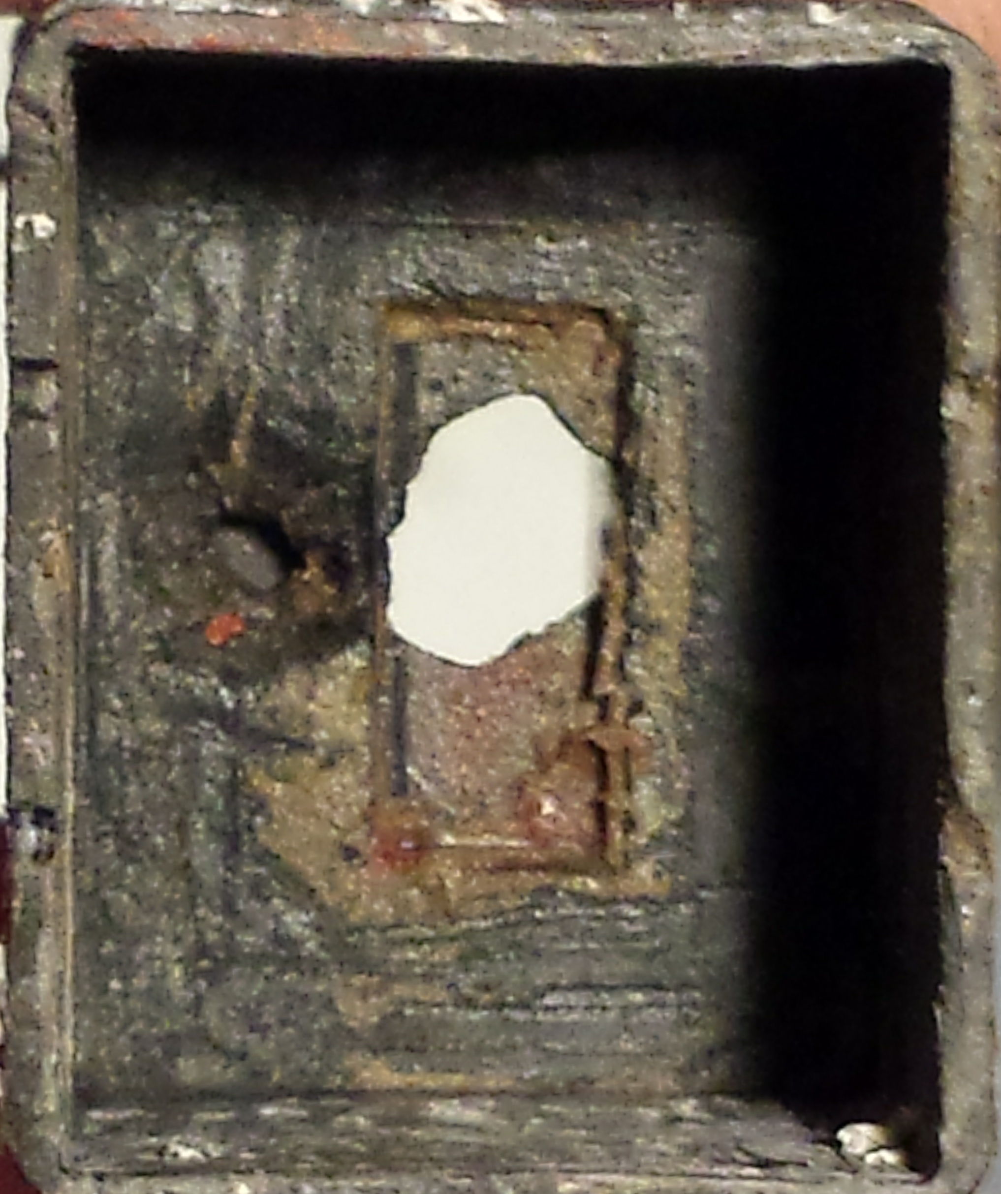

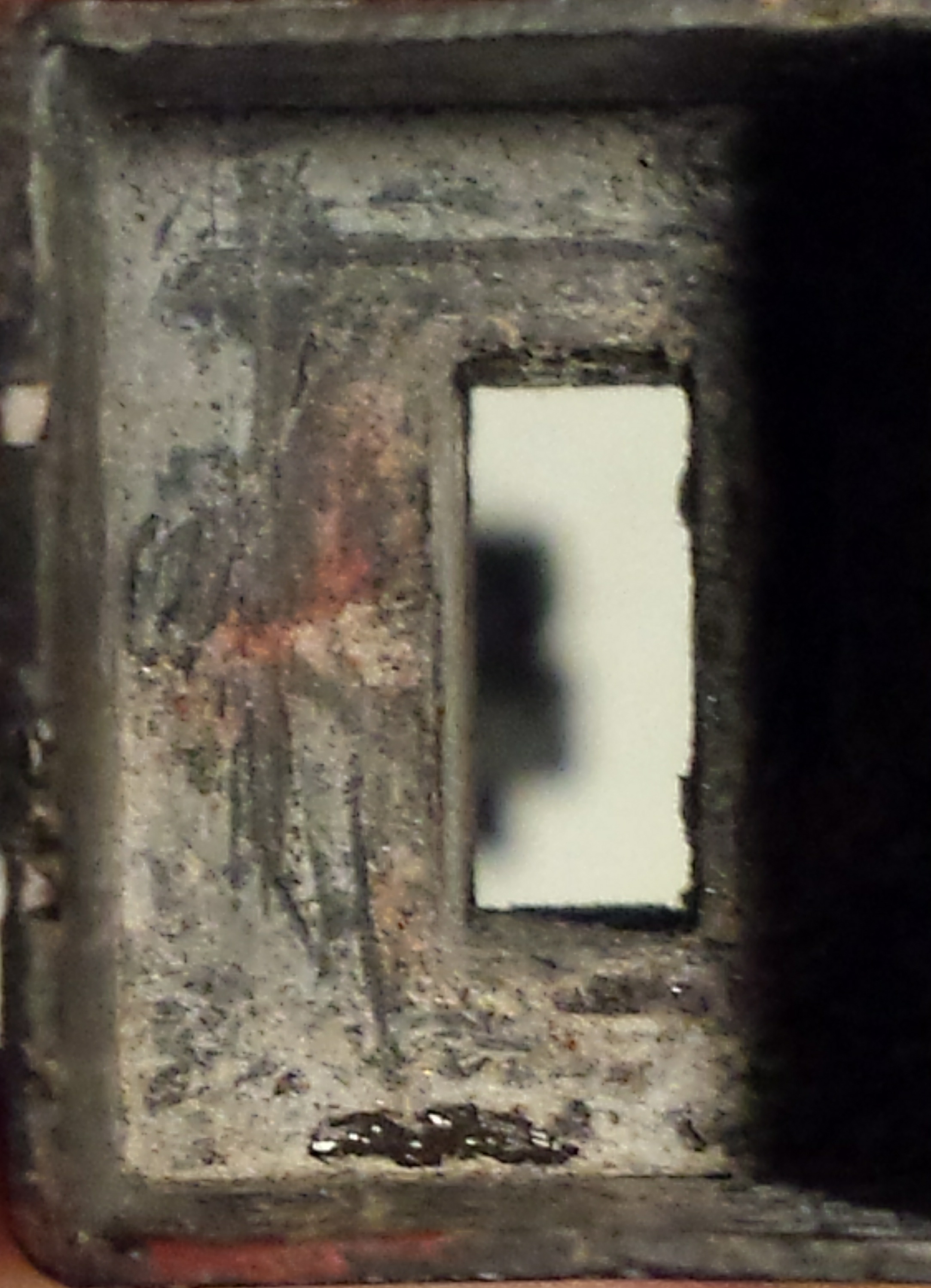

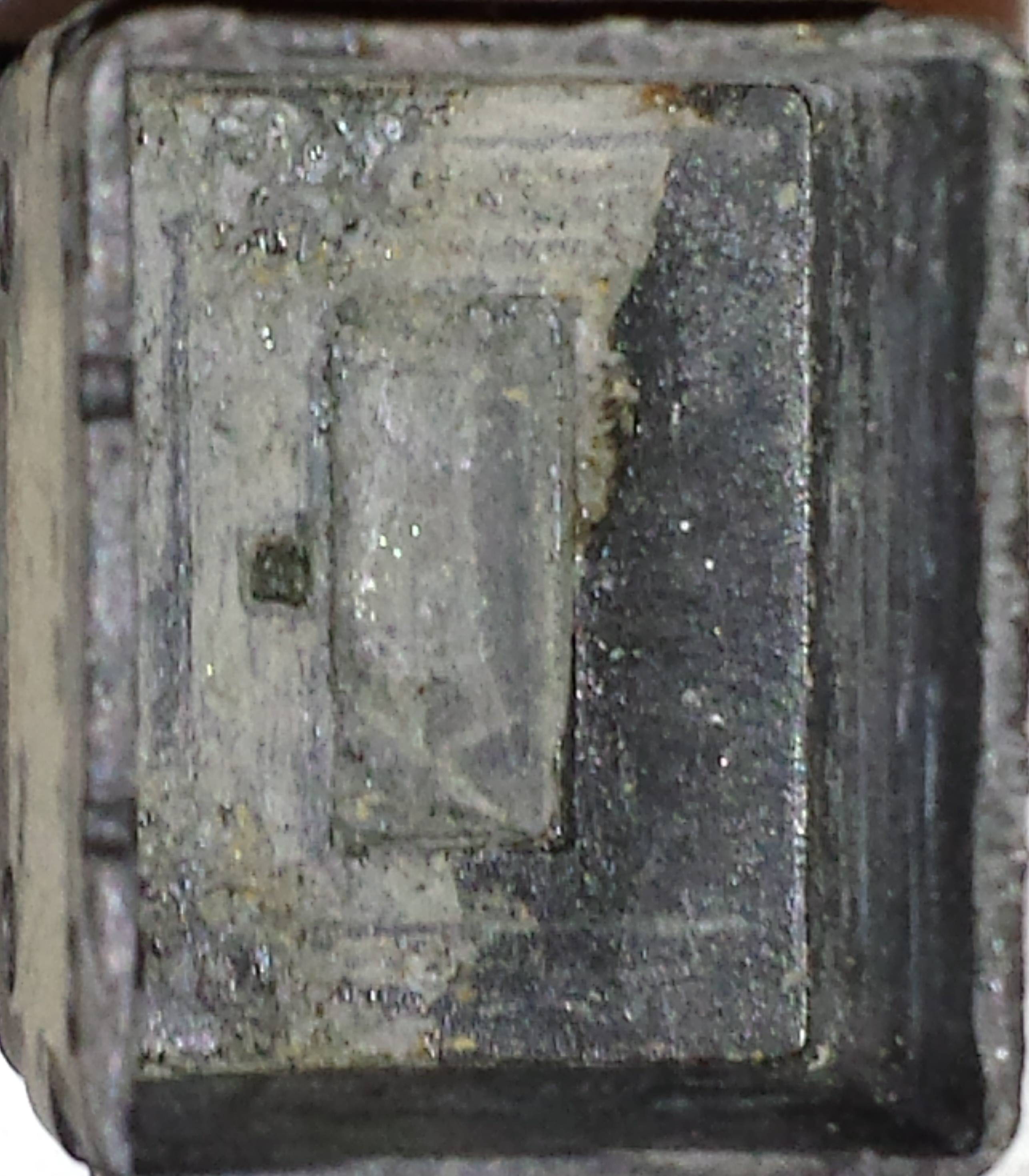

                      Re: Transformer substitution - Sanyo DP42849-01
                      I just put a caliper on a good transformer, and the last one I rebuilt. Good transformer, 57mm. Transformer I rebuilt, 58.24mm. That's from the back of the primary ferrite to the back of the secondary ferrite.
                      ------------signature starts here------------
                        After reading up on the purpose of an air gap (thanks Budm), I can be led to believe that maybe there is supposed to be a gap, but if so, I need to determine exactly what that gap needs to be. What's clear is that my last attempt is 1.24mm more gap than what it should be.

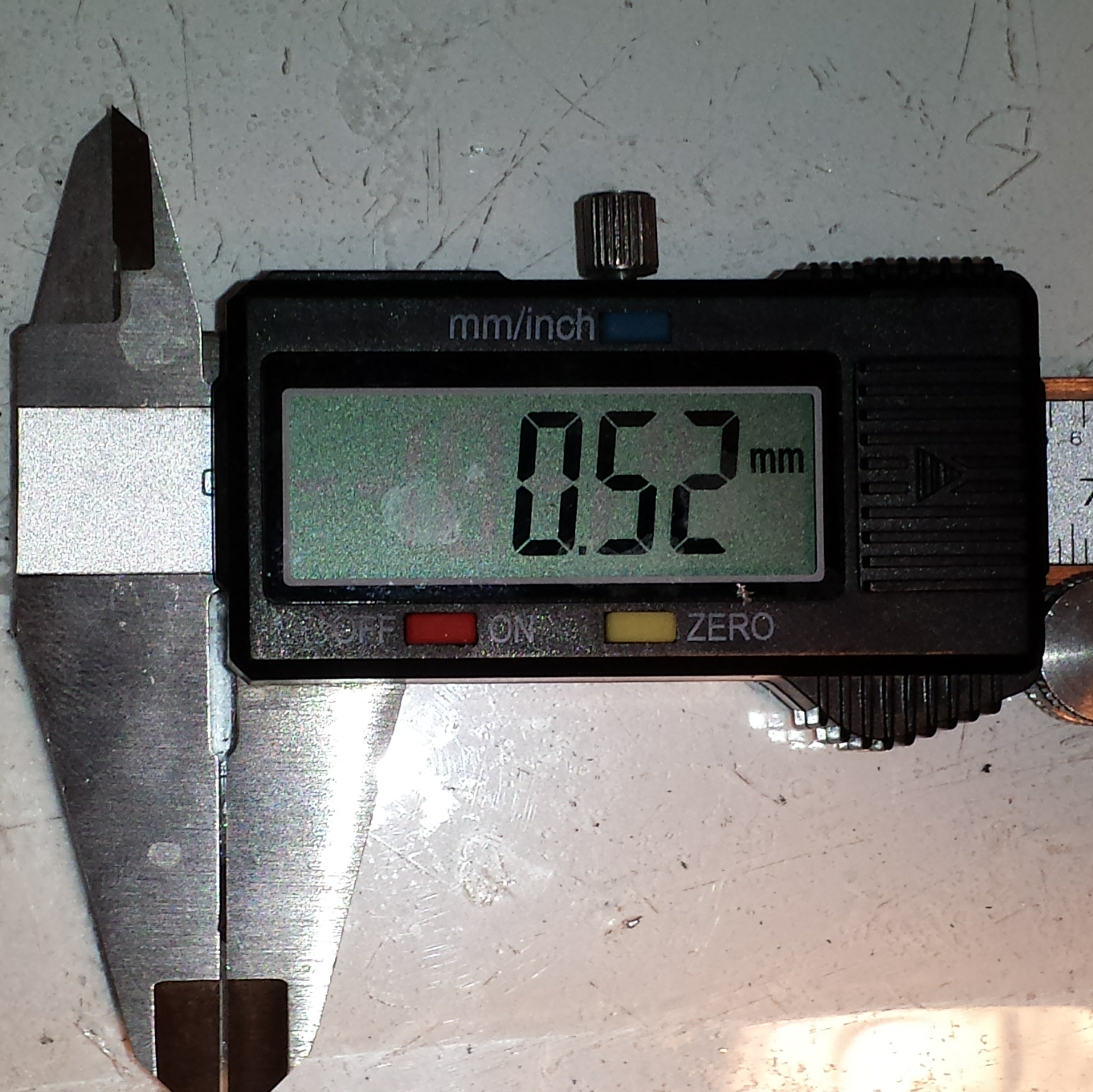

                          Didn't you say you measured the original glue at 0.52mm? I guess the correct gap would be that much? Or maybe I missed something.
                          -David VanHorn
