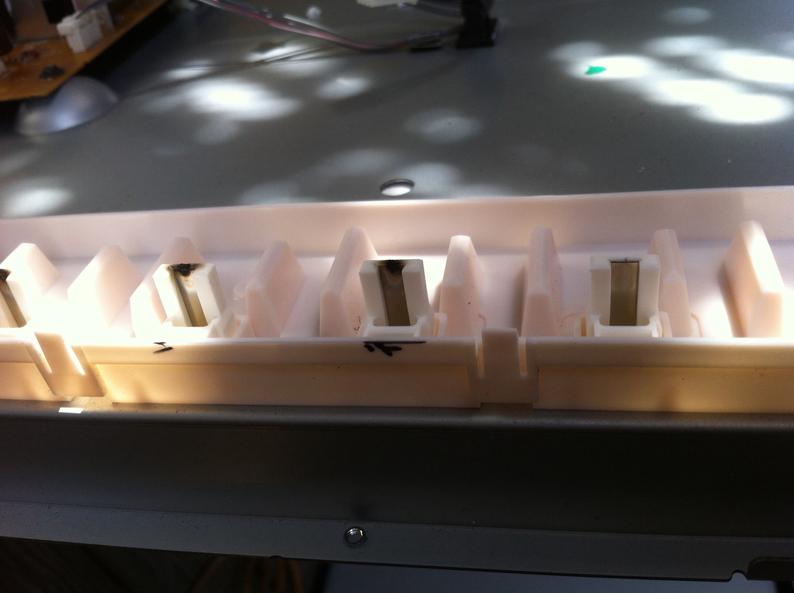

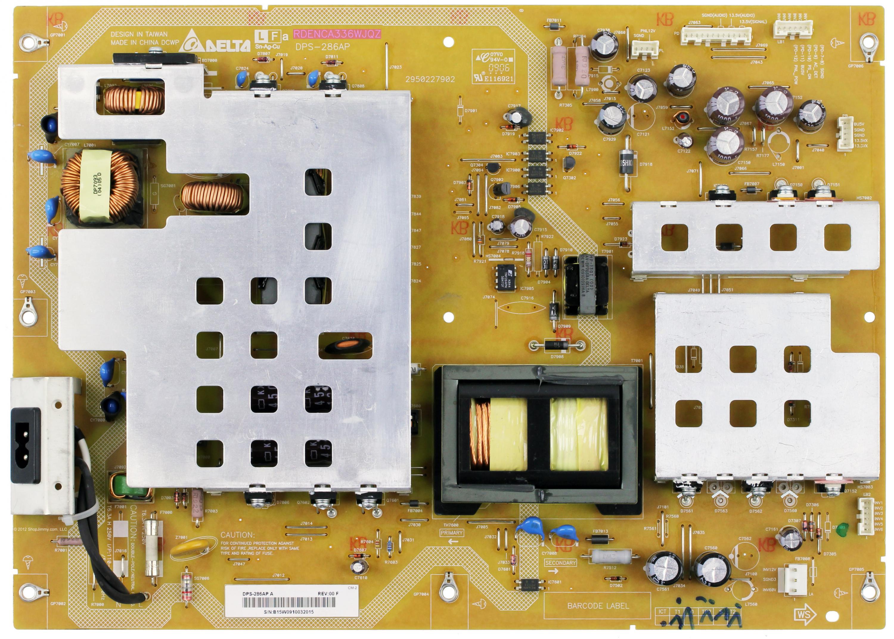

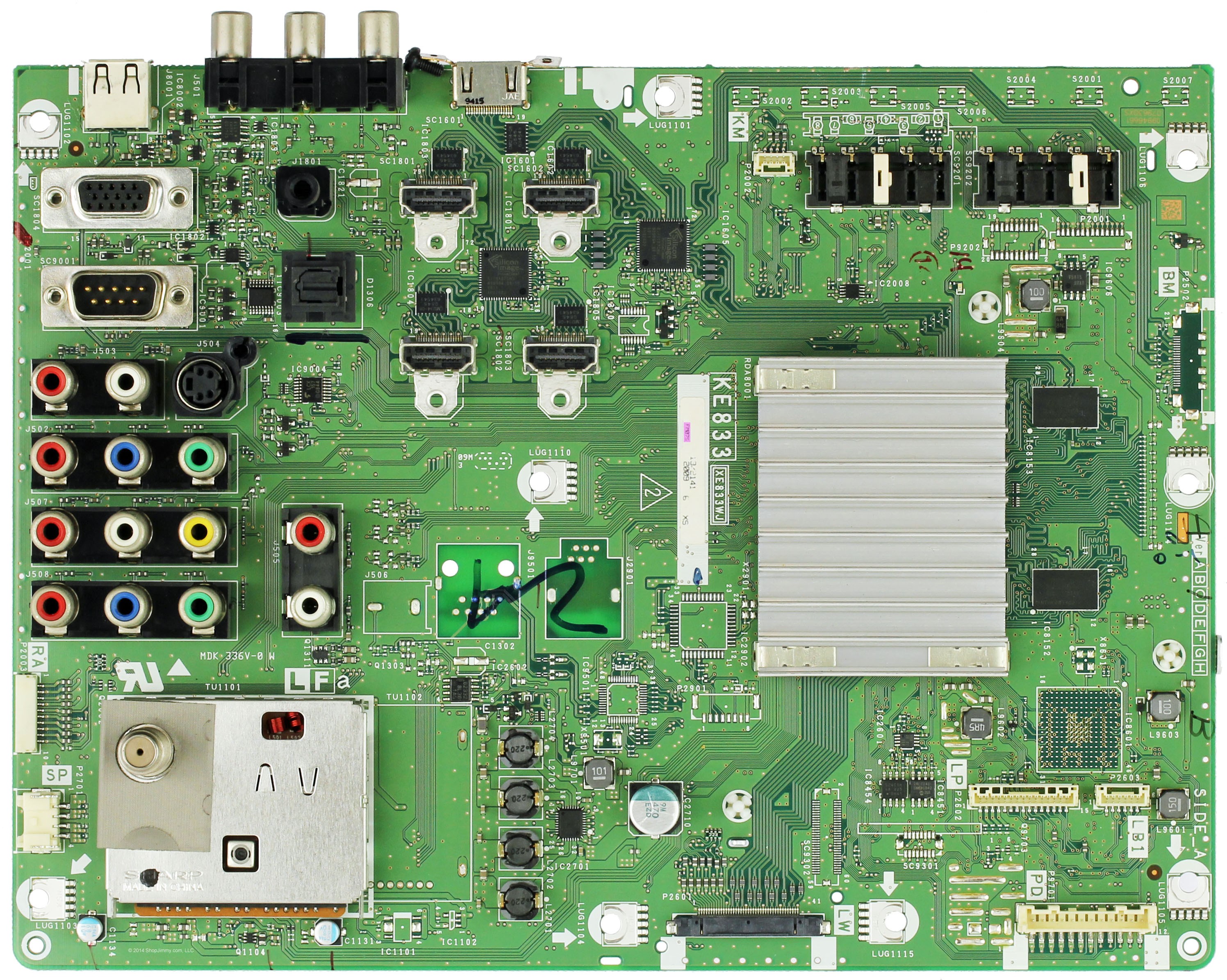

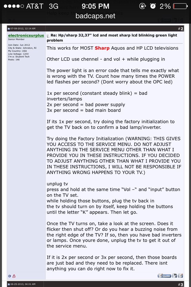

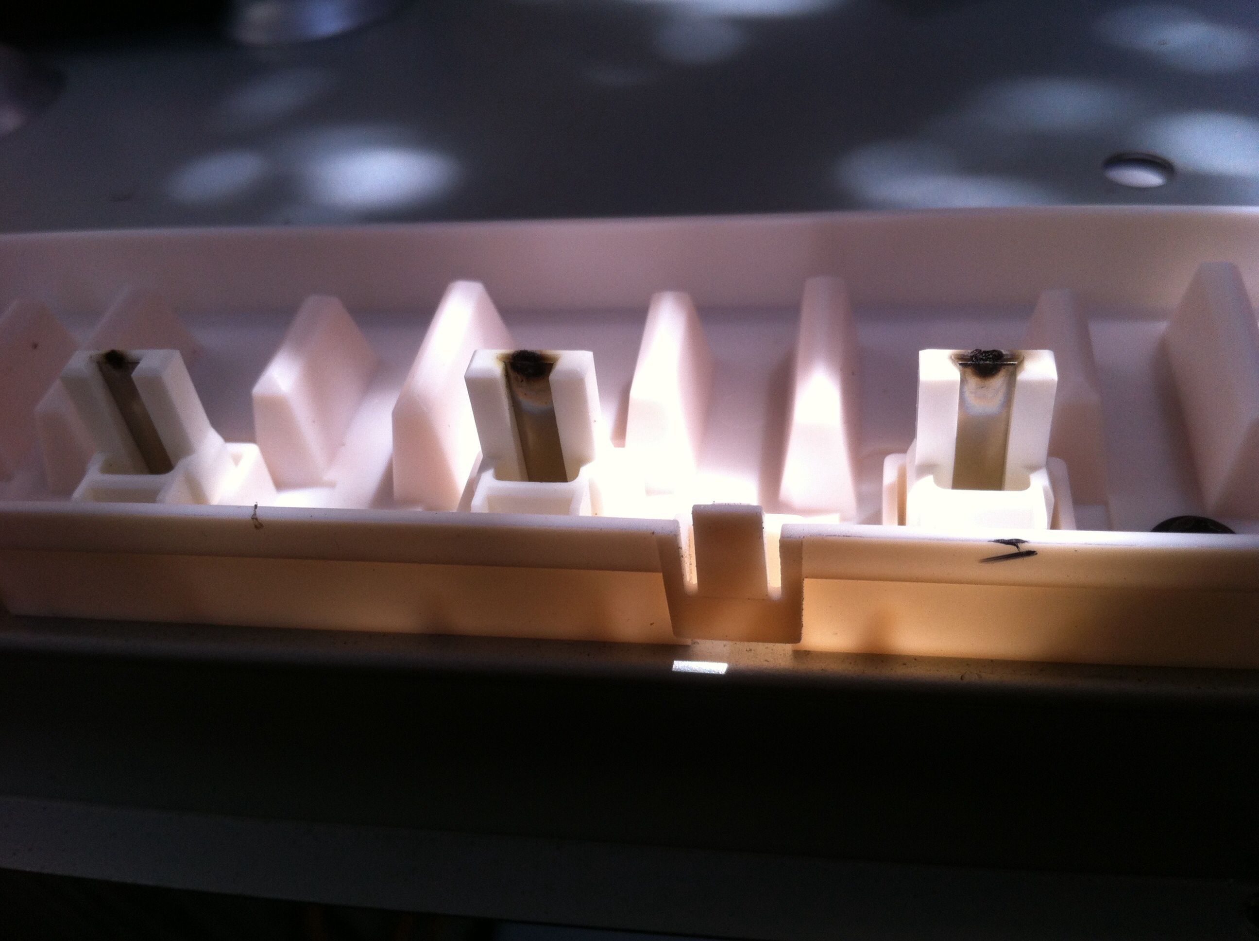

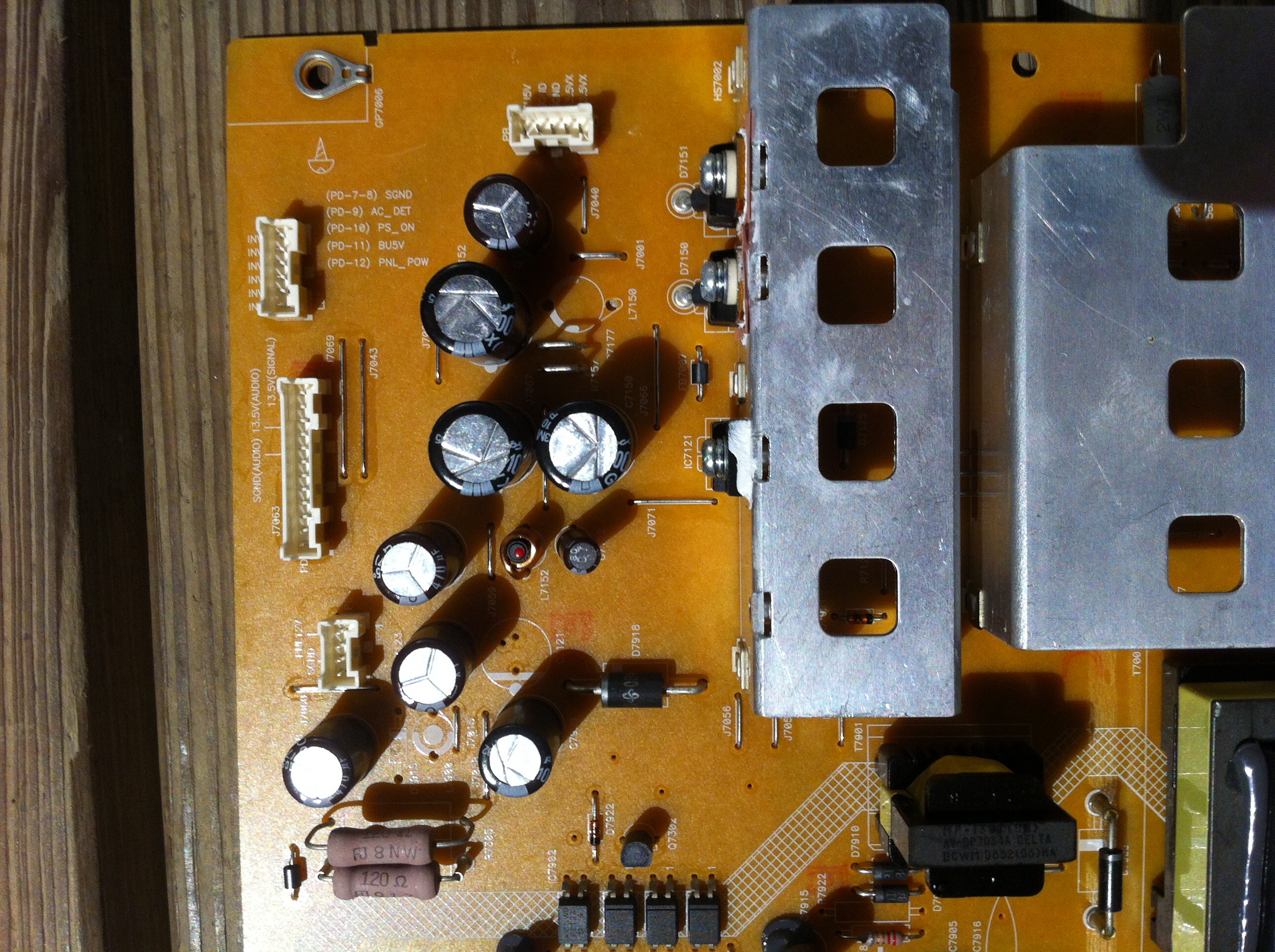

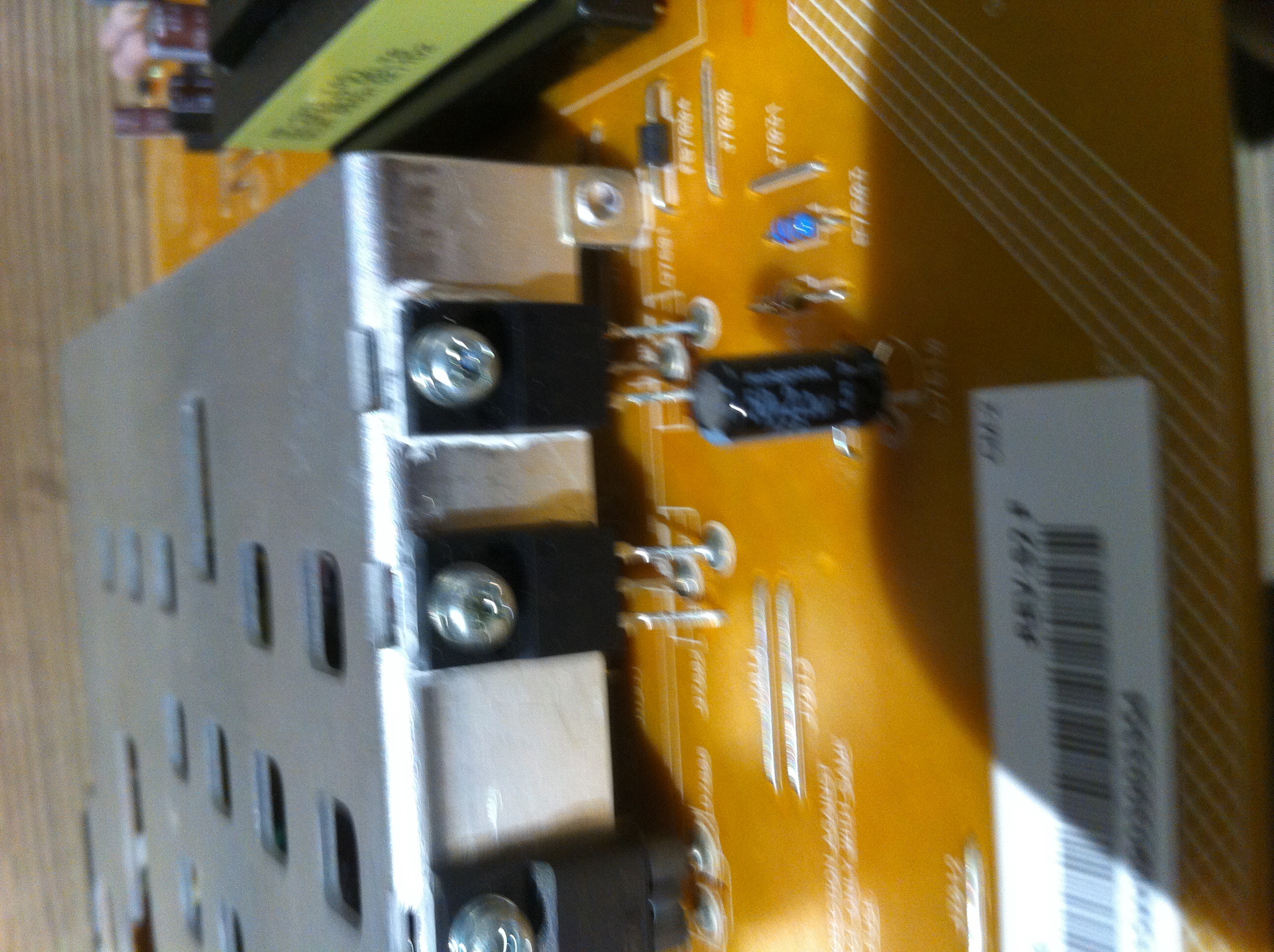

I have sharp lcd tv with no picture or sound at all no backlighting ..
After plugging in i hear click sound and green one light then two lights then one light then two an so ...
After opening i found big ass dead cockroach under power board looks like it may be damaged :/ please check the pic. Also i tried unplugging lvds cable no change at all still light go on ...
Any advise would be appreciated
Thx!!!
Also cabl box looks damaged too can this be the problem ?
