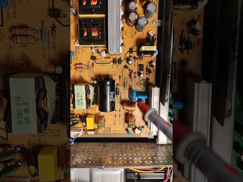

    I am currently trying to repair a Grundig Vision 9 37 9880 T USB LCD TV for a friend that has a weird audio problem. Basically everything works fine except for the heavily distorted sound when the Subwoofer module is connected and there is a buzzing sound coming from the PSU PCB.
    This seems to be a rather rare TV so there is not much prior on topic help to be found however a service manual is available at the usual sources (Electro Tanya i.e.).
    I think the PSU buzzing comes from one of the coils near the bridge rectifier but I am not sure if this really is a problem or just a very noisy power supply. I do have professional experience with electronics but I am certainly not a TV repair guy. The output DC voltages from the PSU PCB seem to be fine. So while annoying for the moment I think this might just be severe coil whine and the issue lies with the sound chip or main logic board.
    The audio system seems to be divided into a sound bar (sound projector) that's mounted beneath the screen and a subwoofer module that is mounted to the back shell / housing of the TV.

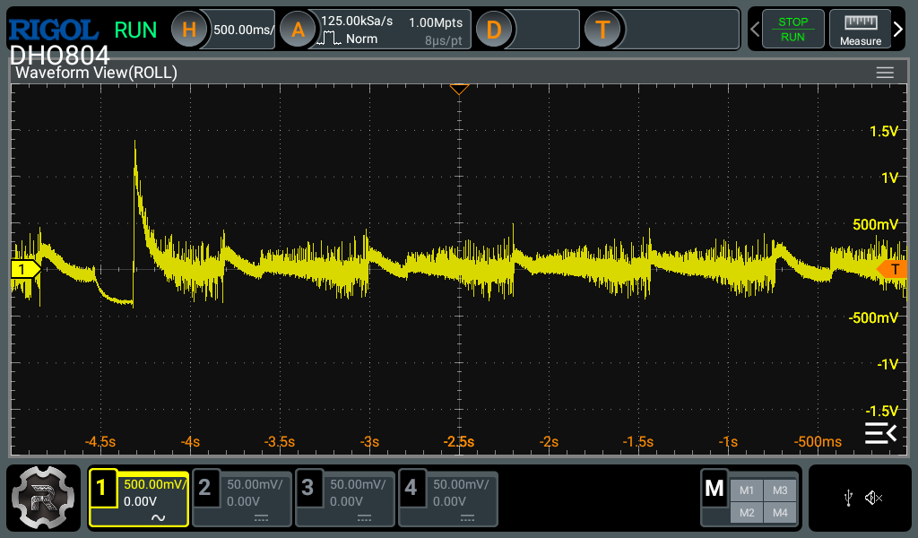

    When the TV is turned on after being turned off at the power strip level a farting like noise is emitted from the sub module but that goes away shortly after.

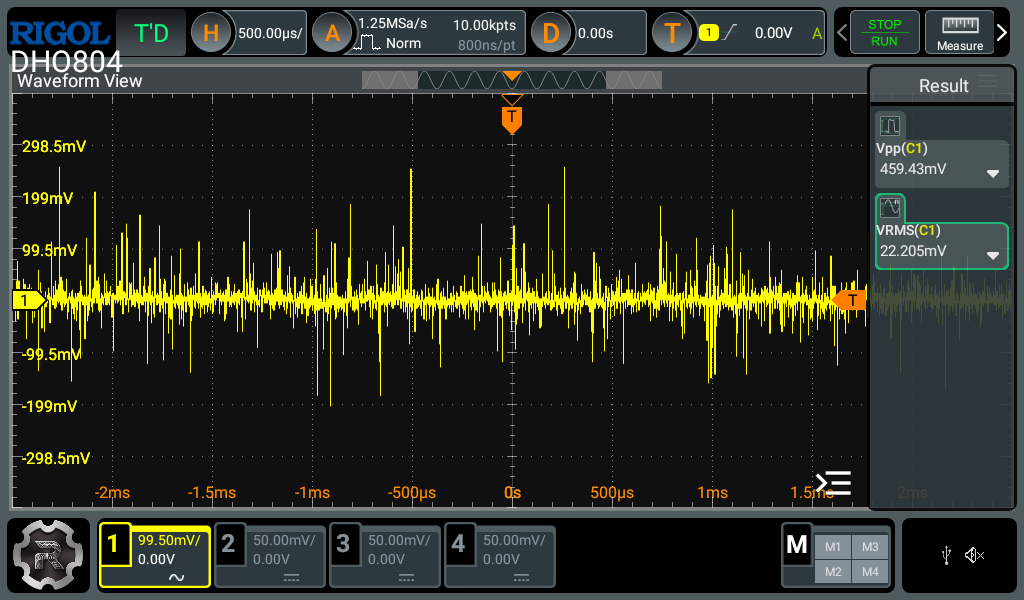

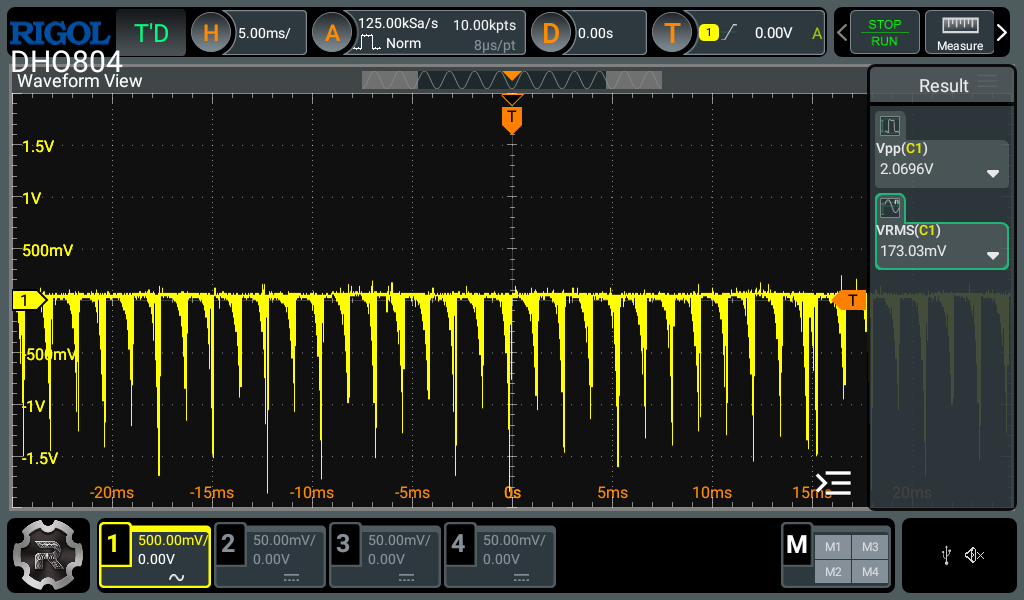

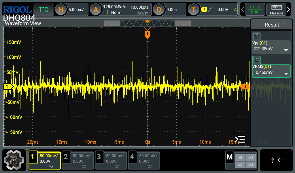

    My approach to test the audio was to listen to some music which sound distorted as if the sub speakers are damaged however I testes the subwoofer module on the bench with an external amplifier and the speakers seem to be fine. No damage to the rubber surrounds and tone is fine. No scratching. Coils seem to be able to move freely.

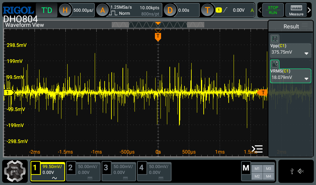

    The next thing I tried was to feed a 20Hz to 20Khz sine sweep (found on youtube) to the system via HDMI3 and it sounds horrible. More like clicking or rattling in the lower frequencies. When the frequency gets higher the sound is more normal for a sine signal.

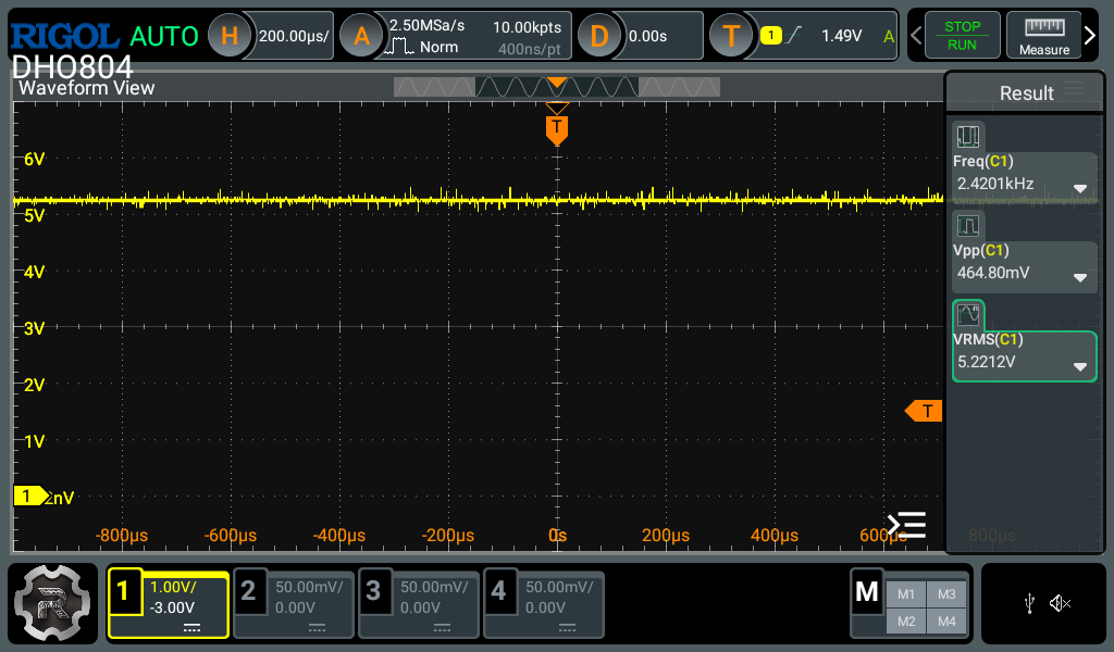

    I also measure total garbage signals even with a steady 1kHz sine wave on all terminals (headphone out, subwoofer speaker terminals, tweeter speaker terminals) with my new Rigol DHO804 scope.

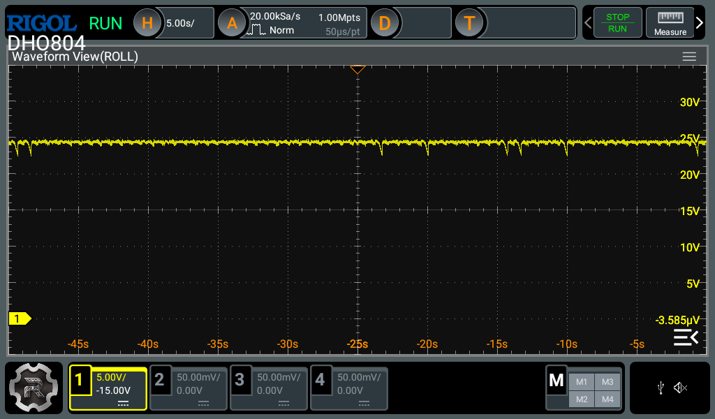

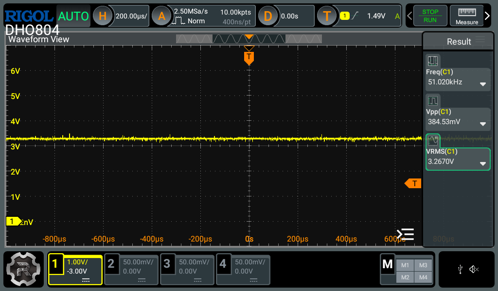

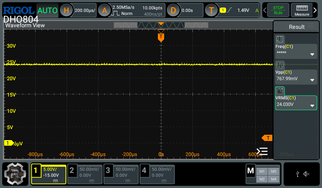

    Measurements with DMM on the PSU PCB's connector to the logic board:
    +5VS, 5.214V
    GND, 0.01V
    BL, 3.265V
    DIM, 3.290V
    +24V, 23.96V
    STBY, 2.946V
    +12V, 11.899V
    GND, 0.0214V
    Measurements with DMM on the PSU PCB's connector to the backlight inverter board:
    GND, -0.0042V
    +24V, 23.95V
    BL, 3.265V
    DIM, no wire connected

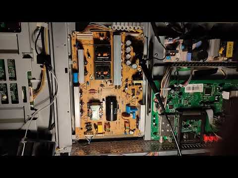

    Some Videos that I've shot with some scope measurements down below.
    Grundig 37 9880 T USB PSU Buzzing Noise
    Grundig 37 9880 T USB Farting Noise
    https://www.youtube.com/watch?v=eqRuUCotLAI
    Grundig 37 9880 T USB 100Hz Sine Garbage at the Headphone Out
    https://www.youtube.com/watch?v=5PlE8wRZYbk
    Grundig 37 9880 T USB 100Hz Sine Measured (at Sub Module)
    https://www.youtube.com/watch?v=_xRJSTvvYiE
    Grundig 37 9880 T USB Thermal 1
    https://www.youtube.com/watch?v=QBh1jmPa3t8
    Grundig 37 9880 T USB Thermal 2
    https://www.youtube.com/watch?v=e62o-2_bwEA
    I suspect that the STV8357FSX sound processor is damaged but I don't know if this could also be some other issue related to the PSU buzzing. Help is much appreciated.

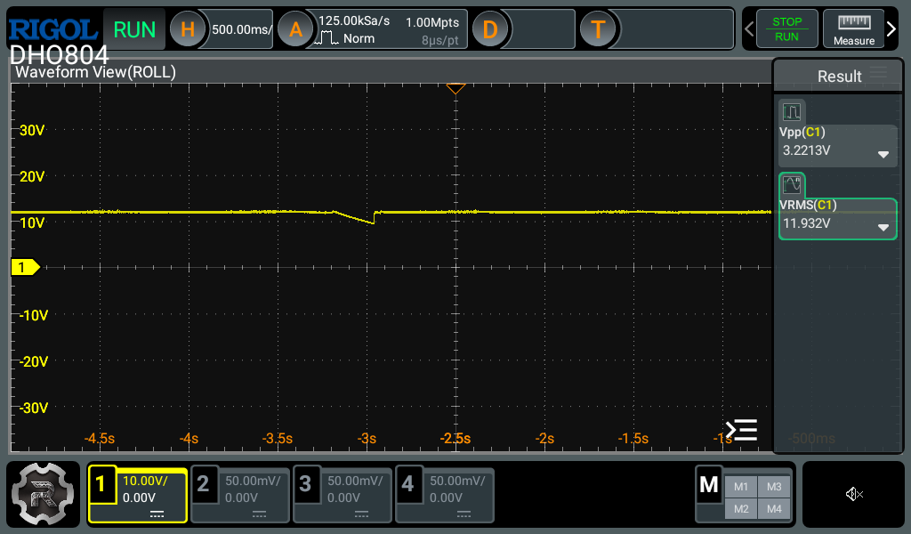

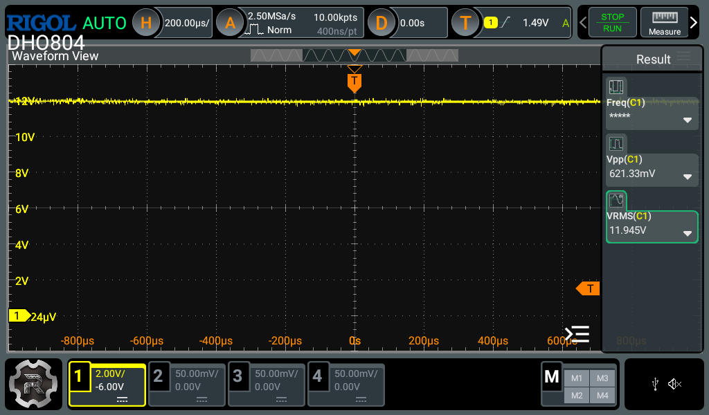

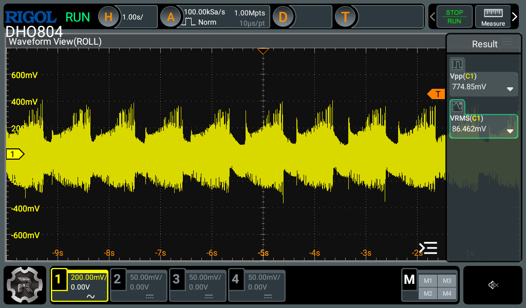

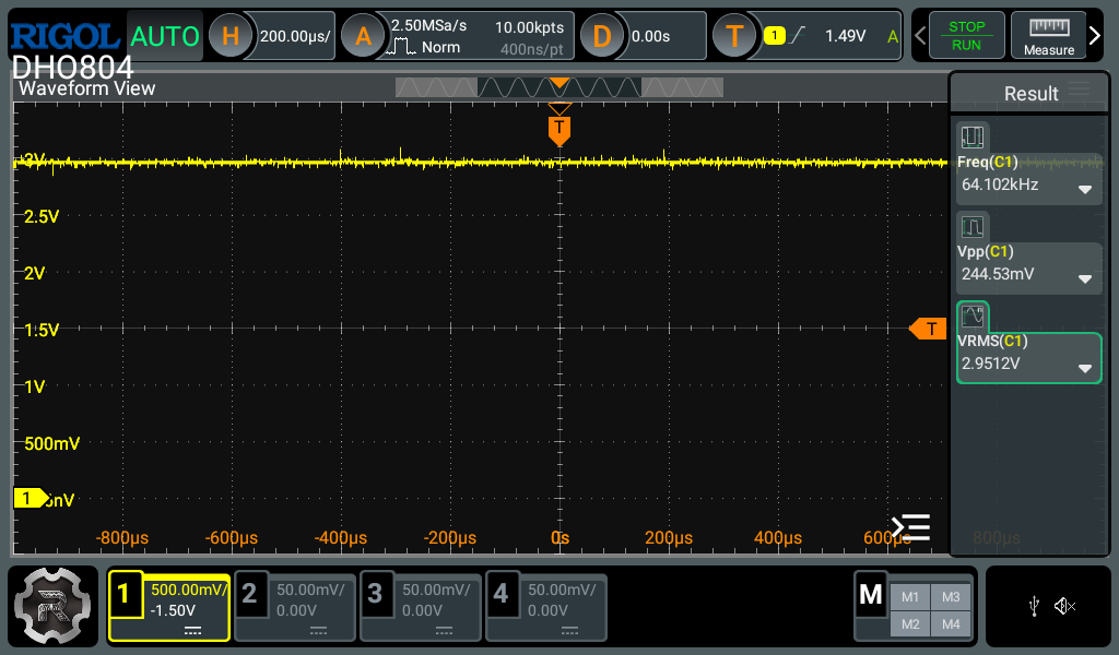

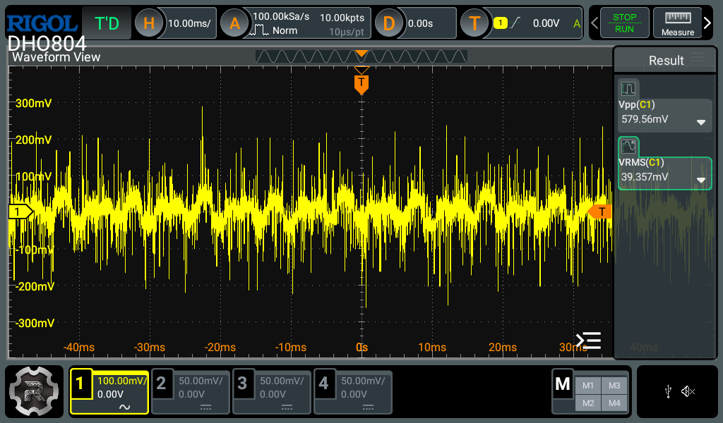

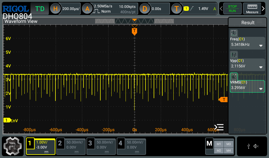

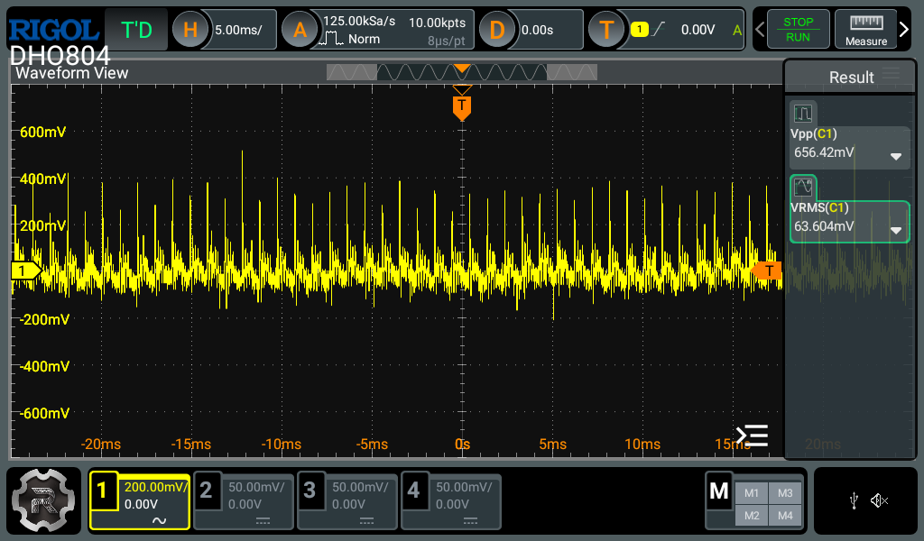

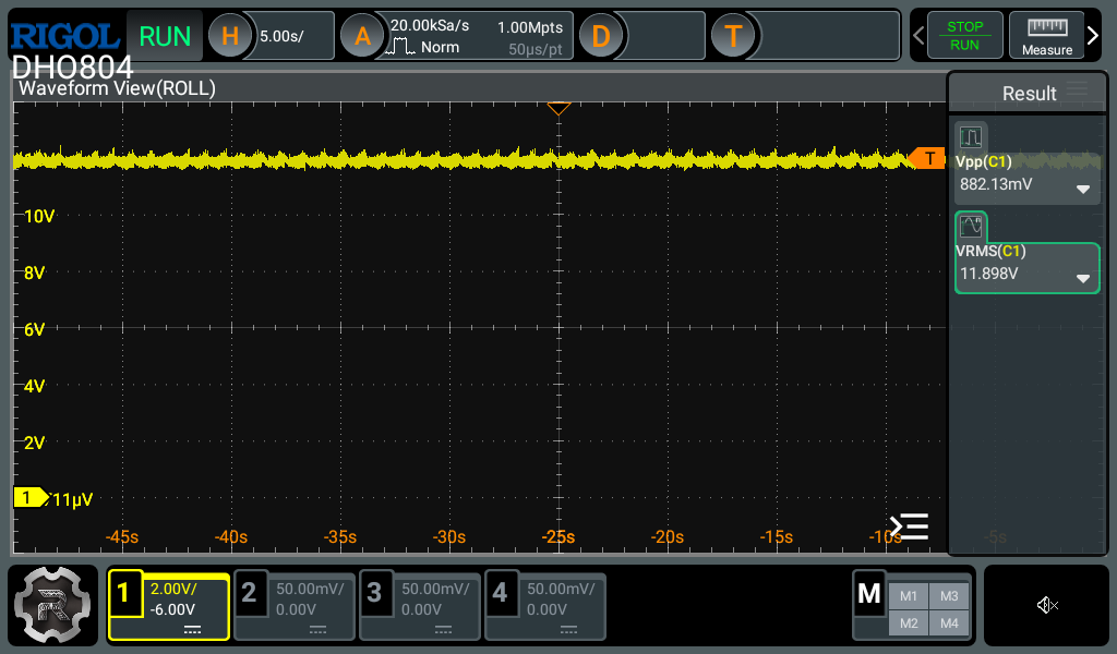

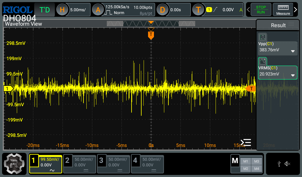

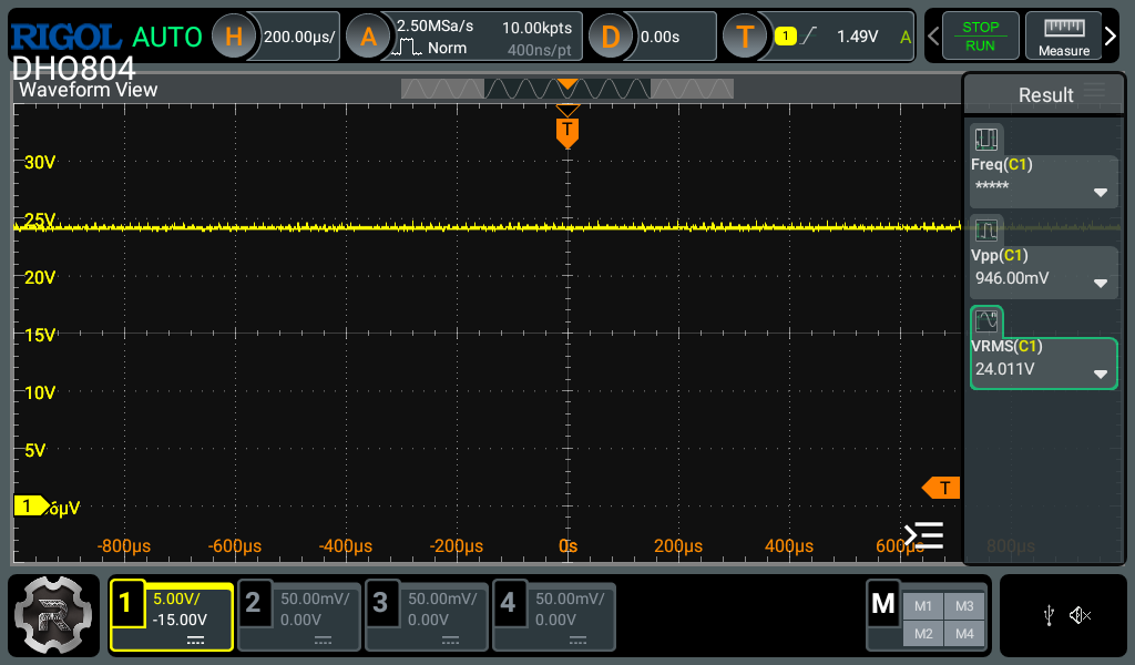

    Some scope screenshots attached ...

      Buzzing Noise at PSU could be Filter leak.... or Overload to narrow the issue. run the PSU in stand alone test.. if the Buzzing Noise disappear... then the issue not at PSU

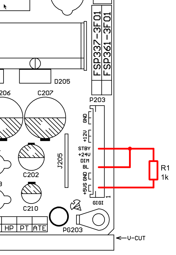

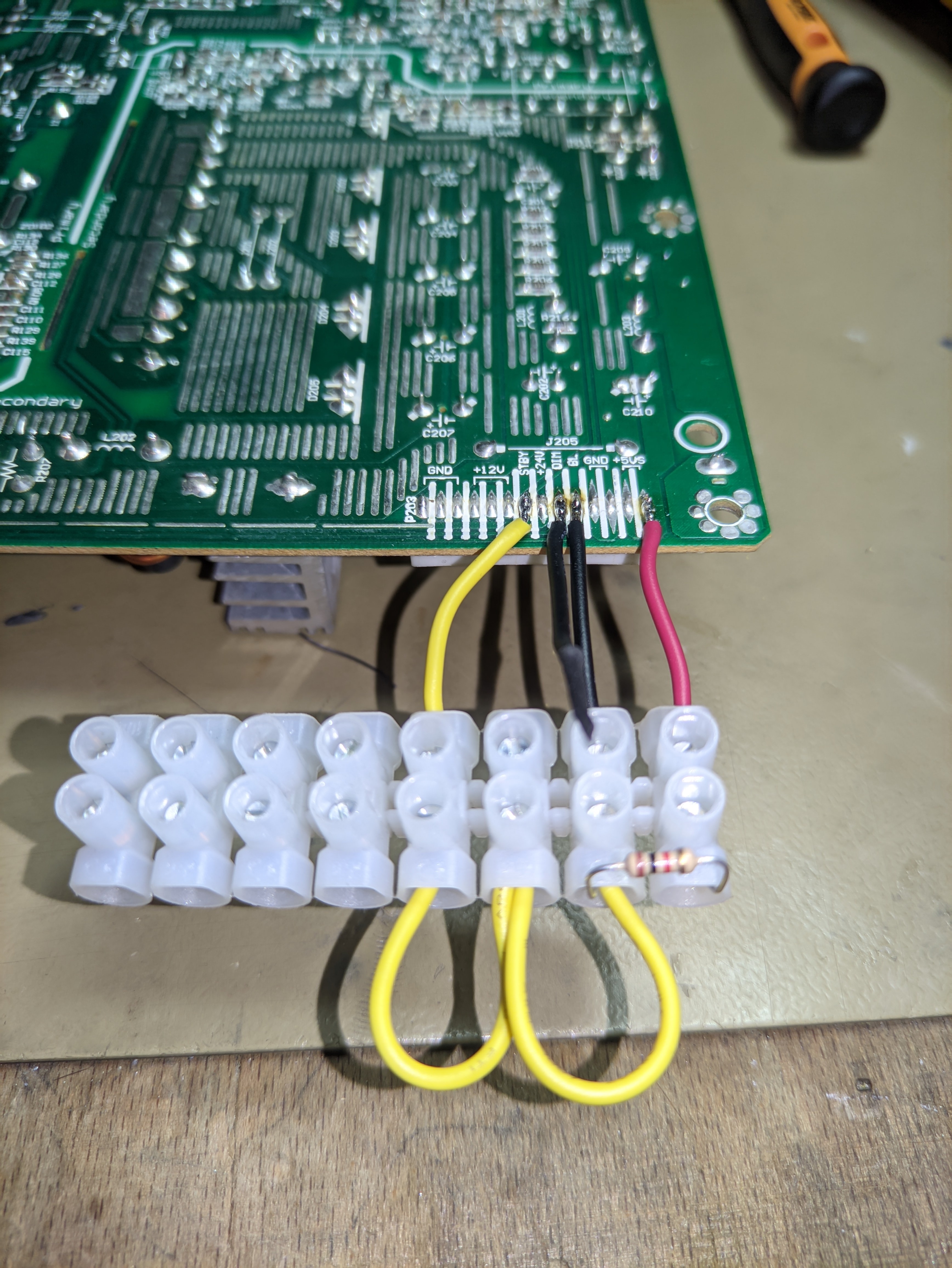

            +5VS seems to be too be the standby supply voltage as it is the only voltage being present after the TV is switched to standby via the remote.
            So if I understood you correctly I should connect the +5VS pin via a 1K resistor to the STBY and BL pin like shown in the attachment?
            • Diah
              • Feb 2013
              • 6365
              so yours PSU Socket i will rename the pins to be more understandable
              5VS = STBY .. STB= Power _ON BL = BL_ON DIM=DIM for BL
              so STBY via 1KR connected to Power_ON & BL_ON ... if the BL didnt power on... you need to add DIM to the same rail of the 1KR.
              PSU will start On. and you will have 12 & 24V... if the buzzing remain... disconnect the BL socket from PSU and check.the noise..
              if PSU & BL power up and No buzzing... keep this mode test... disconnect the LVDS between the MB and T-CON if you have external T-CON.... take from the socket of PSU 12V line and fed the T-CON Fuse F1... check the buzzing... if no more buzzing mean the issue at MB.. i so we do narrow the issue to be sure which part make the overload on PSU

                Thank you again for your help so far. Your short hand style of writing is a bit hard for me to decypher. I assume when you say "if the BL didnt power on" you mean "if the back light (24V to the inverter board on the left and the CFLs) do not power on", is that correct? The rest I think I understand. Anyway time to bust out the soldering iron.

                        I measured the voltages with the +5VS connected to the 1K and BL, STBY and DIM pin connected the other leg. Everything connected but the logic board. All voltages (12V, 24V) are presents but no loud buzzing from the PSU. Just very very faint clicking every 1.5 seconds or so and I can observe my external, totally unrelated LED desktop lamp flicker at the same interval. Also the 12V seems more noisy to me now on the scope. I will update this post with screenshots in a moment.
                        Video of the clicking and +12V pin on scope (AC Coupling / Ripple).
                        Grundig 37 9880 T USB Faint Clicking

                                So I made a video with some more information on how this is currently wired up and the various loading options I have available.
                                Grundig 37 9880 T USB Some More Information and Loading Options
                                "Too long - no time to watch" Video Summary:
                                1) I think I connected the PSU PCB according to the previously provided description (provided by @Diah) but I could be wrong. The Logic Board is not connected to the PSU PCB but the Back Light inverter board is.
                                2) I have the following loading options: a programmable (Chinese) electric dummy load, some 100W power resistors + passive cooling, sadly no car 1157 (BAY15D) car light bulbs

                                    I did what you asked now and reverted everything and I can now confirm that the PSU coil buzzing is only happening when the +24V backlight connector (P201 as named in the BEKO PSU manual attached to one of my posts above) is connected. If the connector is disconnected the CFLs are off, no buzzing but also no change in audio behavior. It also looks like the audio PSU (YDK 192 in the schematics attached above) does not only power the sound bar but also has some influence on the subwoofer out. If I disconnect the audio PSU all audio except the headphones stop working. Maybe the STV8537FSX is communicating with the processing board (ANT192) in the sound bar. I haven't fully figured out how they work together. Might be related to the MONITOR_OUT_L/SUBW signal from that board. I need to do more measurements on the various signals and amplifier circuits.

                                        The audio signal looks in very bad shape on the scope on all outputs and I tested the subwoofer speaker module on the bench with a little Sure Electronics AA-AS32157 15W class D amplifier since it was the easiest to hook up to the module and the subwoofer speakers work fine when driven this way.
                                        Ignore the German talking in the video it's not important (just me explaining to my non-technical friend for whom I am trying to repair the TV). I recorded this before I started this post and it just shows the setup and that the music sounds how it is supposed to sound when the subwoofer speaker module is driven externally.
