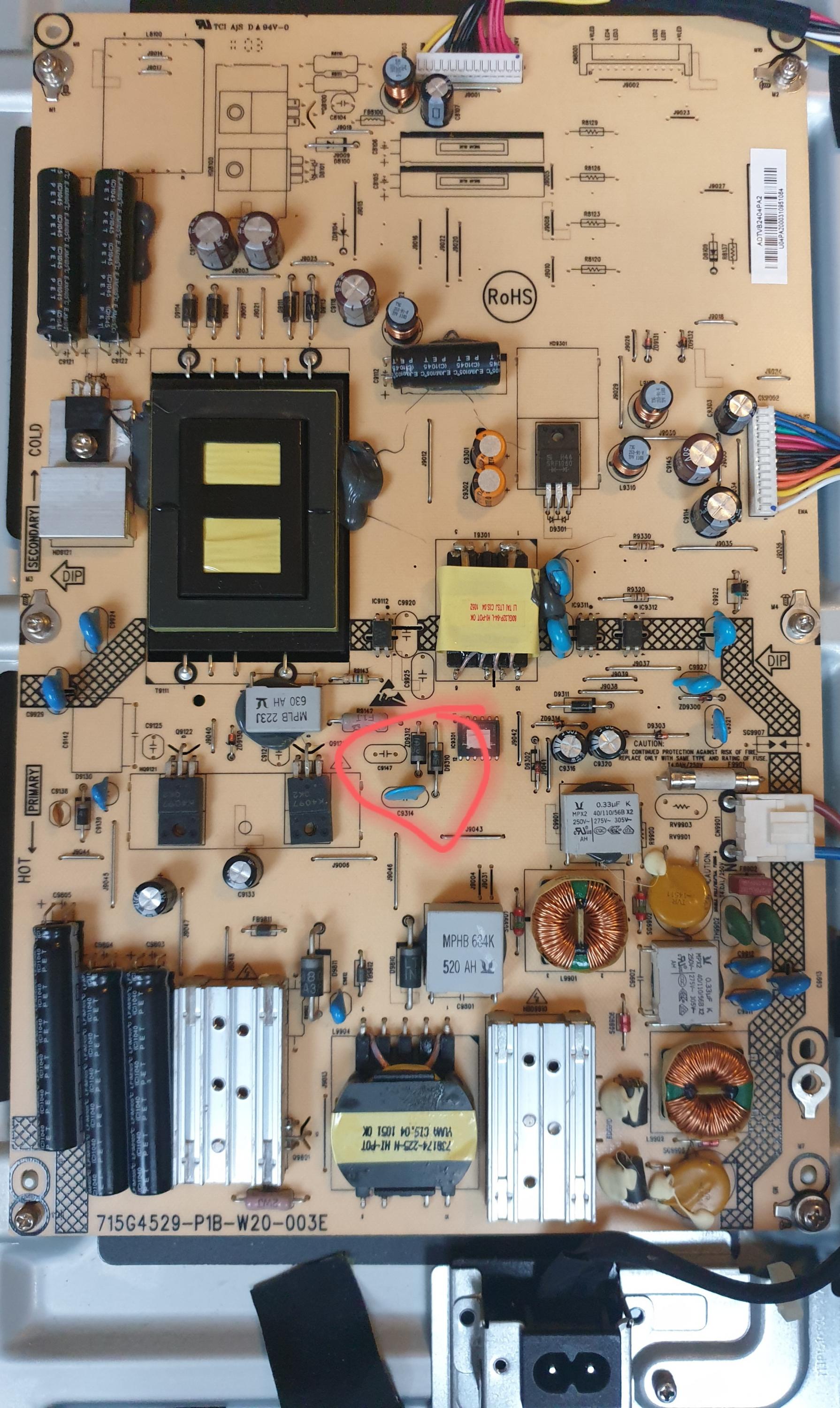

    My 12y old daughters tv (that she got after her grandpa, has sentimental value to her) was just dead without stby light a couple of weeks ago.
    I´ve repaired a couple of computer monitors, classic blown capacitor replacements, a 55" Sammy led with t-connboard replacement and a 42" Panasonic edge led where I replaced the led-strip.
    Not a master with the multimeter, which is cheap and 10-15year old btw...
    So please make it basic...
    To the issue at hand.
    As stated, the tv is totally dead with no standby light.
    Have measured on the power board and have 320V after the 3 capacitors on the hot side and also 320v by 2 zener diodes closer to the cold side (will add a photo of the power board). No voltage at all at the connector going to the main board or anywhere on the cold side.
    Attached powerboard photo with the 2 diodes with 320v marked and the repair manual.
    As you see I really need some advice here... stuck...

          The first voltage you need is the Standby +5.2V (page 127) see if it is there.

              You likely have a bad IC9301, pins 7~12 are hot ground, so using that as your meter ground, check the voltage on pin6 (320v), then check the voltage on pin1
              On the back side of the board, check that ZD9301 is not shorted, then also check that R9325 (4R7Ω) is not open.

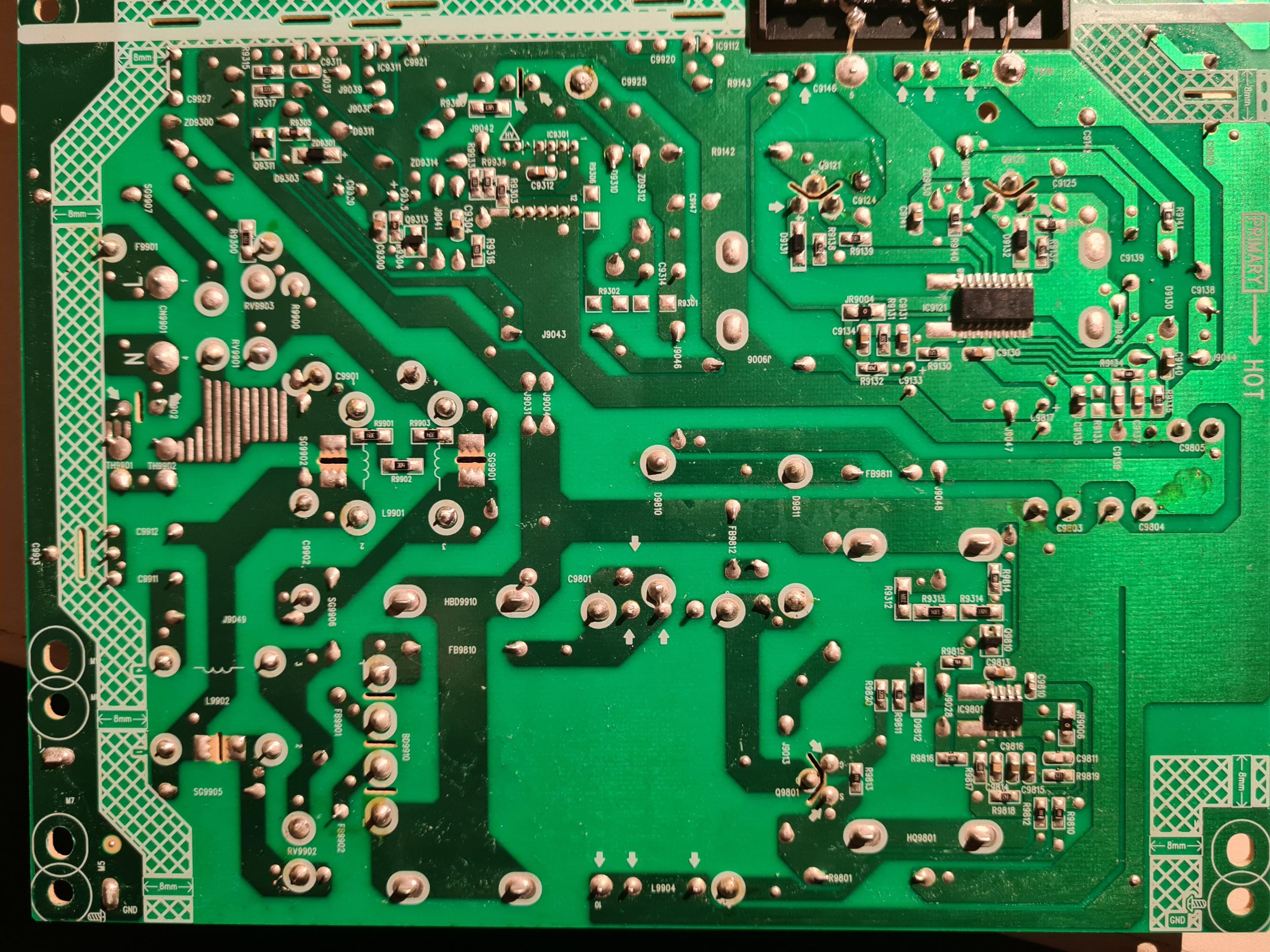

                  from yours measurements its look ZD9301 shorted. release one side of it from boards and measure it again... in case it had same read at both side / shorted.. mean there are R on the way open too.
                  so better upload focused high resolution photos to the top and down side of Hot area.

                      Attached 2 photos of the hot side.

                        R9325 (4R7) is just above J9542 it connects the transformer feedback winding to D9311. (likely not your problem.
                        If you look at the schematic, ZD9301 should not read 003 (shorted), since it tests ok out of circuit, something else may be shorted, maybe C9312, C9316 or D9311
                        You can lift one end of J9041 which should isolate ZD9301 from C9312 this should point you to where the short might be.

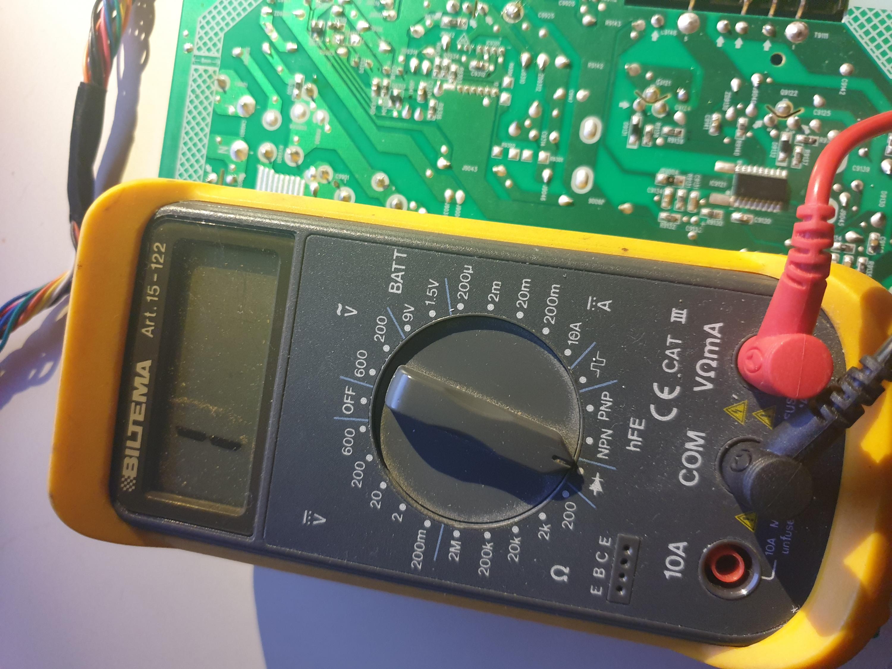

                                Those are good pictures, can you post one of your multimeter, need to get consistent readings.
                                • borstar_micke
                                  • Mar 2023
                                  • 11
                                  • Sweden
                                  Re: Dead Sharp Aquos LC-32LE430E
                                  Here is a picture of my old multimeter.
                                  • nomoresonys
                                    • Jan 2013
                                    • 12206
                                    • U.S.
                                    That meter is fine for the job, the thing about meters that are not auto-ranging such as yours, is if you get a 1 it can mean out of range, as when checking in ohm mode, so say you are on the 200 ohm setting and get 1, you will want to move up to 2000 and recheck still 1 move up higher etc. Recheck all those you checked in ohm mode.
