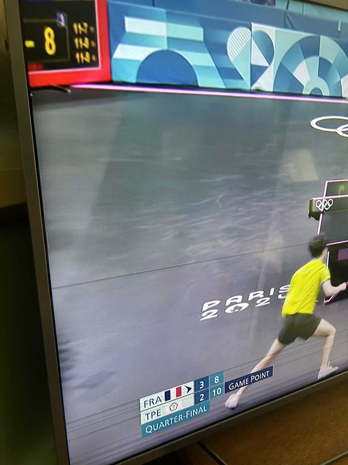

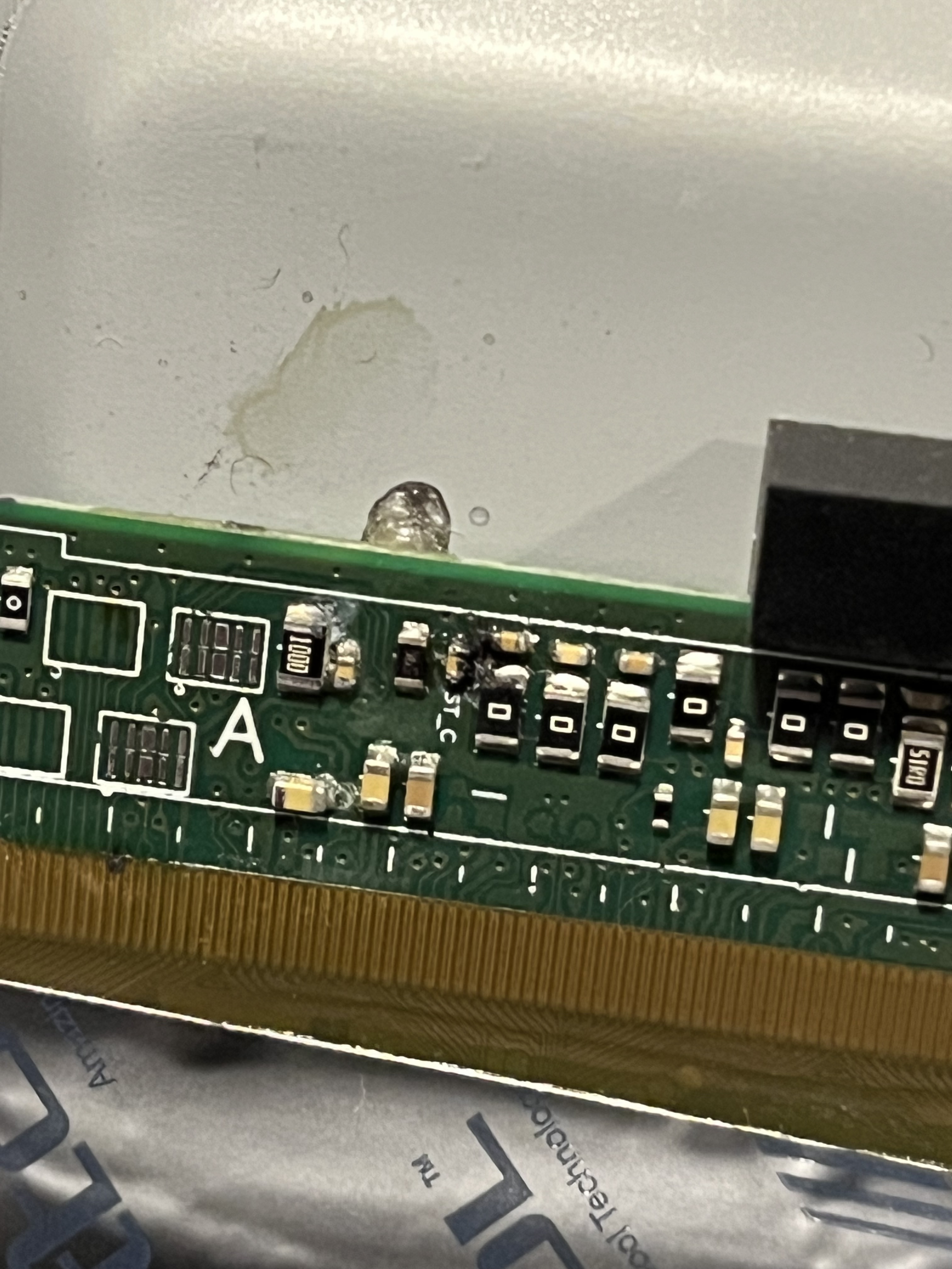

            Ahh, my happiness was short. TV worked like 1h and than i got this lines again and after resetting TV the screen was black with backlight.

              Your ceramic capacitor has burned out (shorted), this happens often, remove its remains, clean the area and replace the resistor.
              It’s not clear here, it’s hard to see, isn’t this solder residue?

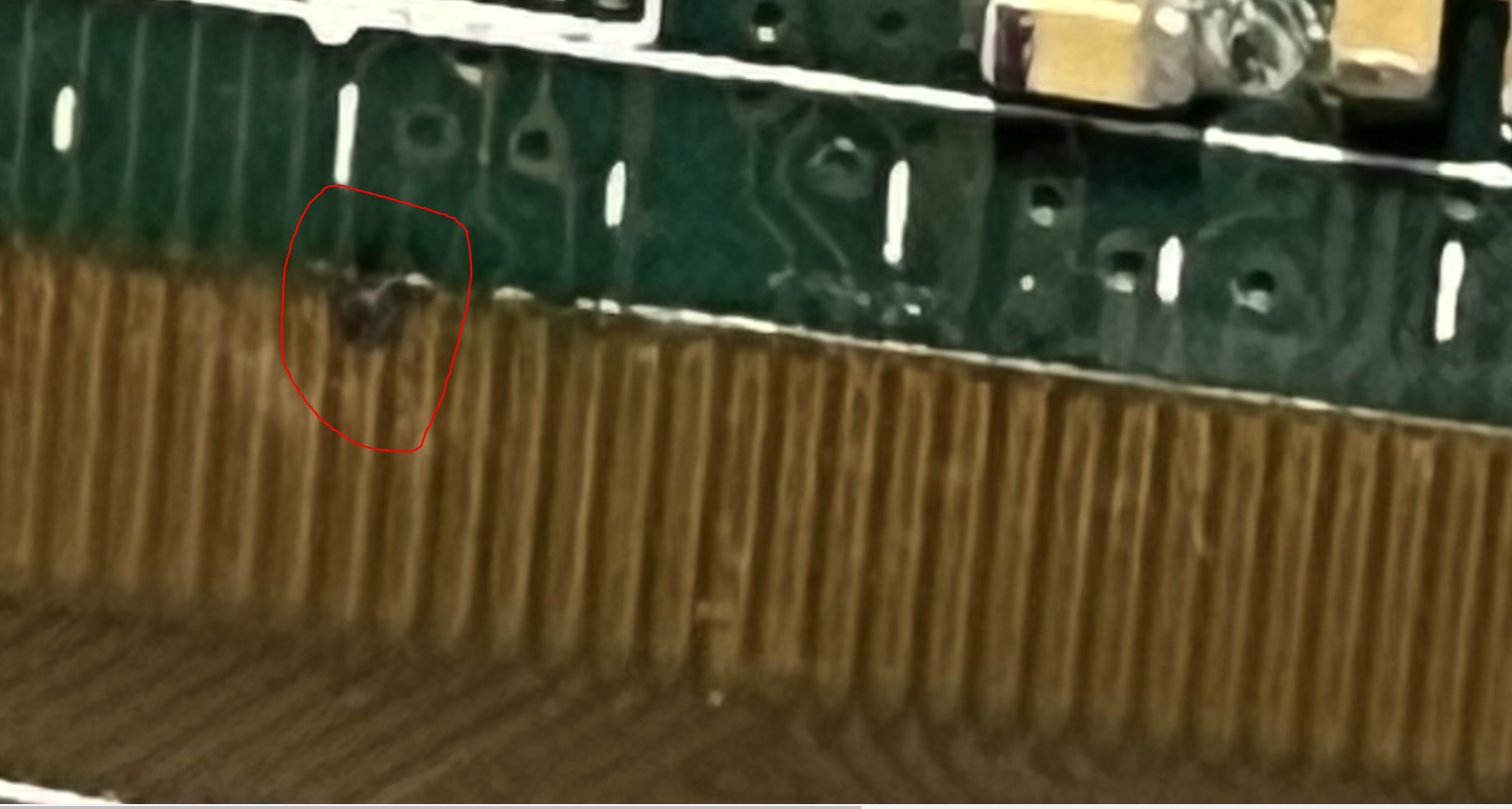

                This is burned trace not solder residue. The cap is not shorted. I removed it but not the burning happens on seconds 0 Ohm resistor. I dosconect that part of LCD and other side show error like grom begining

                  So there could be a short in this place, if not the capacitor

                    I remove the caps but the short are in layer of board

                      I found a short but now i have this on screen. I think i am giving it up

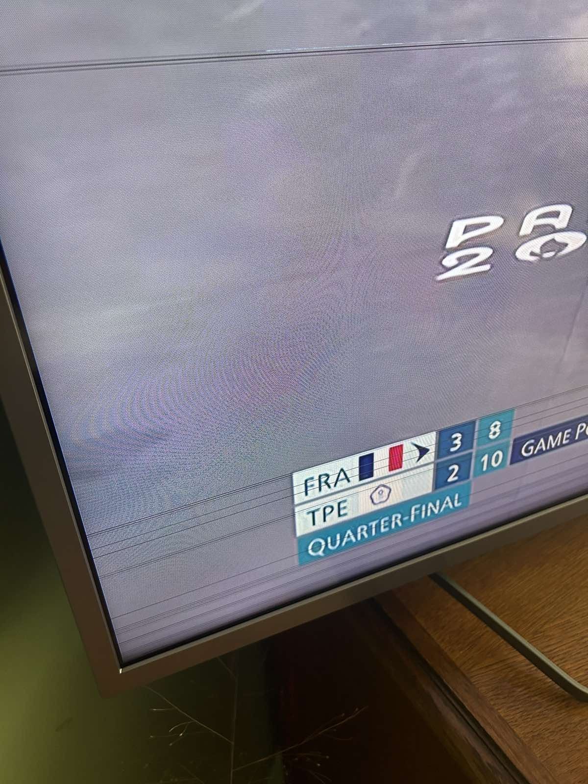

                                Hey, today i got the same model but with horizontal black line on tho bottom of the screen. After testing i found that one line was shorted to the ground and this line is coming from T-con board 55T32-COL CTRL BD. I order another one and waiting for it, hope it will fix the issue. I will post the result

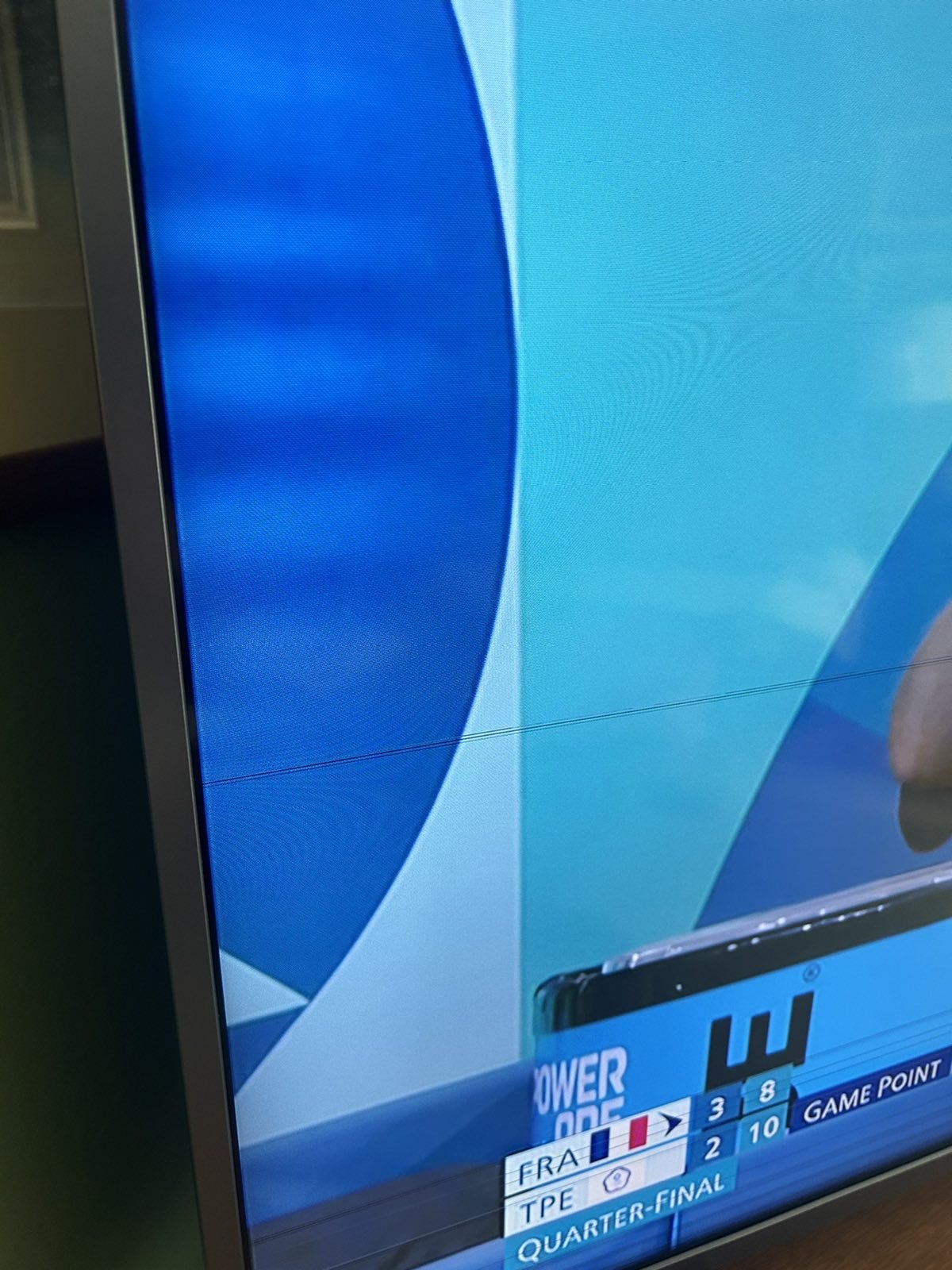

                                      Well i got the part but the issue is the same, still lines on lcd panel. I tried to remove the diodes on the end of the but that also did not help. I guess than the issue is in the lcd panel

                                          Yes i try that, no help. I return the TV to friend.
