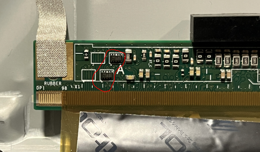

      There is no need to change which motherboard the problem is in the panel (in the buffer strips), if the panel is AUO, then as always the TVS diodes assemblies, take a photo of the buffer strips on the left and right sides.

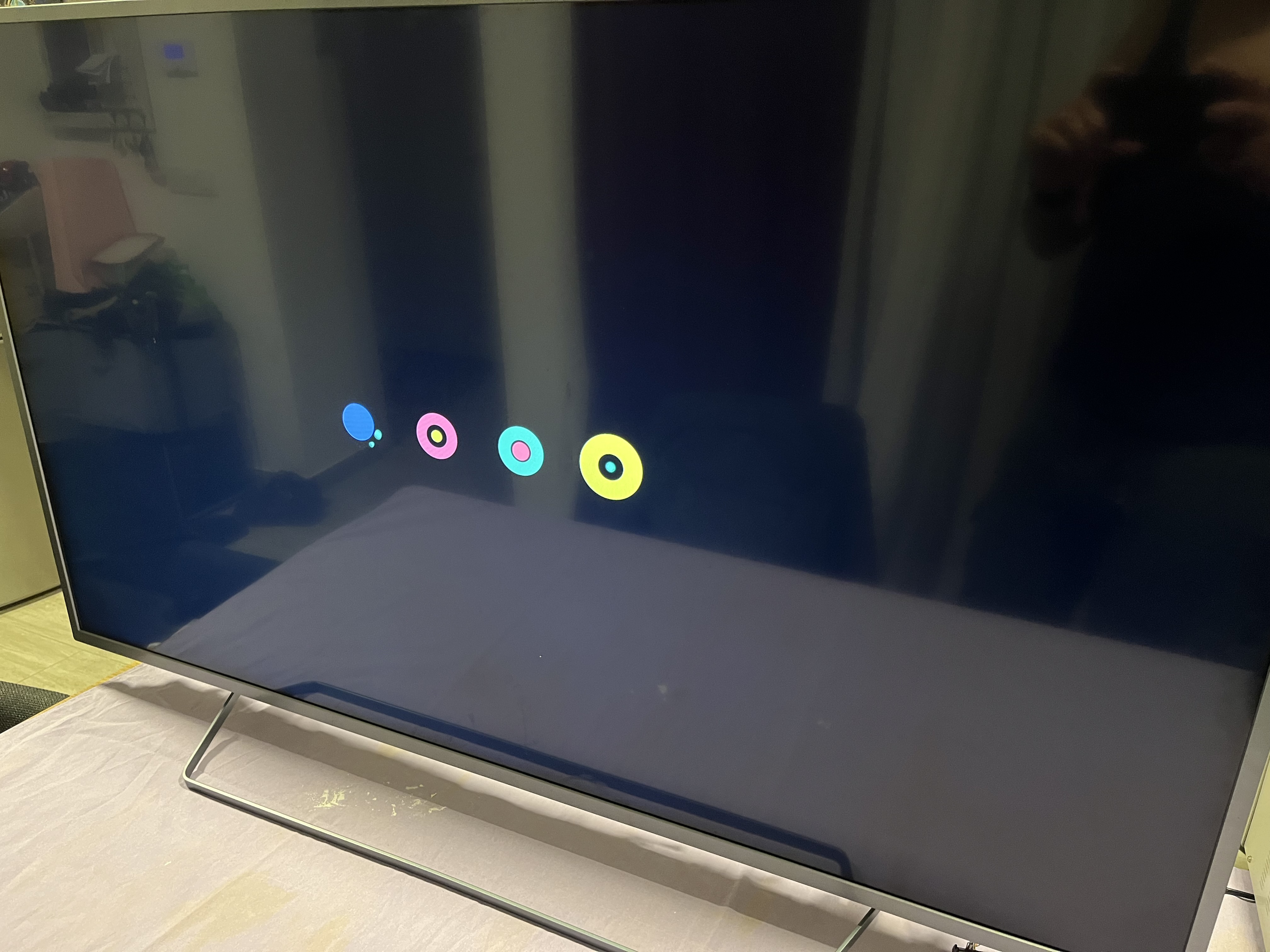

        Originally posted by Diah
        this is wromg... u need to have the 12v from the tv self for example on the MB LVDS socket u have t-con 12V...( pins 1-5 i think ) connect jumpers direct to f101,,, solder it not just touch
        i dis this but the screen is black, only backlight

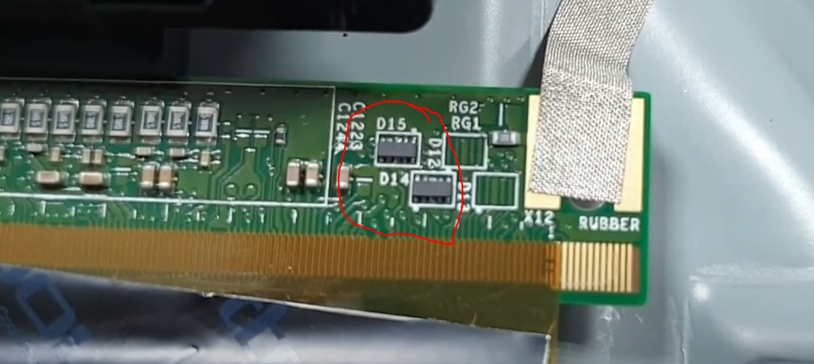

            here is the right and left side. Manufacturer is AUO
              do it again and check VCC on the winbond spi on t-CON if there > 3V

                • rtstorm
                  • Feb 2012
                  • 971
                  • Croatia
                  there is 3.43V on pin 1 of Winbond IC

                    • lotas
                      • Jan 2016
                      • 4749
                      • Russia
                      #30
                      Carefully remove these assemblies from both sides.

                          • lotas
                            • Jan 2016
                            • 4749
                            • Russia
                            #33
                            yes this guy have exact problem like i do, but he have problem only on one side of the screen. But i do not understand did he just remove the diodes or?
                            Yes, he just deleted them.

                                • rtstorm
                                  • Feb 2012
                                  • 971
                                  • Croatia
                                  #36
                                  I remove the 4 diodes and guess what? tv work :-) Thank you!
                                  is this ok to leave panel without those diodes? What are they for?

                                  • lotas
                                    • Jan 2016
                                    • 4749
                                    • Russia
                                    #37
                                    Well, we saw it, it's good that we didn't order the motherboard, and the same problem would have remained!
                                    You don't need to install these diodes, they are more problems than they are worth.
