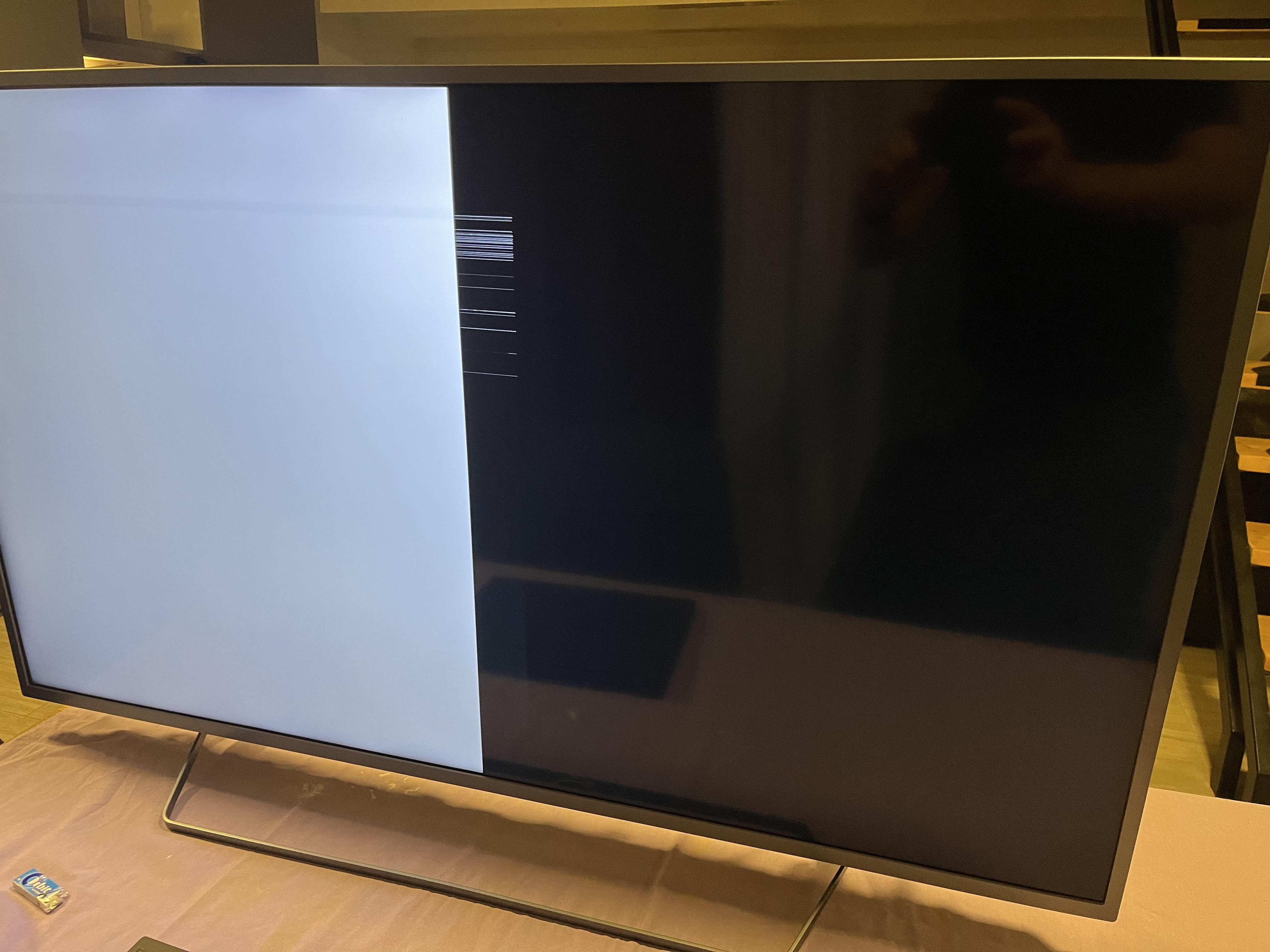

    Hello, I have this 55" Philips TV that suddenly has these vertical lines on the LCD panel. I have checked the T-con board and I noticed some caps have 40Ohm I don't know if this is normal. These caps have 1.2V on them. I mark them on the photo with a silver pen. The T-con board has 1.2V, 12V, 25V, etc. Does anyone have any idea what could it be?

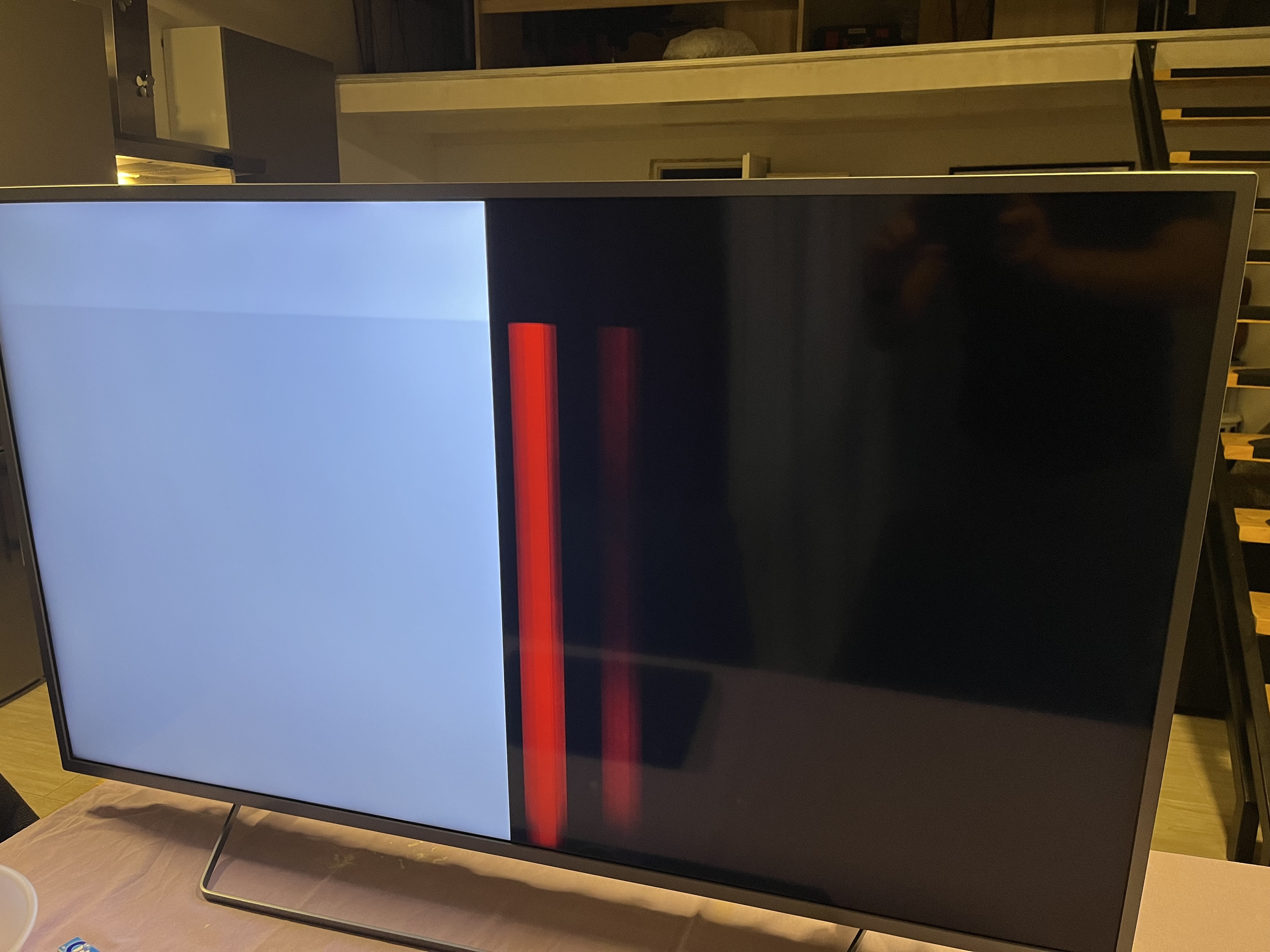

    i try to disconect one ribon cable and the problem is the same, one side is white other side have the lines (the same is in other way)
    T-con model: 55T32-C0L
    Main Board: 715G8579-M0F-B01-005T
    ...the quieter you become the more you are able to hear...

    from initial boot photo it sound to me mainboards data issue
    how about if you disconnect half screen.. did you get half clear white?

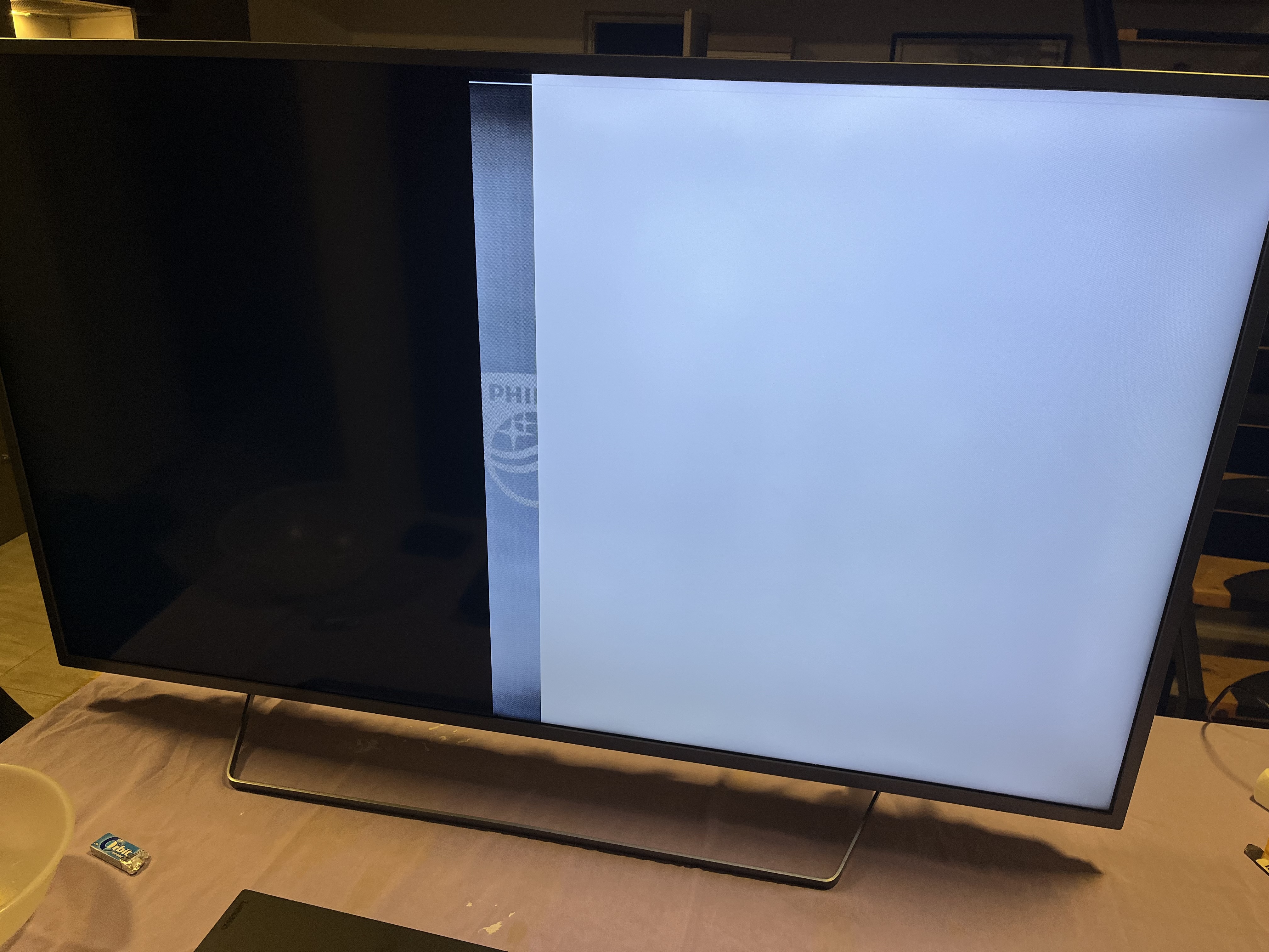

      Here is the image

          100% faulty panel..!! i'm afraid..
          (VGL leakage)

                  Don't hope.. relax.. bad screen..

                    disconnect the LVDS from the T-CON and fed the fuse on T-CON 12V on F101 to test the panel and t-con as stand alone., you should have color pattern

                      I disconnected the LVDS from tcon board, turn on the TV and put 12V on F101 but the screen is black

                        did the backlight come on?

                          Yes, backlight is on. But there is no image.

                            In the test pattern the first seconds screen is black, then white. green etc..

                                I was able to capture the white line on first second when i connect the 12V after that is all black.
